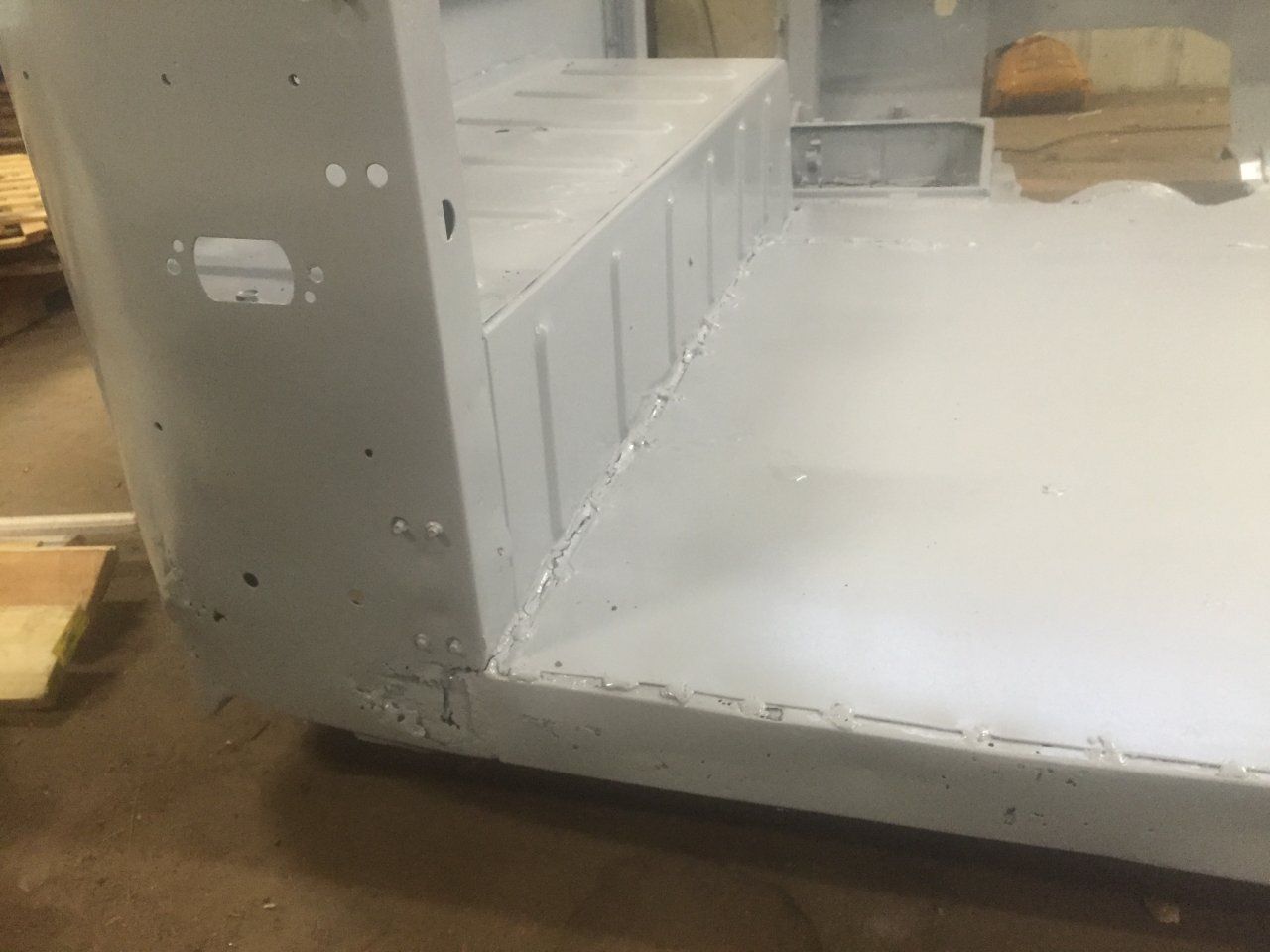

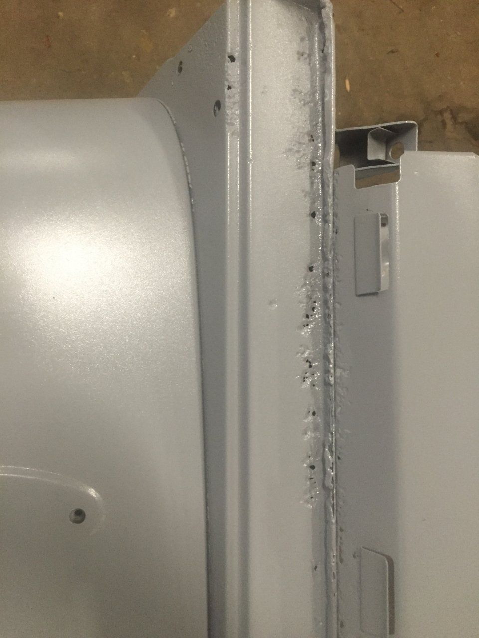

Picked up the tub and most of the body today. Needless to say I've got plenty of body work ahead of me. I finally got 220 in my shop so I'm in the process of getting my welding stuff set up. The plan is to build some sort of rotisserie for the tub to bolt to so I can work on it easier. What are most people using as gauge for patch panels? I feel like I read 16 gauge is about right some where. Can anybody confirm? I'm also going to take a stab at zinc plating a few parts then finish them with a chromate to give the cad plating look.

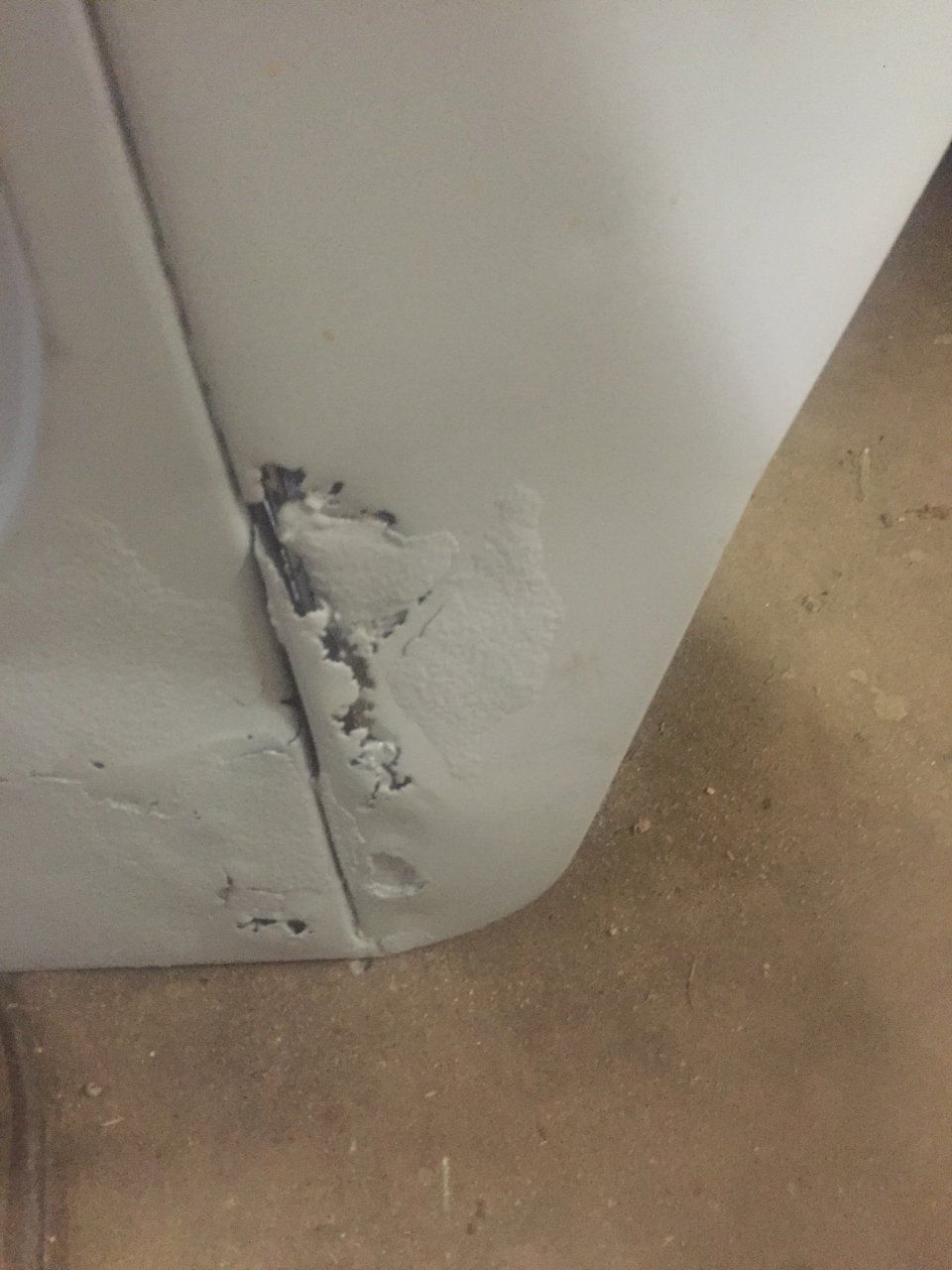

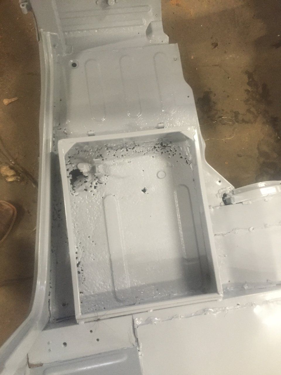

Looks about like swizz cheese doesn't it
