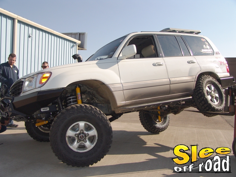

I'd rather have a one of the only SAS 100s in the country haha
That's the White Rhino. It lives down here in Houston. I know the owner and have seen that thing wheeling. Beast. With one caveat, it is so unique that if something fails you may have a hard time with trail repair.
Would I drive it? Heck yes I would.

looks like its all ford, 80, and a few 100 parts. (Id like to ditch the ford and 100 parts completely in place of custom 9.5" housings)

@robustbambi Looks like it is a custom housing utilizing LC parts and a True-Hi9 Differential.
Building of the White Rhino <-- Link

Yeah I'd just use land cruiser diffs, a ruff stuff housing, 80 knuckle balls and hellfire knuckles to get rid of the stock 80 steering arms.

paul's front axle is a front range offroad diamond axle housing with a ford H.P. 3rd member with Toyota 105 series ousters.
