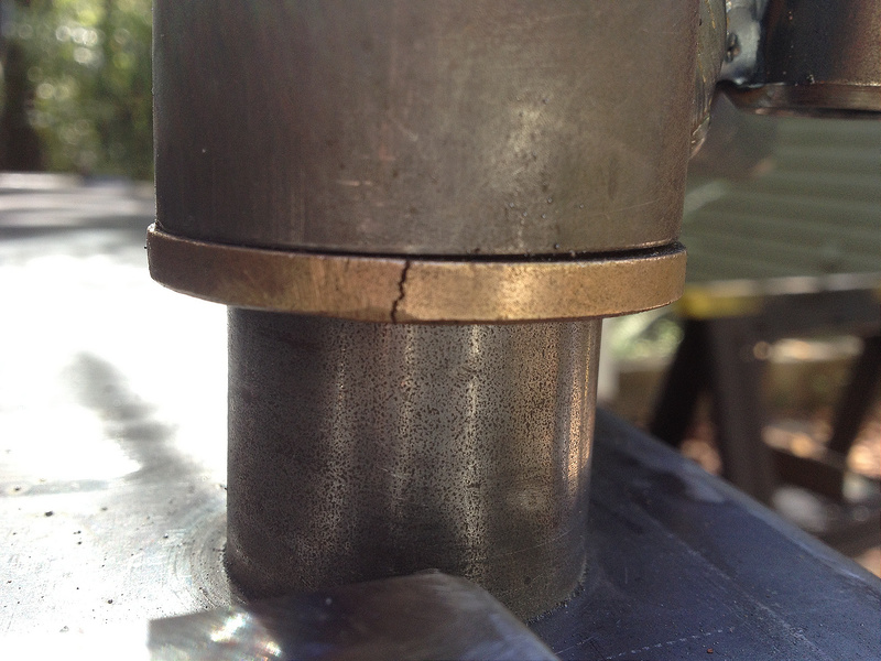

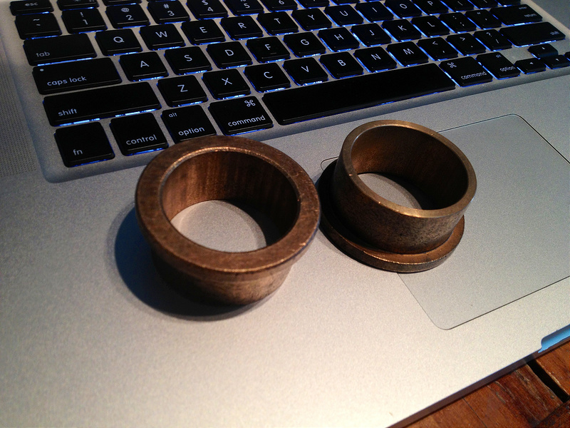

During the bumper's journey from Wyoming to Georgia, the brass bushings developed cracks from the extremely gentle shippers. I was a little hesitant to use them, so i told Mr. Jason.
He was extremely helpful and got these replacements out to me immediately no questions asked.
