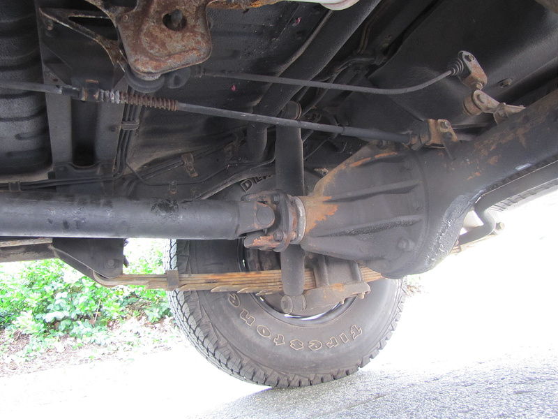

Completely agreed. I was just saying that it may or may not happen! I would always recommend putting a high-lift between the frame rails when cutting out the crossmember, like this. My high-lift fell out because no pressure was put on it.

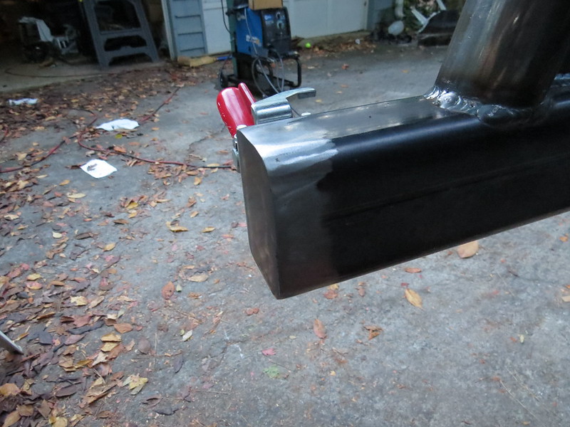

He started off by welding the latch nuts to the inside of the swing out arm so that he could weld the opening shut.
Came out really good in my opinion.
When i looked at the quarter guard pieces and the bumper, it seemed they wouldn't line up straight, I should've sent Jason a PM earlier because he managed to come up with a solution pretty much instantly lol. Anyway, i let Aidan get a little creative with the end caps because i didn't want the bumper to just sort of end, it needed a little extra. He cut up some card board and roughly mocked up what he was going to do.
It was the only tape we had!!!!!!! LOL
Aidan also welded a long horizontal strip along the bottom of the bumper so that when it comes down on a rock, it won't hit the edge of a piece of plate and possible bend... I did that to Aidan's front ARB a couple weekends ago lol.
