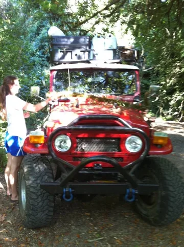

Eli - I see you found a Hi-Lift....good job. Is it bolted down to the storage box or just sitting there? If it isn't secured, you may want to.....you don't want that heavy piece of metal coming at the back of your heads in an accident/roll over, etc......
In the video Ashley mentioned attaching it to the rear tire carrier.

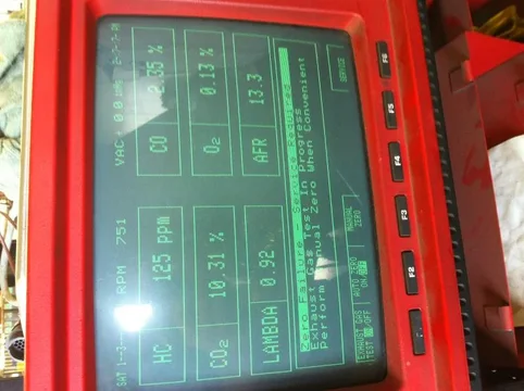

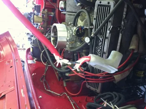

I had been assuming the engine was running really rich via the fuel smell, lack of power, and poor milage.... I finally caved and took it into a small auto shop in medford that had an old snap-on diagnostics machine....
as soon as we get it all hooked up - 7 cylinder was clearly not firing ATALL and the 3rd was misfiring all over the place.... Ideal PPM reading for my engine should fall in the 175-225 (in unused gas making its way to the exhaust) but instead read 2,000! :eek:
pulled out the #7 sparkplug and the gap was entirely closed....not sure how that happened but assuming a piece of carbon (from the excessively rich FI days) came off and banged the back of the plug.... set the proper gap, re ran the test and as the 7th showed proper power the PPM dropped to 350. As we took a closer look, the #3 wire had become pinched between the power steering pump and the exhaust manifold.... burning through the heat shielding AND the wire, but not enough to burn all the way through.... thus the misfire, occasionally the wire would ground out and cause it to miss.... with a new wire, and better routing the PPM now reads 125!
:doh:
Also leaned it up just a bit. The power is night and day, and soon will have updates about the MPG....
