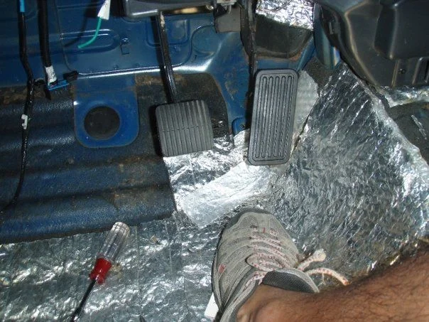

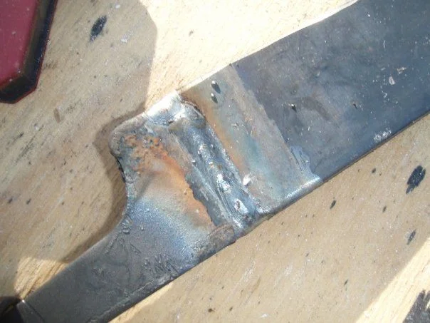

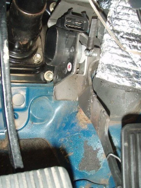

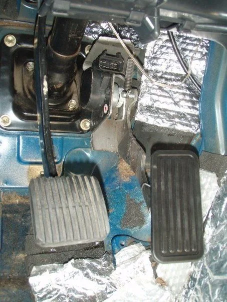

Got to do some gas pedal work this weekend.. and I must say it came up much better than I expected and the welder I scored on ebay the other month welds like a champ !!!!
I was able to keep the pedal in the stock location using the existing holes. I just need to drill one more to make it more secure !!!
Woo-hoooo :bounce::bounce:
Here are some fotos !!
First weld

Second Weld

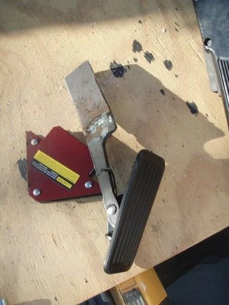

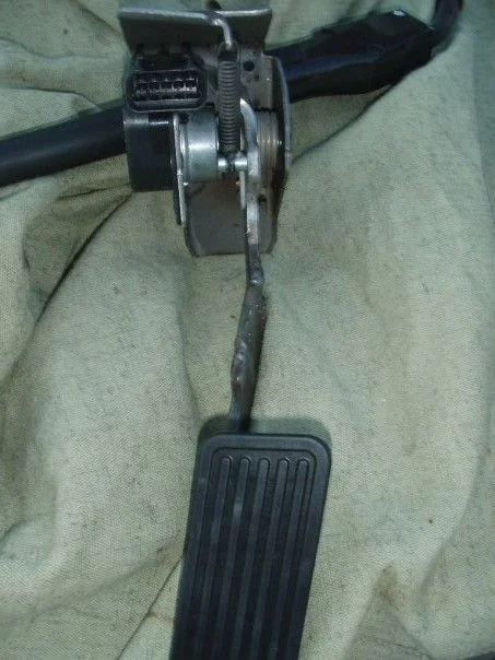

Here are some more.....
The pedal had to be welded on an angle away from the tranny hump...
Oh and this is not the pedal that originally came with the engine...as that was all plastic..... now Im waiting on a fuel pump and some O2 sensors extensions and also need 02 sensors for the front at least one as the wires were fried.....

Nice work man! those welds are looking good.
Nice welding Frank. Where did you learn to weld like that? The pedal looks great!

Anyways.. yeah re: the weld.... I was very surprised about how nice and clean it came out !!!
