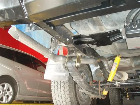

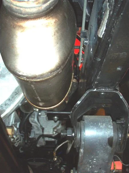

Hey guys, got my truck back today from Mike's muffler and it sounds fawking awesome.. here is the porn !!
This is the cat on the pass side.. I need to move that brake line

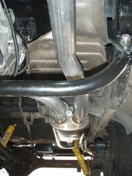

Magnaflow from the front

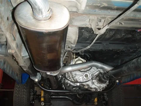

Rear view

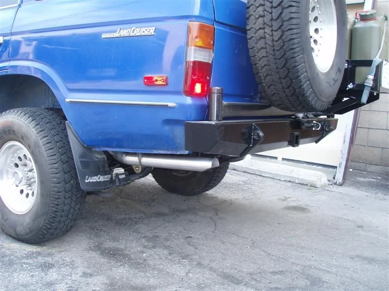

Rear dump and the evap on the right side...
Yeah it will probably get smash one day but for now I just want to please "the man" and get my sticker....
she sits pretty...

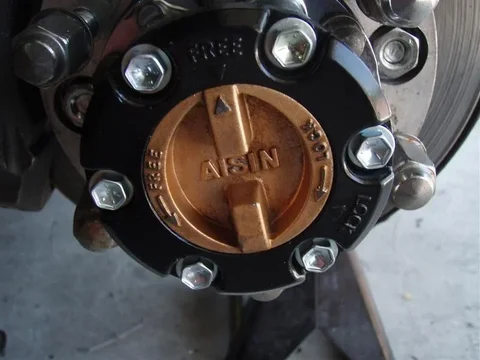

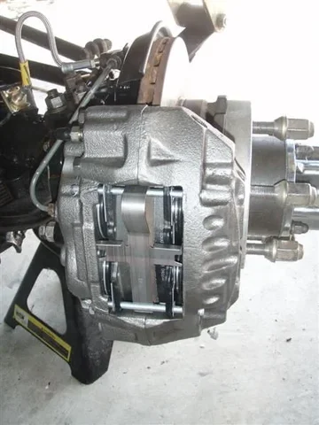

while doing the knuckles I worked a tad on the hubs and some much needed new hardware
New 4runner calipers
threw some paint on the knuckle housing and installed new dust caps on the TRE's (one was torn and the other was MIA)

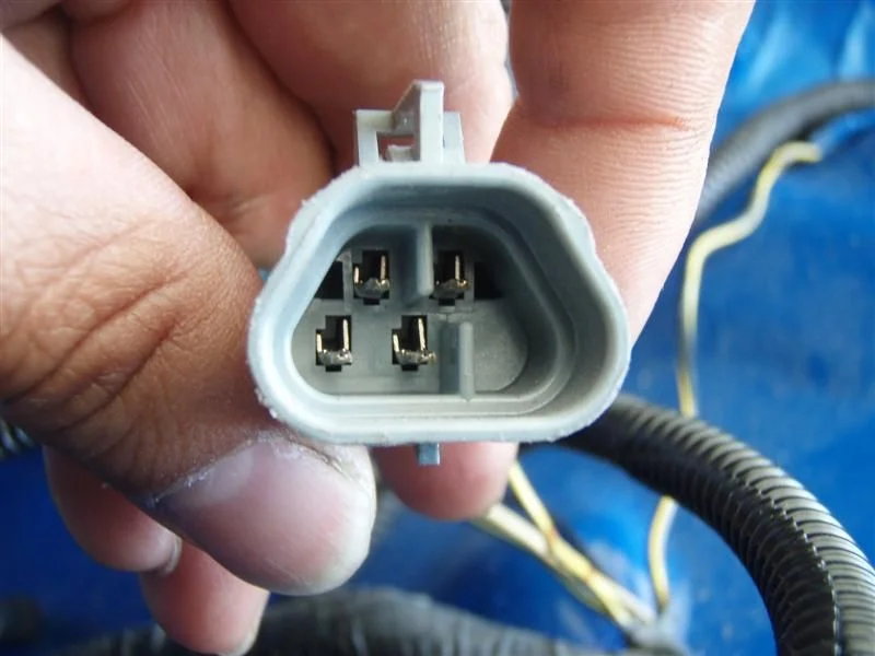

Any of you guys know why the O2 sensors plugs (from harness) on the rear are shaped this way The actual O2 sensors that came with the cats all four have square plugs.

So, here's the deal with the O2 sensors. On my setup, I've got two types of plugs, one set for before the cats, and one set for after the cats. So, I've got two different connectors, one that's square and one that's trapezoidal. (I'm pretty sure the set of connectors that's closer to the computer box is the set that goes before the cats.)
Now here's the real question, it seems as if you've got 4 O2 sensors that are the same with the square plug. Are the O2 sensors before the cats supposed to be the same as the O2 sensors after the cats? (Meaning can you just splice the wires and connect the O2 sensors that you've got?) Or are the pre-cat sensors different than the post-cat sensors?
Does anyone know? (Maybe Randy knows the answer to this one...)
And yes, the fuel pump is going to be loud...I'm going to look at an intank option myself...
Frank, I also have different O2 sensors/plugs front and rear, but mine is flat front/square rear - whereas yours is trapezoidal. I would try to get some sensors that match in any case so that your inspection goes well.

Re: sensors.. yeah I got 4 sensors to pre-cat and two post-cat.
The ones on the front are square and the ones on the back are pyramid like shaped plugs..... and as Shane stated.. I will probably go with the original deal... I found the trapezoid shape sensors but they are listed for 6.0 litter and not 5.3
Stealership here I come...
