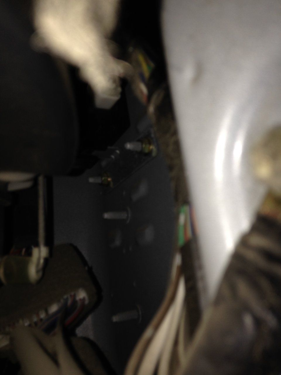

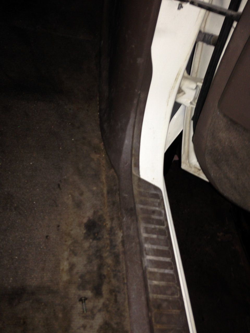

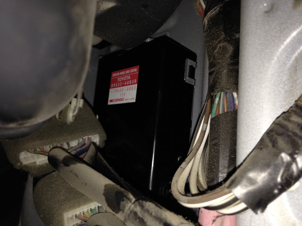

Getting a little ancy about making progress while waiting on the machine shop. Decided to install the diff lock computer. Pulled the passenger door sill with a trim removal tool, cleaned the mess underneath and mounted the computer. I had to clean and oil the threads as there was some paint build up on it. The harness was waiting right there for me.

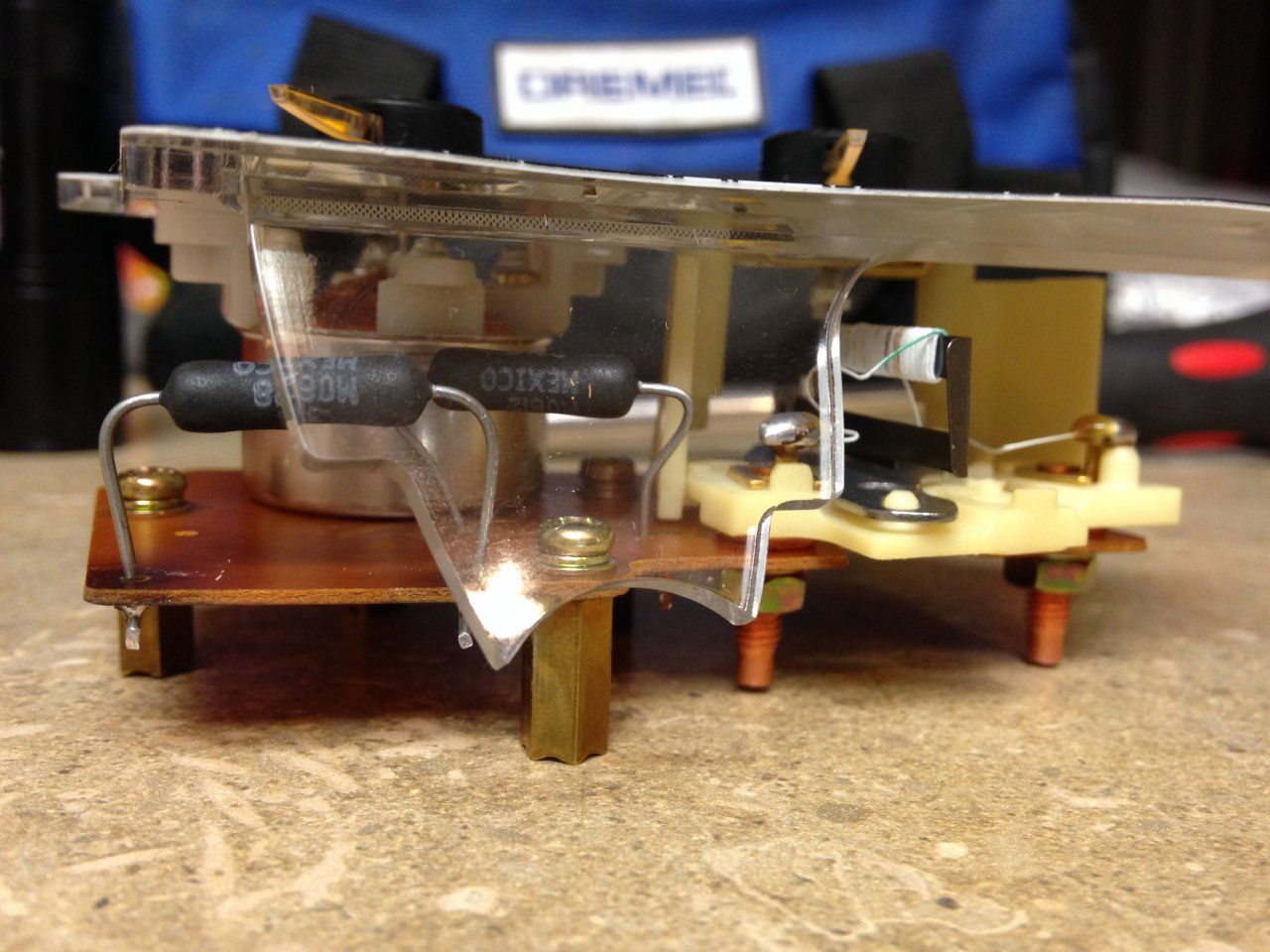

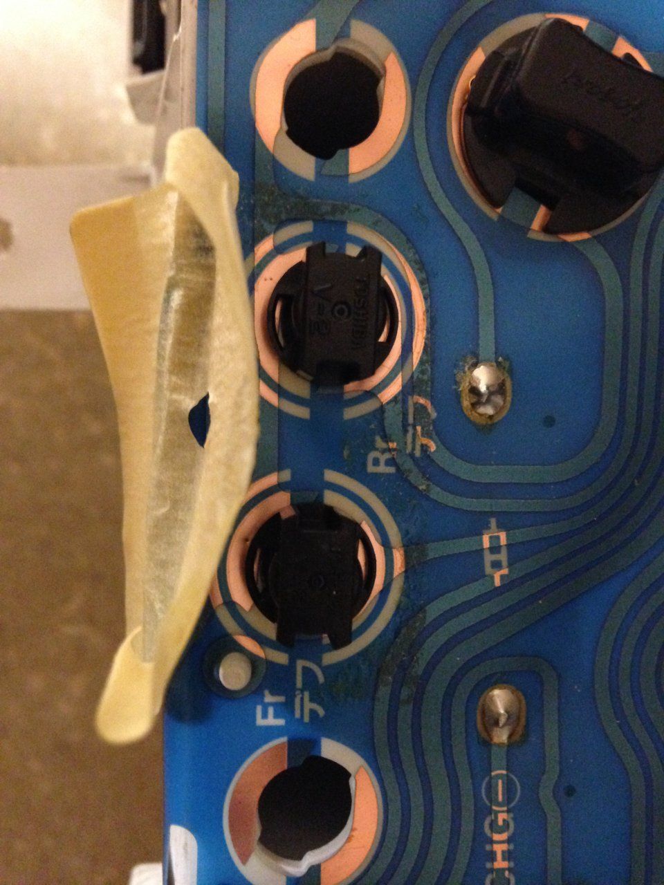

Moving right along, I pulled the combination meter and installed the sockets and bulbs for the front and rear differential locks and did the temperature gauge resistor mod. I fished out the harness for the differential lock switch and put it all back together. I did remove the upper column cover which has 2 screws and I removed the circuit board to solder the resistors in putting them in the middle of the air space for maximum cooling.
Also interesting to note is that the air filter clogged lamp in the cluster doesnt connect to anything on the circuit board.

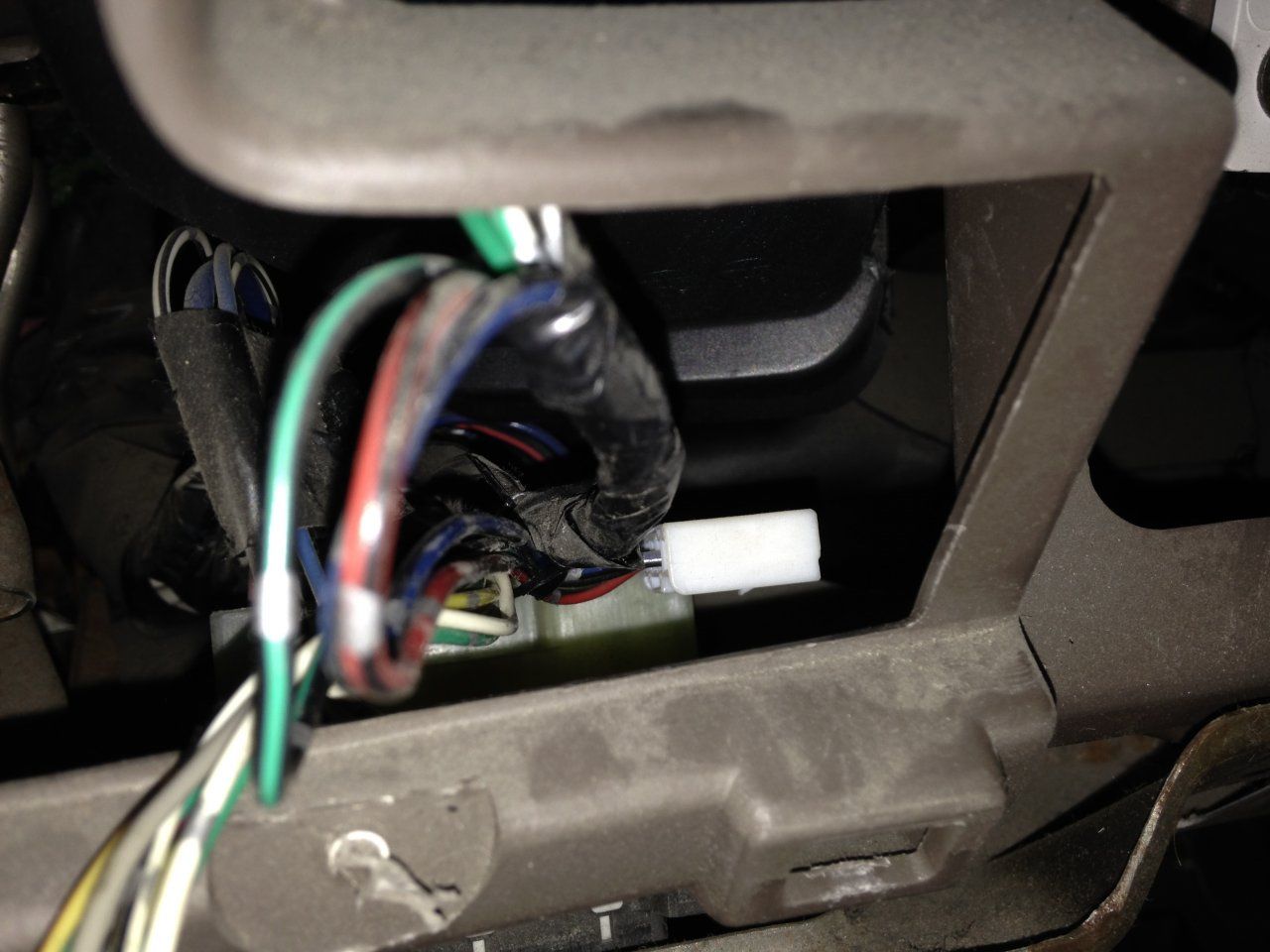

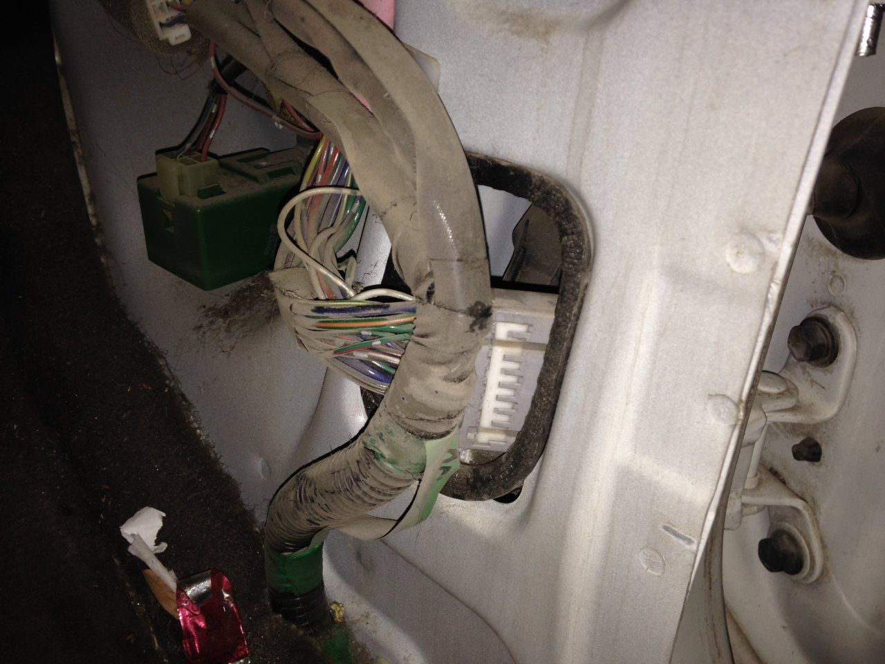

Tonite I removed the back seat and carpet over the fuel pump service cover to change the fuel pump sock. I started thinking about the e-locker swap coming up and wondering about the wiring. Someone told me that I may only need the front and rear harness as the Collectors Edition may be mostly pre wired. Not real sure where to begin here if anyone could chime in. I need to know where to look. I have what I believe to be a set of 96 LC front and rear elocker axles and most of the wiring harness. If it is pre wired, where are the dead end plugs I plug in to? Thanks!
