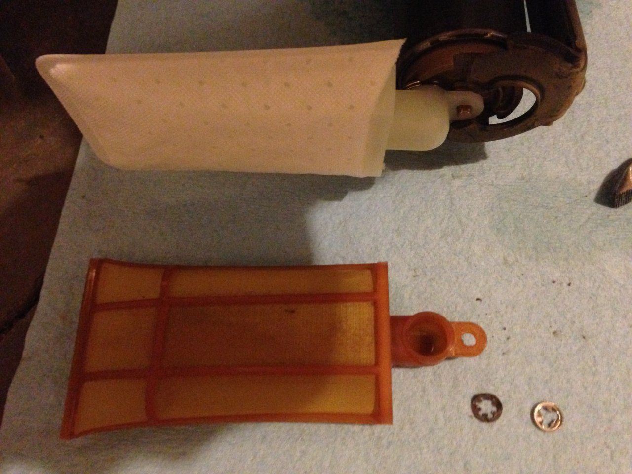

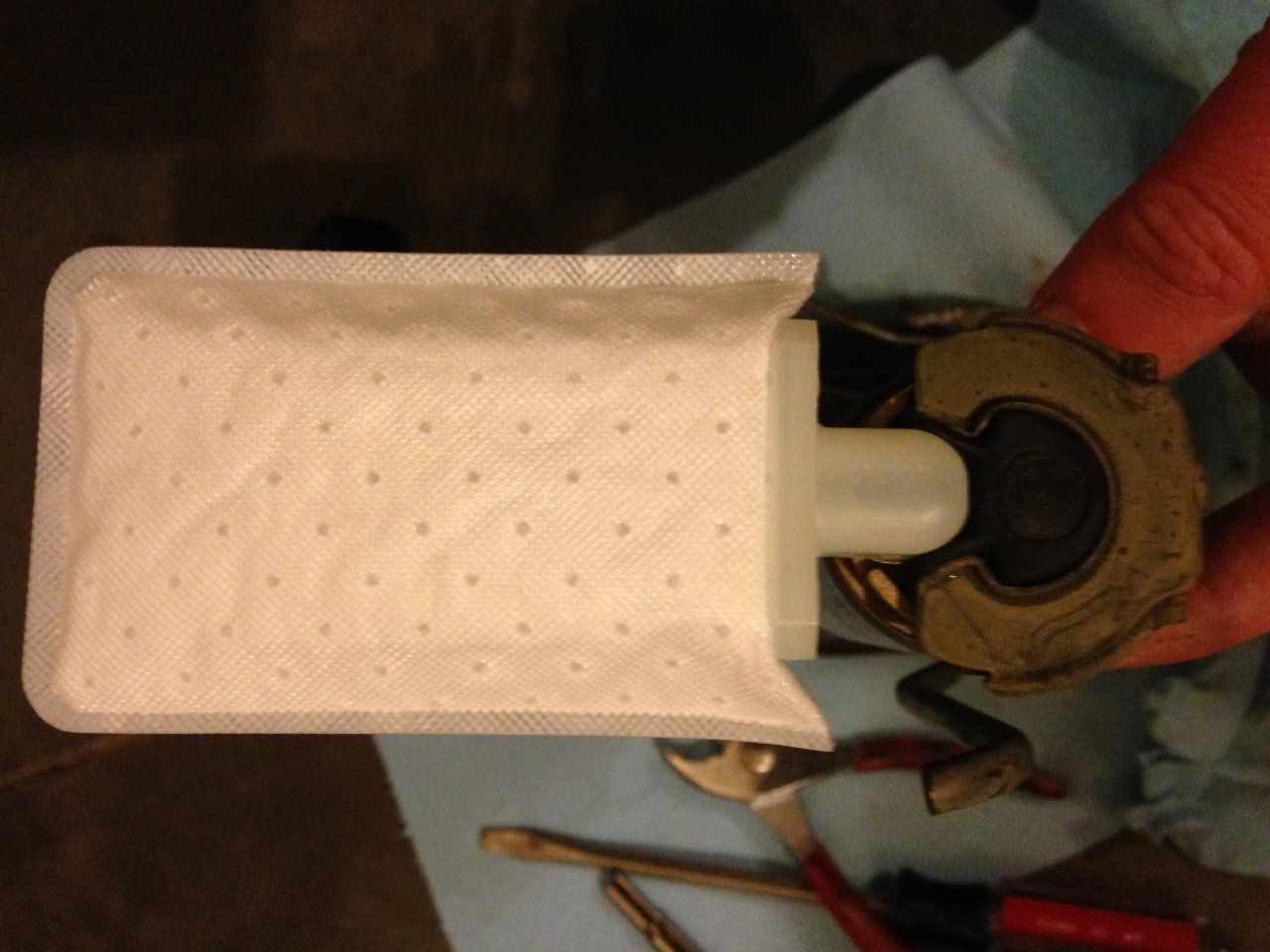

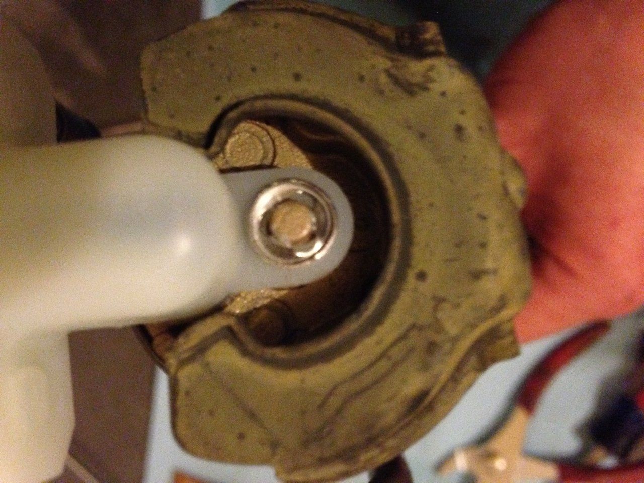

Pulled the fuel pump tonight to replace the sock. Tank looks great & the fuel stabilizer is doing its job. Even the sock was pretty clean. Replaced with the Denso sock which was a tight fit and has a retaining ring on the fitting as well. The clip was slightly different but very stout.

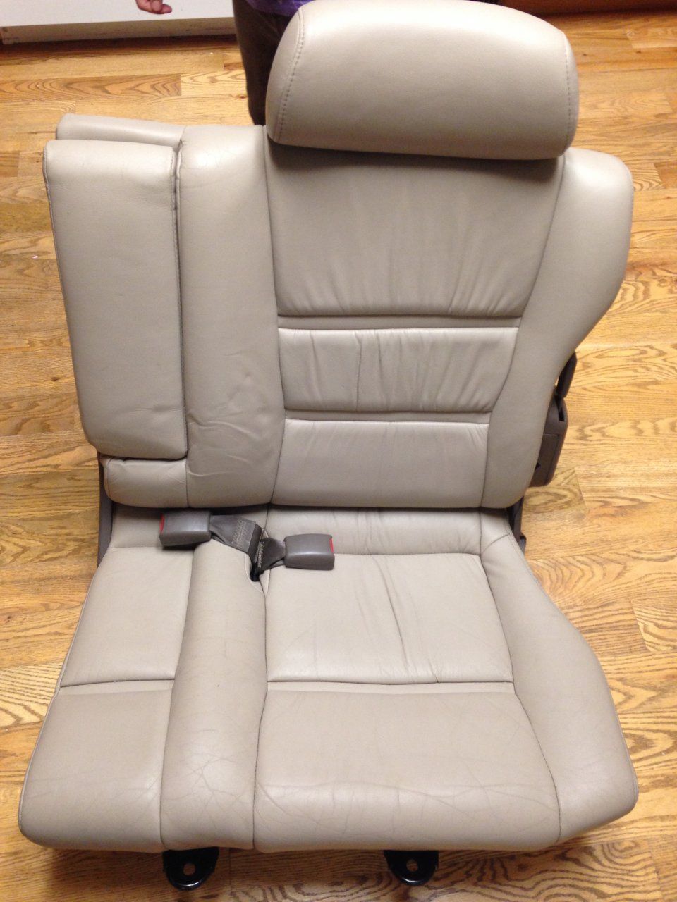

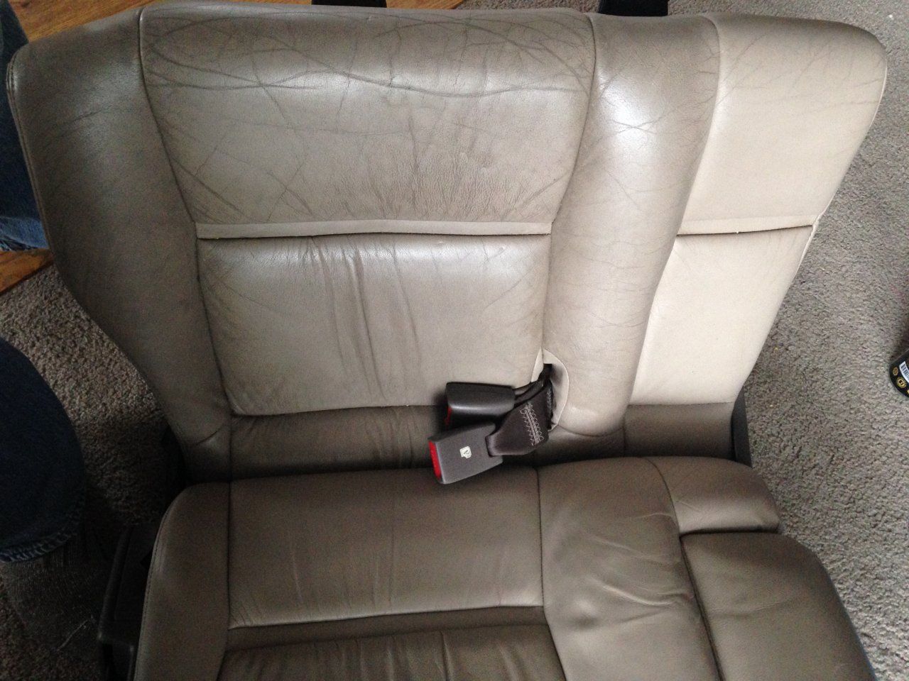

So, the previous owner appeared to drink coffee, soft drinks of the cola variety and liked shrimp/peanut butter m&m's. May also have not done a good job cleaning up spit up. In fact, not sure P.O. ever thought to clean the car. At least it's all dry. All of this I have found working on this rig. Since the back seats were out, decided to address the 2nd row cleaning.
Had to shampoo the carpet and all in all looks great except for a little red dye, probably koolaid. Really pleased with the leather cleaner. The upper right has been cleaned and the rest as I found it.

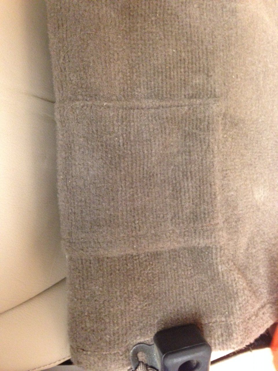

In cleaning the drivers side 2nd row seat, I noticed a pocket made into the bottom side where carpet is. What is this pocket intended for?
It's the pocket to store the strap (when not in use) that you use when flipping the seats forward.

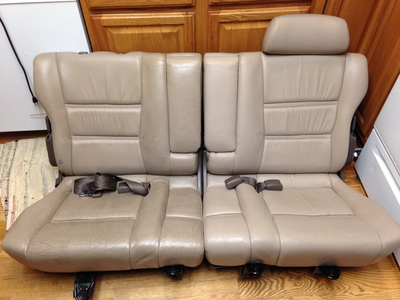

Thanks! Here's the finished cleaned result.
Side by side picture of the difference.

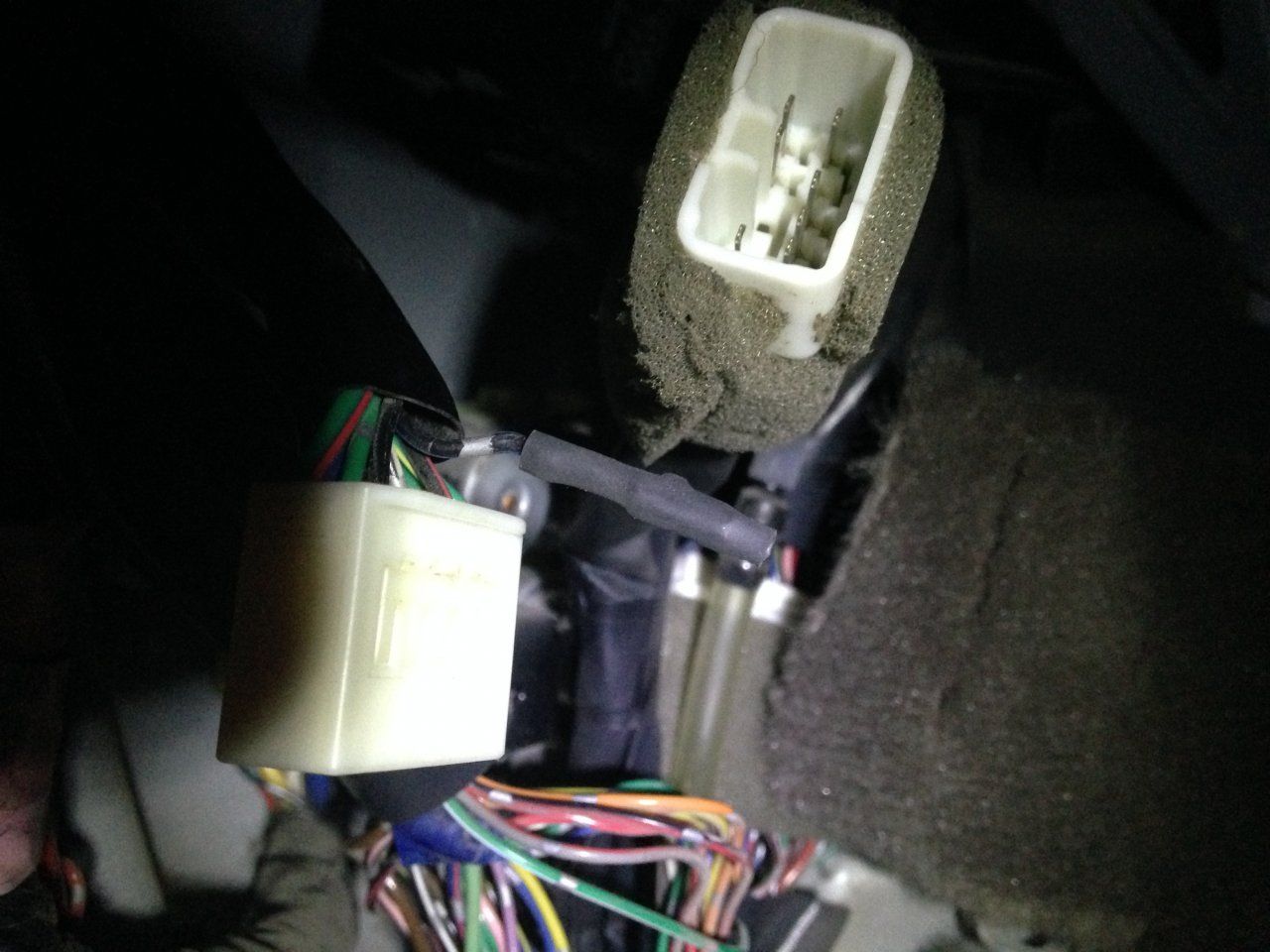

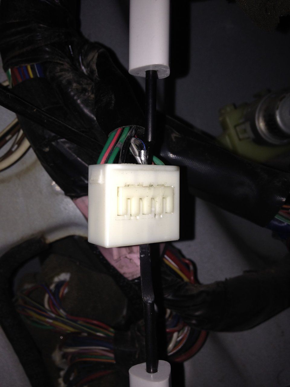

Worked on the 7-pin mod tonite. This plug is a little more complicated than others. To release, first pull up the retainer on the side and then use an electrical pin tool to release the pin from the wire side. After that push through the back. I then used some heat shrink to cover the terminal. It's the small black wire with the blue stripe. Also, found a plug in there not going anywhere. Anyone know what it's for?

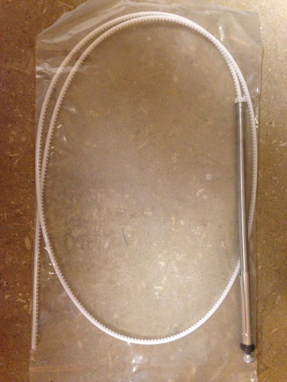

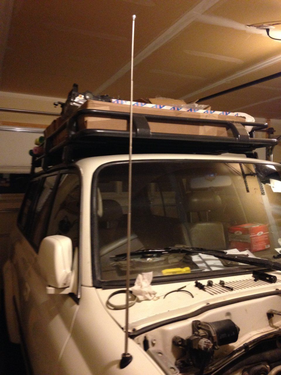

Replaced the antenna mast tonite. Mine required disassembly to remove the old broken plastic cable. I used this link to help: www.spokanister.net/vehicles_antenna.htm
I'm wondering if having the antenna loose will make the snorkel install easier.

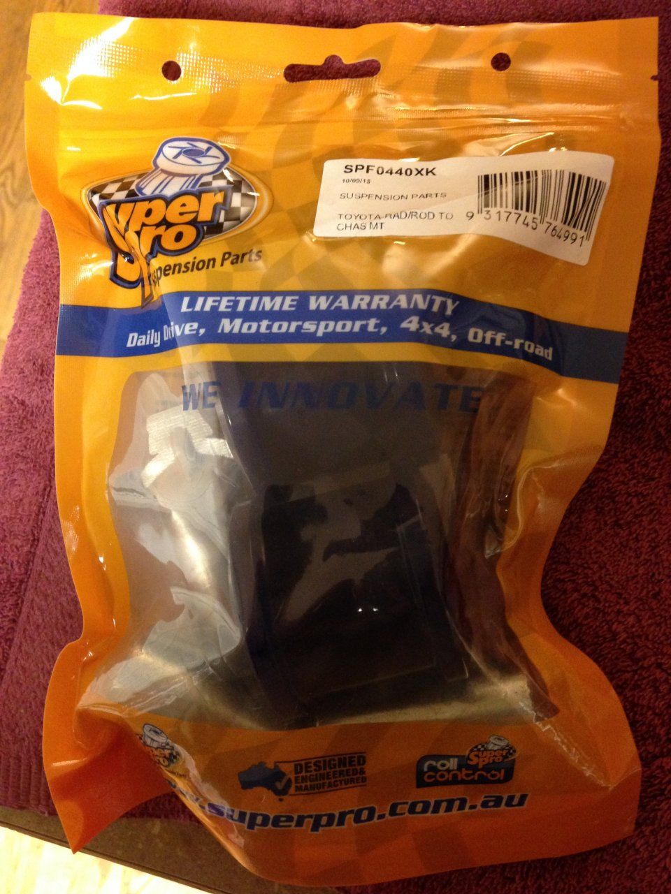

I ordered some offset front radius arm bushings that can be used to push the front axle forward 8mm to squeeze larger tires in easier per Darren McRae's recommendation from www.auto-craft.com.au These will go in with the upcoming e-locker axle swap.

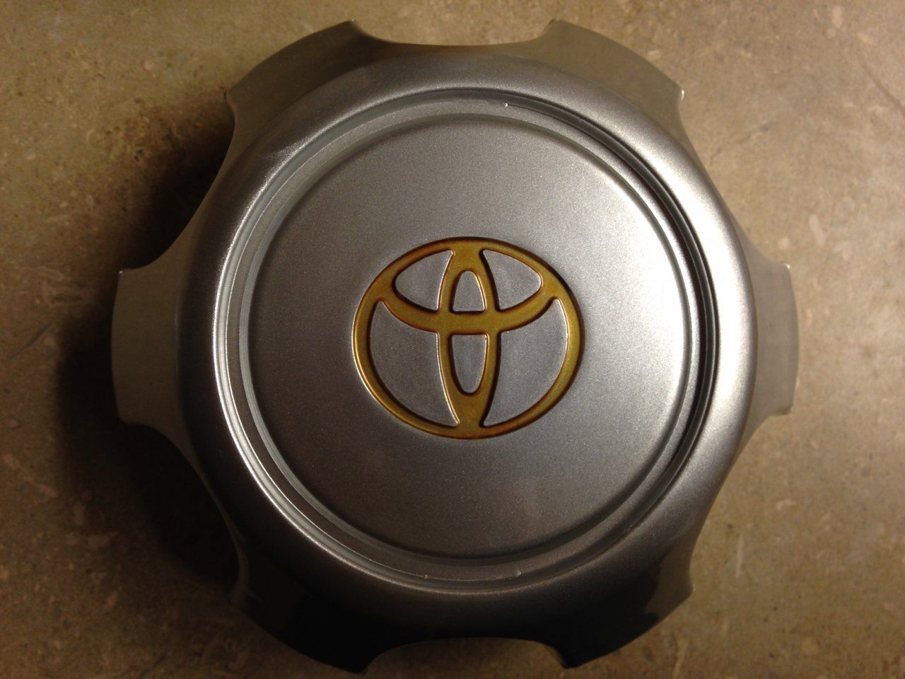

Latest treat for the truck. A new set of hub ornaments.
View attachment 1194550 View attachment 1194551 Worked on the 7-pin mod tonite. This plug is a little more complicated than others. To release, first pull up the retainer on the side and then use an electrical pin tool to release the pin from the wire side. After that push through the back. I then used some heat shrink to cover the terminal. It's the small black wire with the blue stripe. Also, found a plug in there not going anywhere. Anyone know what it's for?
I solved this by just cutting the wire. Easier than undoing the connector and I don't think anyone will ever want to undo the 7 pin mod. If so, easy enough to solder it back up and shrink it.
