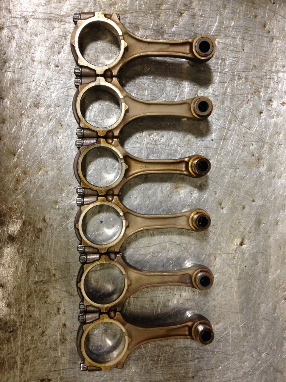

Received some rods in the mail yesterday. Thanks ginericlc! Dropped them off at the machine shop today. One step closer to collecting the parts I need. Trying to decide on pistons. Go stock or ITM, DNJ, or Safety seem to be about the other options short of something like JE. JE would be 8.5 to 1 compression.View attachment 1129476

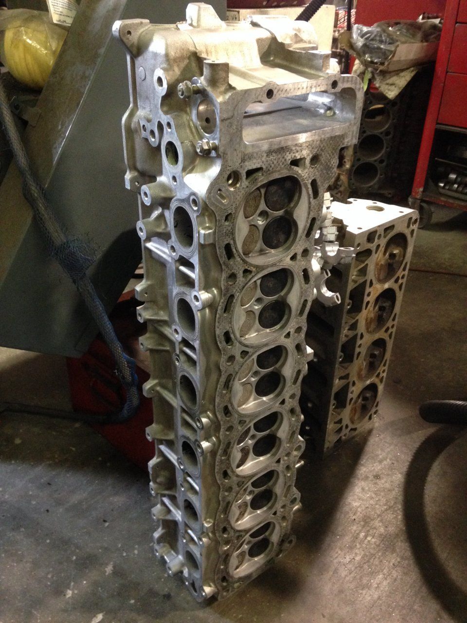

The used head arrived Friday night, thanks ginericLC. Took it to the machine shop and no cracks found and head straight on preliminary check.

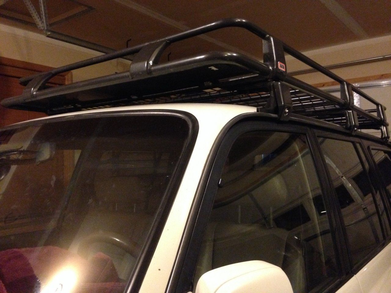

Installed an ARB roof rack with some friends today. I really like the classic look and gray paint with my collectors edition.

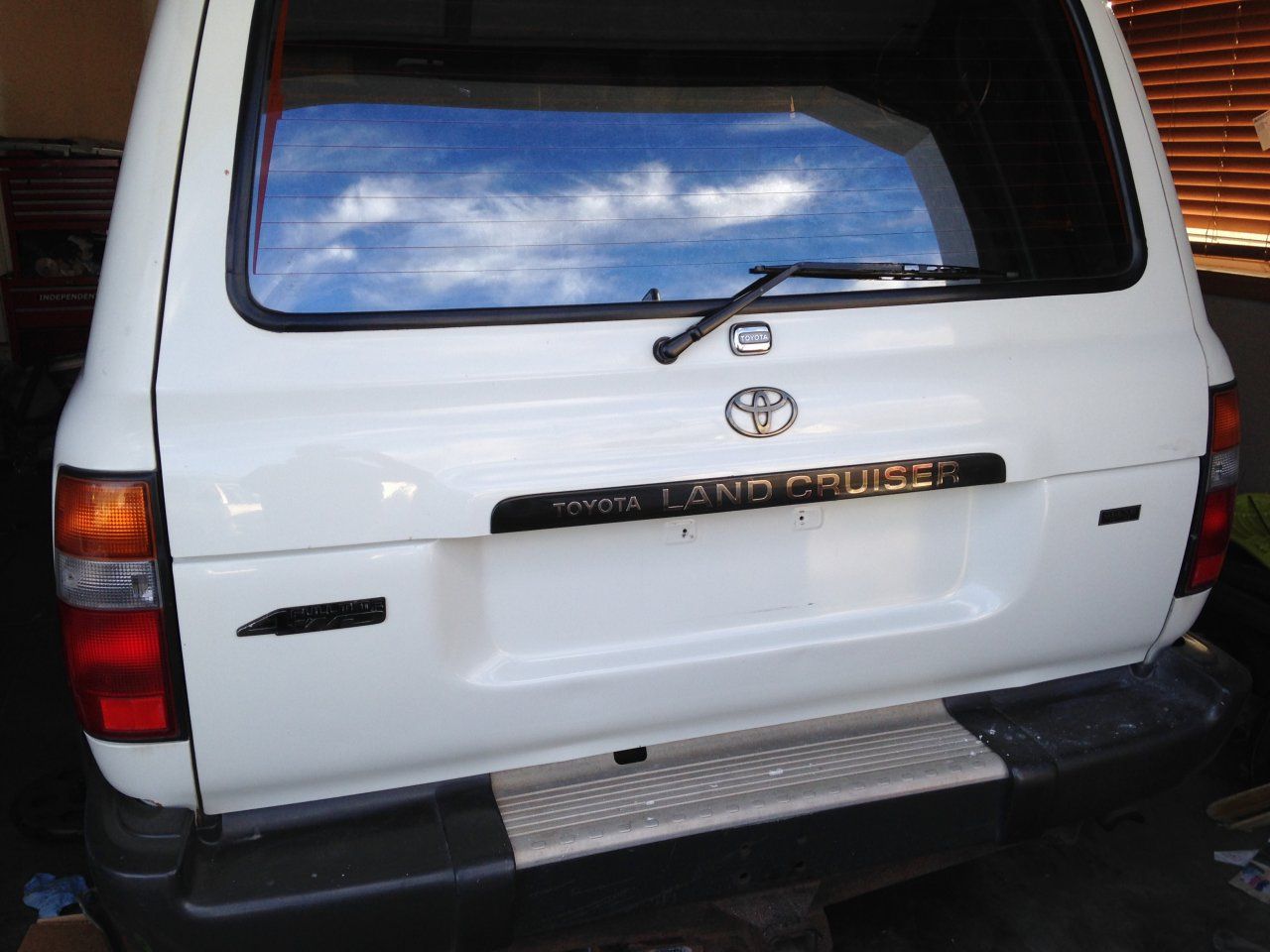

Removed the dealer sticker off the tailgate. Looks better.
Head cleaned. Looks good!

It's the machine shop. He said he's had a lot of comments from people on my head like what is that? Toyota makes a big inline 6, 24 valve head? Wow!
