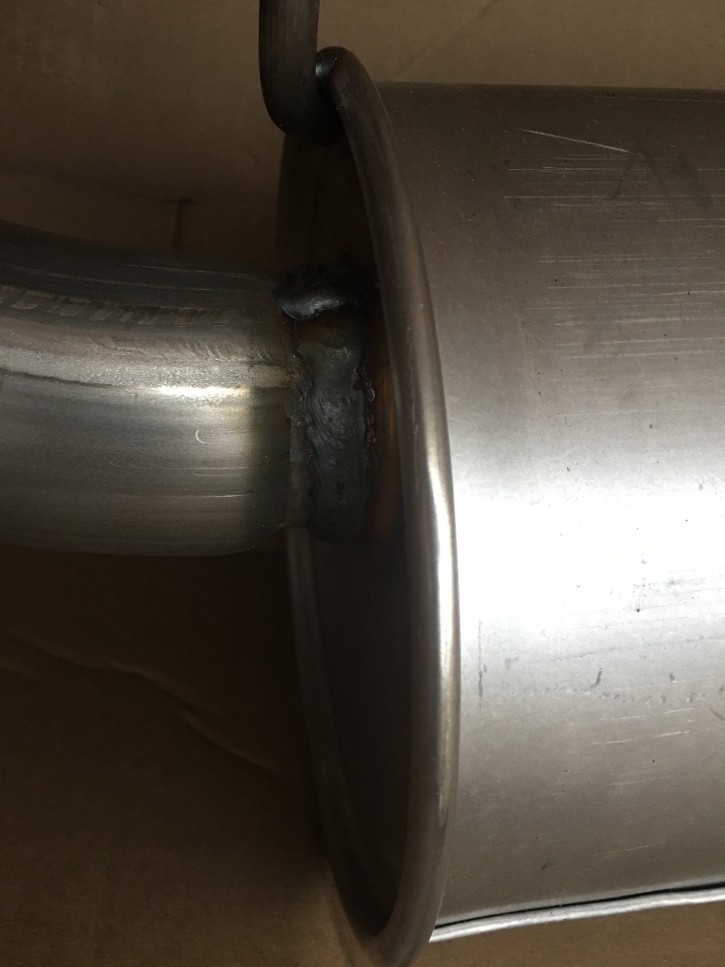

Back to the drawing board on the exhaust system. Kudos to AutoZone for taking the front Bosal Y-pipe/cat and rear resonator back after so long. After reading various threads since purchasing and my own comparisons there were multiple issues that I didn’t want. The y-pipe bottles down into a smaller pipe than stock and like other threads didn’t line up to the exhaust manifolds. I did like the Tacoma style Cat that was smooth without sharp edges. I recently picked up the Bosal muffler and discovered it has donut gasket grooved flanges like stock when the other Bosal pieces didn’t. The muffler though bottled down to 2 inch possibly even smaller depending how the weld was done. Best I can tell the exhaust system was originally designed as a 2 1/4” system. I plan on returning it as well. I had picked it up from Advance.
The rear resonator was probably the best piece since it doesn’t have the factory crimp above the rear axle. But the resonator is a different design. Not sure it is much more than expanded pipe. All in all the quality control seemed lacking. I think I want to go stainless out of the motor at least.

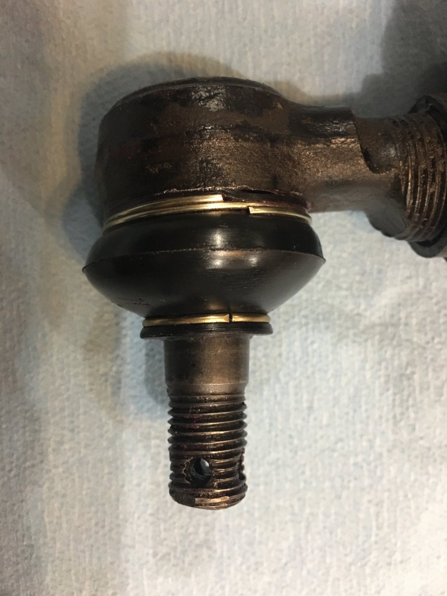

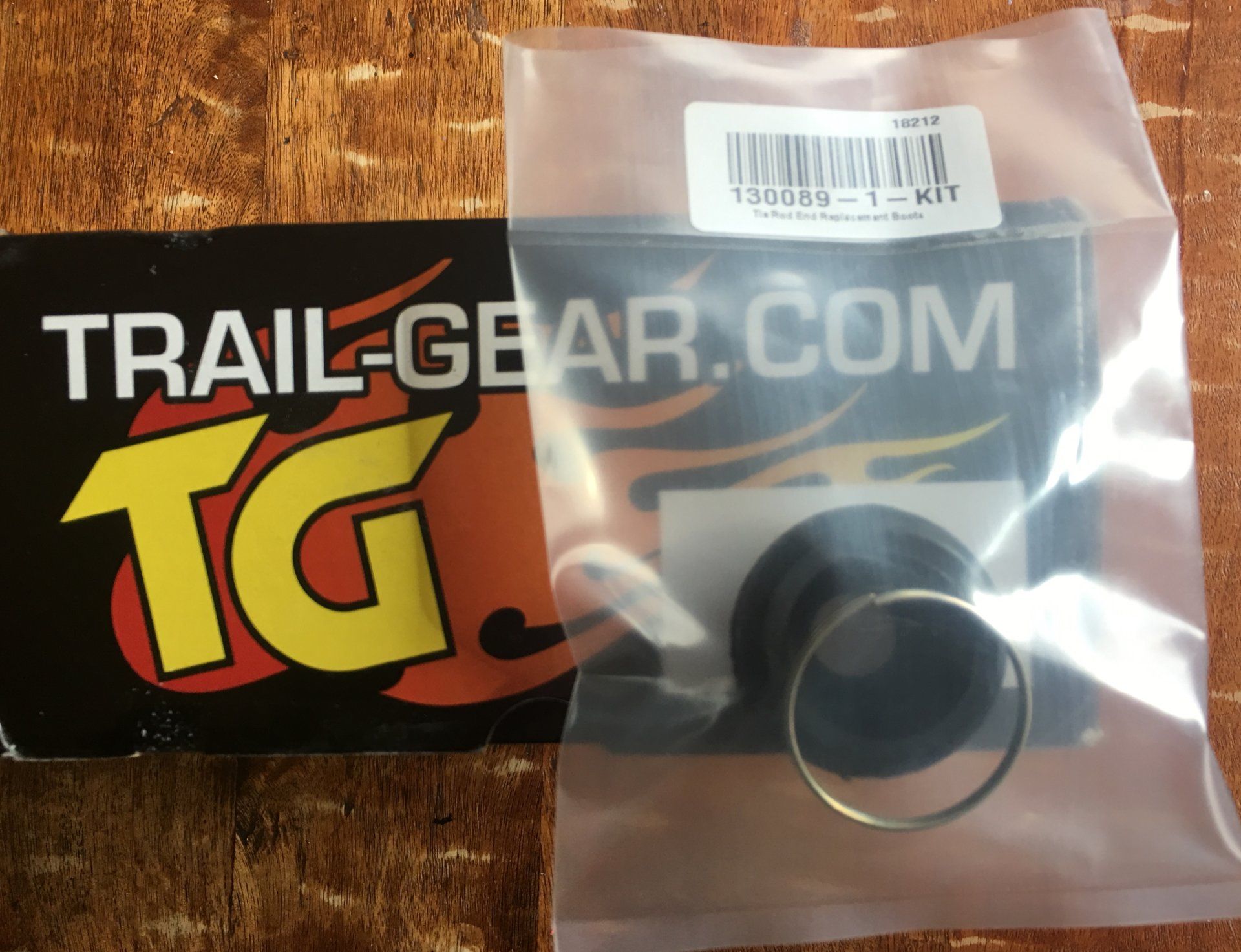

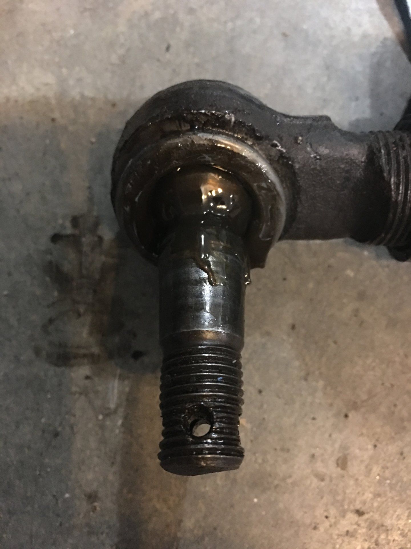

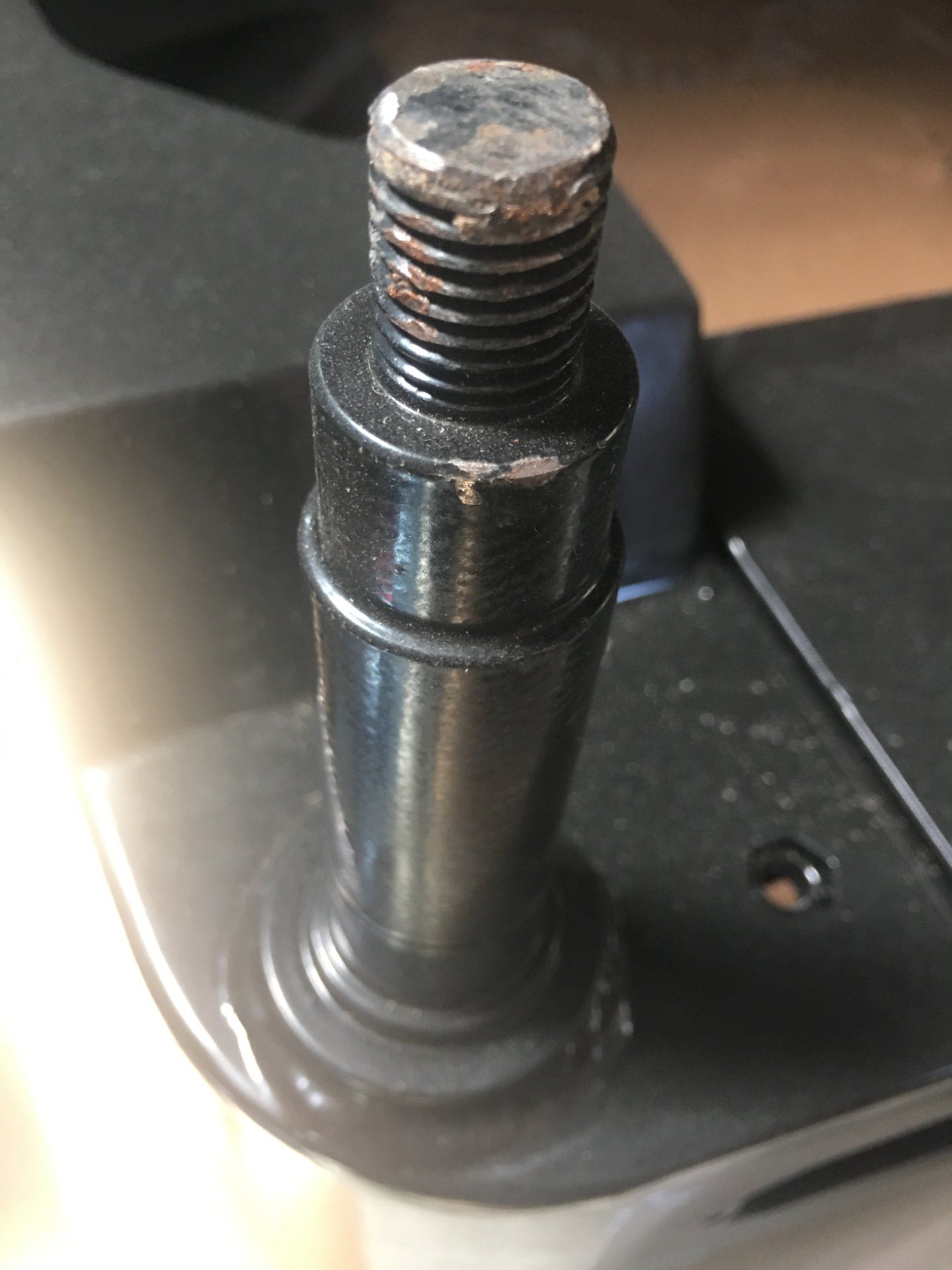

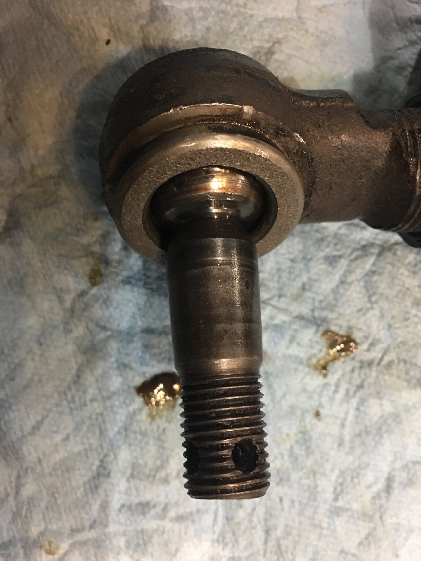

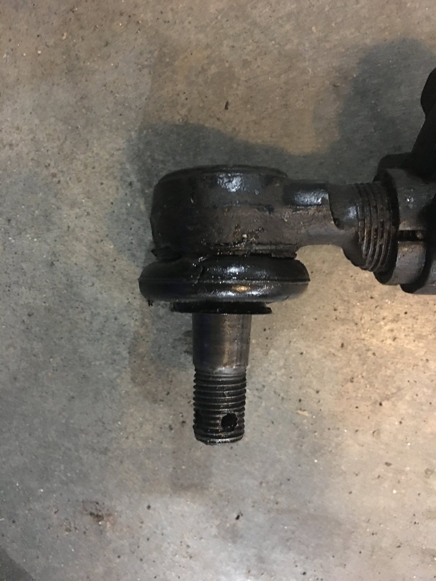

Inspected the tie rod ends and all is good except for one boot. Decided to save the tie rod kit for down the road and purchased a replacement boot.

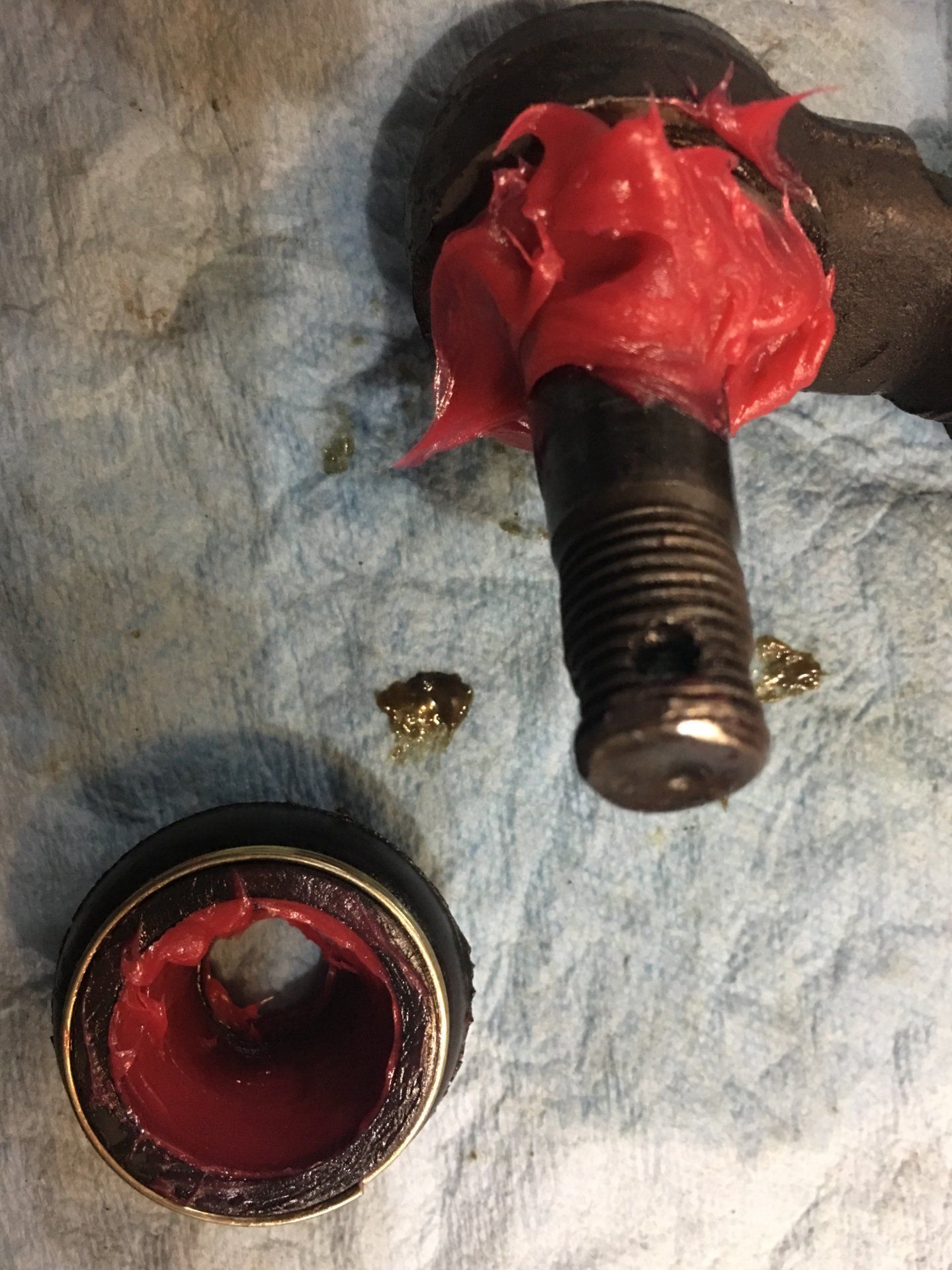

Installed the boot tonight. Just used a large screwdriver under the large spring to pop it off. Cleaned out the original grease and added some new grease working it in the joint. Installed the new boot by hand with the springs on by gently turning it over the groove until it popped on and the spring was on straight.

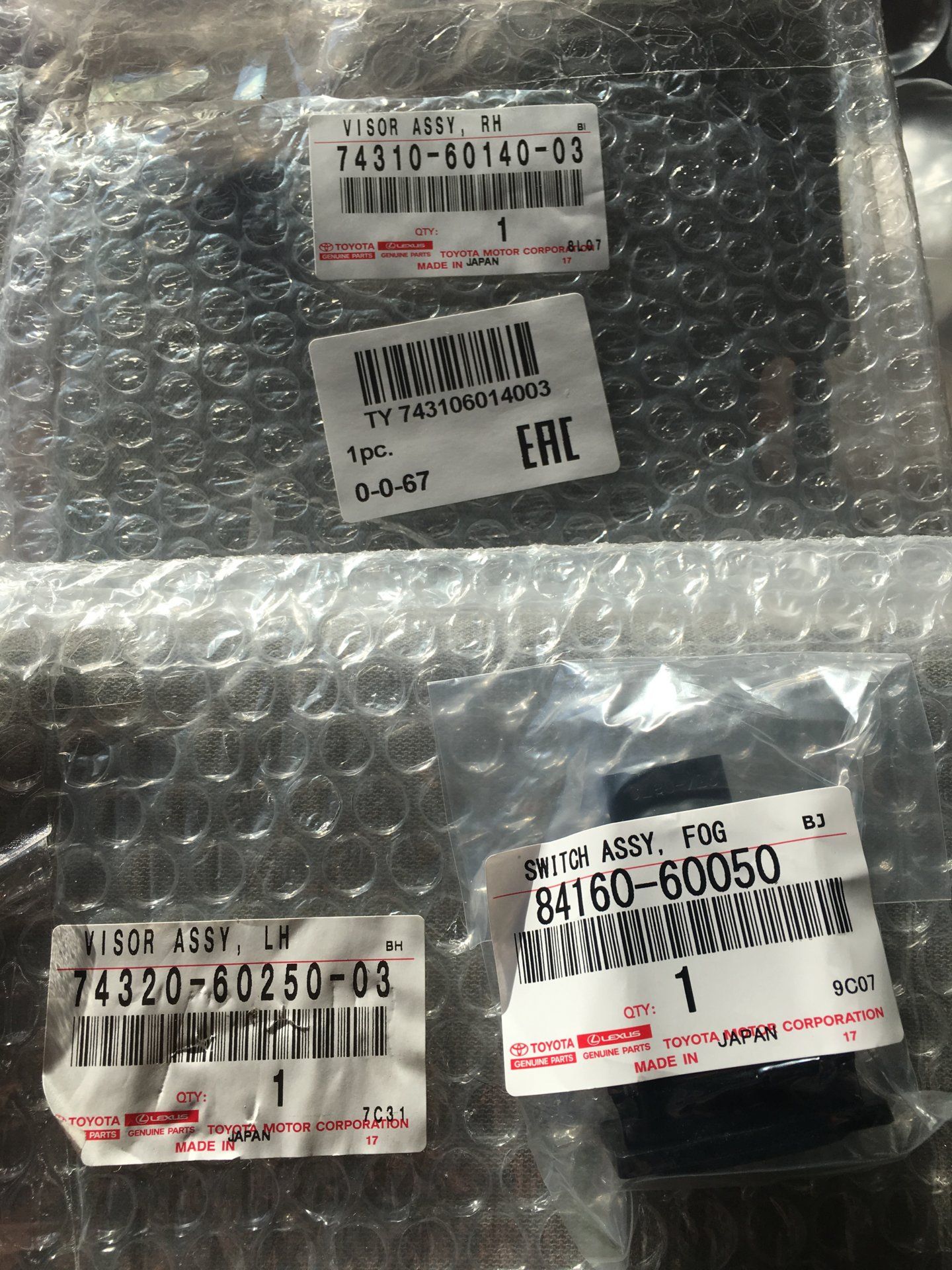

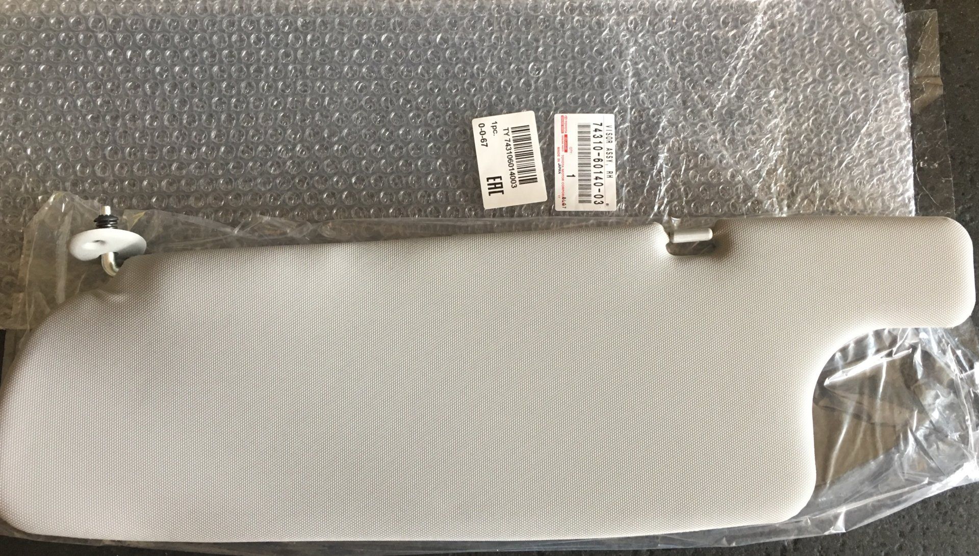

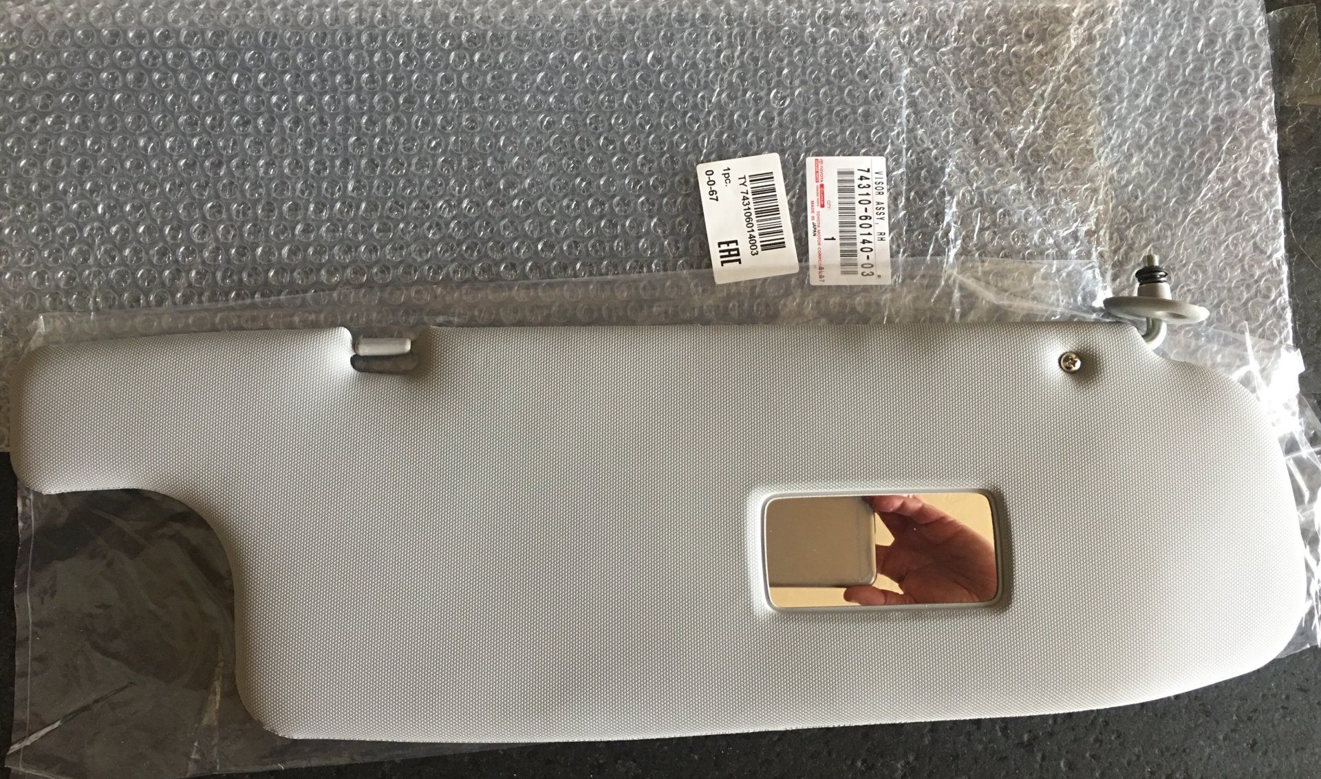

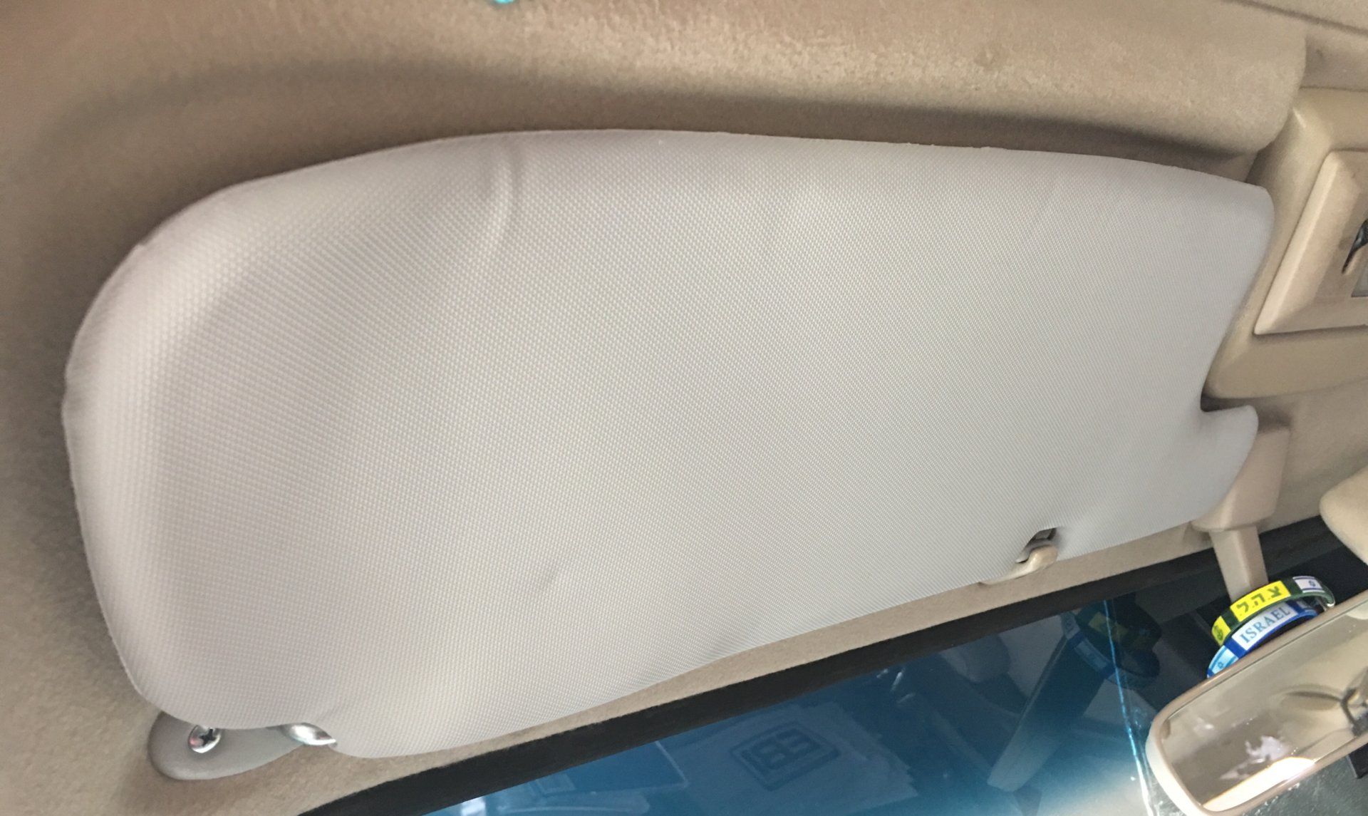

Decided to pick up a factory fog light switch and some poverty pack visors. I think I will store the oak visors for now.

Here you go. They are gray. But, I figured for availability and fitment new well...

Back to the drawing board on the exhaust system. Kudos to AutoZone for taking the front Bosal Y-pipe/cat and rear resonator back after so long. After reading various threads since purchasing and my own comparisons there were multiple issues that I didn’t want. The y-pipe bottles down into a smaller pipe than stock and like other threads didn’t line up to the exhaust manifolds. I did like the Tacoma style Cat that was smooth without sharp edges. I recently picked up the Bosal muffler and discovered it has donut gasket grooved flanges like stock when the other Bosal pieces didn’t. The muffler though bottled down to 2 inch possibly even smaller depending how the weld was done. Best I can tell the exhaust system was originally designed as a 2 1/4” system. I plan on returning it as well. I had picked it up from Advance.View attachment 1937467

Where did you find the visors and what did they cost you if you don't mind me asking?
Amayama. Don’t have the cost in front of me right now as I had ordered quite a while back.

All of the parts were available when I ordered from Partsouq. I order from all kinds of places to locate parts. The fog light switch was the most difficult to get.

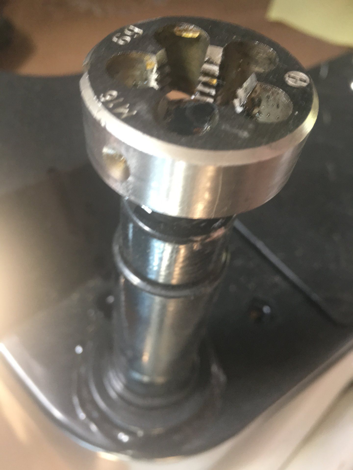

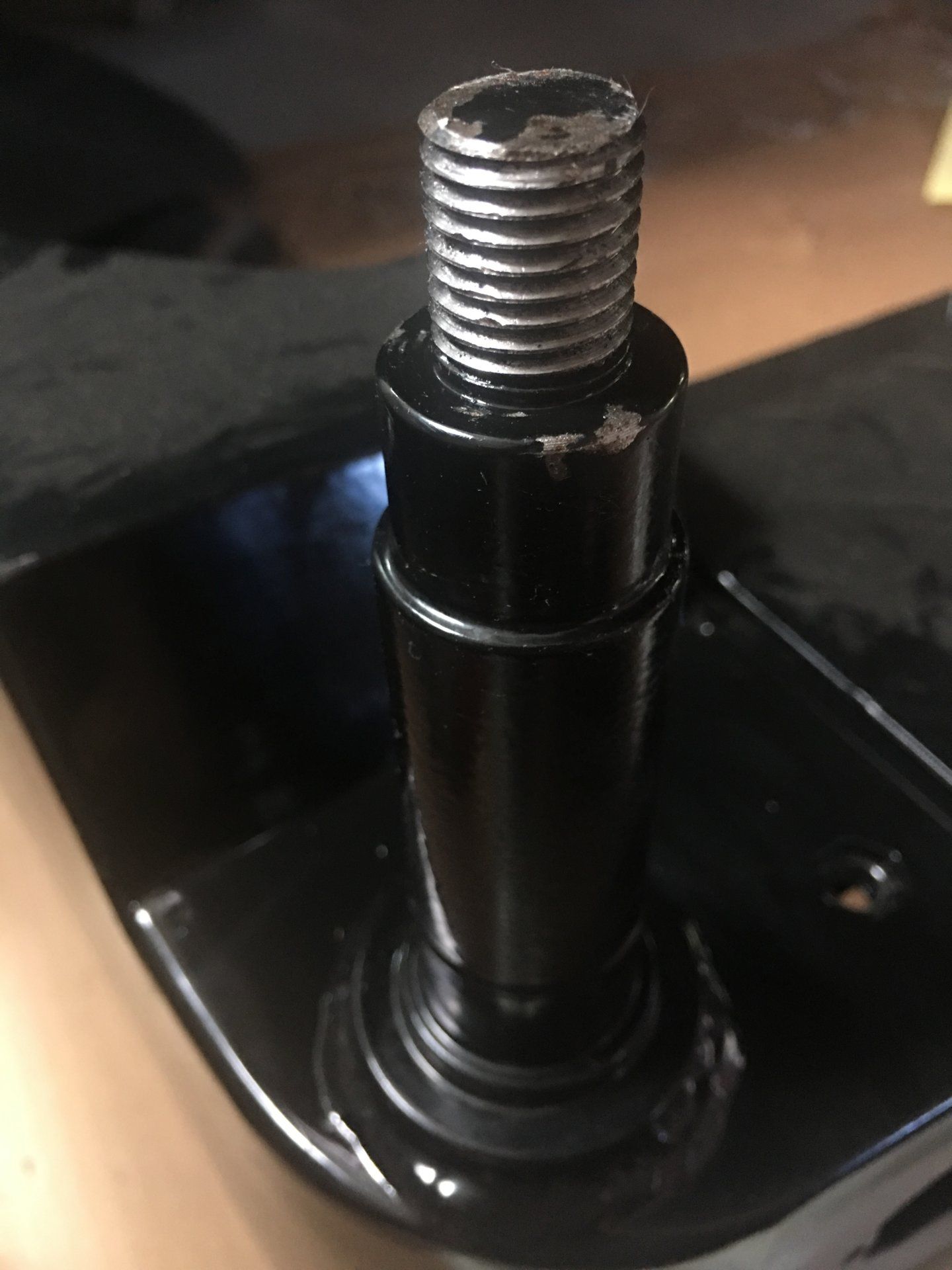

The rear bumper I picked up had the swingout arm threads damaged in shipping so I picked up a tap and die set for it. It turned out to be a 16x2.0mm. Clean up turned out real good.

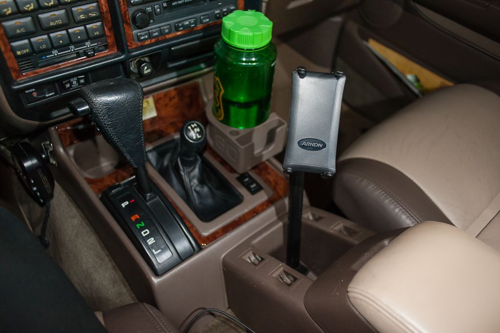

Thanks to @LC4LIFE his custom device holder is relocating to my 80.
