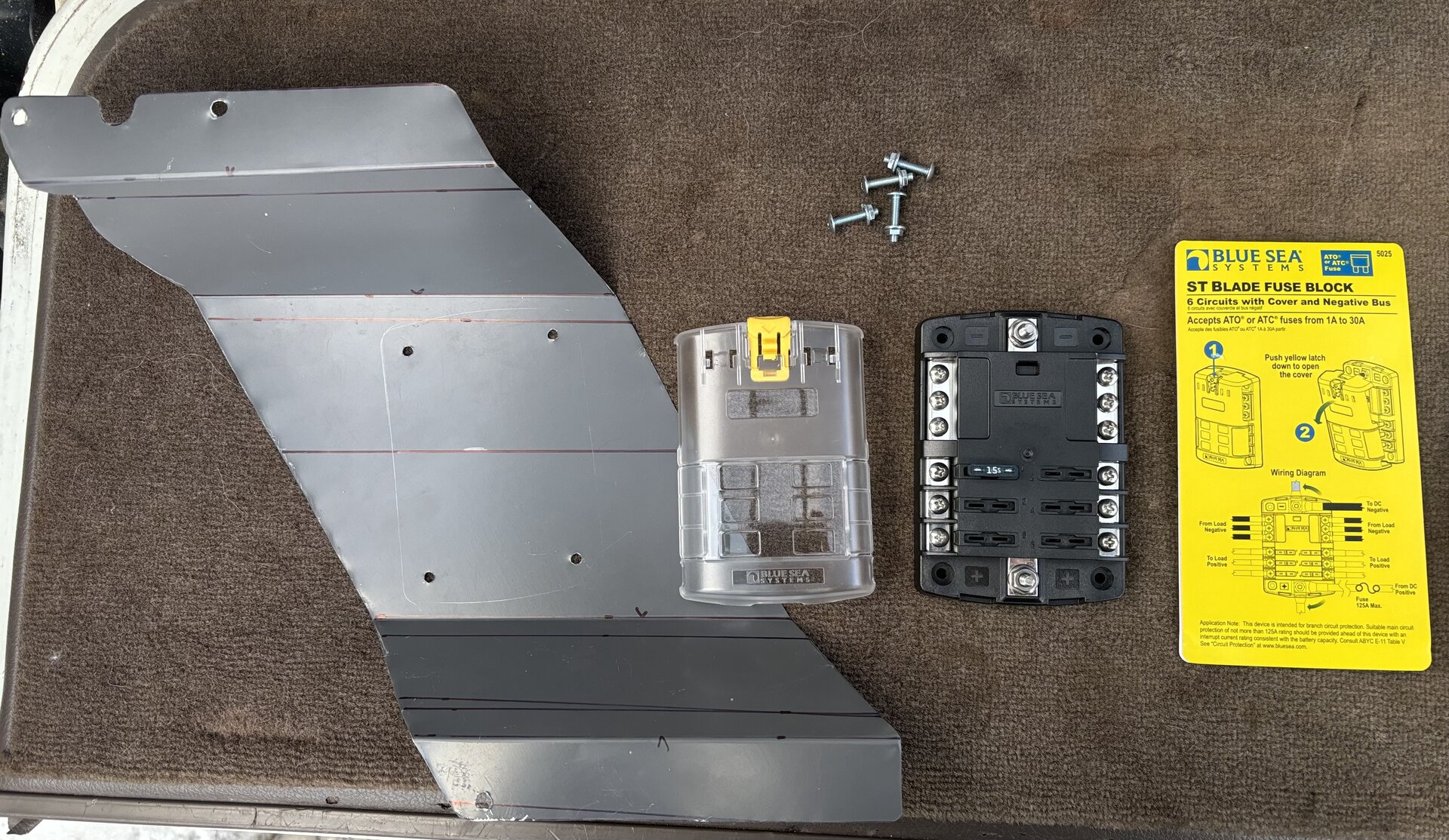

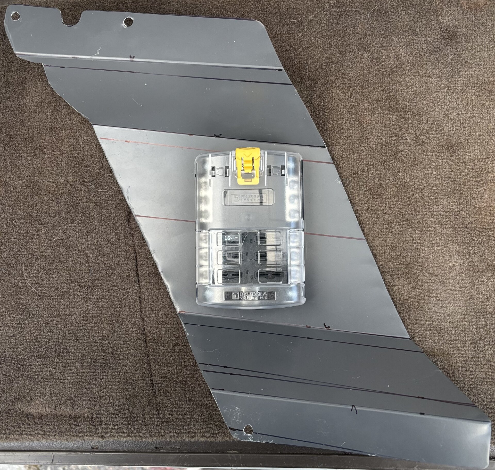

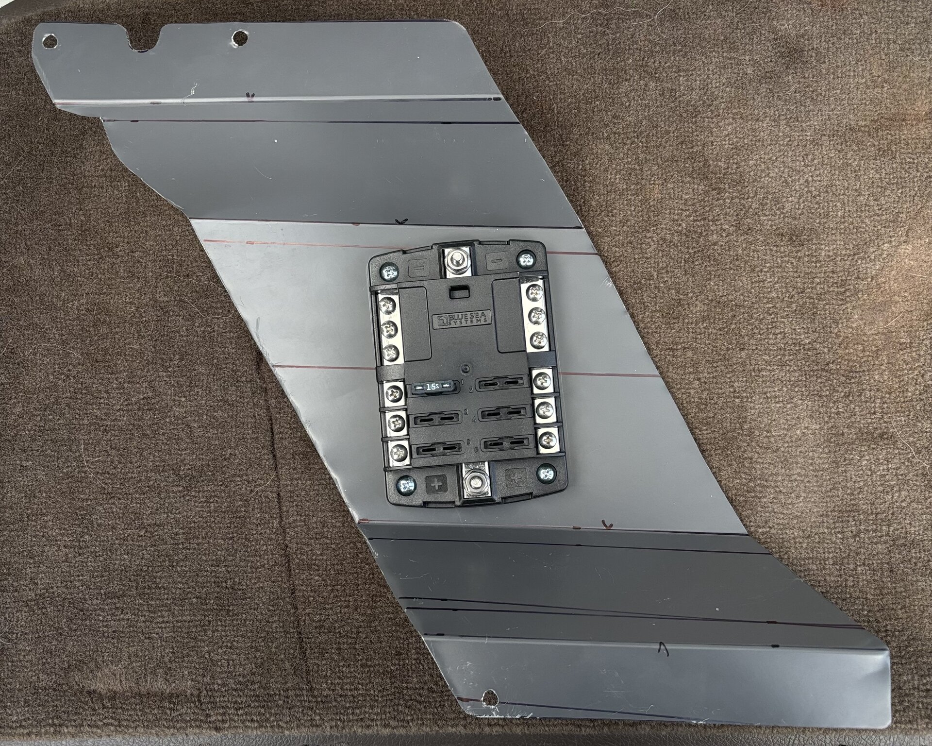

Decided it was time to run power to the passenger rear quarter panel and install a fuse box as I’m running several accessories coming up. A friend used a brake to make a panel to bolt in the factory holes just behind the back seat. Purchased a Blue Sea 6 circuit panel. Didn’t want to take a chance on burning the rig down with some unknown brand quality.

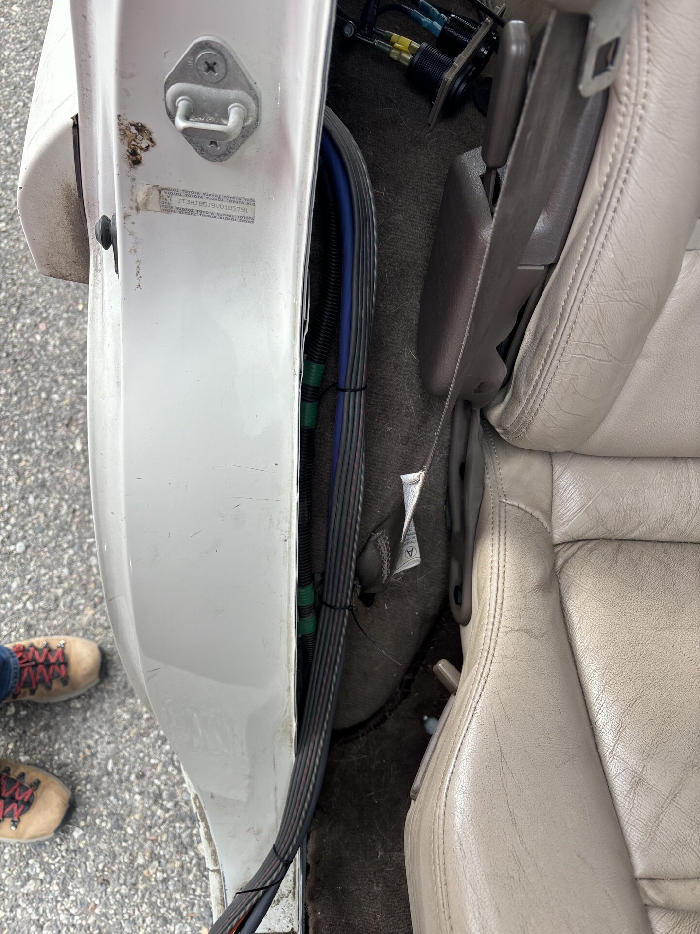

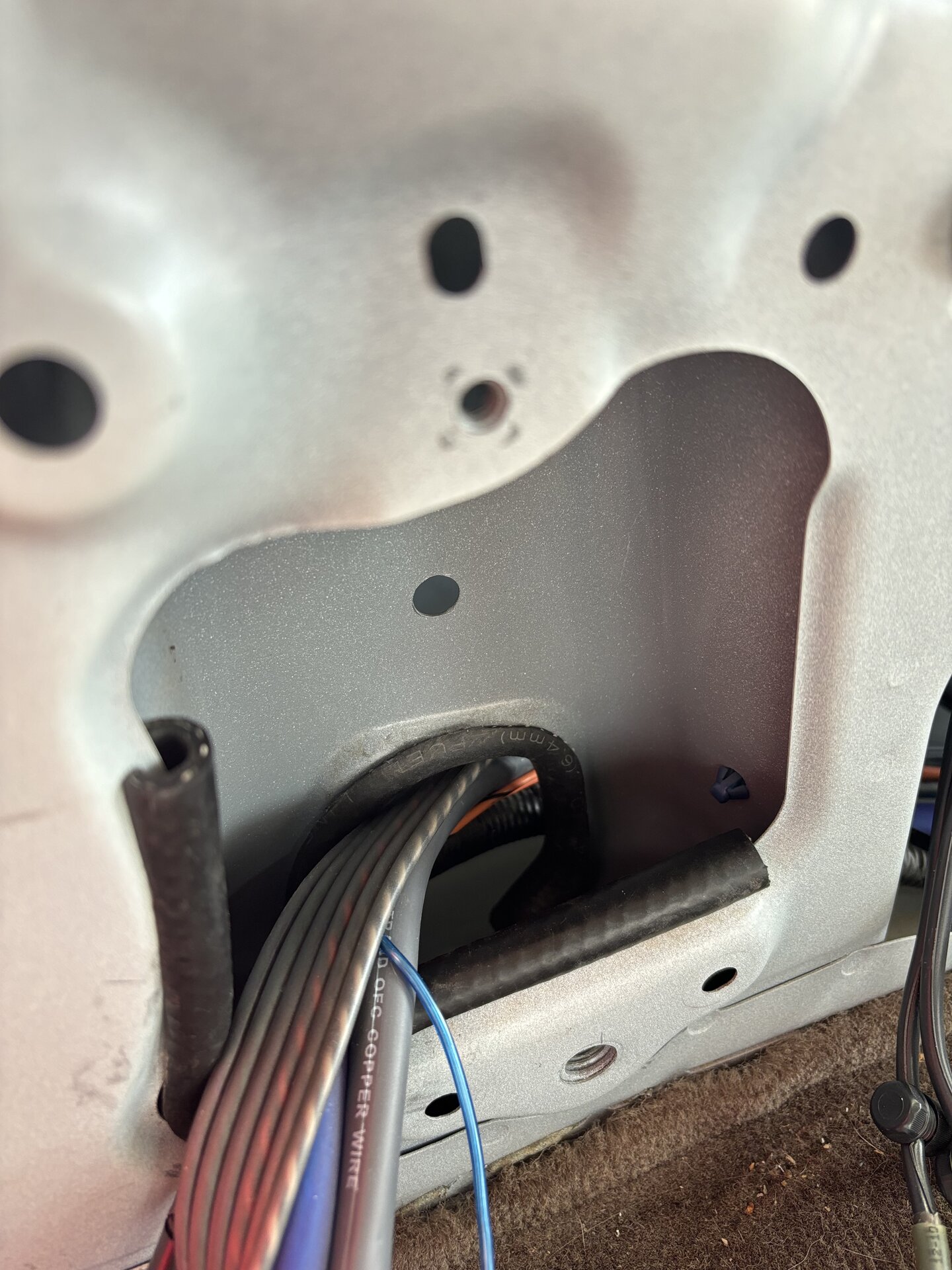

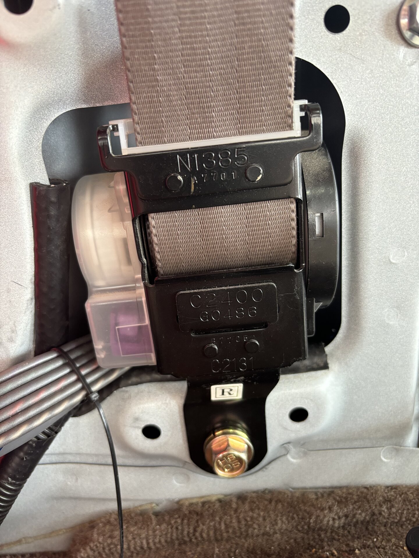

Panel installed and I cut some old hose I had lying around to protect the wires from chasing. Even if you don’t add anything in the back, there is one factory loom that comes out under the seatbelt behind the passenger rear door that can get cut on this metal it exits.
Ended up having to remove the mount as it didn’t clear the panel. Decided to use double sided weatherstripping tape to attach it to the sheet metal. Bolted the ground through the back of the nut for clearance as well.

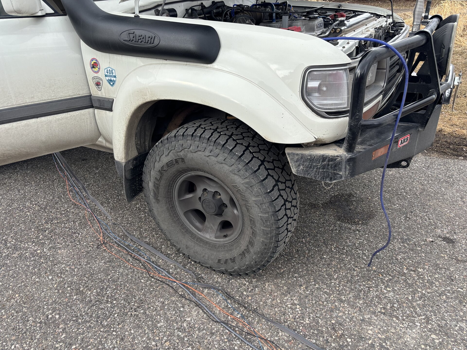

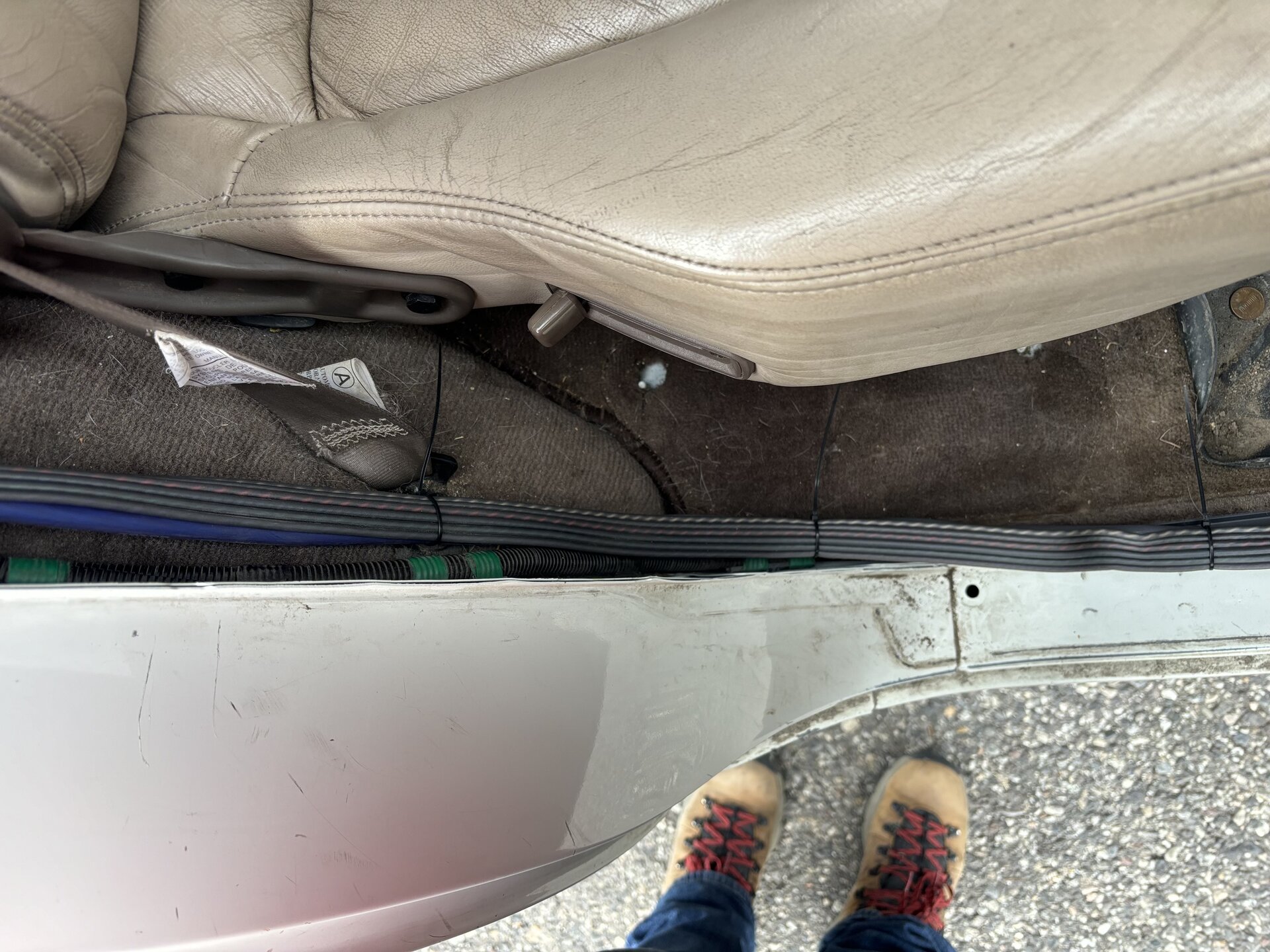

Running wire from the back of the vehicle to the front is a bit of a chore. Neatness buys real estate with space. Use lots of zip ties. I couldn’t do this without my little helper.

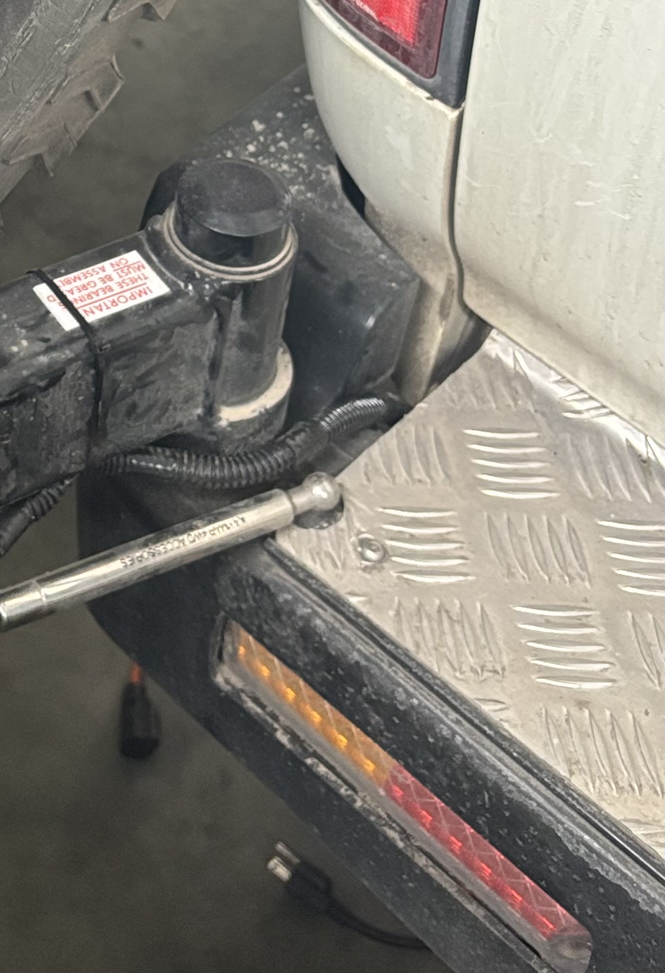

For anyone who has added power in the back quarter panel and needed to run power to your rear bumper for a camp light like I have, where did you pull the wire through the body?
I originally was thinking that maybe one of those rear drains might be a good place to route wire. But after I got into it, I just took the wire down the camp light on the swing out zip tying it to the arm on the driver side. I then put it through some conduit I zip tied along the wiring harness that goes under the tailgate across the back to the passenger side where it goes in the body with a grommet since that was really close to my new fuse box in the back. I attached it there and all is well.

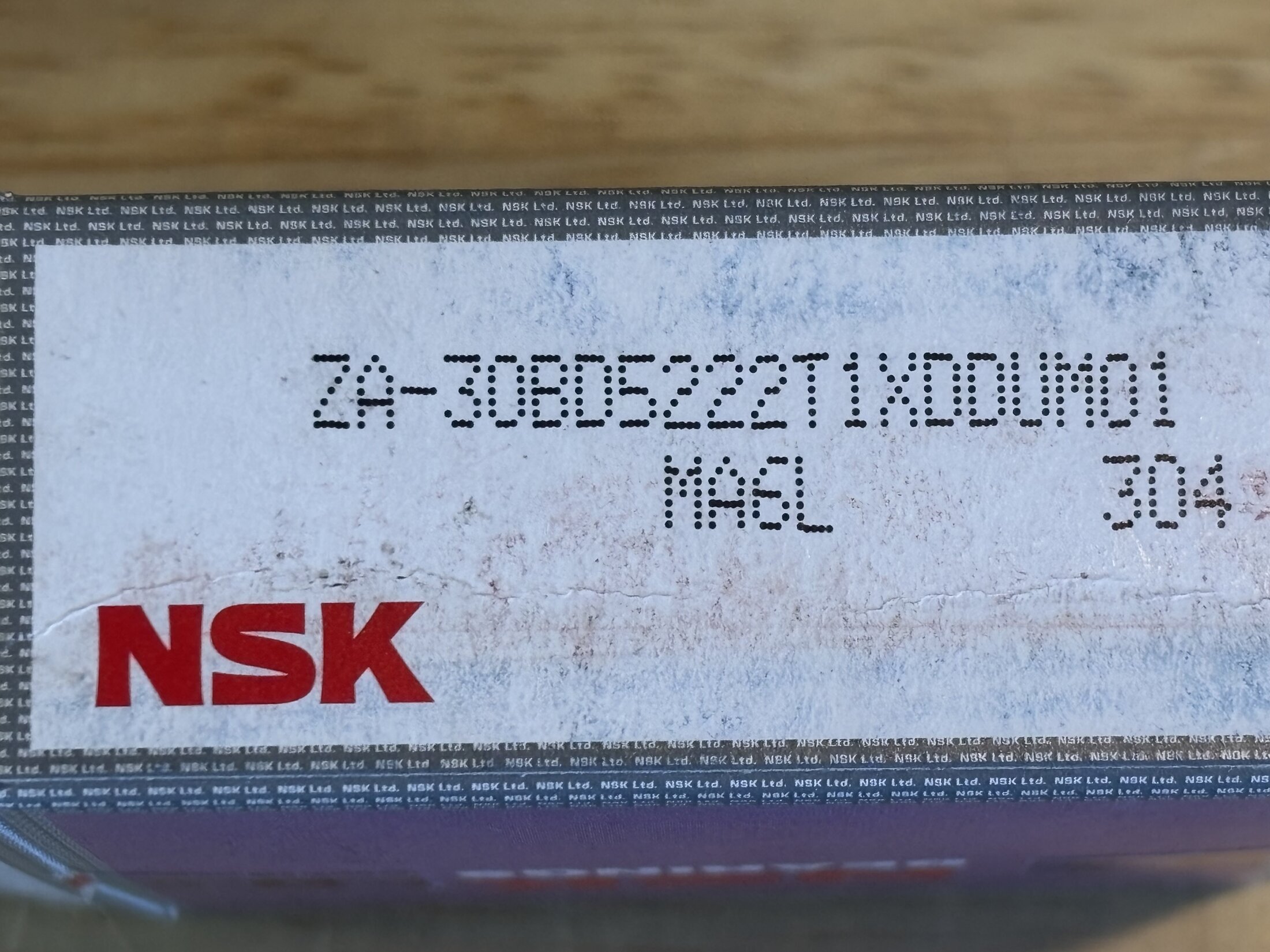

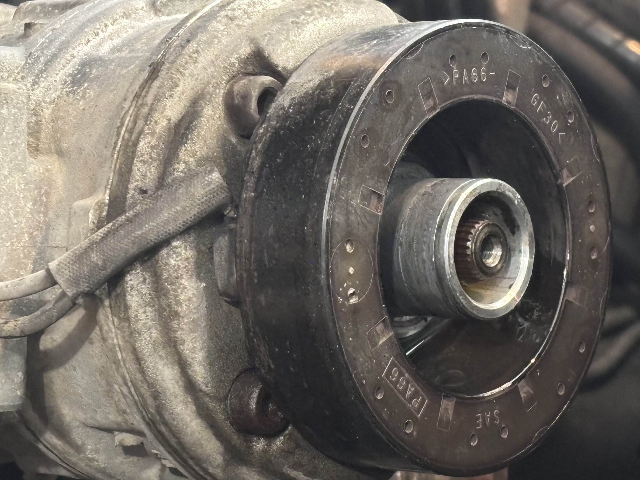

While waiting for shims, I decided to replace the compressor shaft bearing that was making some noise. Smooth as butter now as they say….
Found a NSK bearing that worked. 27ft/lbs for the compressor to block torque and 10ft/lbs for the clutch bolt.

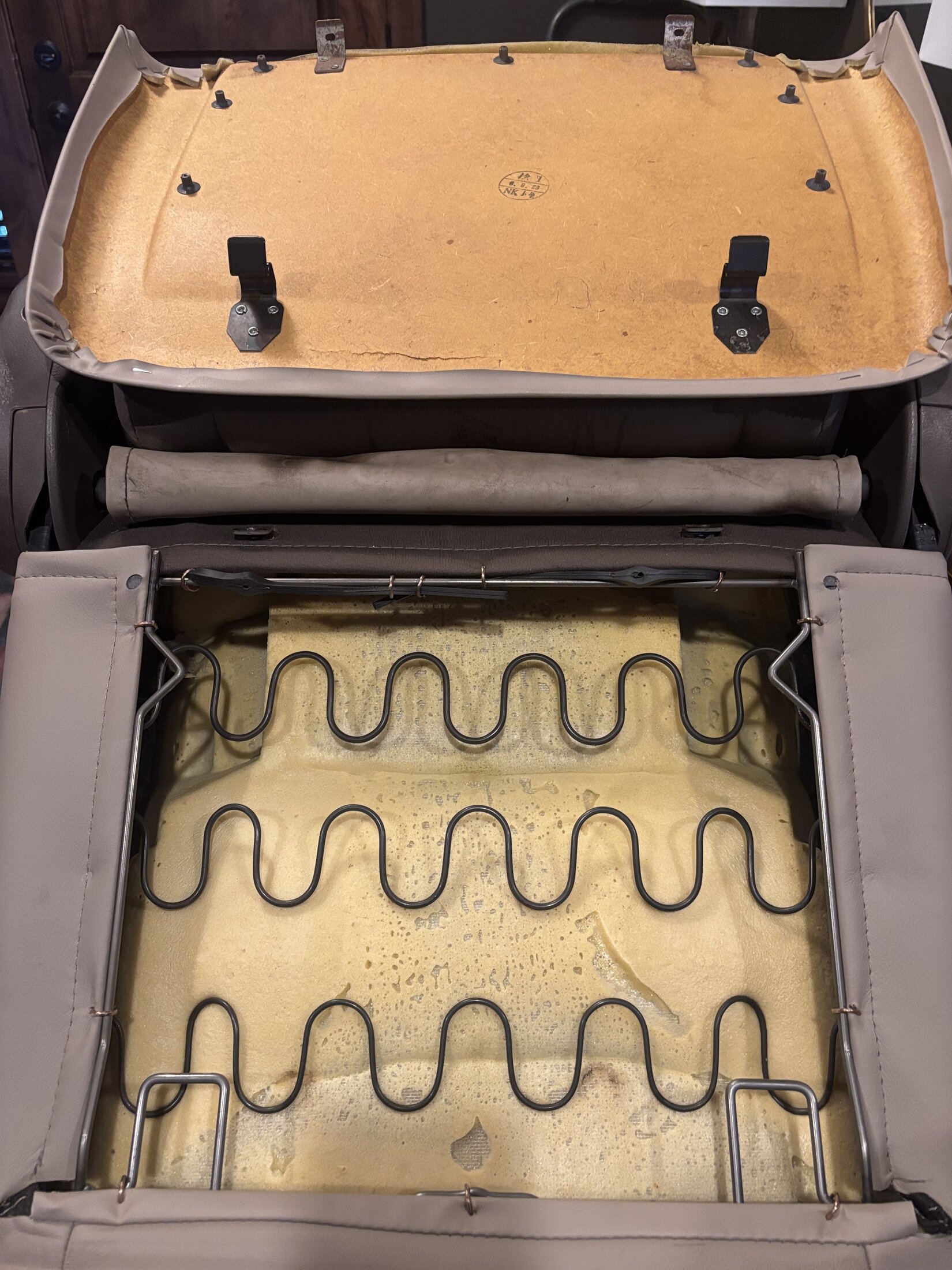

While waiting for parts I decided to finish up the seat heaters. This link was helpful for wiring diagrams.

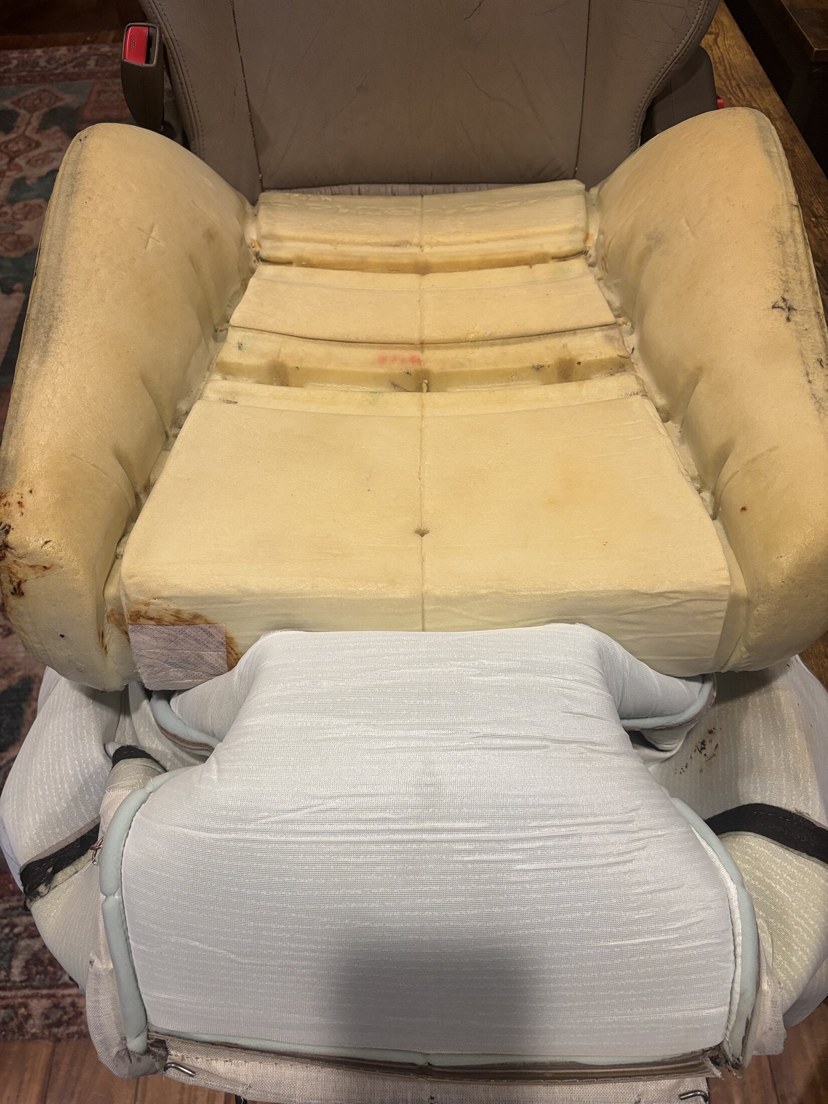

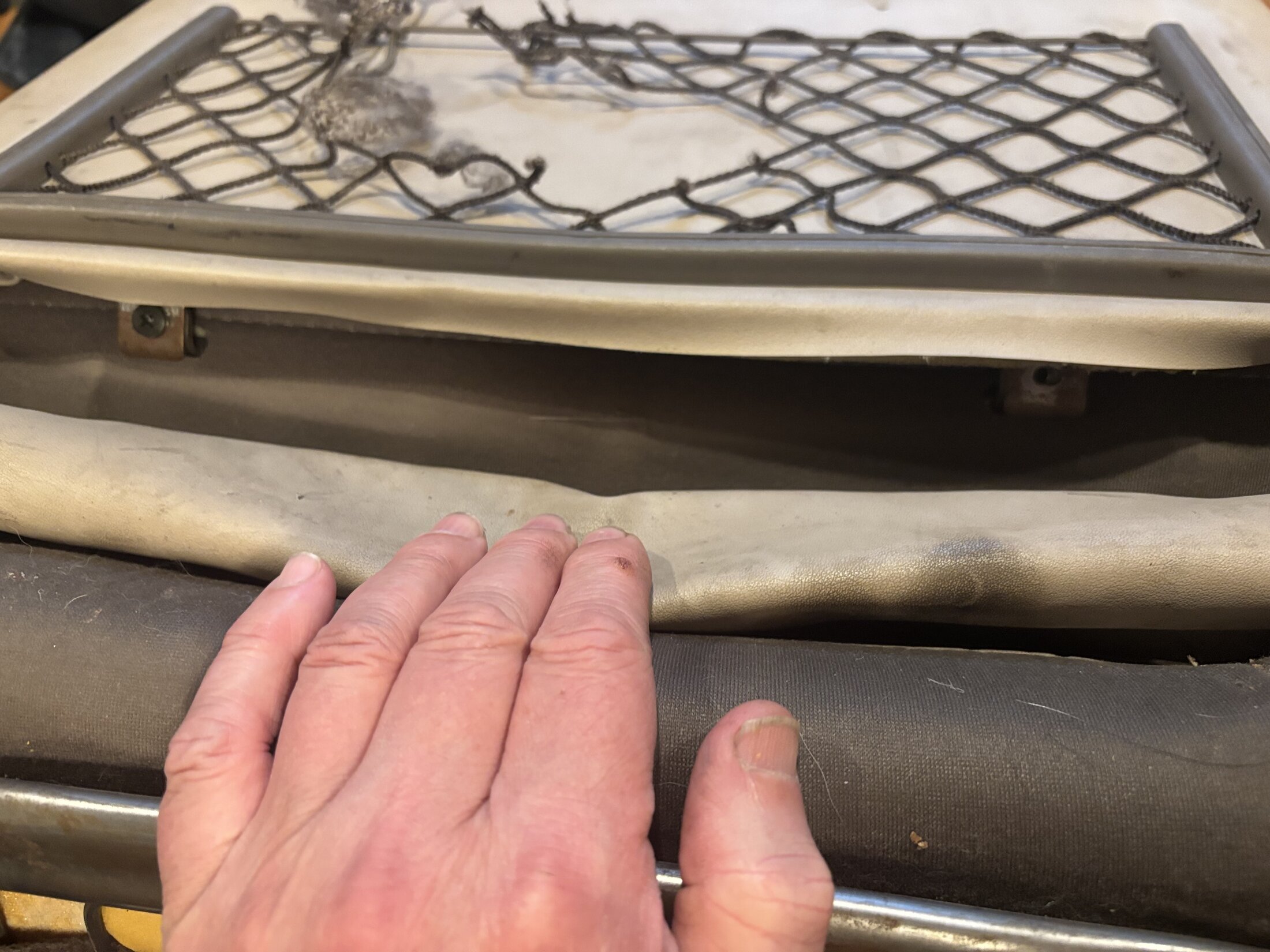

Started with removing the four 14mm bolts and putting the seat upside down on a work surface. Remove 2 bolts from the back panel and slide down to unclip. Use a trim puller to gently remove the 2 plastic clips from the back of the bottom cushion. Purchased 2 repair wire terminals to tie into the factory harness along with switches.

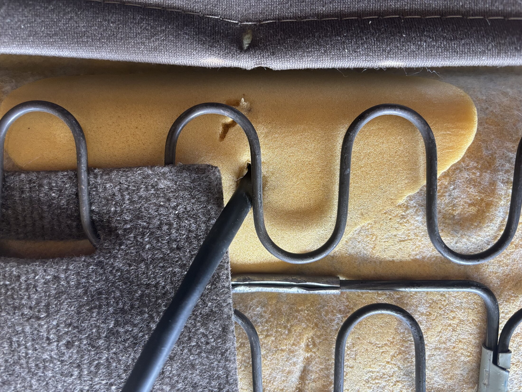

Then the fun job of removing hog rings begins. Seat heater element is taped down on foam. Punch/cut holes carefully in seat heater to line up with where the hog rings were. In this case I decided to use zip ties for reassembling. Run cable out the bottom and repeat on other cushion.
Bottom seat cushion requires removing 4 bolts holding cushion down and 3 screws on each side cover. Cushion torque is incorrect in 97 FSM. It’s 15 ft/lbs. Cotter pin tool is helpful to reinstall corner plastic retainer. Bottom cushion also has a hole pre punched that’s perfect for running the cable. It’s possible to pull the corner and not the switch side to tuck heater element inside. I used a tap for the ground. Note: heated seat ground is not a chassis ground.
One other note about heated seat elements, they came with an extra set of adhesive strips for the top and bottom. I chose not to use them as they made noise. Reinstalled and seat heat works now!
