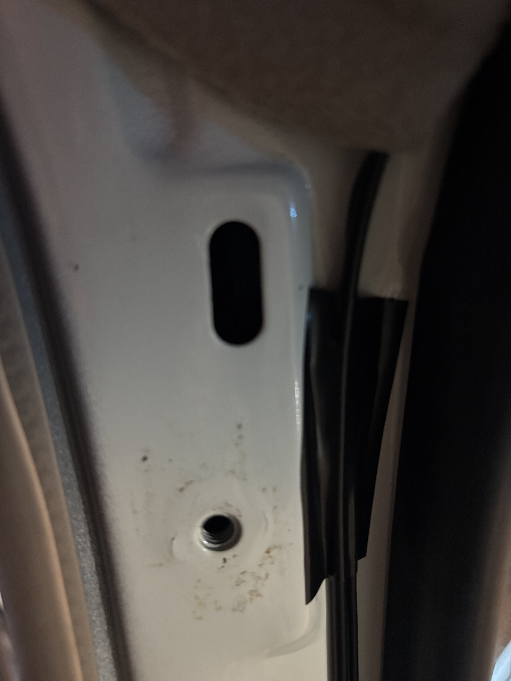

Pulled the A-pillar trim and ran the wiring down the side and behind the cluster to go with the radio harness. Used 3M tape to run the wire. Will bundle that with the usb and aux wiring in the dash I’m using and the amp wiring which is next to run on the passenger side of the dash. Redoing my power source for the Garmin as the 5V converter was producing too much noise interference for the radio at the same time.

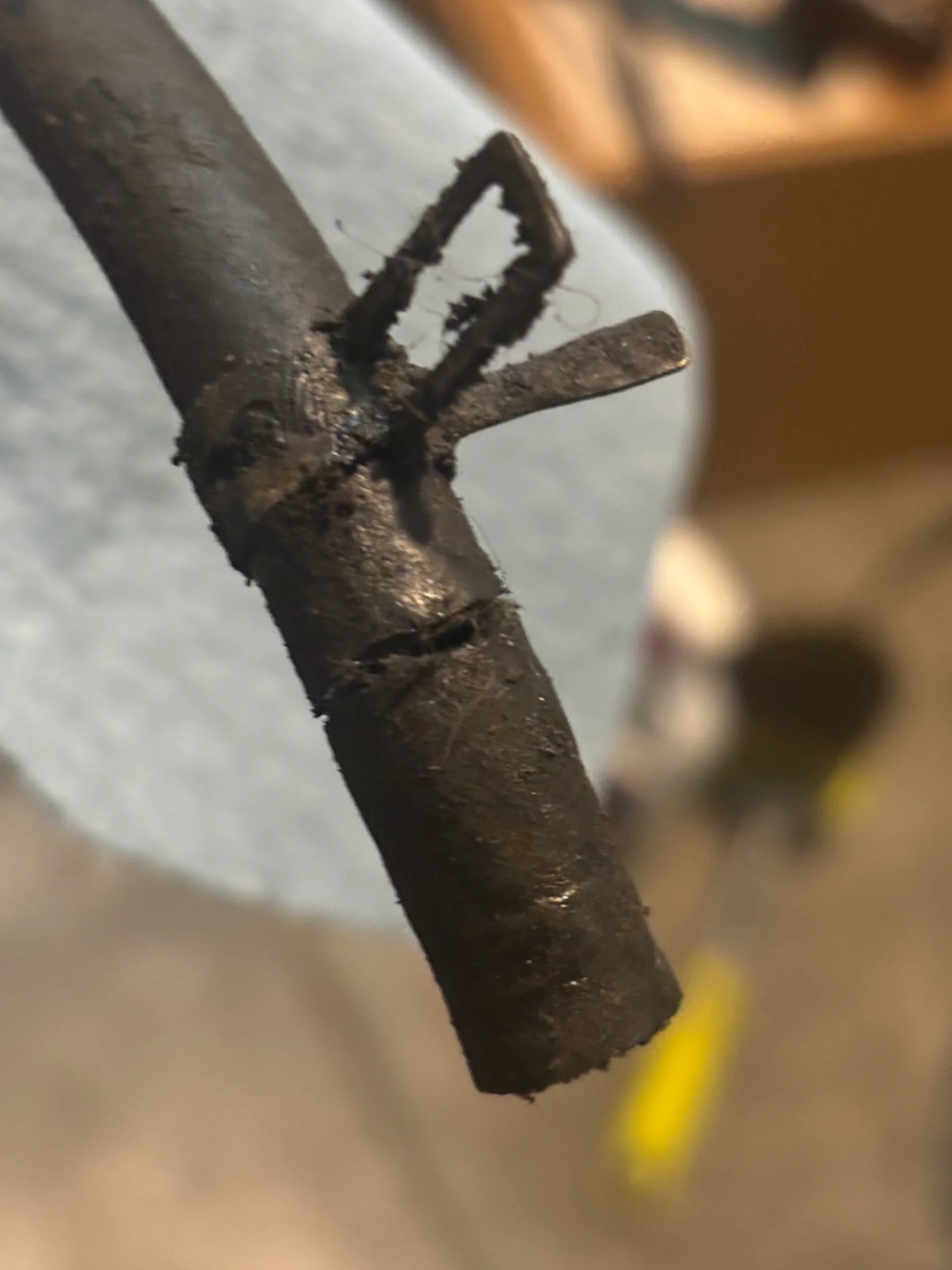

One of the maintenance items I wanted to do was check out the front axle breather hose assembly. As you can imagine it was pretty gunky after all of these years so I removed it and cleaned it up. It’s still flows air, which is good but upon checking it out, I discovered that the hose where it connects to the axle had split. So taking this opportunity to clean up the hardware really good and replace the hose with a 2” longer one for the sway bar disconnect.

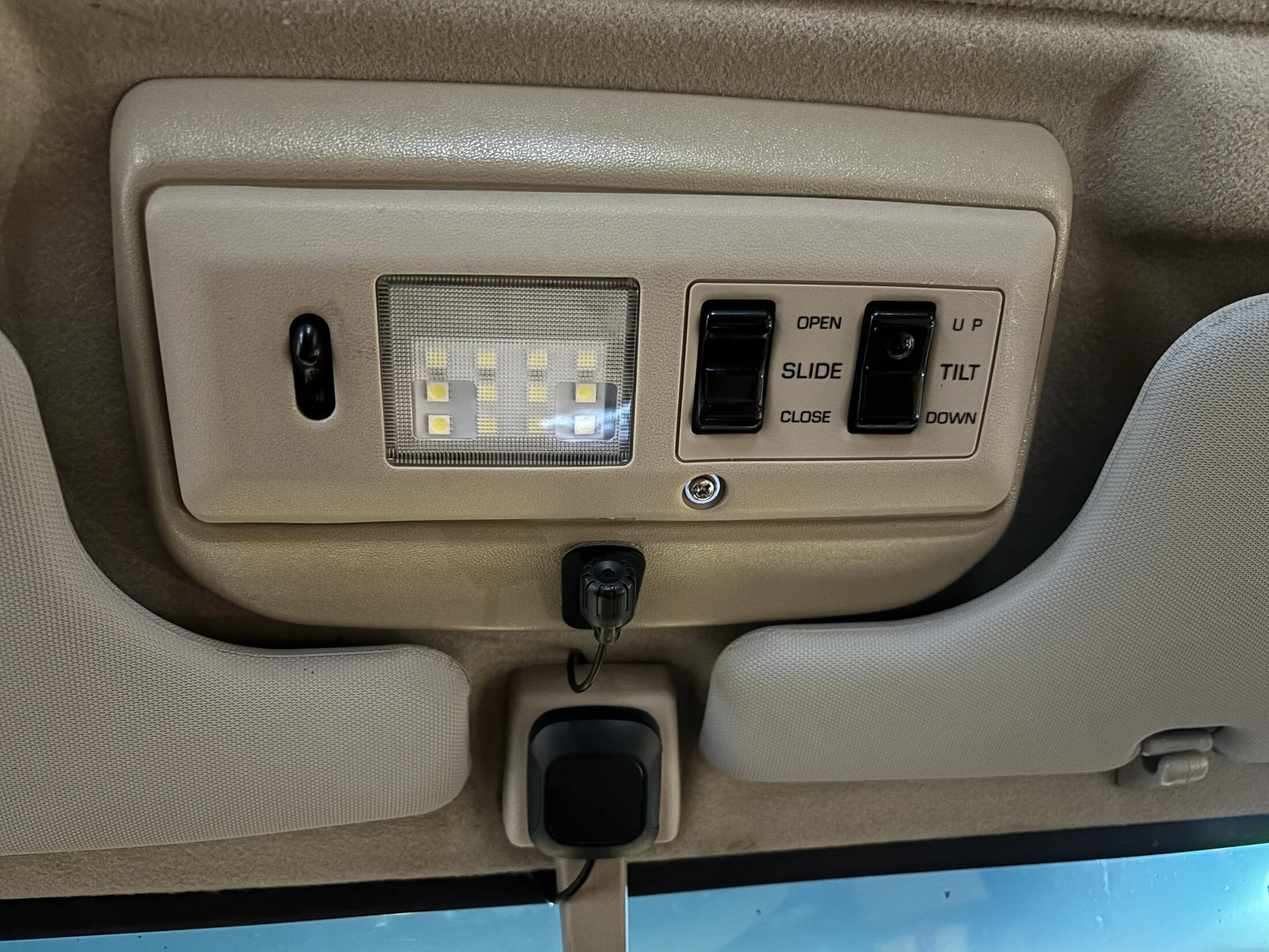

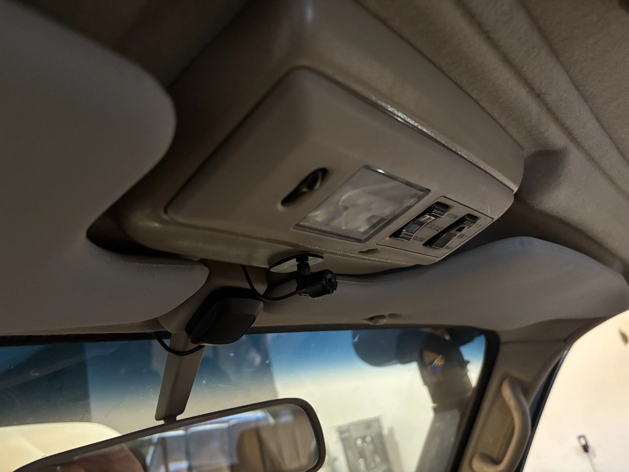

Diode Dynamics. Very happy with the light output compared to stock. I also did the doors with their high output led bulb.
Sweet! I put simpler ones in the domes. But wasn’t sure what would fit in the map light.
