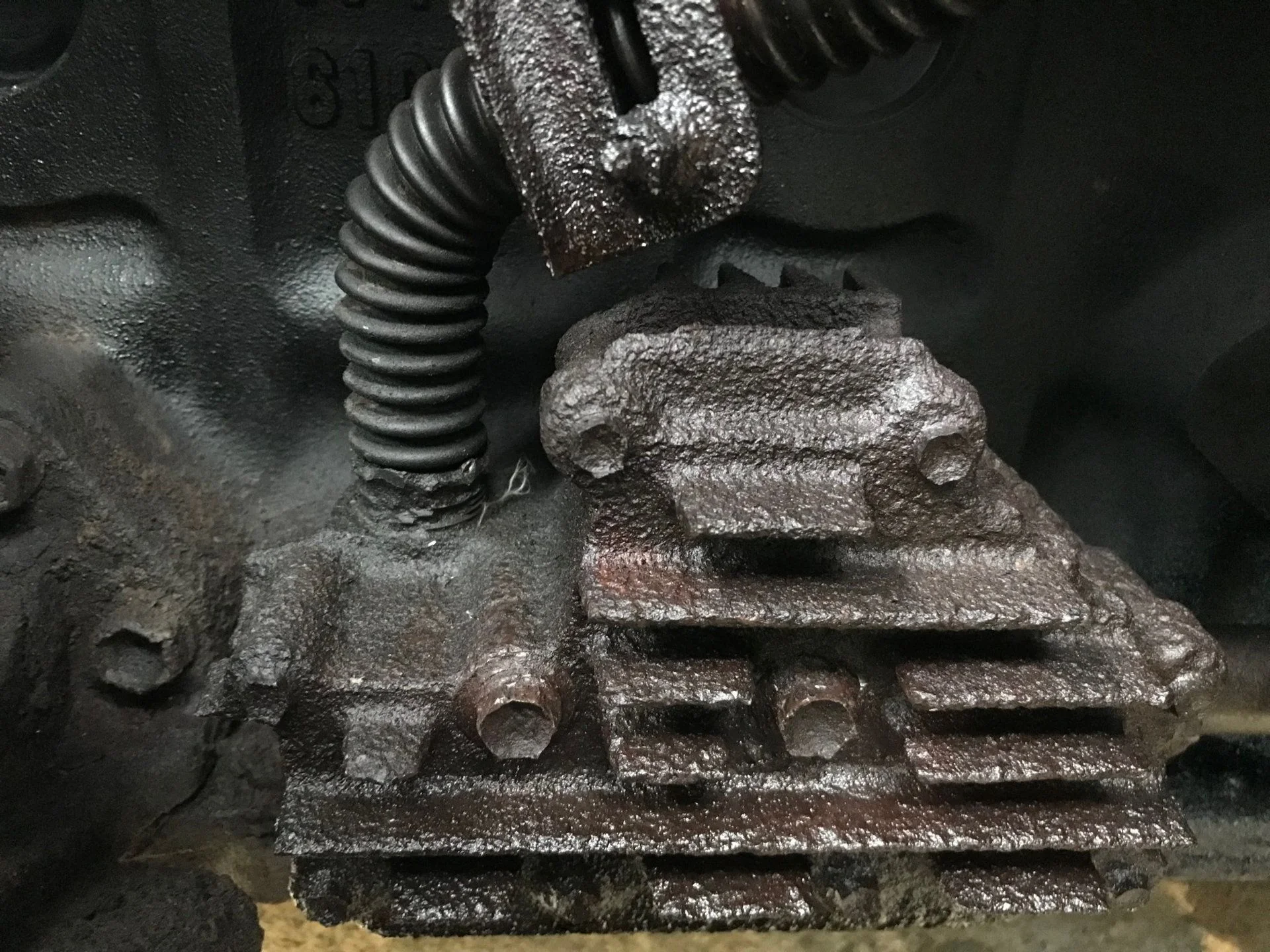

Any advice on breaking the EGR cooler bolts loose? I have purchased an extraction socket set, but still can't seem to get them to budge. I don't want to break off the bolt head.
1917904
Ah! Thank you Jim, I very much appreciate it sir! After looking at the diagram of the EGR cooler, that thought did cross my mind. It looked like the bolt was only threaded in the block, not the actual cooler, and that it may indeed slide off, if the bolt head broke. Seems like the only case where breaking the bolt head off may be advantageous.
FWIW, the hole in the block is not through into the crankcase, so if the bolt breaks off and can't be removed, it can just be trimmed off flush with the threaded boss. Nothing is gonna leak around the bolt.
