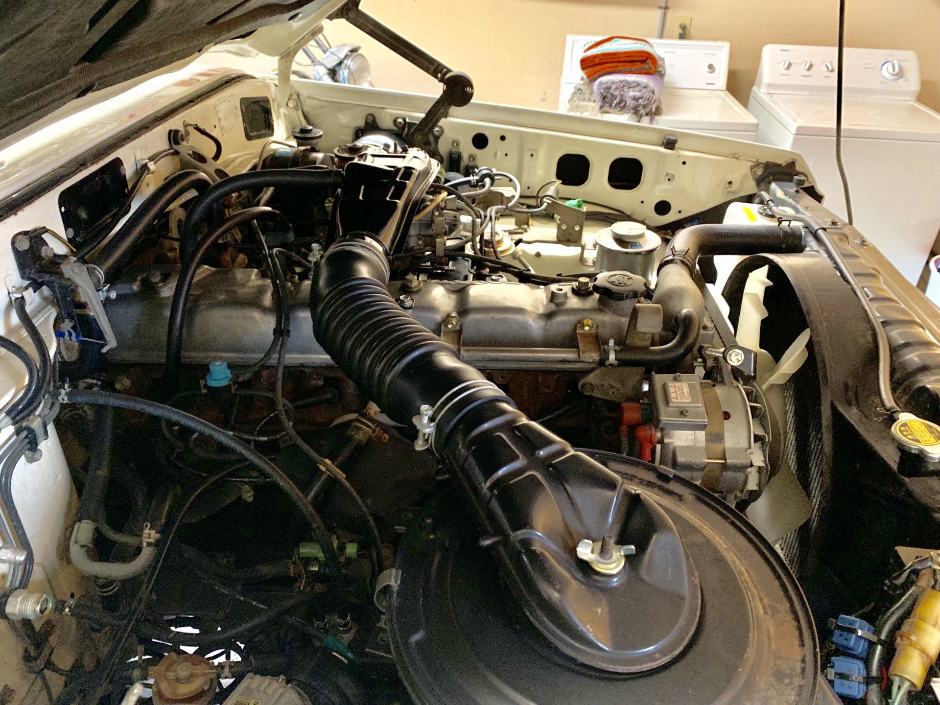

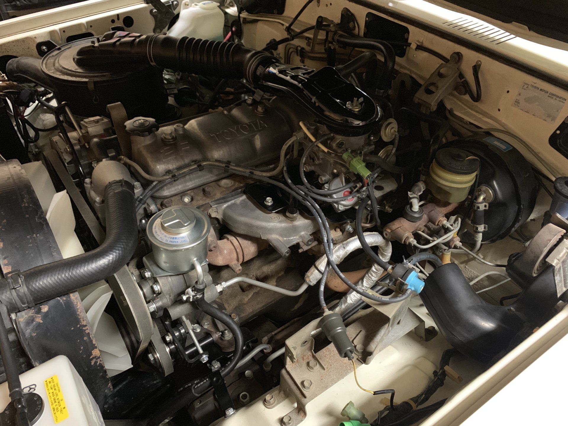

Just checking in to say thanks to those that have done the legwork prior. Successfully desmogged my truck, kept the VCV for distributor vent and evap and using BVSV (1) for the evap vent. Also kept choke opener/breaker since they both function currently. Air cleaner is non-USA unit, non-USA 3F fj62 pcv hardline and Jim’s egr block off.
Truck runs silky smooth for a tractor motor. I'm considering a drop to a 138 1st main jet since that is what I see is the typical size for non-smogged trucks, where the 2nd main is consistently always 200, in some occasions I've seen 220 for certain 62 carbs...not worried about that. I still need to pull manifold off and make sure its sealed up well, but I usually hold about 20.5inHG so I haven't had a major driving force to take the truck off the road to machine and reseal, but it will happen as I find some free time to have the truck down for a few days.

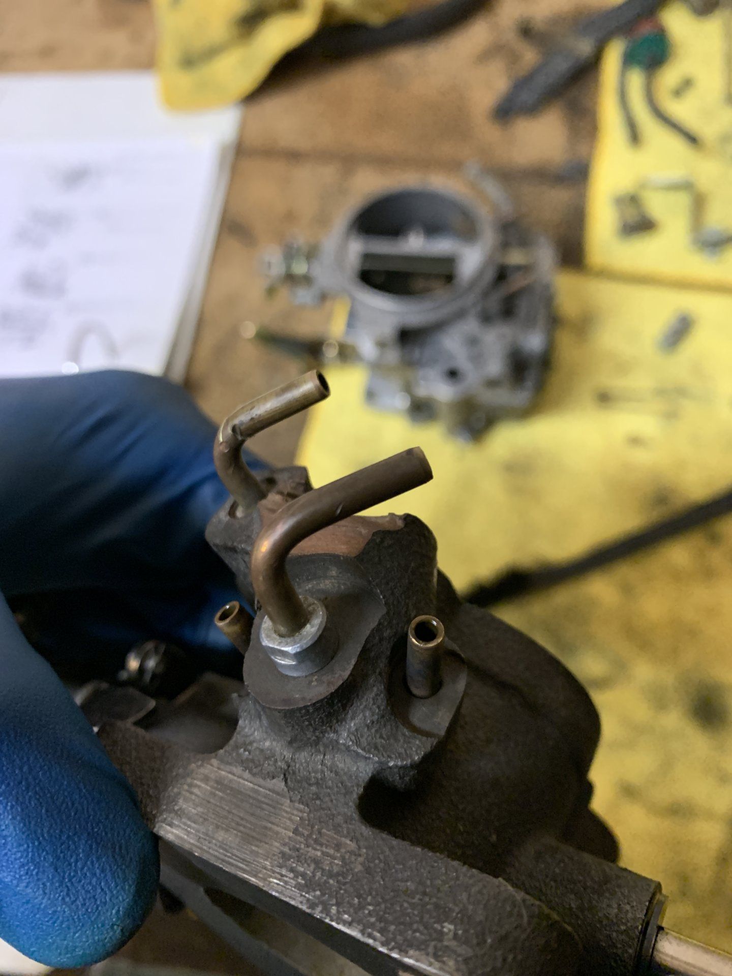

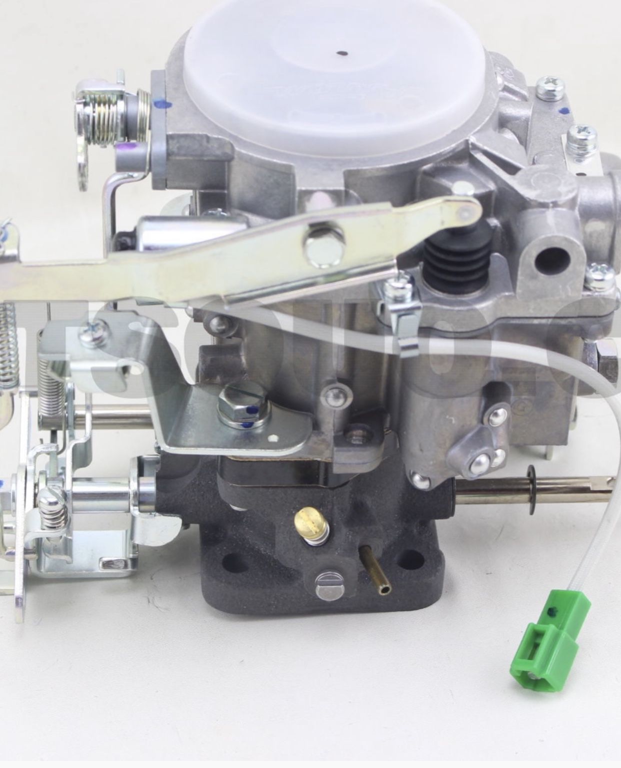

Now one part I am curious about. I noticed on the USA carb we have the HAC port which is either threaded or pressed into the carb base, I didn’t attempt to remove at the time. I would assume threaded due to one flat being machined into the port. I also noticed the non-USA carb has the exact same fitting/location and one could assume it is removable and the port off the USA carb could be swapped over....effectively utilizing HAC on a non-USA carb. Anyone else noticed/attempted/have a spare carb to see? I don’t have one of the city racer reps or oem non-USA carbs to review.

I don't know if that HAC throttle body port is pressed in or threaded, my guess is pressed since that's what all those other ports are, but I've never tried to remove one. Would be nice to know if it's possible!

The idle plug is not threaded, it is pressed in. There is a shape to it on the inside, so the external flat is there to be sure it is clocked correctly when pressed in. To permanently remove the HAC elbow, twist and pull. A 3.5?mm ball bearing can be whacked into the AL plug to close the hole.
