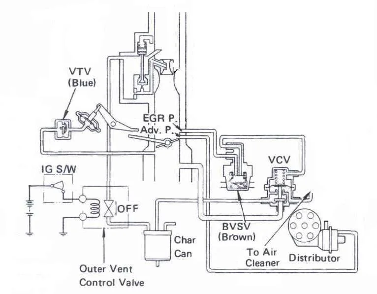

Correct 1978 desmog diagram
It should be routed like this to minimize the negative systems (EGR, AIR) and keep the positive systems (evap, vac advance, CB...).

See post #3 for what it should look like to run good.
Removing all rubber hoses from underhood will lead to running like poo (no PCV, no vac advance, overpressurized fuel tank, no choke breaker, inop dissy cap vent system...).

Need some help identifying parts (VTV, BVSV etc.) on diagram #3
thanks
BVSVs screw into the thermostat housing and have two vacuum line connections. VTV is a cylindrical shape, inline with a vacuum hose. Blue VTV is actually blue and white as I recall.
BVSVs are closed when cold and open up at different temps depending on their color. Not sure what a VTV does. Check valve?
