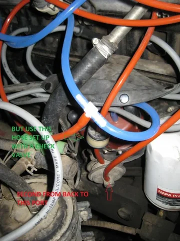

Unfortunately, I haven't seen anything in particular, but if you check out my pictures, I kept the HAC and everything runs great. If you need to know where specific hoses go, let me know and I'll get some more pictures.

Where do the four ports on the carb, that are facing the block route ?
kinda hard to make those out from the pics... thanks for your help
I'm at work, BUT I will either take a picture or give you the routing instructions in the morning. I am running a similar set up.
Here you go Professor ... I'm no professor, so I have no idea what all these ports are called, so I have kept it simple. If you have ANY questions about my pictures or explanations ask and I will explain to the best of my ability. After you are finished, be sure to post pictures of your engine and everyone can check it out.

I hope this helps. If not, I will be working on the truck tomorrow morning and I would be willing to get on the phone and fo line by line with you. Good luck !!
