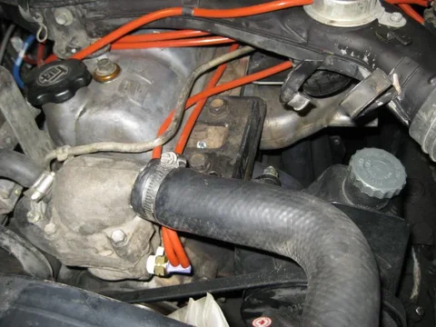

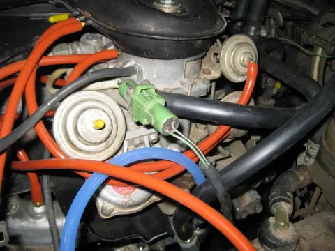

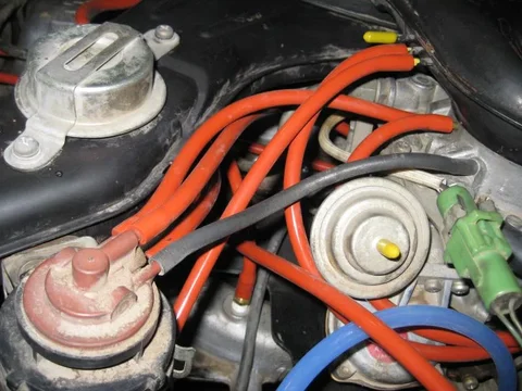

So, with the help of a good friend and all 600+ posts on this thread has led me to the completion of MY Desmog. Since reading this thread, I have realized that there are many different verions of a desmog. Mine includes HAC and the BVSV. I wanted to post some pictures for everyone to look over.
As you can see ... I was very inspired by Trapper50's desmog
Looks good.
Only 2 minor glitches I can see.
1. The AC idle up is missing? The AC vac can is there on the frt of the carb, with the yellow cap, but it connects to a vac solenoid usually mounted on the vertical inner fender (not on the emissions rack, cause it's not emissions related). None of the vac control stuff is visible in the photos.
2.There is a VCV in the hose at the dissy advancer. If it there for HAC, then it should be going to the HAC fitting, the outer one. In your case, the inner fitting (primary advance) should be coming direct from the advance fitting on the carb base.

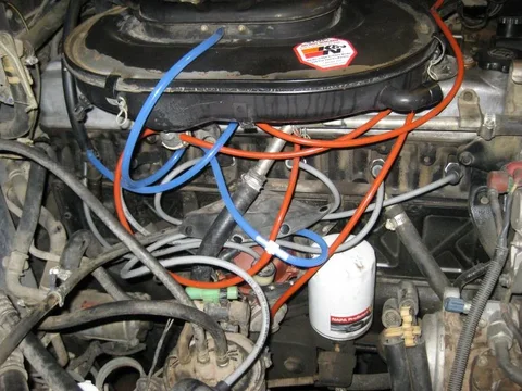

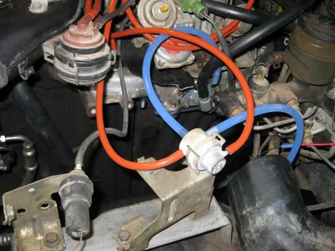

I just inherited what may be the most hack-tastic desmog yet. 87 fj60
Not a single thing left plugged in on the drivers fender, vacum leaks out the wazoo, and it was idling and surging between 1500-2000 RPM. (from vacum leaks?) Also air rail is just open where it used to connect to(smog pump?)
Is there any way to get this thing running halfway decent with no HAC, AC idle up, etc. for now?
I just ordered the proper air rail caps from Jim, so once all the leaks are fixed, is there a way to (even temporarily) run/plug the vacum lines with out ANY of the valves switches, etc?
Thanks!
Post up some pictures, so we can see the damage. It will also make it easier for folks to chime in.
I will try to grab some pics tonight. I moved some things after reading here and looking at the diagrams, no real difference, but still have some vacum leaks to fix.
PO had the one to the AC idle up coming off the 3 prong deal in the manifold, and the distributor advance coming off another one of those 3, and the 3rd broken off.
I jb welded a ball point pen tip in the broken spot, and put the dist to the port on the bottom of the carb(c) like in the pics. Then capped the ac idle up, and the other two ports on the manifold piece.
He also had the choke breaker run to the egr valve IIRC, so I moved it to the middle port on the carb like in the pics.
I told you guys it was bad...ha ha
Well, I know it can be daunting to read all 600+ posts, but you are doing the right thing by looking at the pictures here and the diagrams. Also, there are a lot of great minds (not me) that will point you in the right direction until you get it right !!
OK here are some pics.
Pretend the Air cleaner is on and the ports on it are plugged. (They are now).
What else can I do, to get this thing running better?
Missing lots of stuff...
