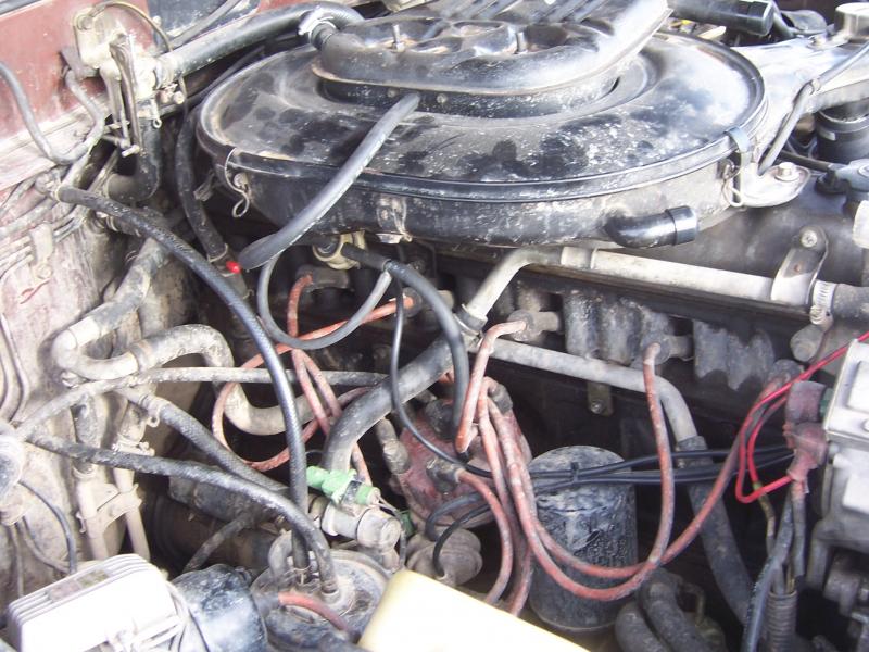

Mine is done. This is what it looks like in the end. I still need to cap the air cleaner properly. It idles nicely (600 rpm) and accelerates hard. Much more power than before.

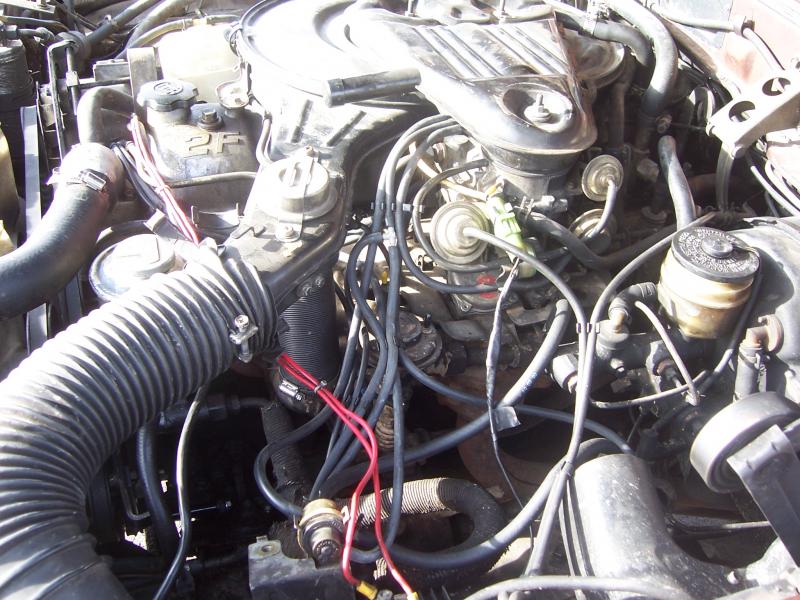

Hey guys, I'm almost done with my desmog. I'm in Idaho so no emitions testing! The only part of desmogging I need to do now is the part that all hooked to the exhaust. But I wanted to see what you all thought of my progress so far so you can correct me if I've done anything wrong. And hopefully help others who may be wanting to do the same thing.
Thanks!

See anything wrong in the pictures I posted??

Pics look good. I like the HAC mounting.

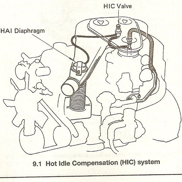

Okay... So if I want to I can eliminate the HIC system because it just warms up the carb faster for lowering emissions. But I still need the crankcase breather. Does it have to go in that spot or can I route it up to the aircleaner?
The HIC valve does control the HAI for faster warmup. The HIC also provides (as the name indicates) Hot Idle Compensation, raising the idle speed when engine bay temps are high, to help turn the fan & WP faster and cool things off. So, if the HAI is undesirable, just cap off the HAI vac nipple on the HIC valve. HAI will be disabled, but the HIC function will remain.

I don't beleive the HotIdleCompensation valve can adjust the idle speed. It doesn't connect to the carb in any way.
believe what you will.:meh:
It needs to be on the record that the purpose of the Hot Idle Compensator is to compensate for the drop in idle speed that occurs on a hot engine. It does this by allowing a metered amount of air into the PCV hose and then into the manifold. Making more air available=increased idle speed. See emissions FSM for detailed explanation.
I think it's purpose is to open and close the HAI.
The secondary purpose of the HIC is to allow a metered amount of vacuum to the HAI diaphragm, to improve cold weather driveablilty. On older vehicles the 2 systems are divorced, but starting around 1979, the engineers figured a way to mate the two into one control valve, the HIC.
