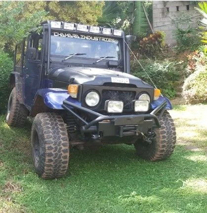

On to the Rig : I bought it this way, it was built around a decade ago for a customer by a reputed local 4x4 fabricator and builder . He then sold it to another guy who had it for 5 years before it came into my ownership .
These are the specs to the best of my knowledge
-1980 toyota Bj40 land cruiser
- Custom Bodywork with a bed in the rear and single cabin up front
-powered by a 13bt (from a bj74?)
-Running a custom coil spring setup up front with radius arms and an anti roll bar borrowed from a bj79/hdj80
- Tough dog dampers up front and EFS in the rear (both australian brands you may/may not be familliar with )
-Power steering and A/C
- 35 inch Maxxis bighorn tires with not much tread on them;)
- Two 25 liter water tanks
-11500 lb T-max winch

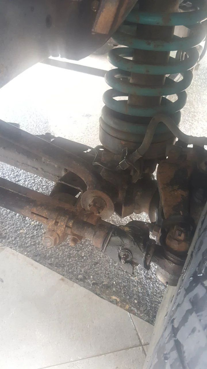

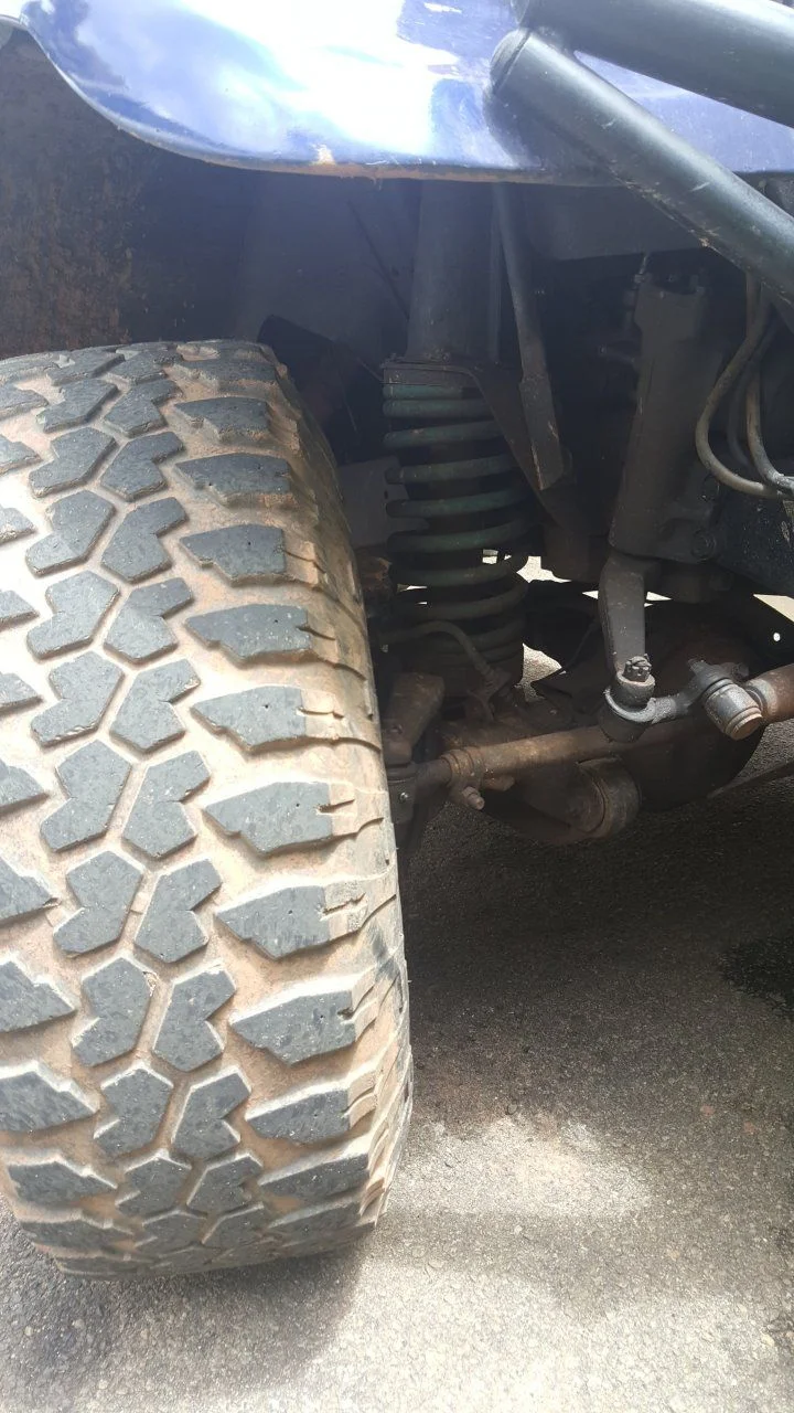

Front Coils -

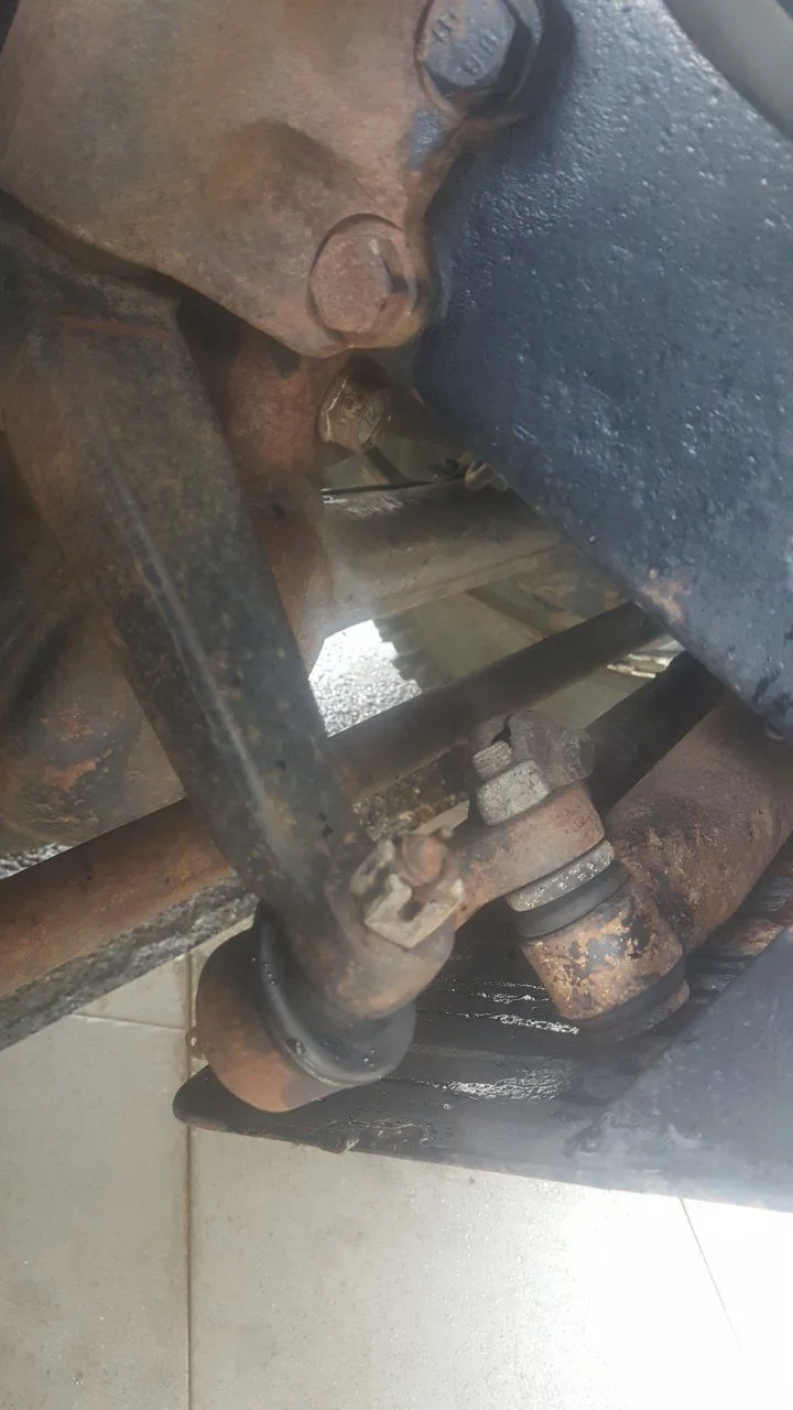

From the closeup pic of the coils, it looks like your main steering rod is bent. Might want to check that.
...which means now you've buttoned back up your shackles with the bent side plate.
And you've got a badly deformed and loose motor mount.
Please park your truck.

hi there , thank you for pointing that out . Ive only worked on cars so far and am fairly new to cruisers , perhaps i can shoot you a pm so that i can better understand what rod exactly you are reffering to ?
I did forget to mention that my motor mounts are bad , and that ive got a new set on the way.
Could this have been caused by the bent rod ?

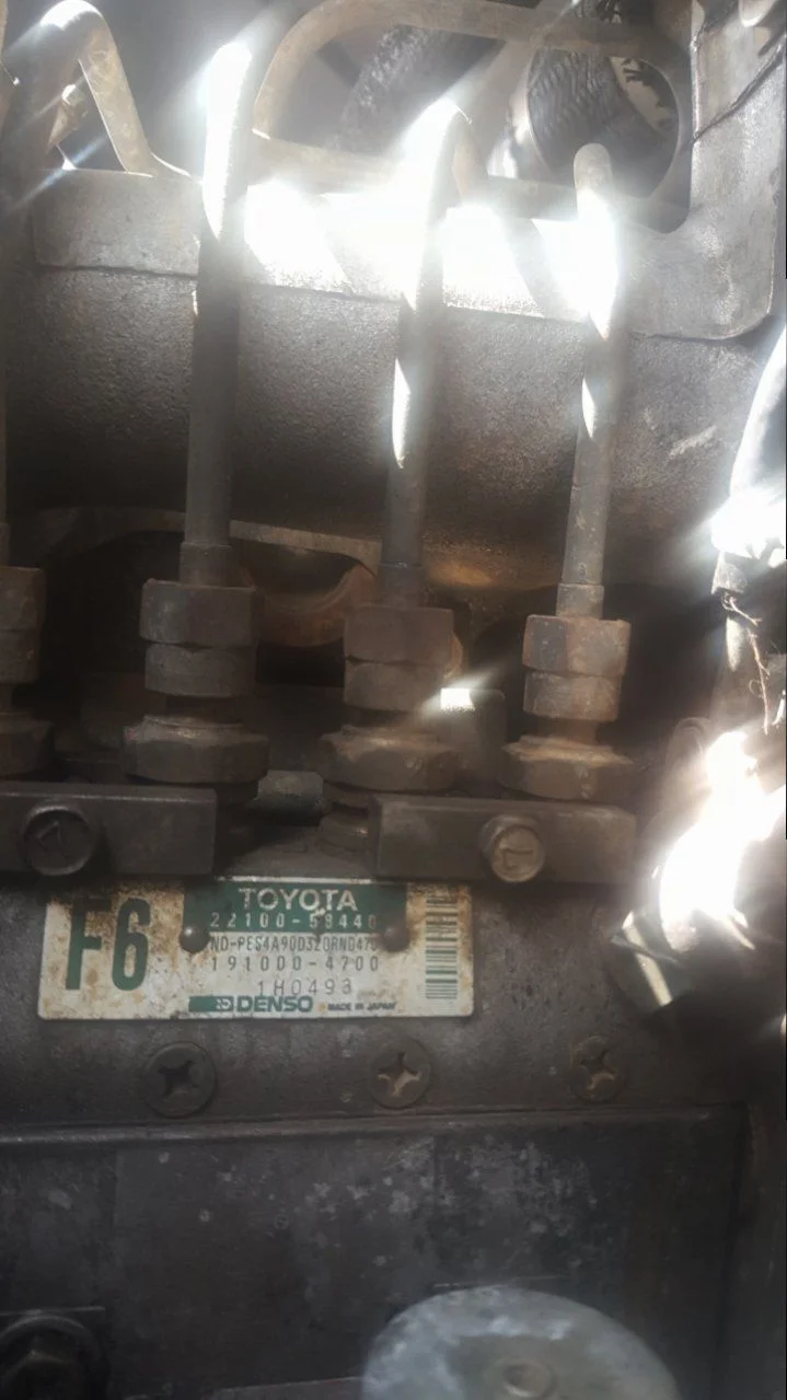

Also im hoping someone here can help me identify the fuel pump on the vehicle (13b or 13bt ? )
- Steering/ suspension ; Whenever i let go of the gas pedal , the vehicle slightly pulls to the right but straightens back when throttle is applied . The tie rod ends are not worn and there is no free play in the steering system (vehicle responds well to slight steering inputs but is not twitchy . I suspect worn radius arm bushings . Another member pointed out that the main steering rod could be bent and im not sure if that contributes to the problem.
Pictures of the steering setup (RHD vehicle ) -

65swb45 is joking because there's no way he'd be able to work out any of those things from your photos..

...Also im hoping someone here can help me identify the fuel pump on the vehicle (13b or 13bt ? )..
Here's your fuel pump (arrowed):
(It's the thing your primer pump is mounted on.)
...- Steering/ suspension ; Whenever i let go of the gas pedal , the vehicle slightly pulls to the right but straightens back when throttle is applied . ....
So it pulls to the right for an instant after you take your foot of the accelerator? But only for an instant?
I can't figure that one out, other than to suspect it could maybe be something to do with an axle that's moving into an angle (related to your chassis) when you put the power on, and then returing to its former position when you take your foot off the accelerator.
Vehicles like yours have often been modified for off-road performance with little attention given to on-road manners so this issue may have been present for a long time (with the previous owner either unaware of it or uncaring about fixing it).

Thats a clean 40 you got there ! :D Maybe i wasn't clear enough about the pump , i was asking if anyone knew what model of pump ive got on mine ! Im not sure if the builder mixed parts from a 13b and a 13bt (contacted him but no reply yet) and was wondering which model of engine my pump came from :lol: Perhaps i should go on the diesel tech section of the site but thank you anyway :cheers:
So you mean the injector pump ... part number 22100-58440?
If so, that's from a 13B in a 1987/1988 Dyna/Toyoace I believe.
Yes that is what i was after , thank you !
I will be putting it up on a car lift next week and inspecting the radius arm bushes because the radius arms are the only link keeping the axle in place ( in regard to fore and aft movement ) , making them the main suspect . If the bushes are worn it'd be a simple fix :D Will update as soon as it comes off the lift :beer:
