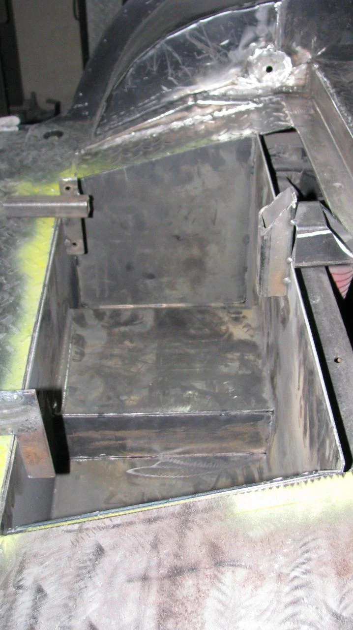

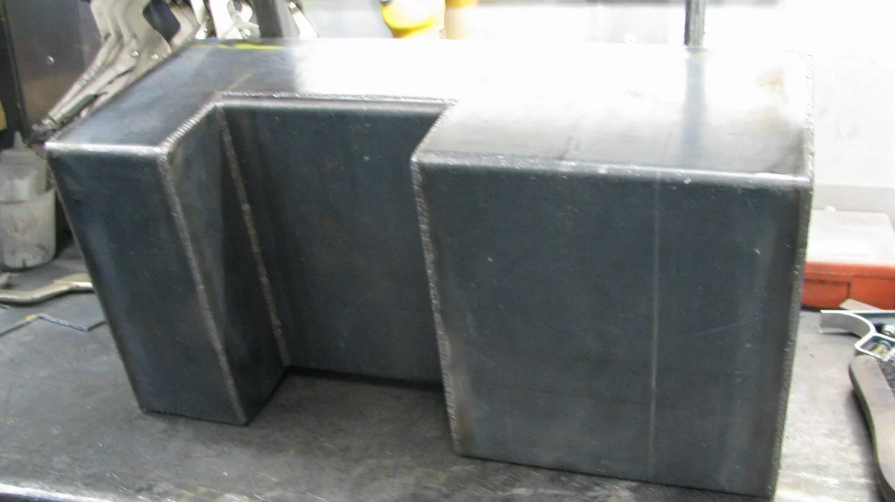

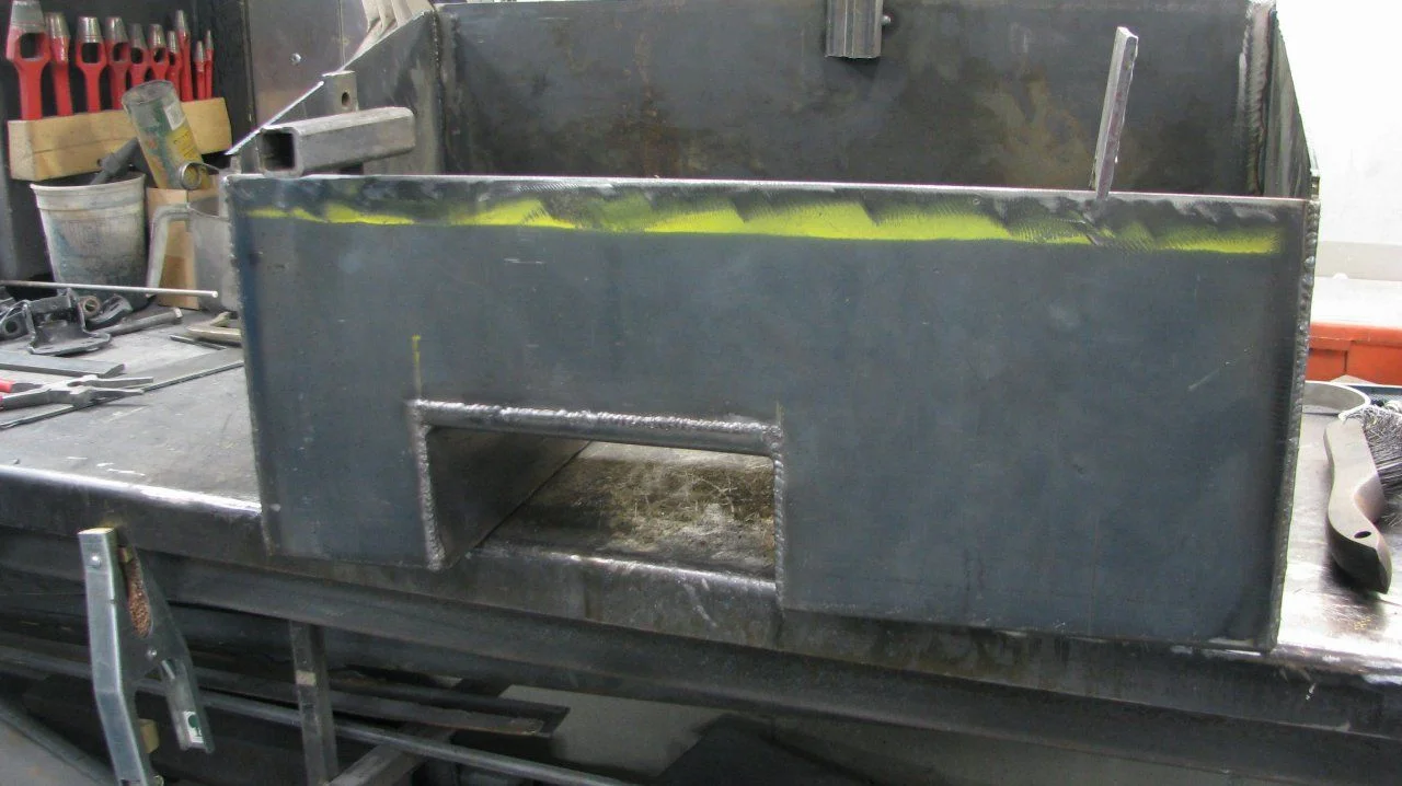

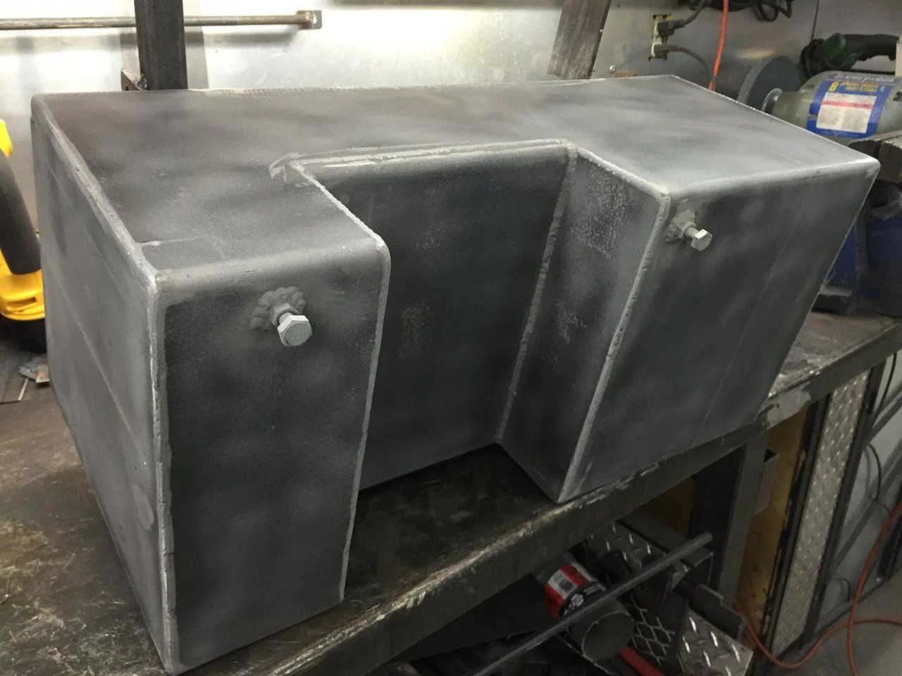

more progress on battery box,
This thread is awesome to read! Thanks for taking the time to post the pictures.

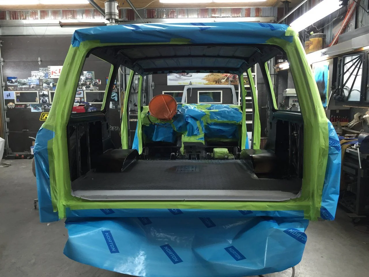

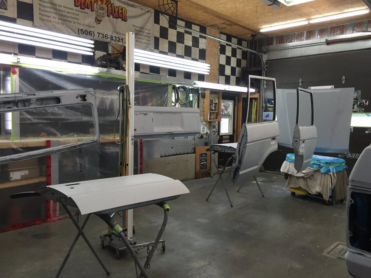

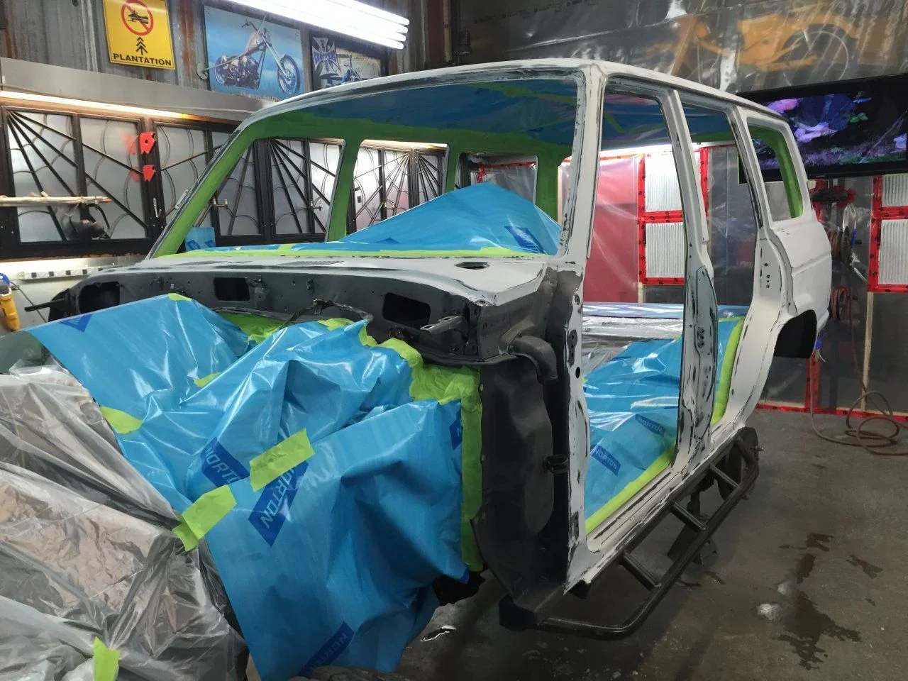

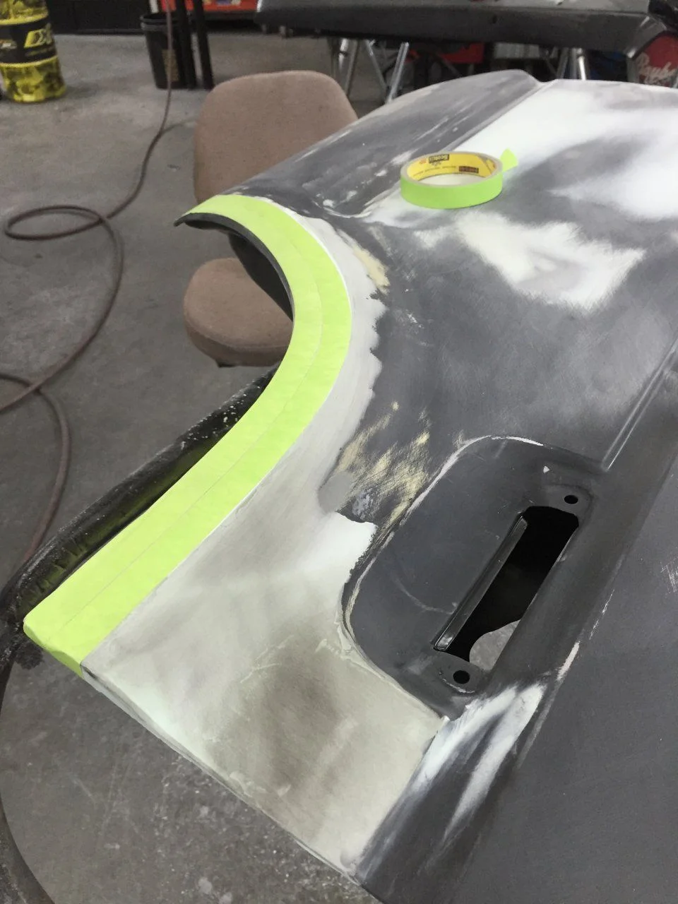

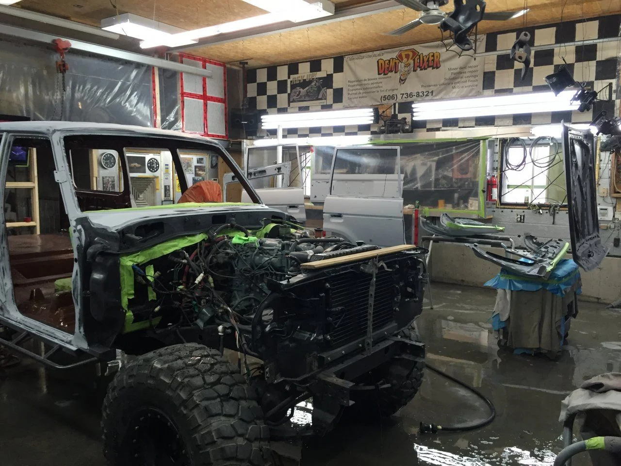

After many hours of sanding and more sanding and scuffing of poly primer things are finally ready to hang up, seal and Paint !!!! :bounce2:

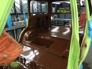

After Too many hrs spent sanding and scuffing i have decided to scrap my idea of a faded and flat finish as i'm am running out of time for the finish on this rig. :( Too much time would be needed to make a proper looking fade finish as there are Way too many edges or body lines to deal with. :worms: so…. she's gonna be full brown with a clear finish and maybe just a small two tone of black .. and a nice scratch finish once i hit the trail ! hi,hi
Got all the parts hung and waiting on the wheather to warm up a bit ( still snow here ) and……

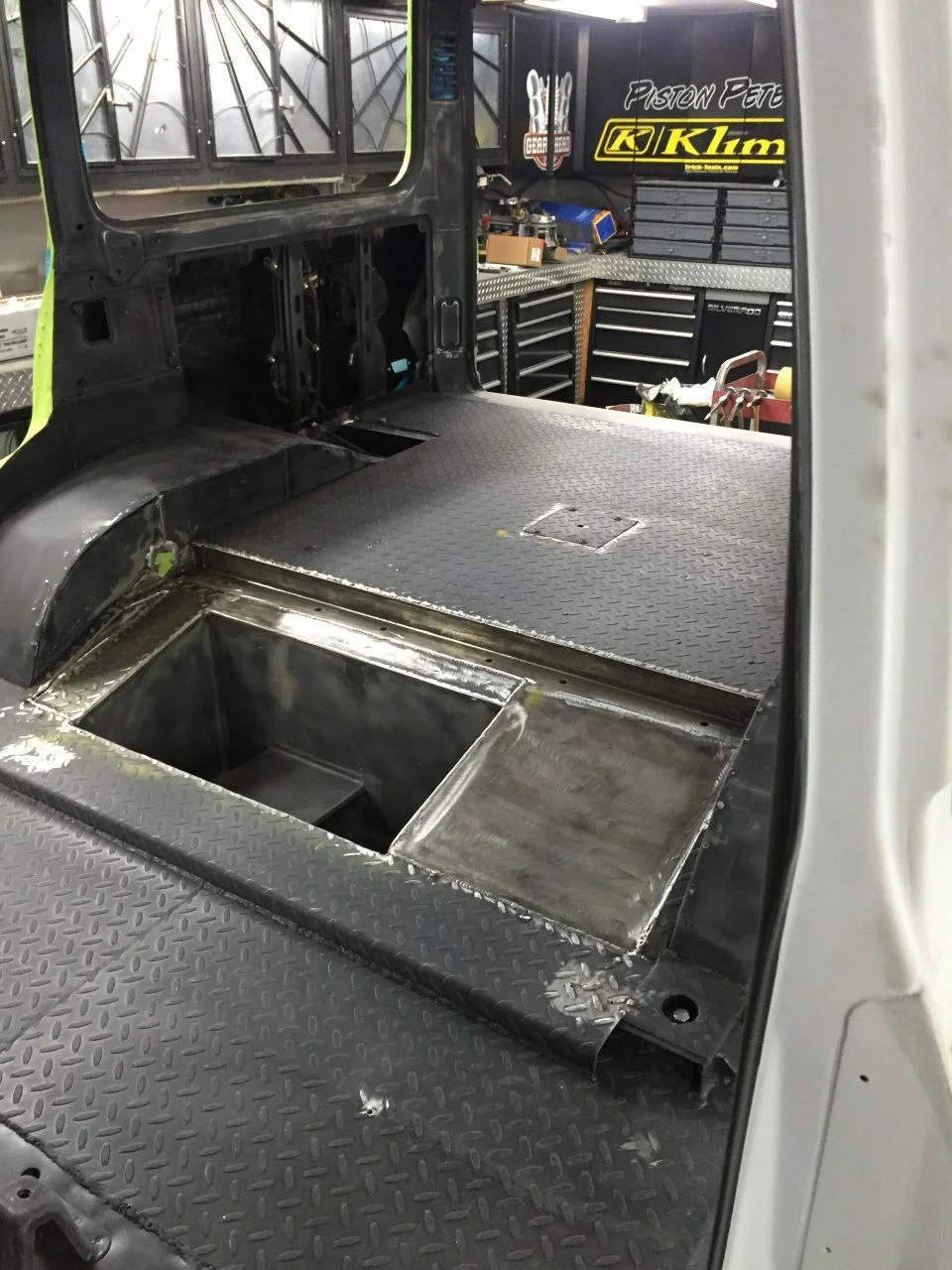

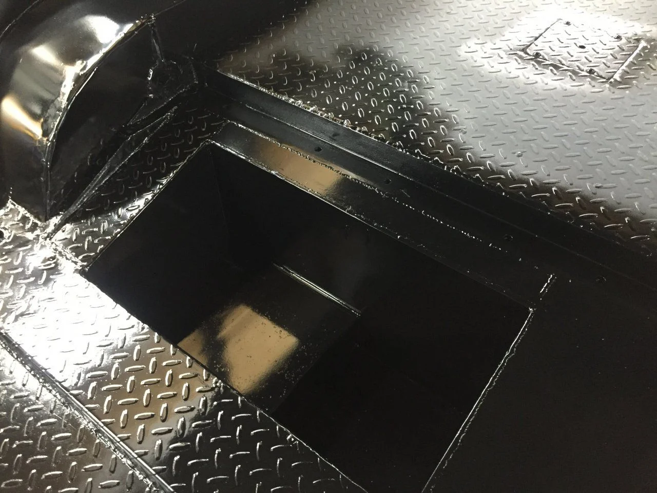

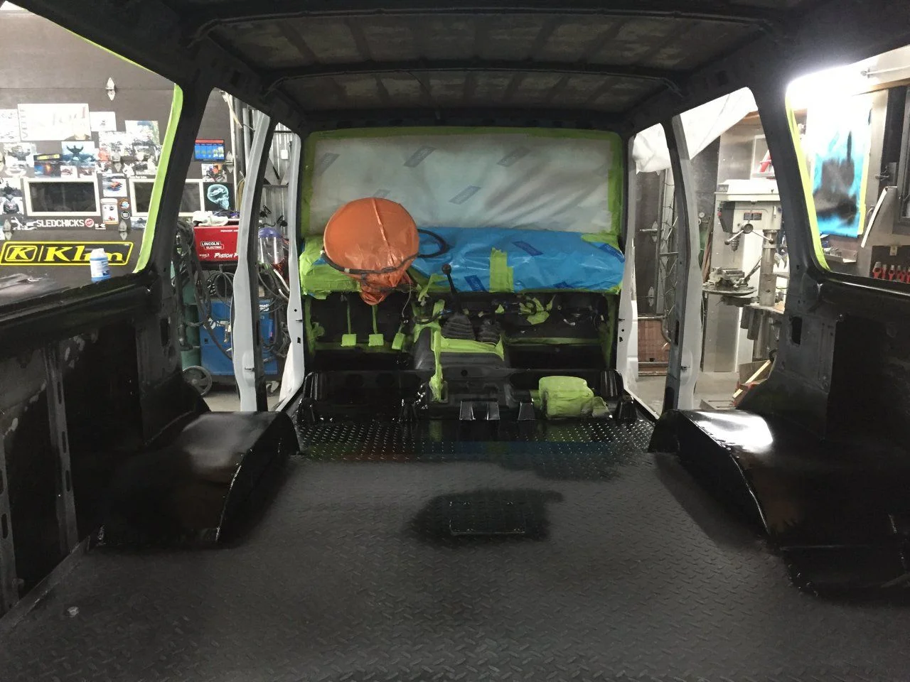

Wicked fab work! I like the extra storage under the rear seat.
A bit more progress….
