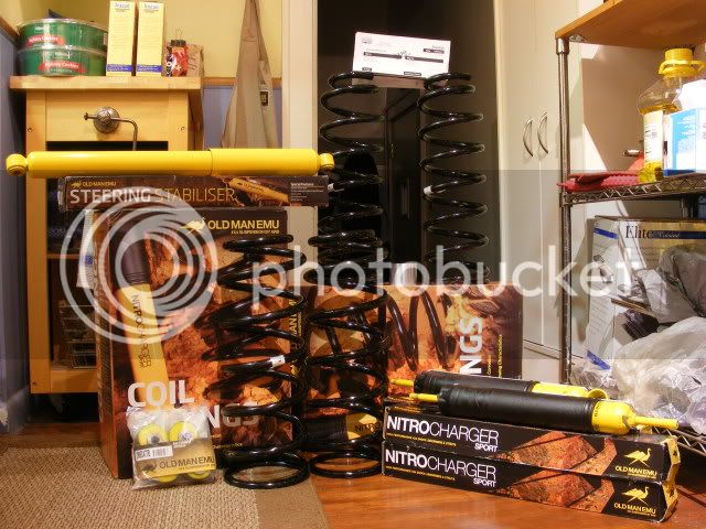

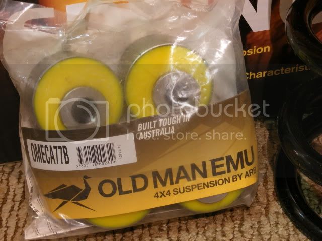

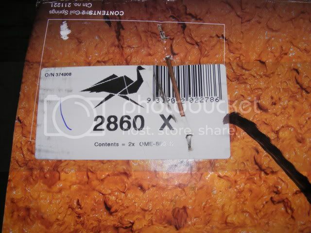

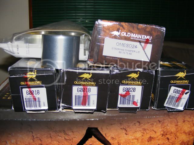

Part numbers and components of the Medium Load 2.5"

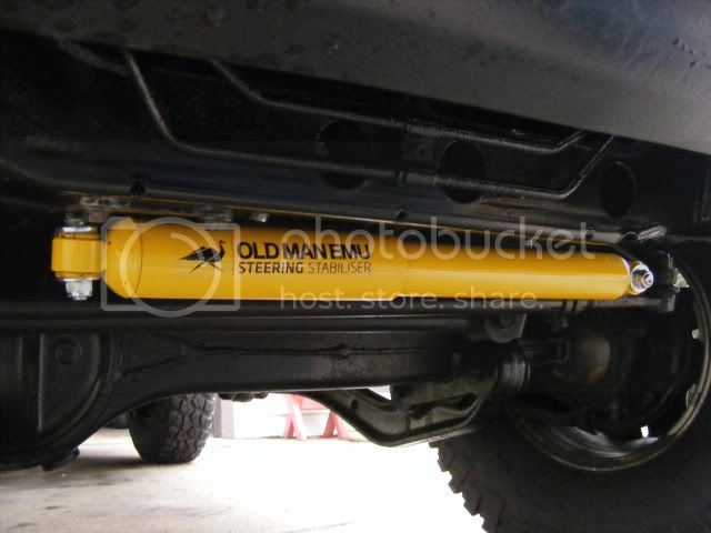

As far as you build....very impressive! I see the dampener is in, when does the rest get installed?

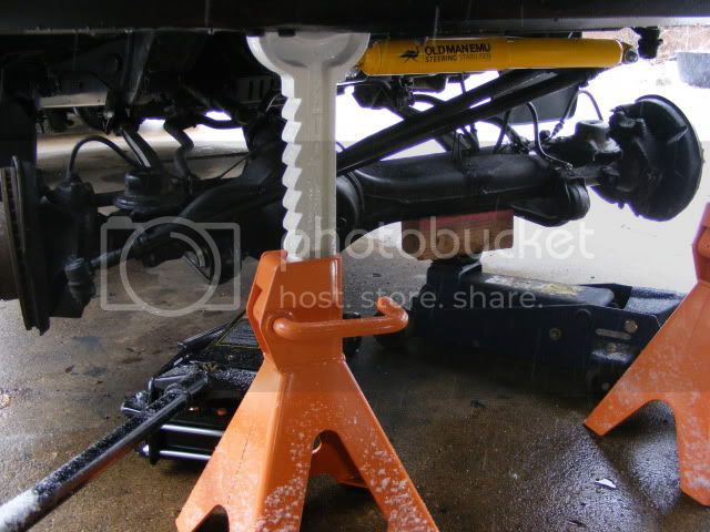

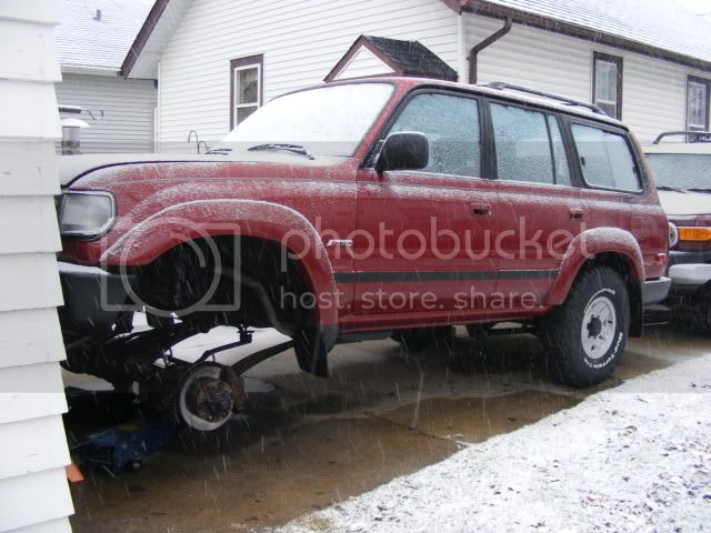

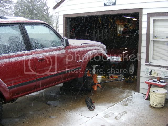

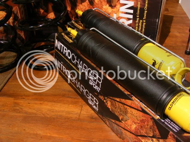

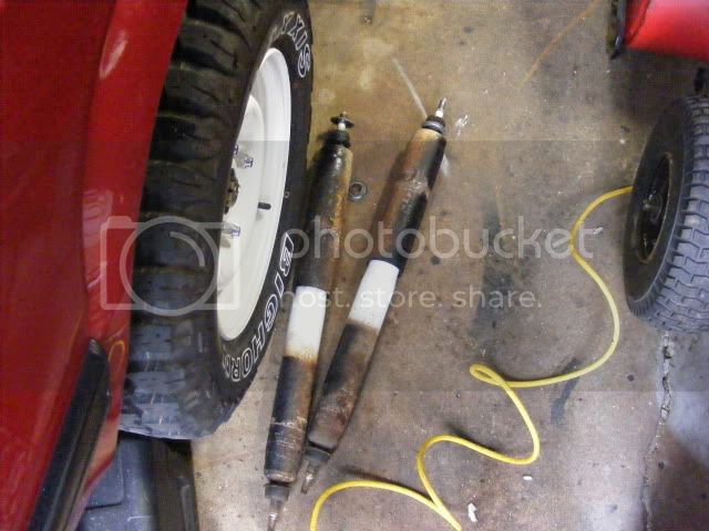

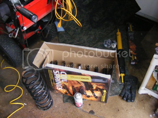

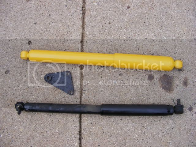

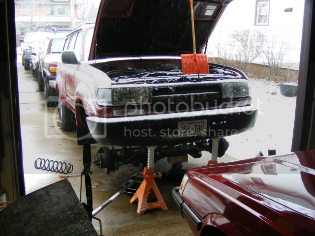

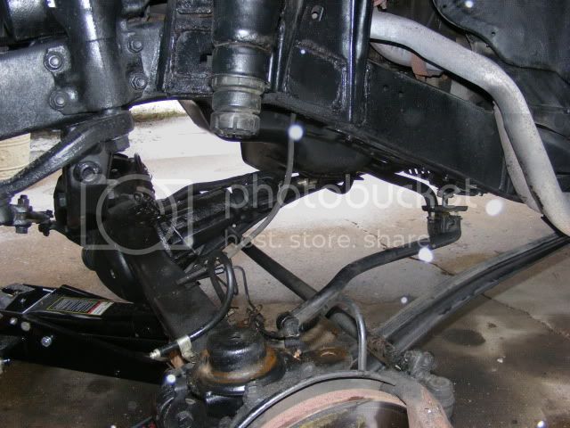

Well, I laid in the snow for 3 hours today and got the springs and shocks in (Wow much better!) Funny how the OME springs are shorter then the Stock springs, but I guess they have a stiffer spring rate to make up for it.
Tomorrow I hope to do the rear, unless the trucks buried in 3 ft. of snow :lol:

Yeah, I was getting tired of waiting for my buddy. He thought I was crazy to lay outside today LMAO!
So you decided not to wait for the lift to put on your lift??? Looking forward to seeing it!

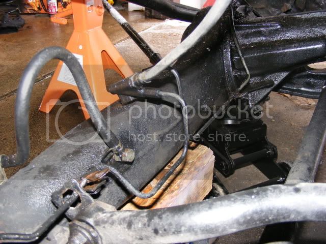

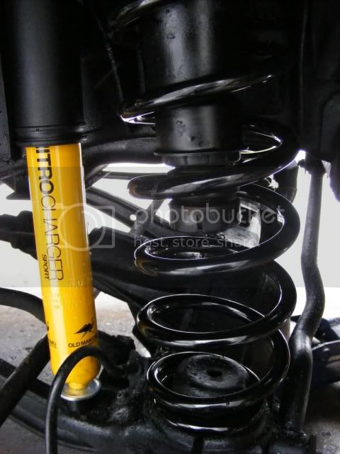

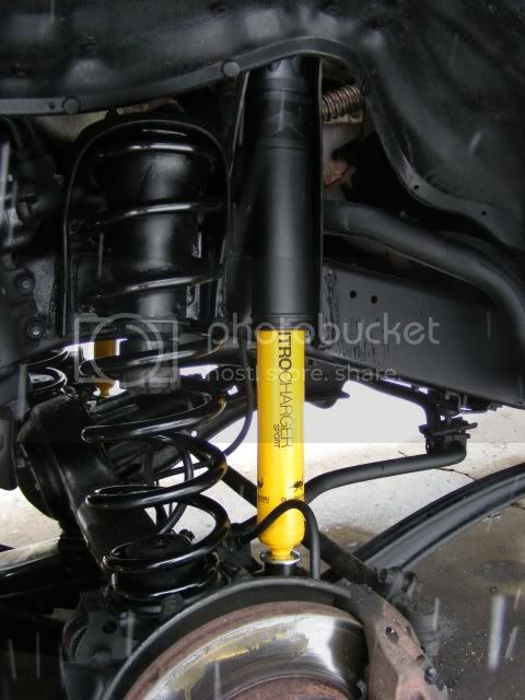

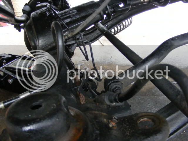

Some advice for others who plan to swap springs/shocks. In order to lower the axle enough to remove the stock springs, you will need to remove the 6 12mm bolts which retain the Brake line to the axle to gain more slack in the soft line that runs to the frame. Other wise you will over stress it and possibly rip it. You will also want to drop the Swaybar mounts enough so the Drive shaft doesn't get hung up while lowering the Axle.
Also, if you plan to do this without using a vehicle lift, you will need two 3-ton Jacks to raise and lower the axle evenly, and a pair of 12-ton Jackstands (Or at least a jackstand that has a total length 30" inches) to place under the front frame rails (Where the toe hooks are)
This went a lot easier then I had in mind, but once you unbolt the stocks and start to lower the axle, its all a cake walk after that!

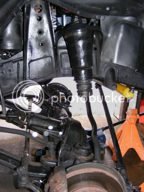

Few pictures of the front install.
Looks great! Nice pictures of the process. Did you get the rear completed as well during this event?
