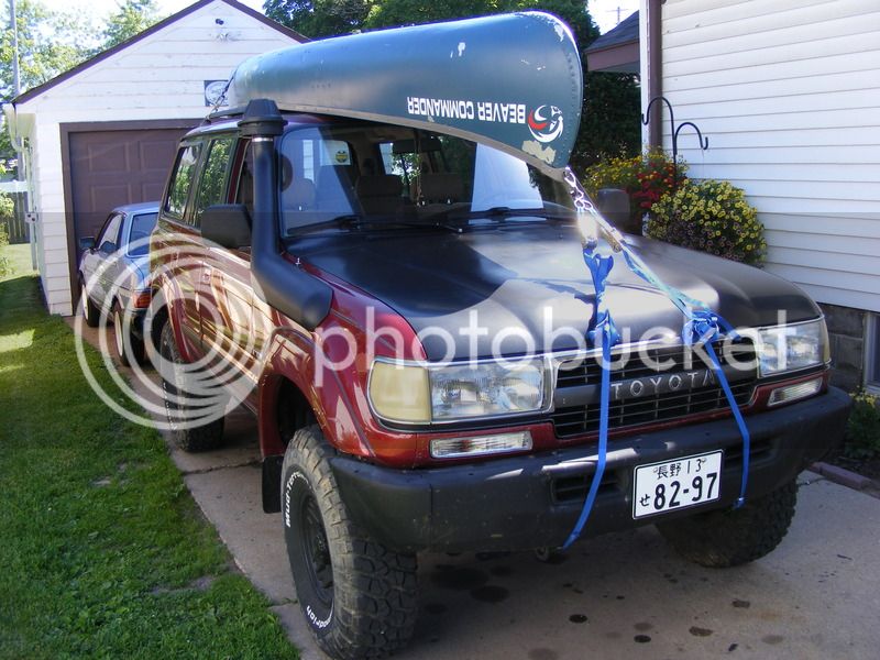

Tomorrow, we'll be taking the Canoe for its first voyage of the year.

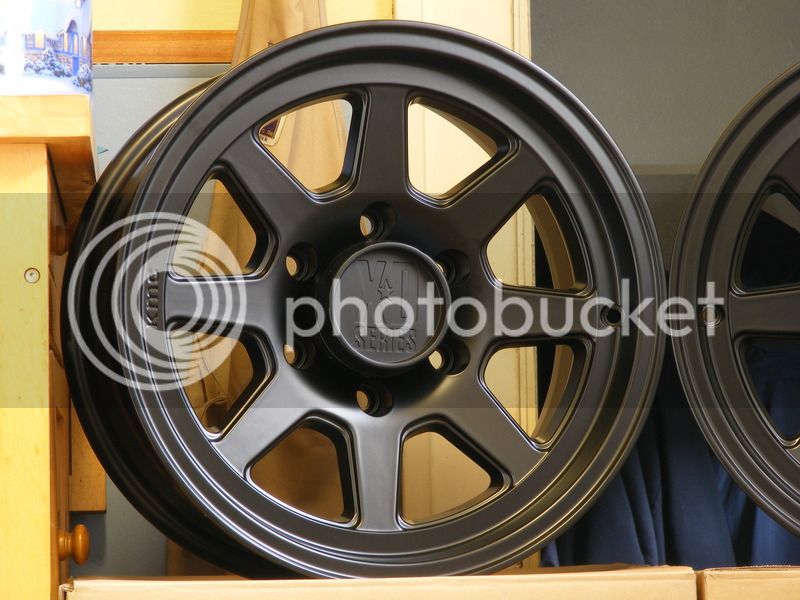

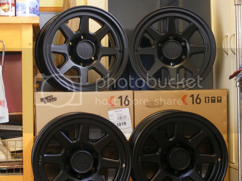

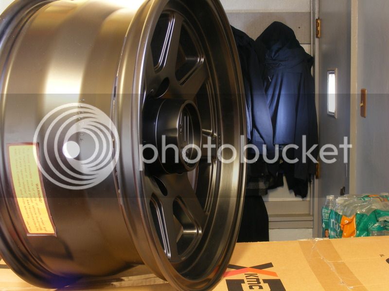

Took the dive on a set of 16x8 KMC XD301s. 108mm CB, 4.5 BS, 0mm Off-set. Now saving up for some 35x12.5 General X3s.
Really need to get off the KM2s after 6yrs. :p
