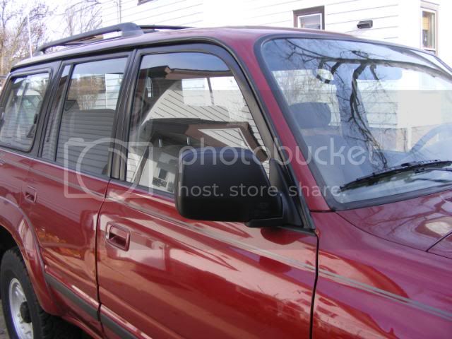

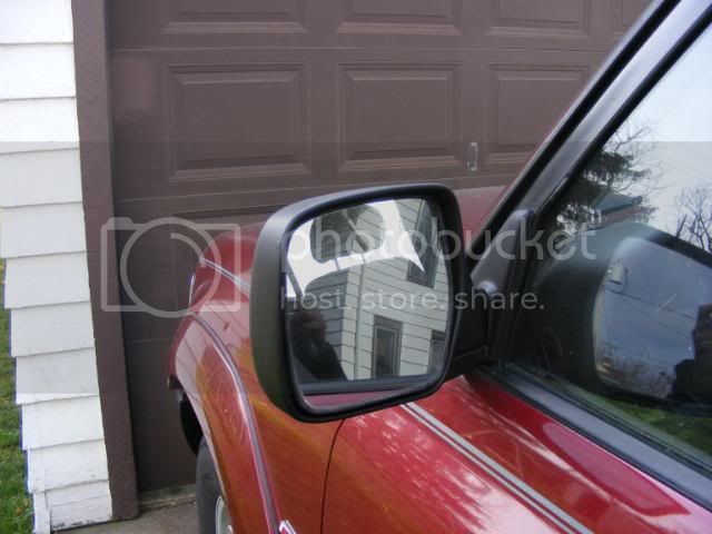

The new uncracked mirror, both painted with truckbed liner.

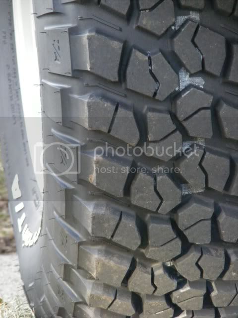

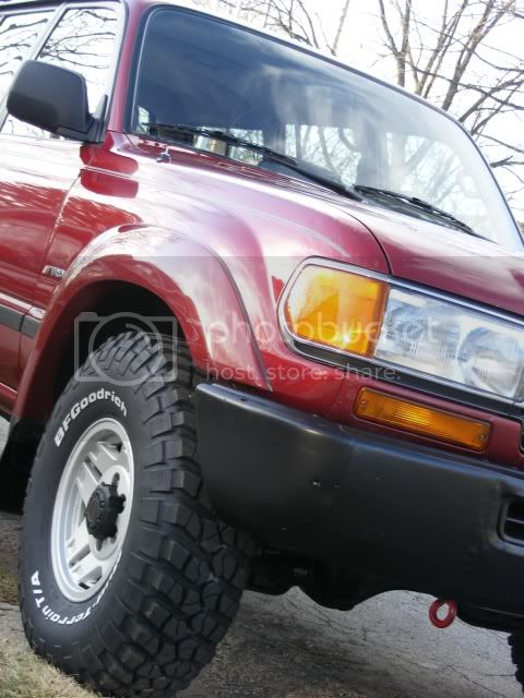

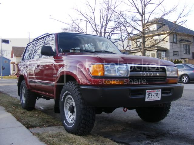

I was thinking of getting the 12.5s, but wasn't sure. I think a little wider would look nice on the truck, but yeah, I am liking the 10.5s!
the mts look good at 10.5 tread. Rig is looking good.
Those tires look great on the stock wheels. I think you will be happy with the tires I found the narrower KM2 tires are fantastic on and off road.

lrowe_csp said:
Nice paint job on the trim pieces! For posterity and assistance to other cruiserheads who may need to do this with their cruisers, what brand, type and color of paint did you use?
