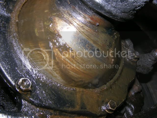

It looks like some rust under the grease on the knuckle? Water inside?
I thought I detected some birf soup in your earlier pics. Looks like a front end rebuild is in your future. Your inner axle seal is not so good anymore, and diff fluid is leaking into the knuckle, mixing with the birf grease and causing it still spill its guts out. Heres some good reading for you.
https://forum.ih8mud.com/80-series-tech/78276-front-axle-rebuild-faq.html
Yep, have a thread going for this issue.
I checked the knuckles and I guess they had almost no grease in them, I added 3/4 tube of Moly between the two knuckles, going to check and add more as needed.
Also drained and refilled the diff, The oil didn't look Milkshake, Was black though (And I changed it once before about 400 miles ago) So I am guessing everything on this truck is very dirty.
Alright, so keeping an eye on the knuckle and gear oil. I need to check it again since I changed it last and see if infact there is some milkshake going on. I am planning on tearing down the front axle come spring time (So I can take my time and do it right)

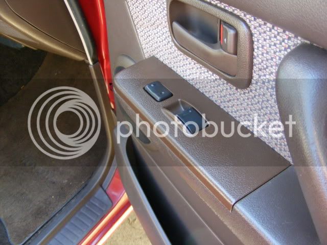

These are the Bezels I got from Cruiserparts.net, I painted them a similar brown to match (As they were gray)
-Tom
Nice paint job on the trim pieces! For posterity and assistance to other cruiserheads who may need to do this with their cruisers, what brand, type and color of paint did you use?
Satin Rust-olium Dark Brown.
Just make sure to get all the oils off the plastic via glass cleaner and water, and do light coats as to not clog up the detail on the trim.
