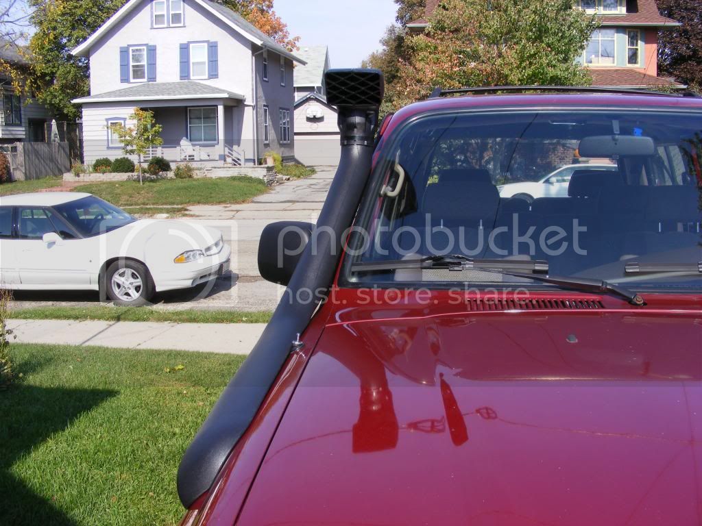

Installed a Snorkel last week. Making the first hole with the 3-1/2" Hole saw was definitely the moment of truth and hoping the template was correct. Amazingly, even though I kept wanting to move the template down, thinking it was too high, it was right on!
Snorkel looks great.

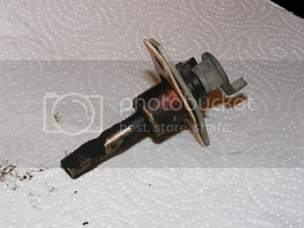

FINALLY! PROBLEM SOLVED.
I swapped in a new CSI from Cruiserparts.net today, and Bam! The truck runs perfectly again. Apparently my gut feeling was accurate and a little reassurance from the board very much helped.
This is what the original Injector looked like.

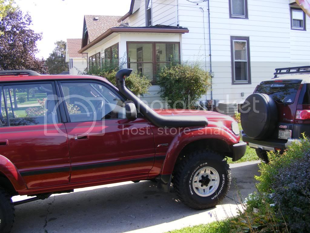

Your 80 is still looking good, is that snorkel the amazon one? it doesn't fit/look half bad, I might need to pick one up as well.

Sorry for the lack of info, after I swapped in the fuel pump, it ran great and then a few weeks went past and something else started giving me trouble. I noticed a strong smell of fuel in the engine bay and had a very large amount of unburnt fuel pouring out the exhaust (Thought it was a diesel for a sec lol) so I knew something was dumping fuel like crazy, just as to what, I wasn't sure at first.
I tested resistance on all other components including the CSI and everything checked out with the specs in the FSM. But after starting the truck and having it run horrible, I unplugged the CSI, fired it back up and it ran smooth. The RPMs were a little higher than normal, but ran good otherwise. So I figured I would swap out the CSI with a NOS one I found (Dealer says these are discontinued) and sure enough, my gut was right despite all the negative comments I was given trying to diagnose this issue.

No this Snorkel is actually molded the same as the Safari brand one. Just doesn't have the Logo on it. It fits really nice, I just want to change the Poly boot that ties it to the Air box.
