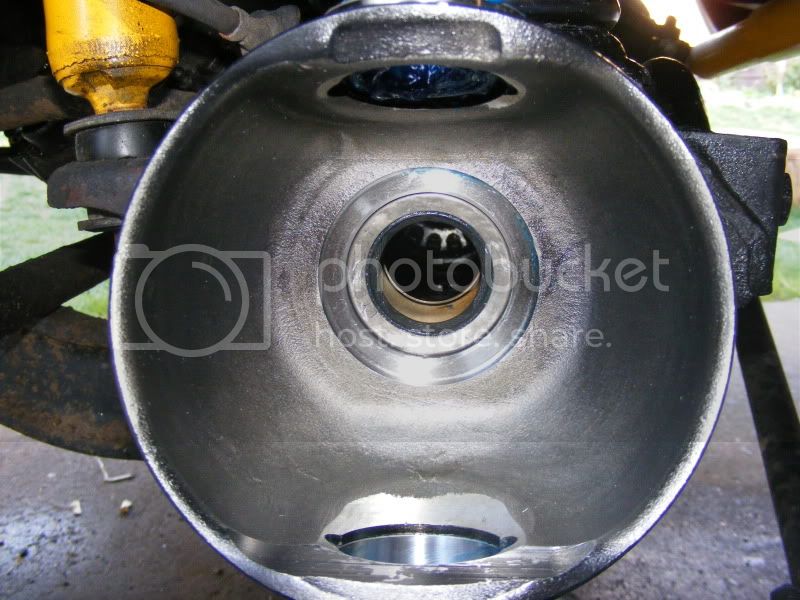

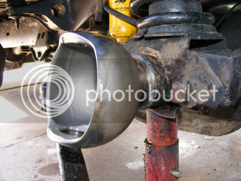

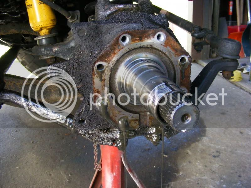

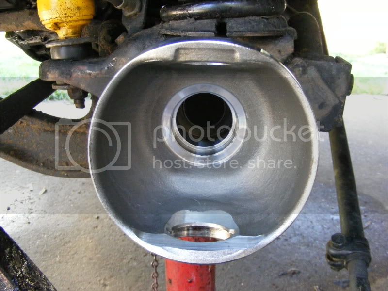

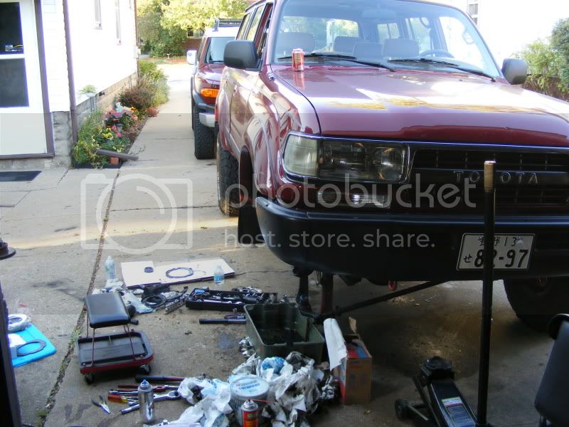

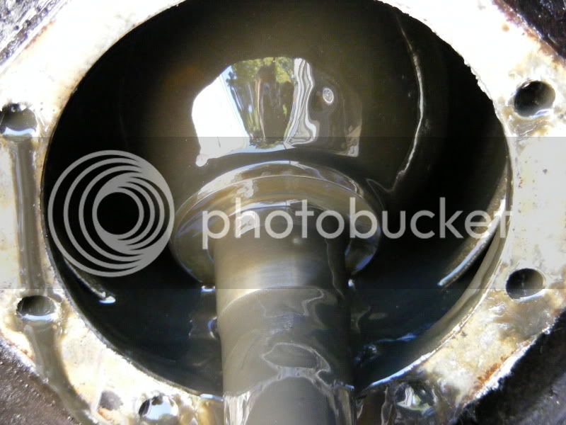

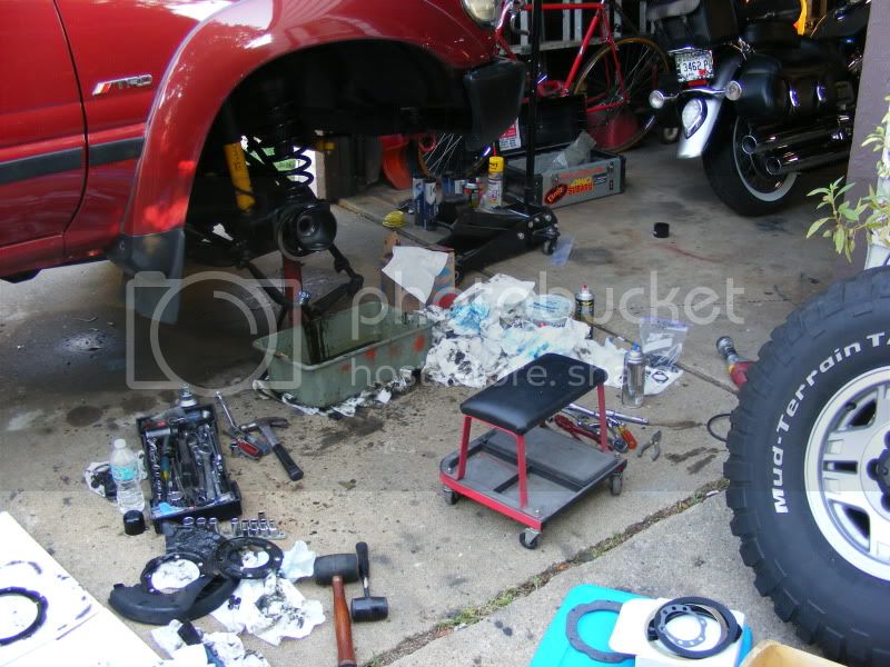

I resealed the knuckle this past weekend, everything was straight forward, and wasn't really hard at all. Just very messy Lol!

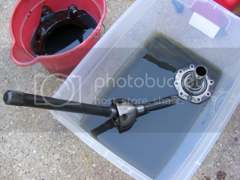

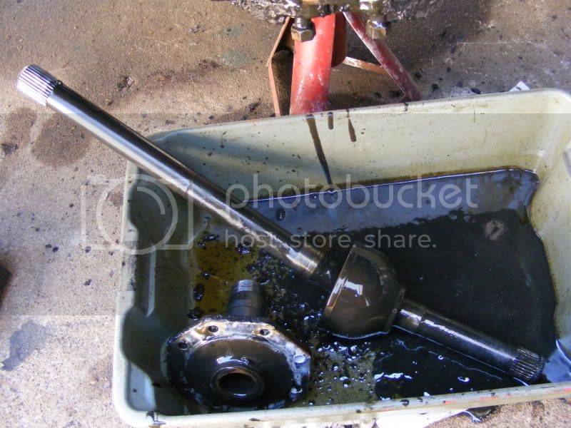

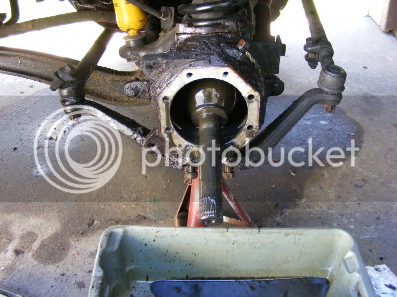

I took a few pictures while disassembling.

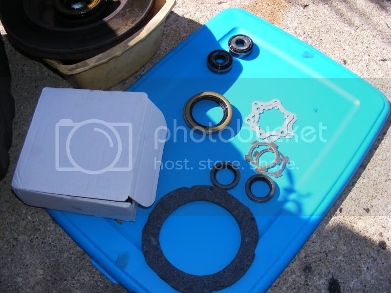

Some of the CruiserOutfitter kit.

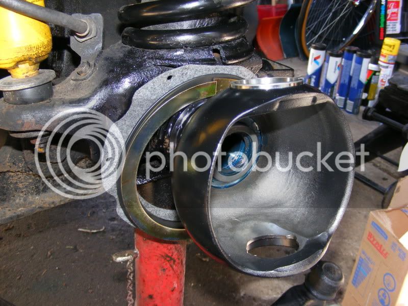

I sanded and painted the Birf ball with High-temp engine enamel. New Trunnion bearings in, new Axle seal in (Damaged the first one) Wiper seals on.
The mess I had going!

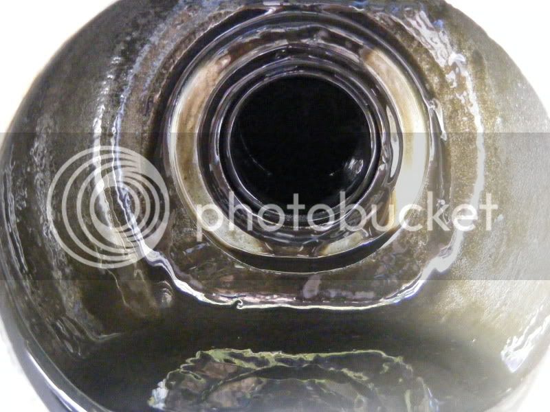

Soaking in Diesel.
I repacked the Birf with Valvoline Palladium, The specs on this show it has something like 10% Moly. Repacked the wheel bearings with Kendall Superblu and installed a new seal and changed the gear oil. Seems to drive just fine down the road! I took it on a 2-hour joyride, no strange noises, no leaks. Gonna check the Knuckle grease tomorrow and add more if needed.

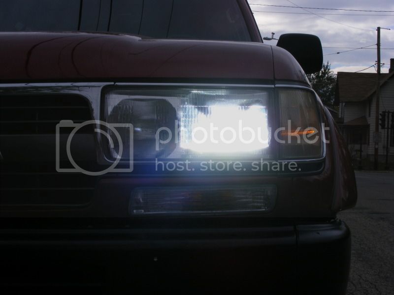

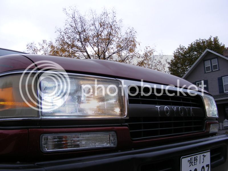

Just installed new HIDs from DDM Tuning. 55w 5000k 9006 with Wire harness/relay and Raptor Ballasts. I was running 35w 6000k Xentec HIDs, those are going to a friend.
I cannot even imagine how bright these are, they light up street signs during the day. Can't wait till tonight!
I am also running Hella 100w Rally 9005 bulbs for high-beams.
1 year ago.
Present.
