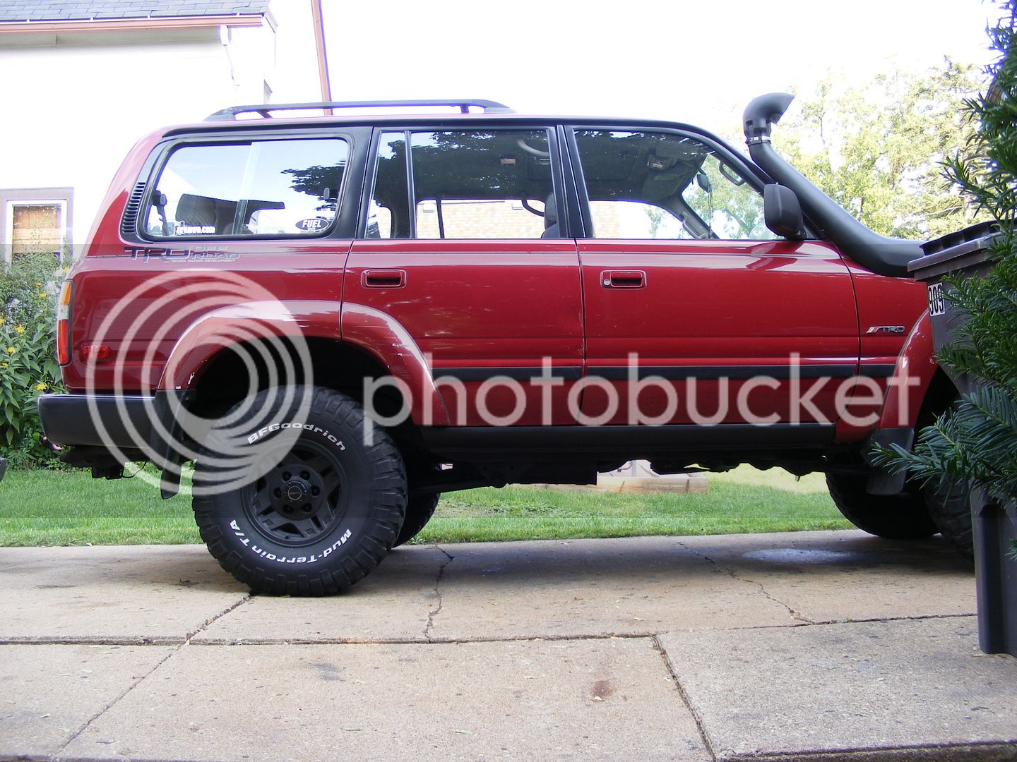

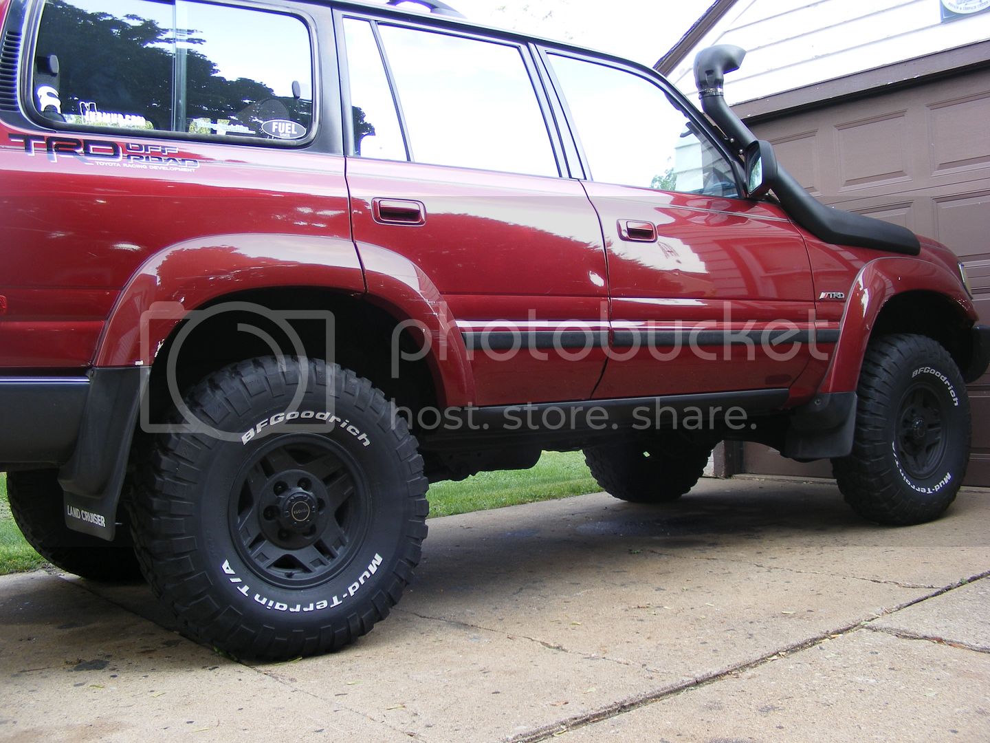

Love your build thread very informative. I drive a 91. What snorkel did you buy and were there any fitment issues? Ive been looking at the ones on eBay but not about to jump into buying one that will have fitment issues. Thanks in advance for any snorkel recommendations/advice!
Thanks! Yeah it was the Ebay snorkel. Its basically a knock off Safari Snorkel and it fits perfect! The template works even though its kinda scary making the first hole haha. I paid about $170 I think? I had it on in an afternoon.

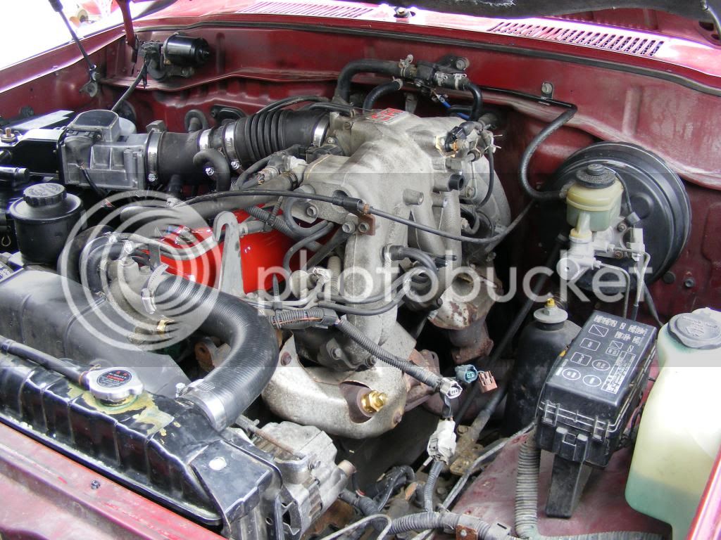

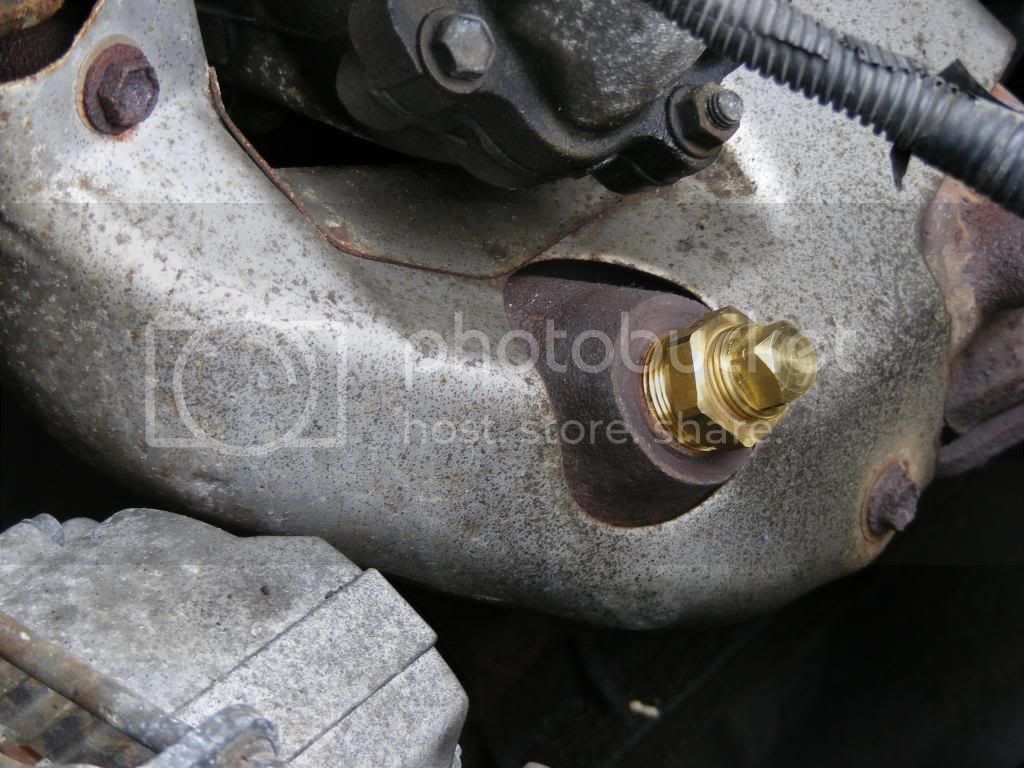

Here are some pics of it properly De-Smogged. I'm just waiting to pick up the EGR Block Off Plate from my buddy who CNC'ed it out of 1/8" Steel. (Hence the Rubber plug in it for now)

Can you give me the specs on the exhaust manifold plug? Size?
I can't remember the specs on it. Its basically two brass plugs from Lowes, I lock-tited the smaller plug into the large plug. This is the same plug that is mentioned in the official De-smogging thread. it gives a part number to find at Lowes (Menards does not carry it)

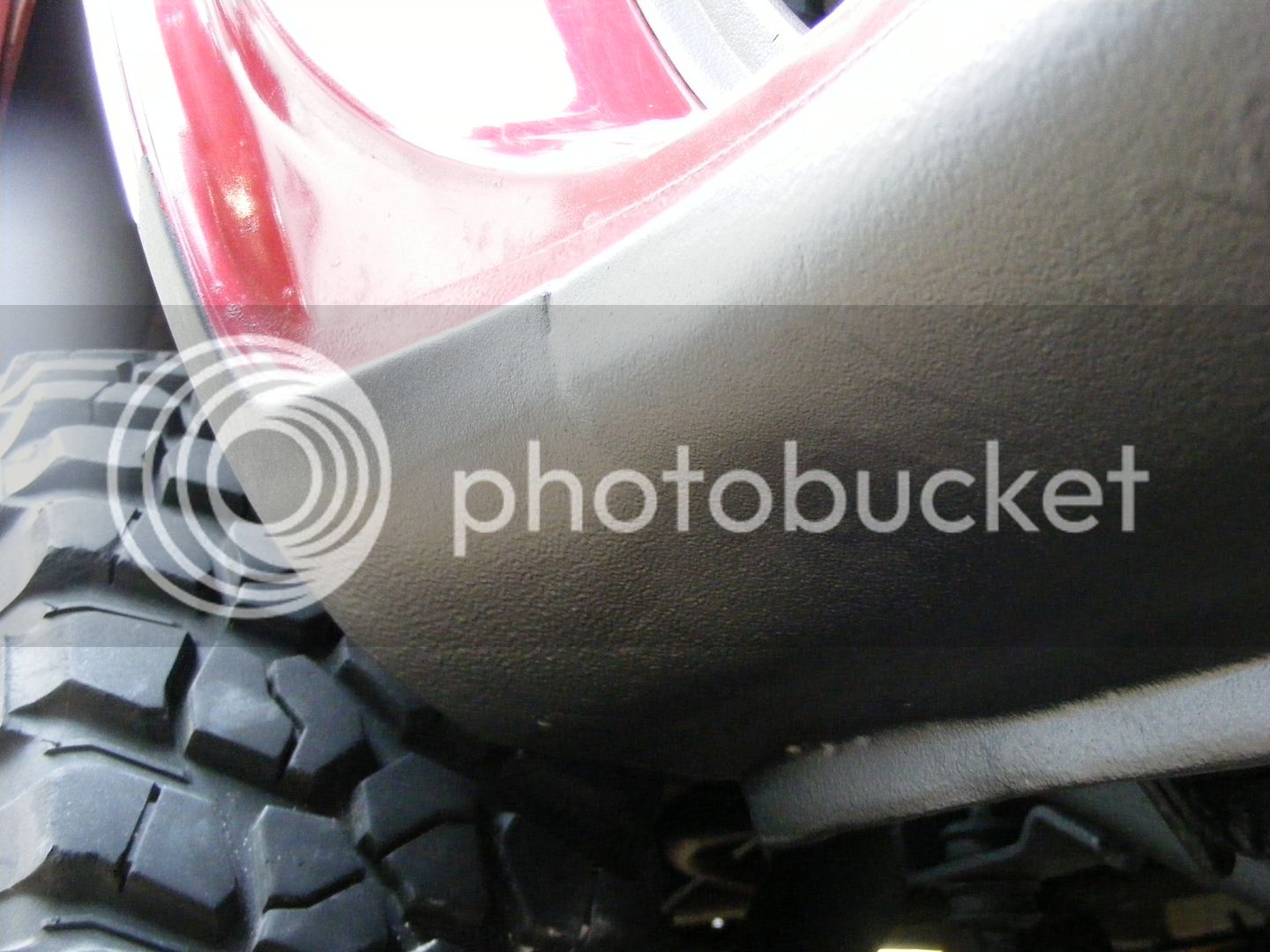

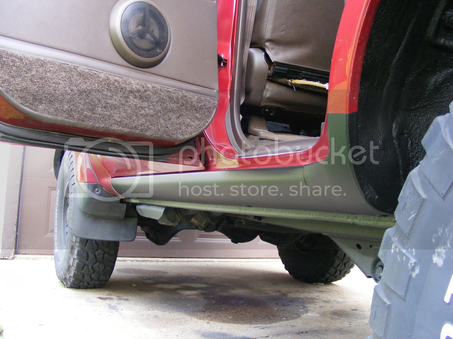

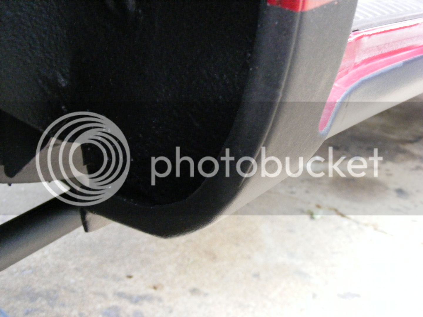

Also forgot to mention. Had to fix the only rust spot on the truck last week. So I cut out the bad section, and rebuilt the inner and outer structure of the rocker corner. Remade everything from the lower pinch weld, to the pinch weld for the wheel well. Nice and solid and rust free now! Had a good 4" hole before.
Painted the Rockers with Dupli-Color Bed Liner.
Its pretty spot on. Took a little fab work, and some grinding down the welds, but looks a lot better then before.
No rust on this side (Thankfully!)

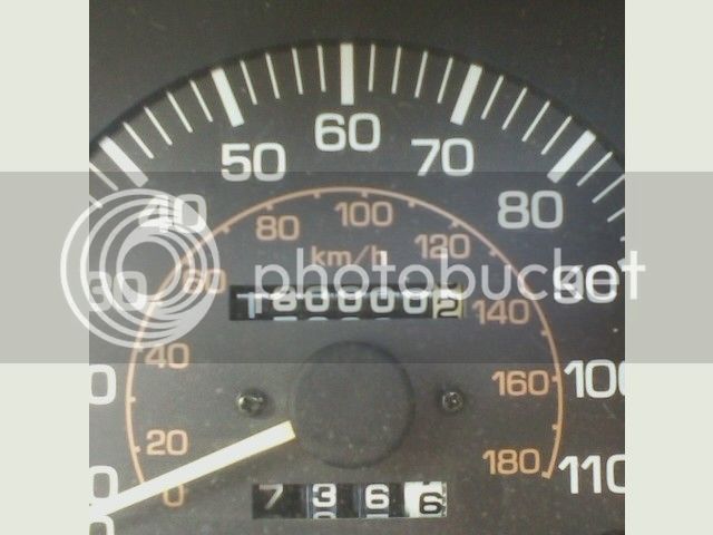

Also rolled over 180,000 the other day!

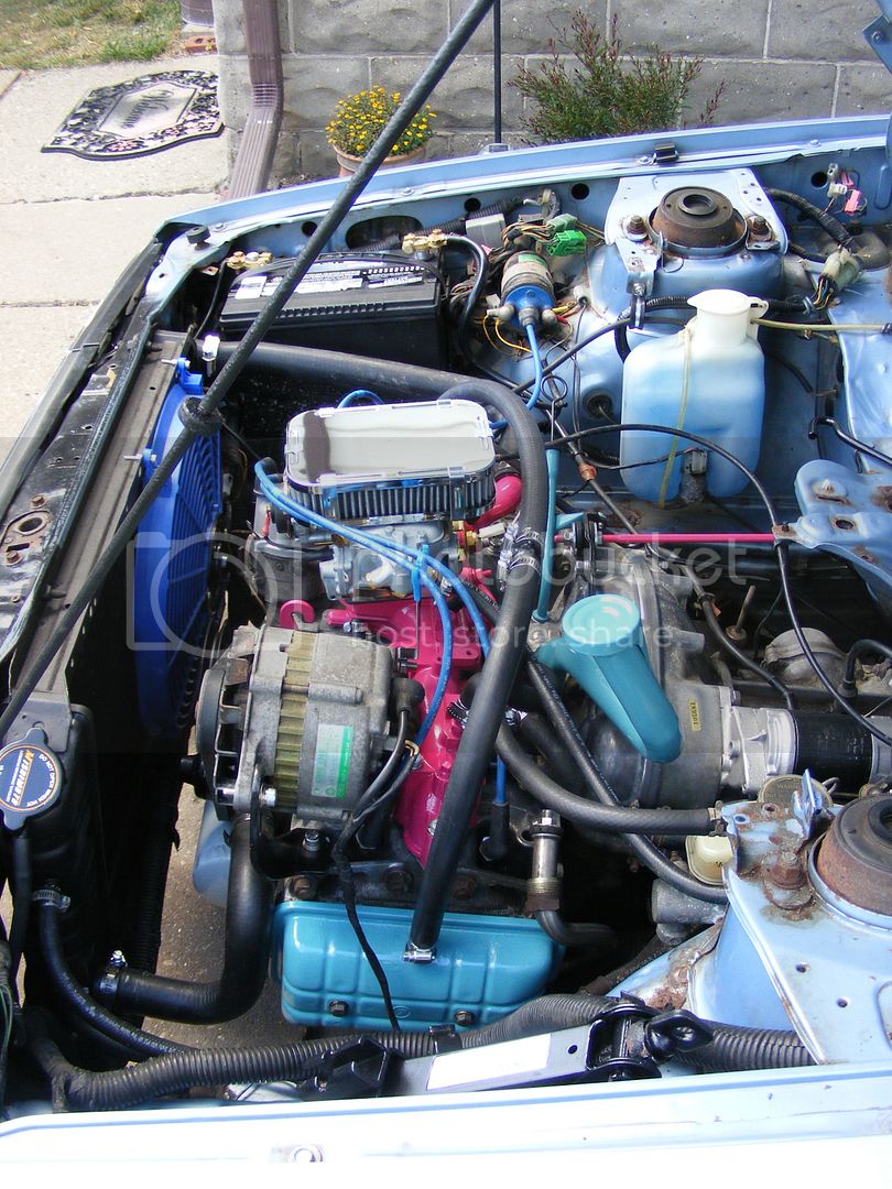

Also, a snag of my other project over the summer.
Full on Weber 32/36 DGEV swap, and motor reseal, refresh, and clean up, with all Stainless hardware.

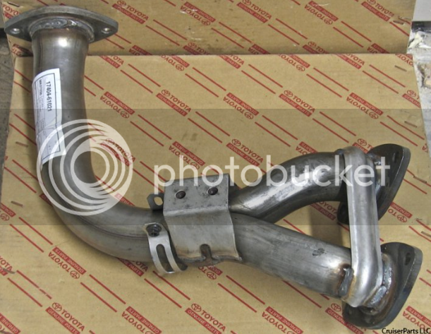

Does anyone have one of these y-pipes from a '91-'92? Mine is pretty rotted away, and would like to get a better one for when I put the new converter pipes on.
Don't really want to spend $250 on this one. So if someone has one thats better than mine, let me know :)

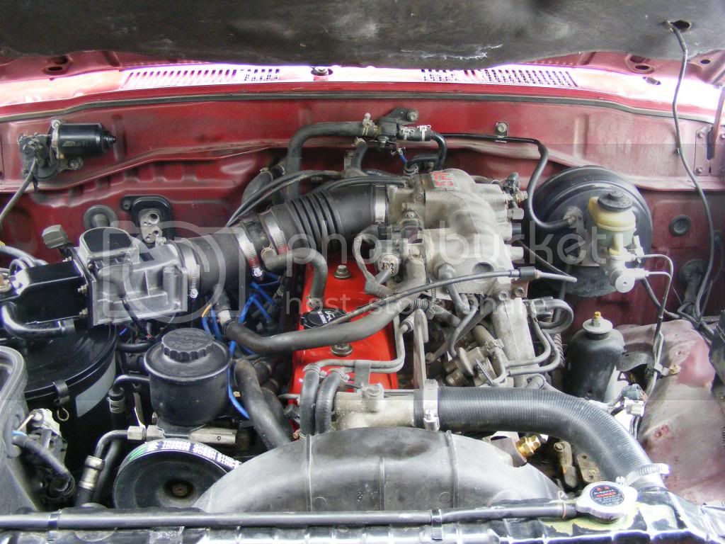

New Cat pipes in, cats deleted, everything welded up nicely, painted everything with black Header paint. New Denso O2 sensors in. Runs a lot smoother, and feels a little less gutless.
