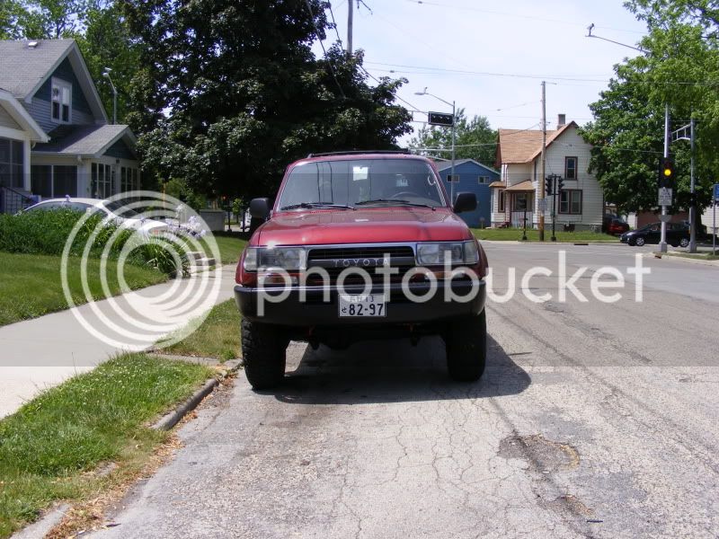

After messing around with the 80 today!
Swapped the springs around and installed Man-A-Fre spacers in the front.
^x2 Nice man stance looks even

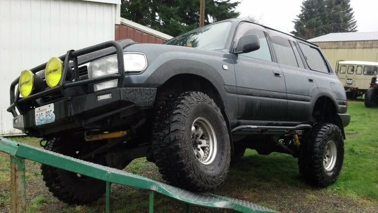

I believe these are 35s. Exactly how they got in there (spacers lift?) I still don't know. They do not contact anything, at least yet
More than likely you have a lift on it.
You can fit 35's on a stock 80 but they will rub. Fitting 35's doesn't require much lift at all 2" will do it with no rubbing. 3.5-4 and you can fit 37's and 6in you can fit up to 39's with no cutting.
Yes its a lifted Rig, OME Medium Load front/rear with front Man-A-Fre spacers.
I will have to take a picture of my 33s to show how close they are to the header down pipes, Other than that, 35s look like they would clear with ease.
