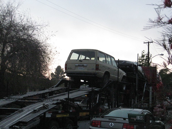

This project is not only stalled, I don't see it reviving. Life has moved to the point where it is redundant. I'm considering parting it out. Rust has arrived in the gutters and I'd like to see someone get it before it is too late. PM with any interest. If none, I'll be putting up a FS thread as soon as I figure out if it's going whole (with everything) or as a roller set-up for an SBC/700R4 combo.
Oh noooooooo! Sorry to hear this bad news. Hopefully someone will just take it over and complete the build. You have done some amazing work and I would hate to see it broken up. Let me know if I can be of any assistance in the process. If you decide to part it let me know as well as I may scavenge parts from you for another project I am considering.

My wife has taken to the pop-top camper/CTD Dodge pick-up like I never expected. Doubt that I'll be able to get her back into the off-road tent trailer. Being able to cook inside is too much of a bonus to her. Strike one. As the CTD is an extended cab it fills the "need to haul other folks around" need. Strike two. Then the opportunity to own a truck that I've coveted since the PO first started the build came up and I jumped. Strike three. In order to slim down the number of vehicles parked around here I'll likely sell off Patch as well.
Best of luck, @ntsqd . And if circumstances change and you find yourself blessed owning another 60 in the future, us folks here in the 60 section would once again be grateful for your contributions to this 60 Forum!
