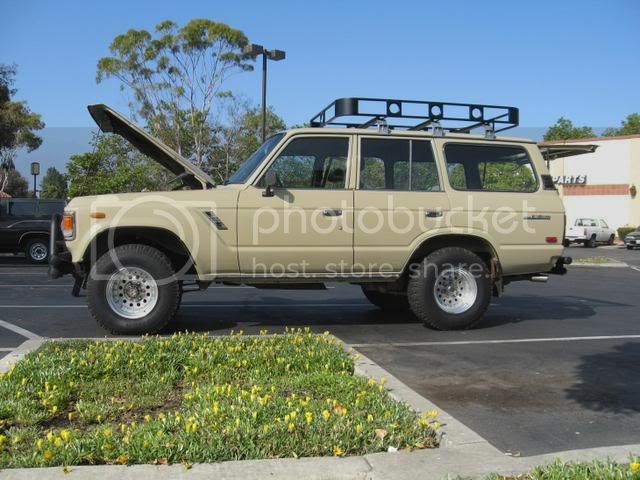

The vehicle: 1984 FJ60 with 270k on the ticker. Two of the 4 keys came stamped with the name "Wallace" on them. Presumably one of the PO's names, but that is now the truck's name. I got it semi-locally, but from the stack of receipts it spent a fair amount of time in the Woodland, CA area.
What Wallace looked like when purchased:

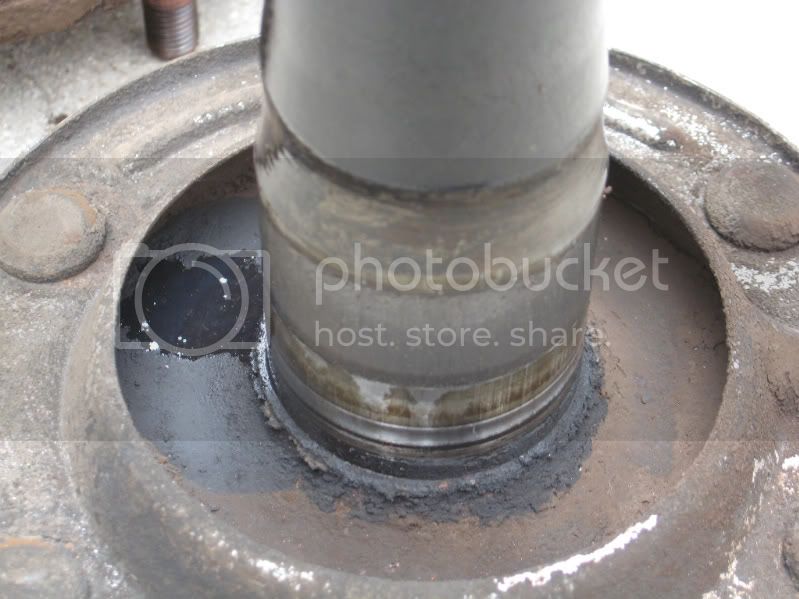

In driving it I started noticing a rumbling noise. My friend Ruben always teases me about hearing bearing noises. this time that is what the problem was.
So the cure is:

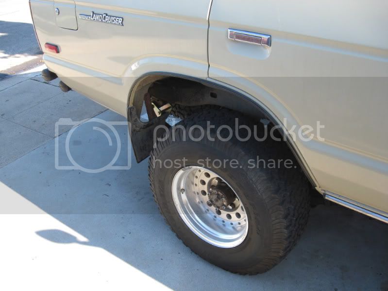

Shortly after getting the FF rear axle in place I happened to really give the tires a looking over. Plenty of tread left on them, but the sidewalls were badly checked. They may have been worn funny as well because the truck still had some odd noises and behaviors.
My '84 Mini (this year is getting habit forming!) was shod with 33-10.50 BFG M/T's that were a failed experiment when several years ago I was about to take off on a ~2500 mile trip. I really didn't want to have to listen to the M/T's sing that whole way so I bought some new 33-10.50 A/T's. While I was at it I swapped out the 15x8 steel "rock crawler" (dang but those are heavy!!) for some alloys. Fast forward to now when the 60 needs tires. So back onto the Mini went the M/T's (on the alloys) and I moved the AT's to the 60 on it's existing wheels. The steel wheels went to friend with a ~12 y.o. boy who is hard on equipment, just like his dad. It should take him a while to bend those wheels on his short bed J-10.

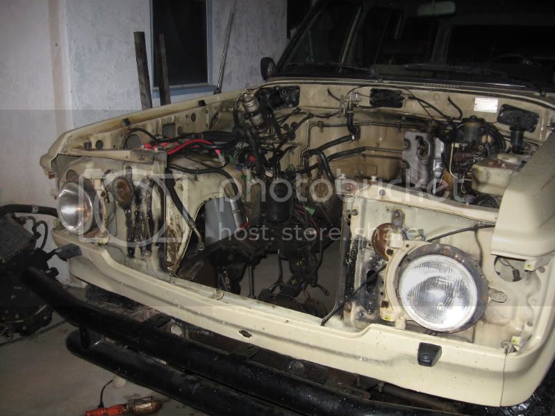

Current status of Wallace; the engine fell out!
The good news is that the 2F is going to a 60 that has been marooned in a NM repair shop's yard with a rod through the block. Suspect the killer galley plug let the oil out and the numbnutz driver kilt it.
