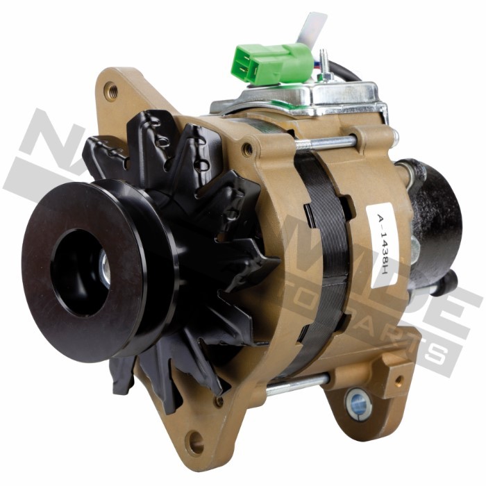

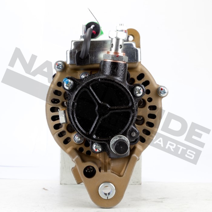

Will I am running 12v. I sourced the starter and alternator from a 2H I had.
Roger that. So the 2H 12-volt starter and 12-volt alternator/vacuum pump will work on the 12HT engine?
Correct! On the outside they are identical. On the inside there are a few differences.
Just be sure you can use the internally regulated unit. I’m pretty sure mine is external. Either can work but it is usually best to match what you are already wired for/using.
