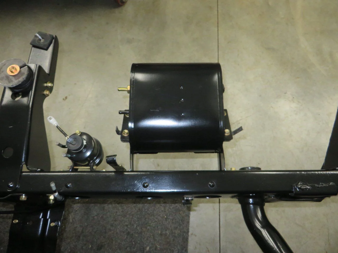

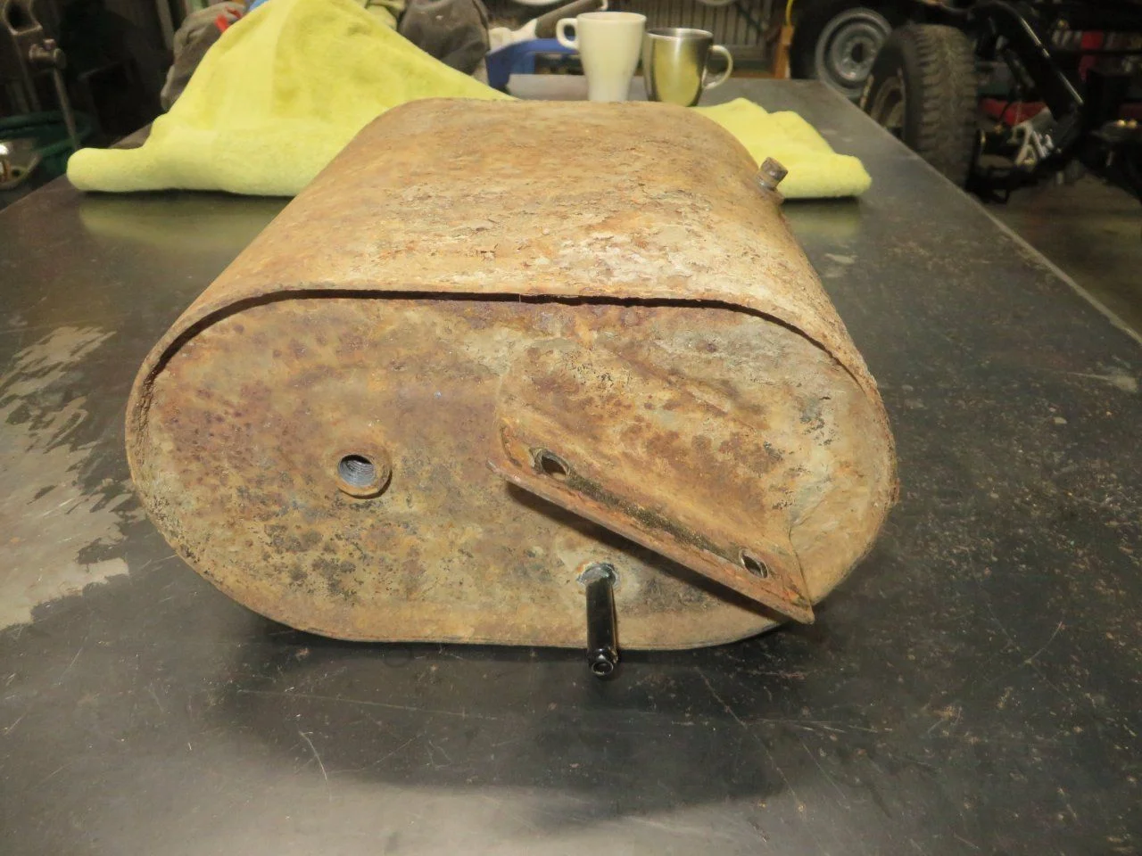

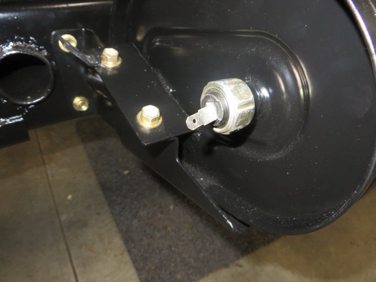

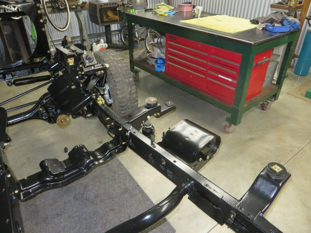

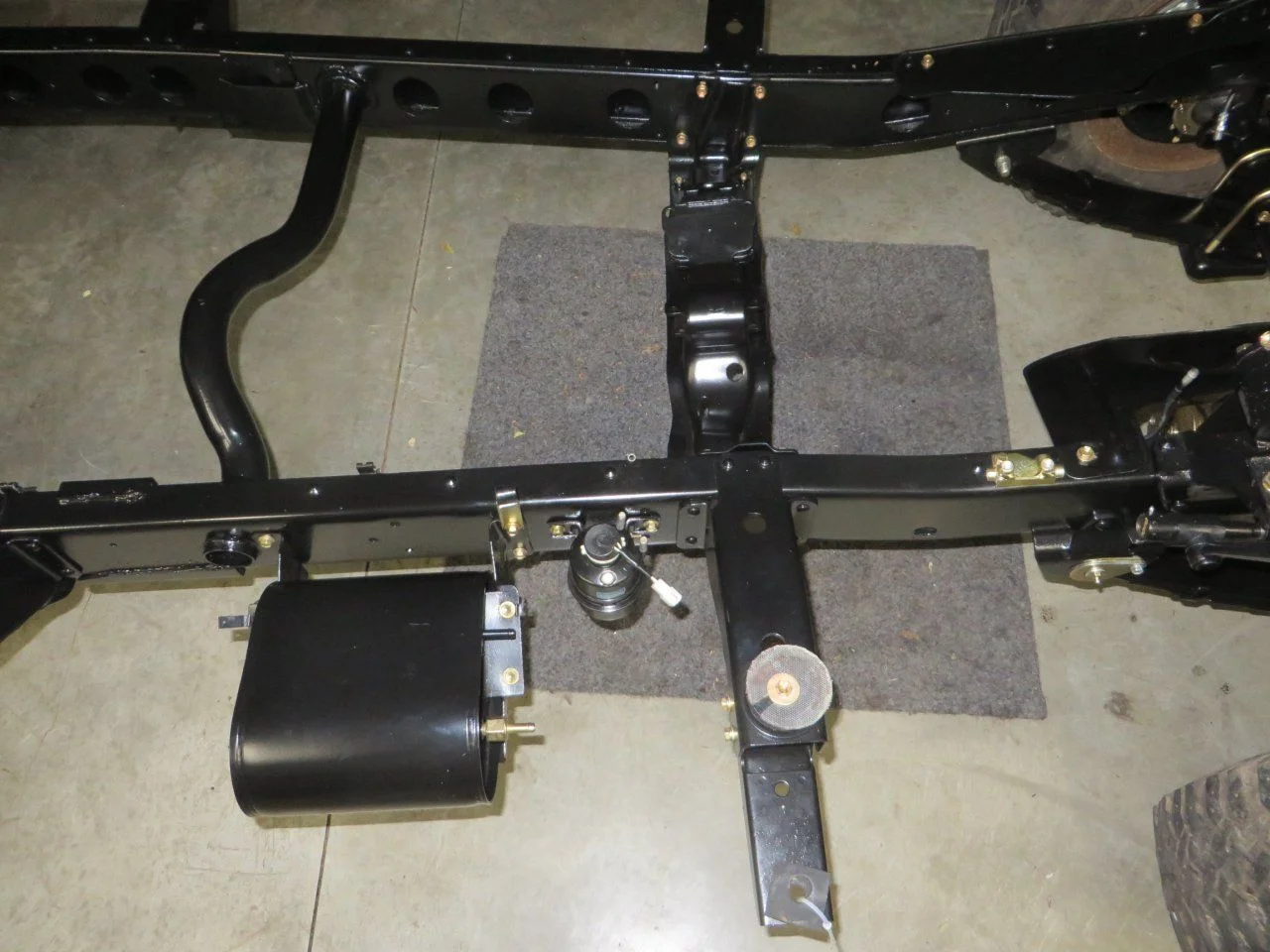

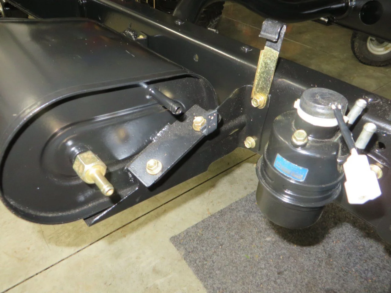

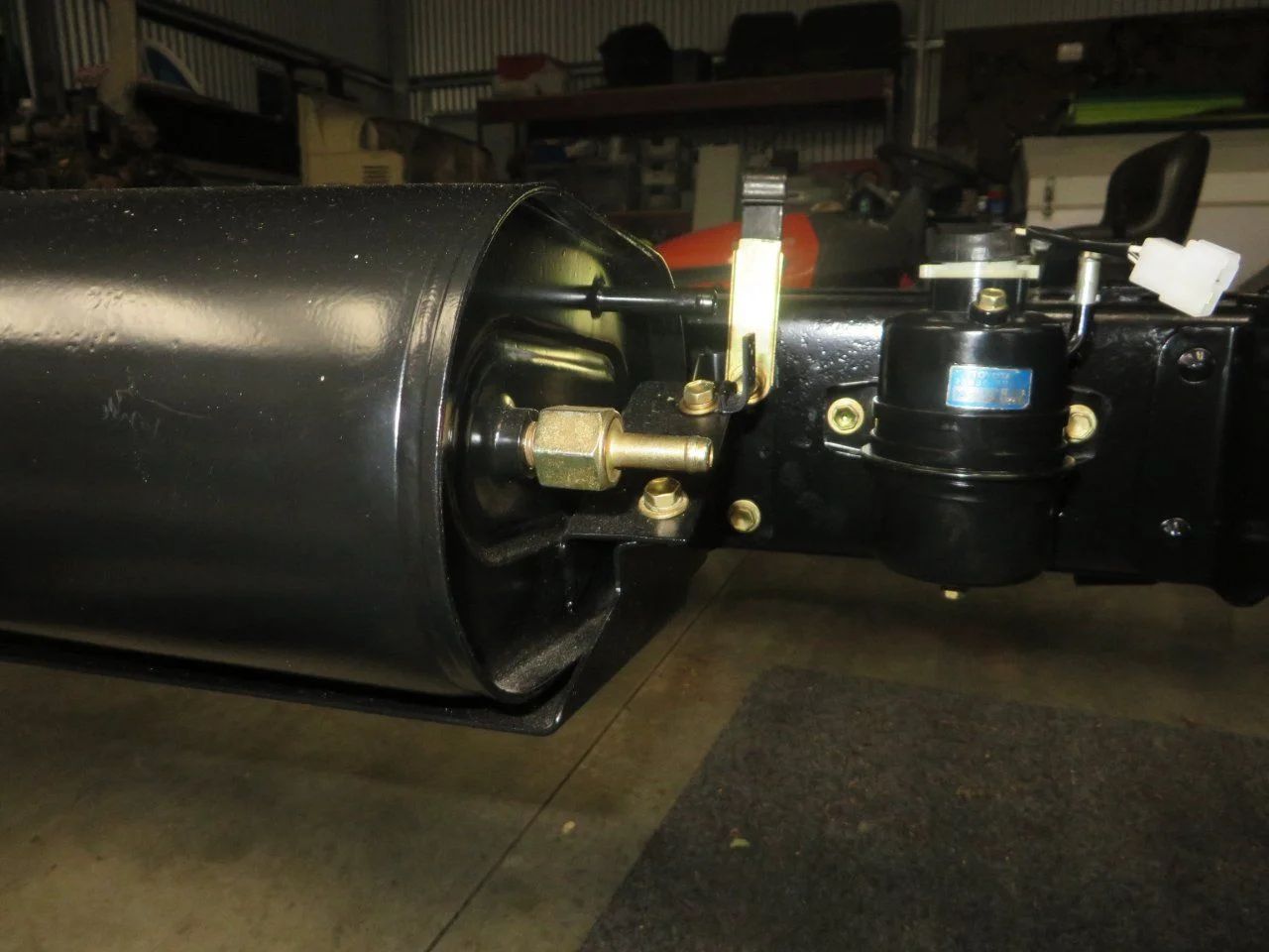

This is an old one I picked up a while back. I needed the mounting bracket from it. The original one on Mario was pretty bent up. You are welcome to this one if you want. I can give you weight and dimensions if you interested in getting a quote on shipping. It doesn't have the check valve or the pressure switch. I hope the pics help. Cheers, Ben

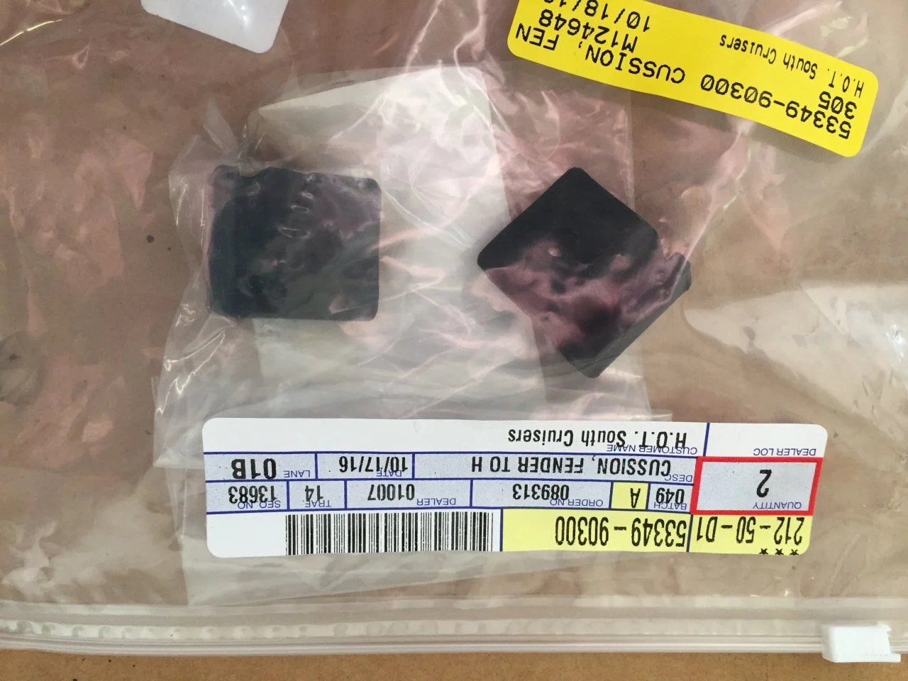

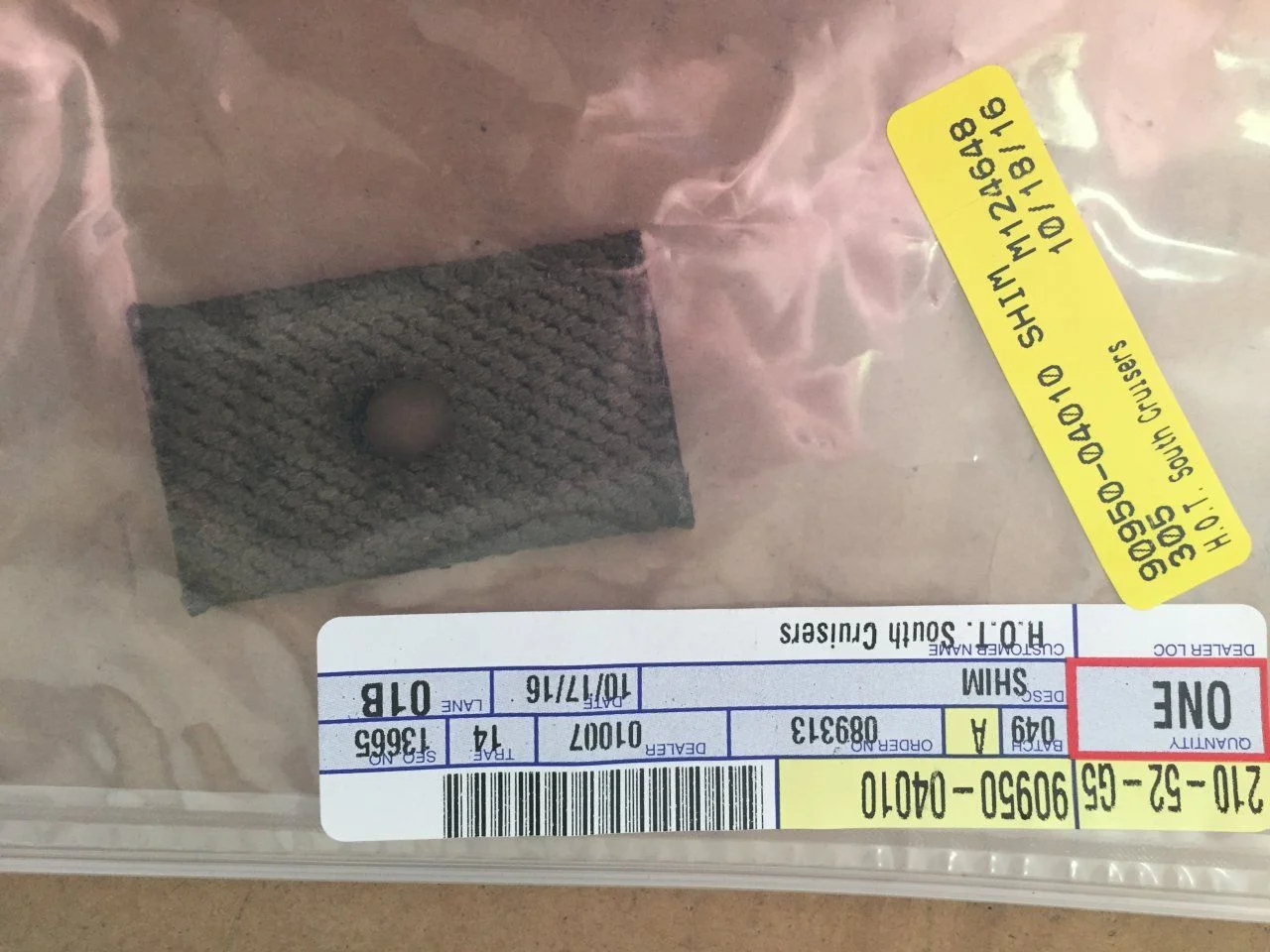

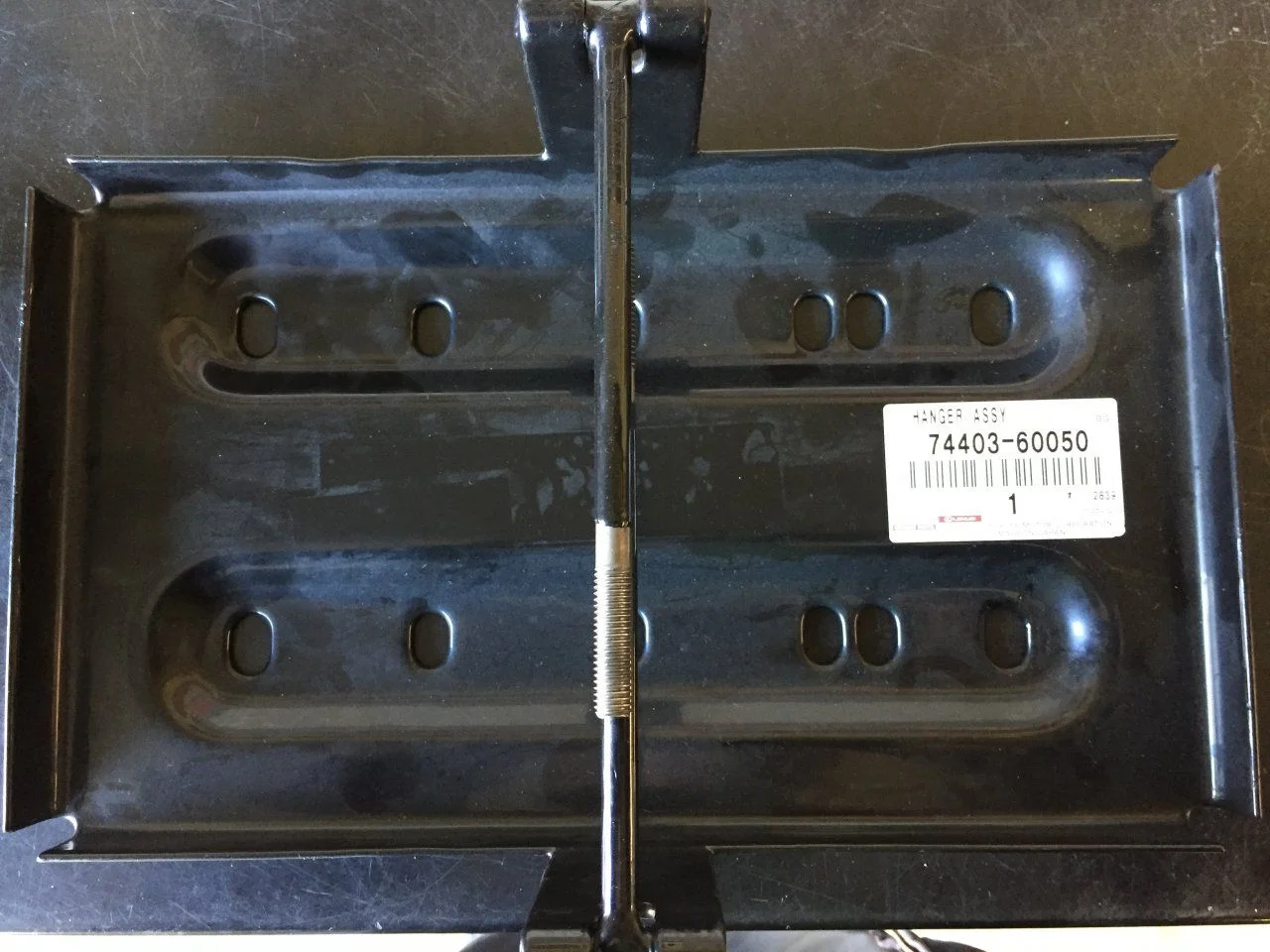

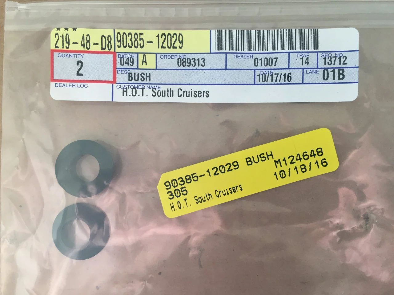

I received a few parts this week. I'll be posting pictures of them so others might be able to use the part number at their local Toyota parts counter. I bought the apron cushions from Toyota after 2 attempts with aftermarket units didn't fit. I also found the radiator shims are still available from Toyota and the 12" battery tray, as well as the bushings that fit around the bolt in the parking brake standoff assembly. I apologize for the inverted pictures. They area not that way on my computer, but when I upload them they rotate for some reason.

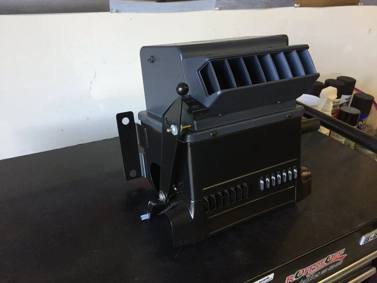

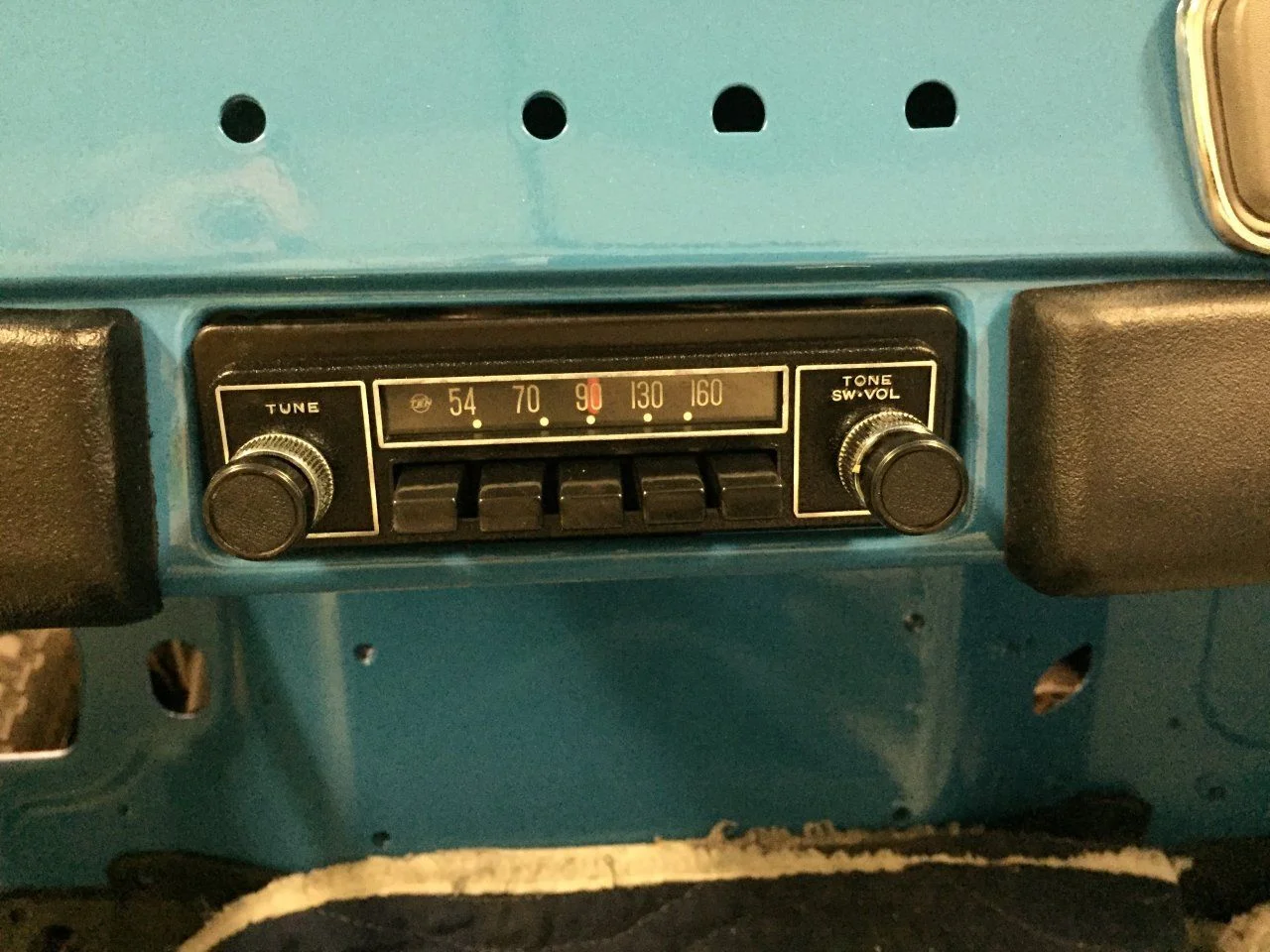

I did receive one other part this week. It did not come from the Toyota parts counter. I decided to buy a refurbished heater instead of finishing the one I have on the shelf. I also made some progress today in getting a few parts bolted on. @shmukster Gary that old radio you sold me cleaned up very nicely!

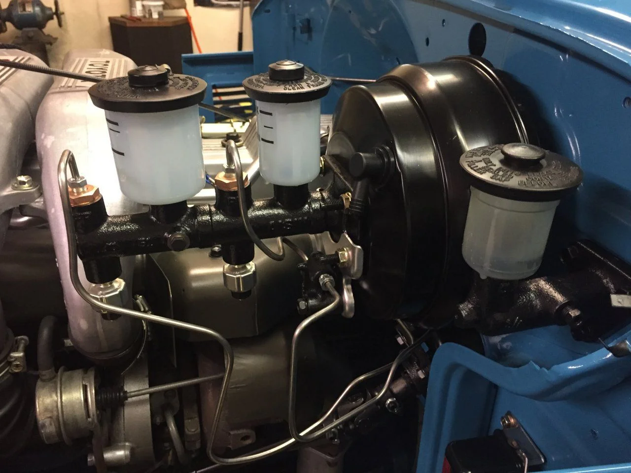

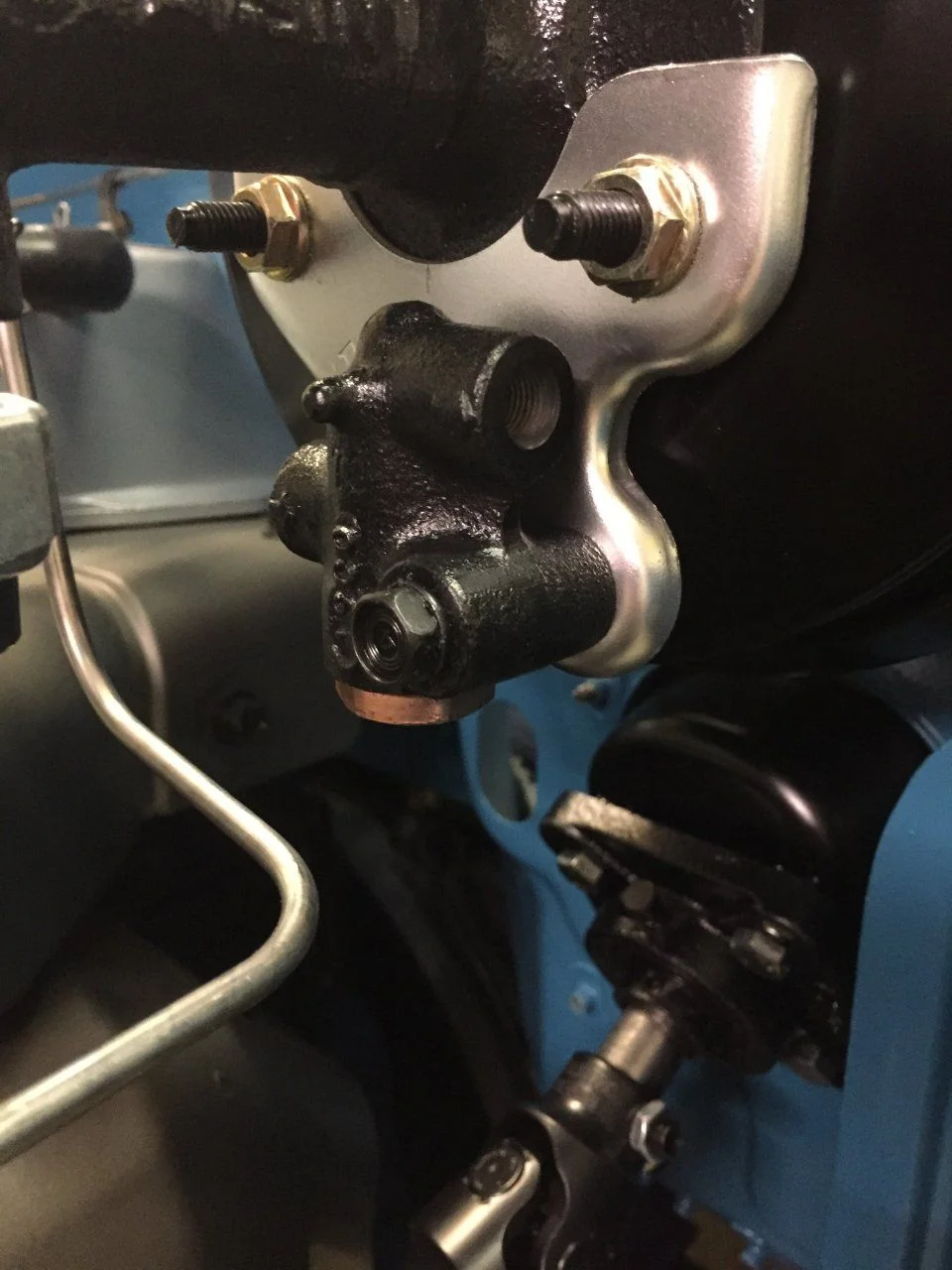

I didn't make a lot of progress over the weekend, but tonight was a much better night. I installed the refurbished glove box door. Then I worked on my proportioning valve and brake line install.

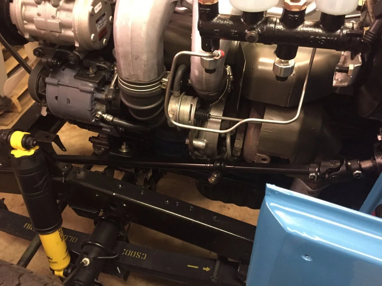

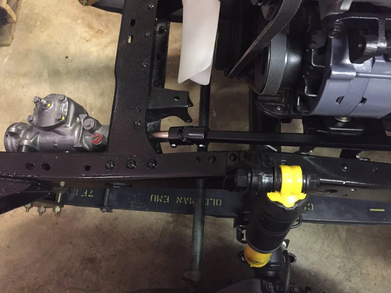

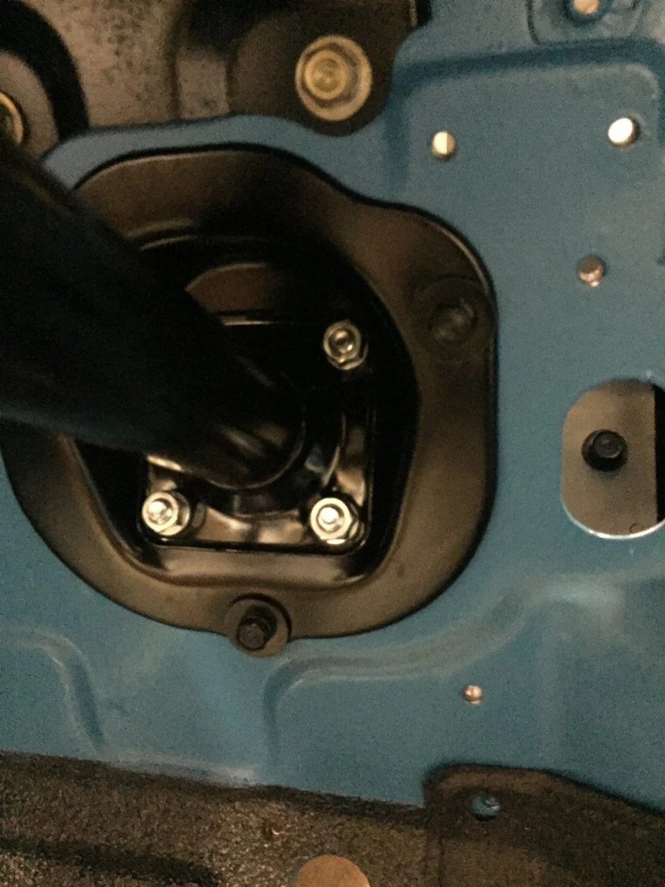

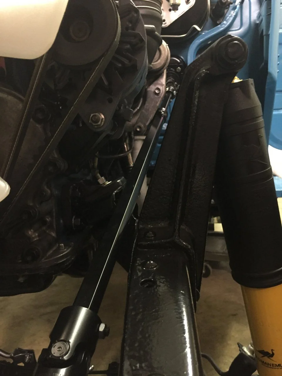

I also worked on installing the steering column and the sector shaft to the gear box. It's a might bit tight! Maybe too tight. Nothing is touching, but with torque it might. I'm not certain this is the final configuration on this setup. At the motor mount there is about 3mm of clearance.
