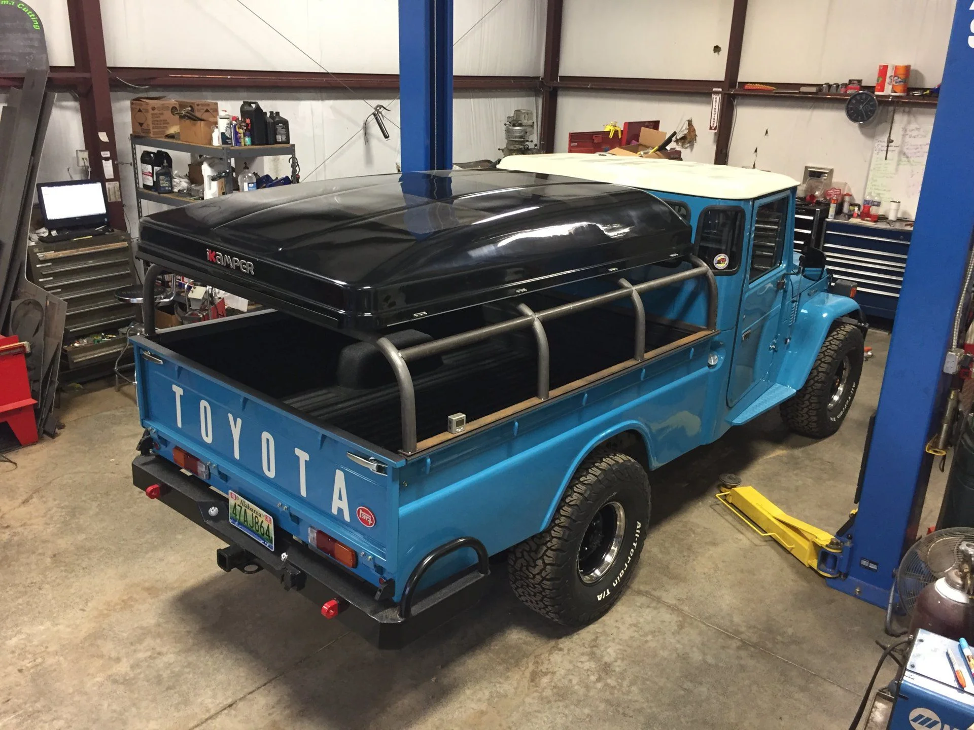

Here’s a few more for you.
Go reverse orientation like in pic #3. Looks great!
That looks great! I also like the reverse orientation the best.

Dan and Mark I will definitely be mounting it in the reverse direction.

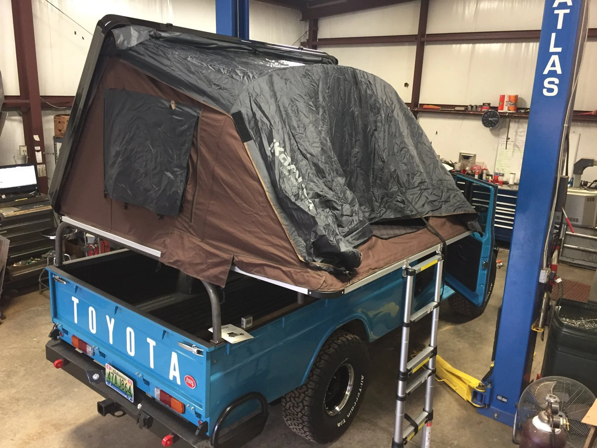

Ben the RTT is actually an iKamper Skycamp. I have a stove/kitchen on the way. I am considering a fridge and a shower. Mulling over plans for an extra fuel cell/water tank. I hadn't thought about expresso machine, good call mate! I do like my coffee!!
Peter I almost ordered the Satin black version but it was a $250.00 upgrade (the only color choice with an upcharge). But I like the contrast of the black and blue. Sometimes you can get too much of a good thing. The bed rack will be covered in black canvas. I'm hoping with everything on the bed in black it will maintain the aesthetics of the truck.

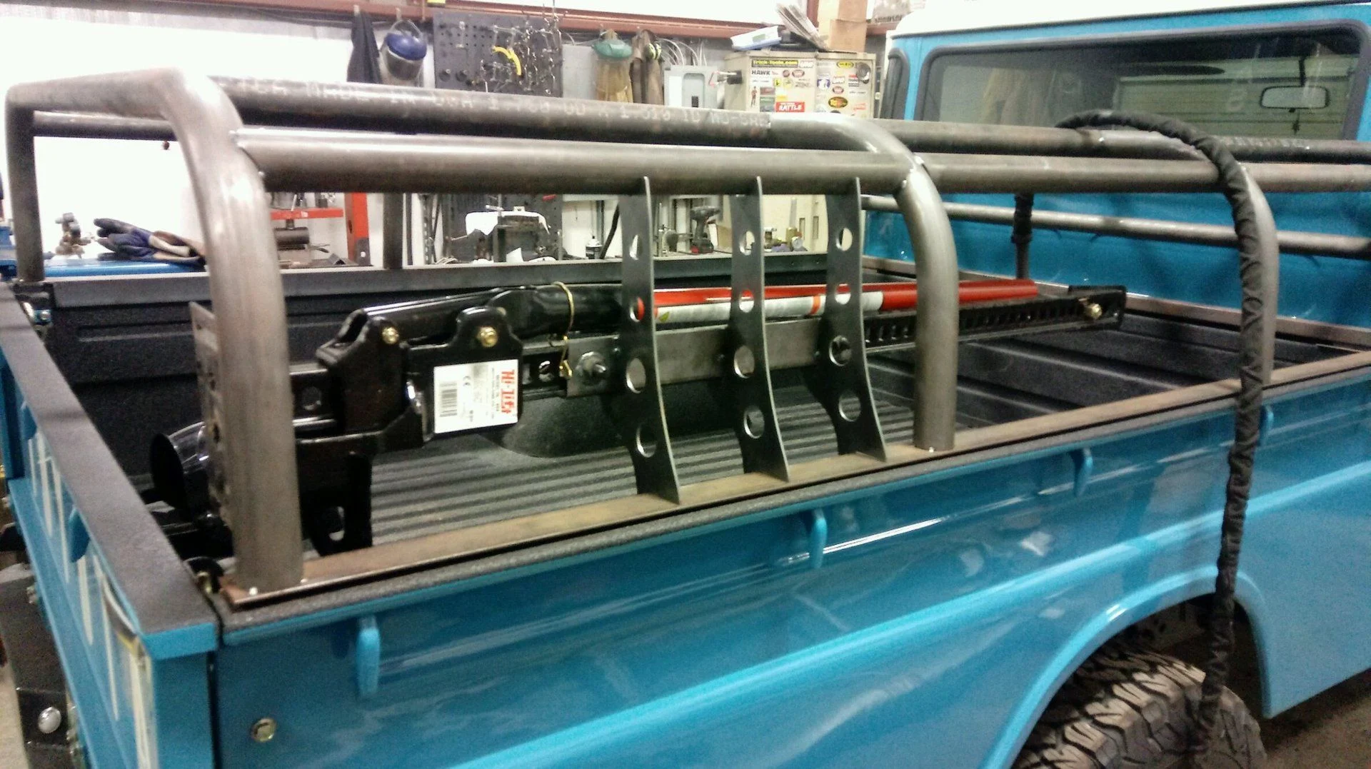

A little more progress. John has the high lift mount mocked up.

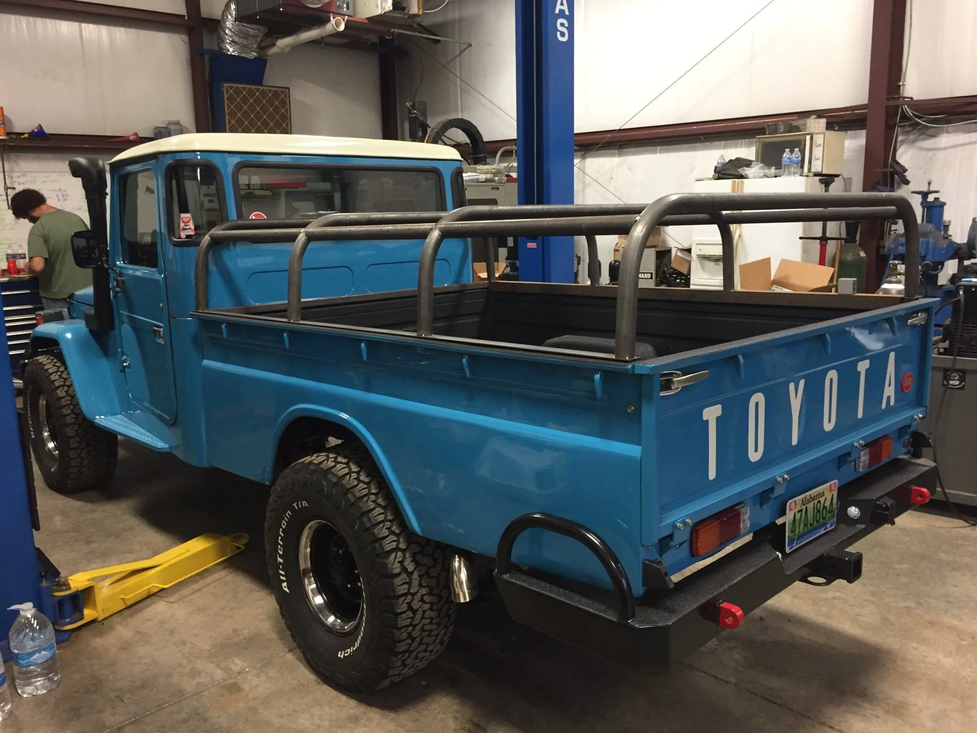

Assembly of the bed rack is complete. I’ll pick it up from the fabricator this afternoon and then it is off to blasting and powder coating. I’m very pleased with the entire job but I think the Hi-Lift mount is especially awesome!

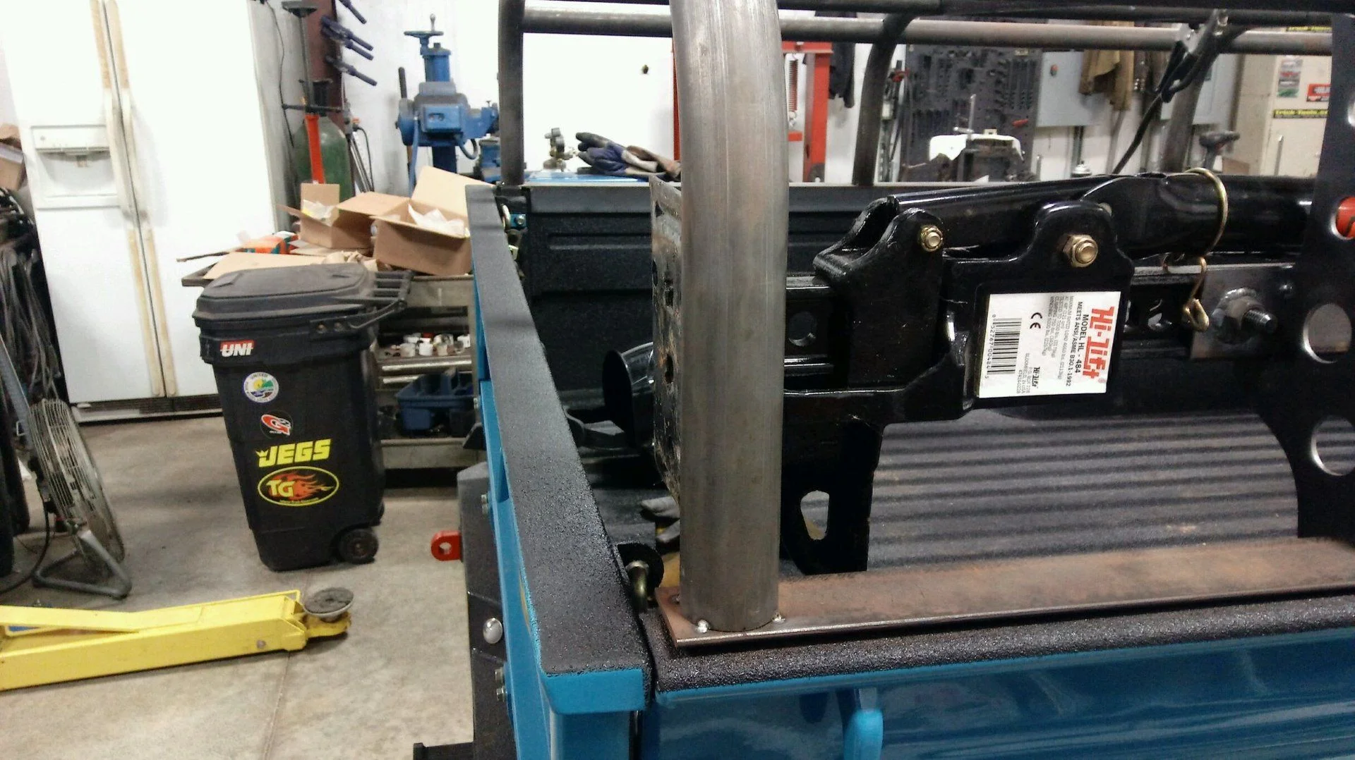

Hard to see...but it looks like it's secured by a couple bolts on those rear posts...and maybe a couple more at the front of the bed side?
- Brian
Brian you are correct. There are 3 bolts on each side at the front where the headache rack was installed being used to secure the front. There are 2 holes on each side at the rear stake pockets I’m using to secure the rear. These holes were designed to secure the optional wooden bedside extensions. No extra holes were made the secure the entire rack. This was one of my major design objectives.

Wow whats that weigh? With the RTT on it and everything. Looks pretty beefy
Brett the rack is about 150 lbs and the RTT weighs 150 lbs. I think the extra weight will make the 45 ride very nicely.
