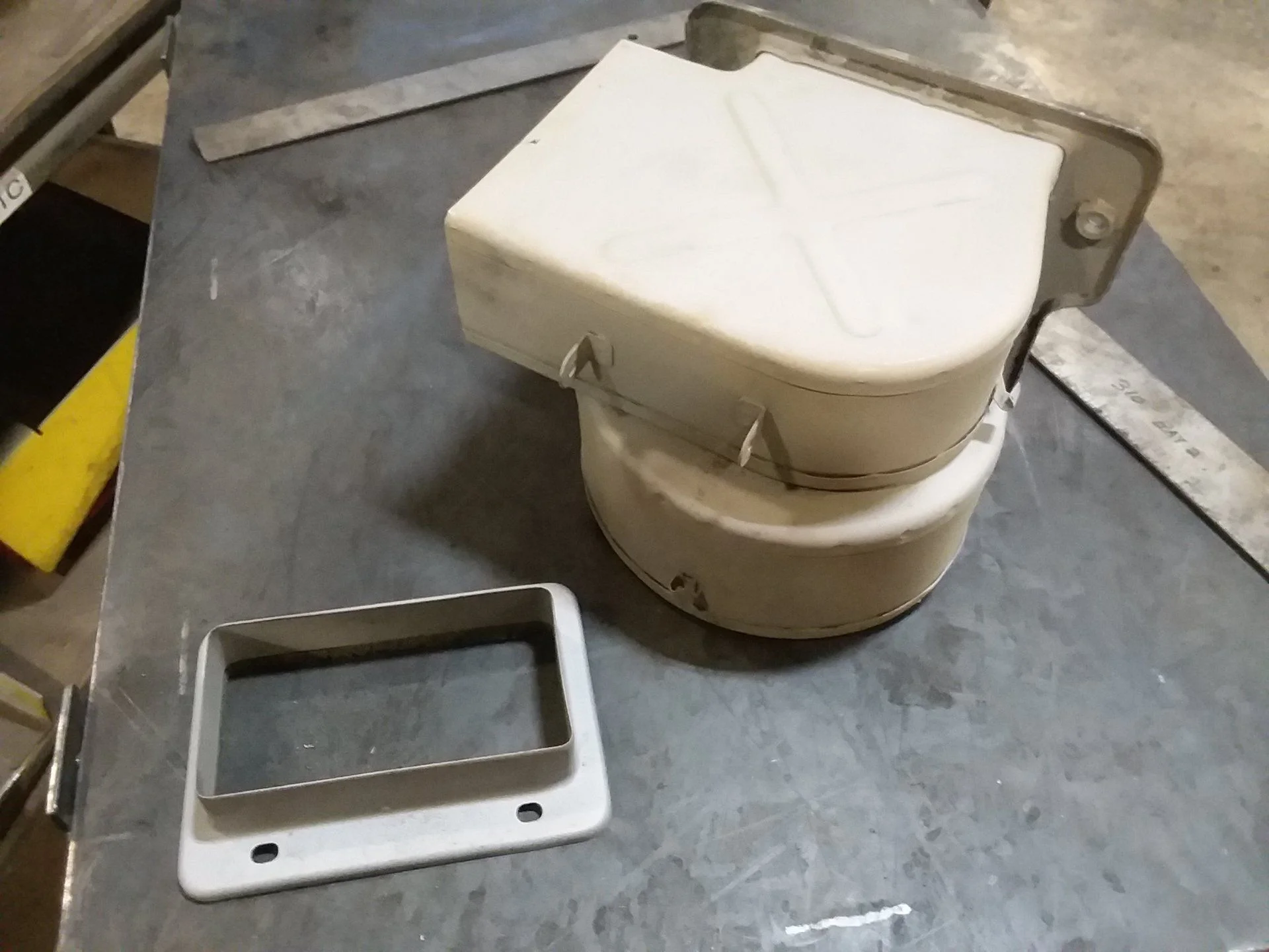

I was having a difficult time finding the rubber boot to the blower so I decided to delete the rubber boot entirely and replaced it with a custom "wind tunnel". I am really happy with the results. Anyone with a little bit of time could do this as well. Here's how I solved this problem in my 69' 55.
The old boot was nonexistent. I searched the web for a replacement but didn't have any luck. SOR had one for a 40 series and I'm not sure if it would have fit. Even so, I was more interested in finding the alternative.
I began by measuring the gap (front, back, side to side) then I pulled the unit out and took it to the shop.
When measuring the gap from front to back I determined that I would need move the blower forward about 1/2". I would need to make some kind of spacer to put between the firewall and the blower. I found a piece of 1/2" UHMW (Ultra-High-Molecular-Weight) Polyurethane. which is basically a really hard plastic material but is also easy to work with. I pulled the original rubber gasket to use it as a template.
Once I had my shape I just cut it out using a drill and a jigsaw

After I had it all cleaned up a bit I decided that I wanted to replace the screen that sits on the blower. I took the old screen and simply traced it out onto some material that we've had laying around. It was the perfect choice.

It was now time to begin constructing the wind tunnel. I took some really thin mild steel, I think schedule 22, maybe?. I'm sure tin would have worked well also. And I began cutting my pieces.
Using only a vice and my hand I then started shaping them.
I basically made four pieces, one for the top and one for the bottom along with two sides. It took a bit of trial and error but really was not too difficult. Just worked until ending up with a good fit before tacking things together with a welder. Keep in mind that the blower, the wind tunnel and the sidewall mount are not welded together. The wind tunnel slides over the blower and the sidewall mount.

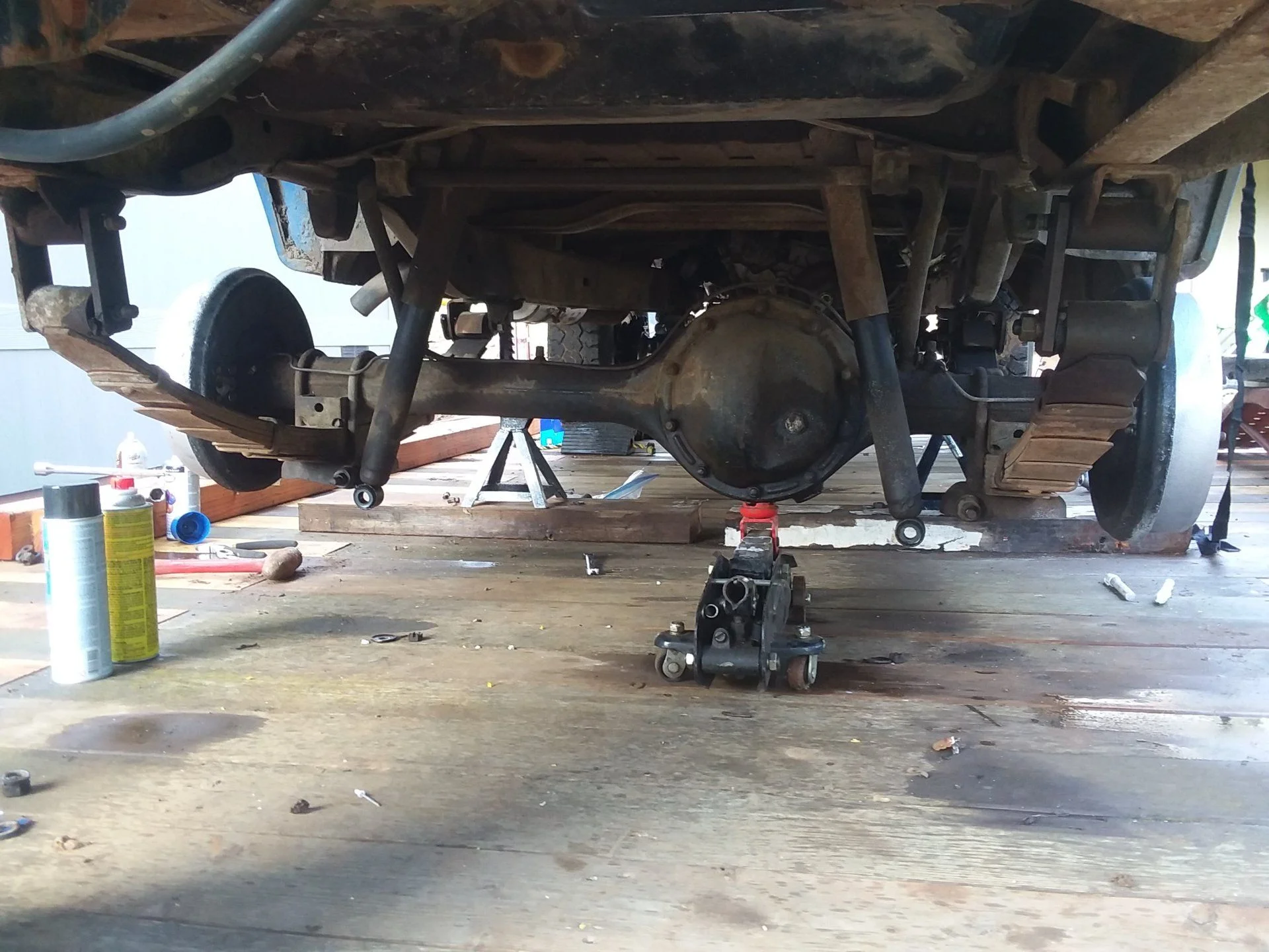

I had a minute to spare today so I ran outside and pulled the rearend out from underneath the 69'. I have been anxious about opening up that differential after noticing all that play in the input shaft. So I began by lathering all the nuts and bolts the day before in penetrating oil.
The bolts came out nice n easy.

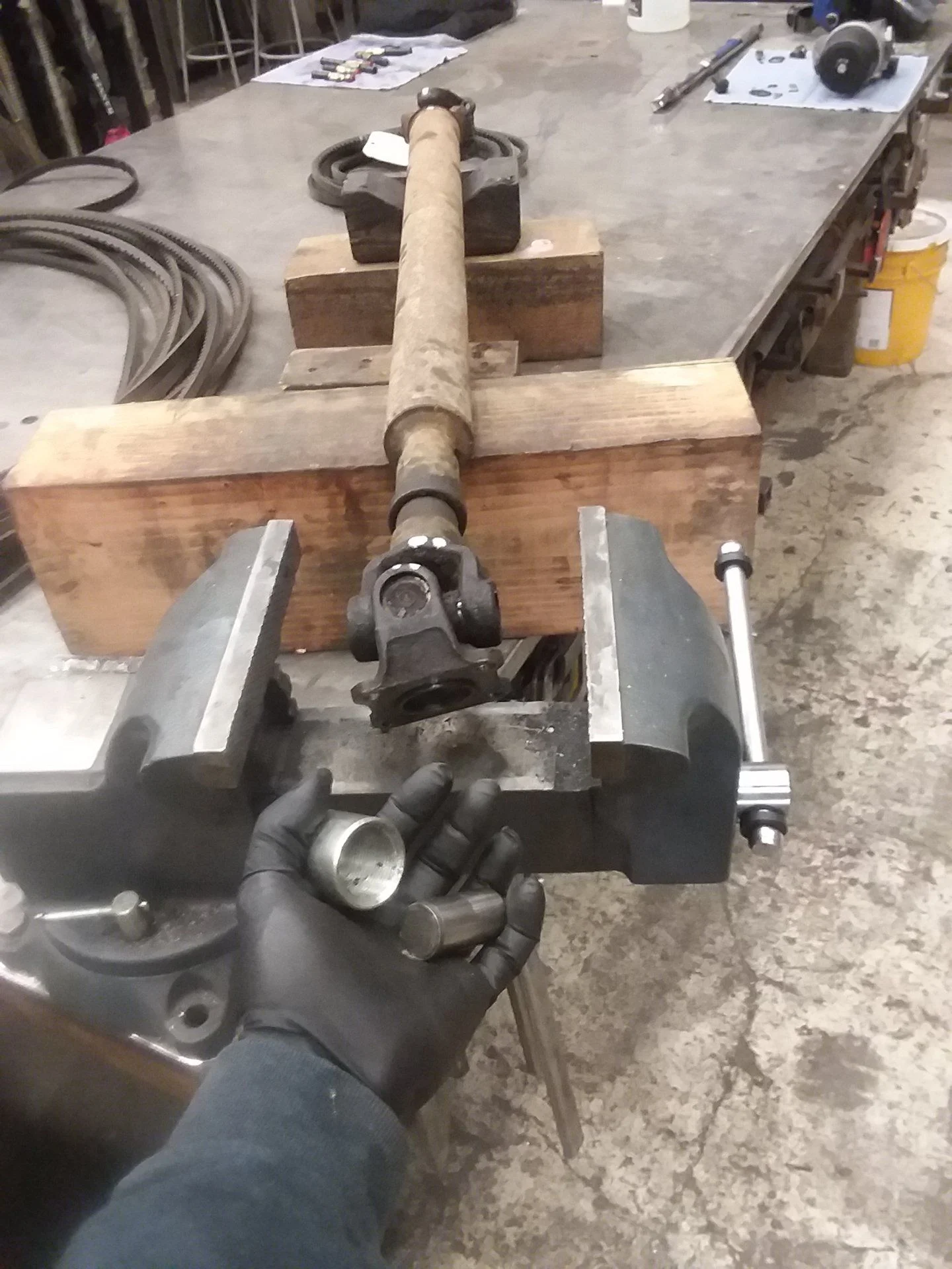

I don't have gears yet but I do have U-Joints. This method may or may not be the best but this is how I have always done it and it works for me.
I also made matching punch marks on the appropriate flanges to help ensure proper installation of the drive shaft.

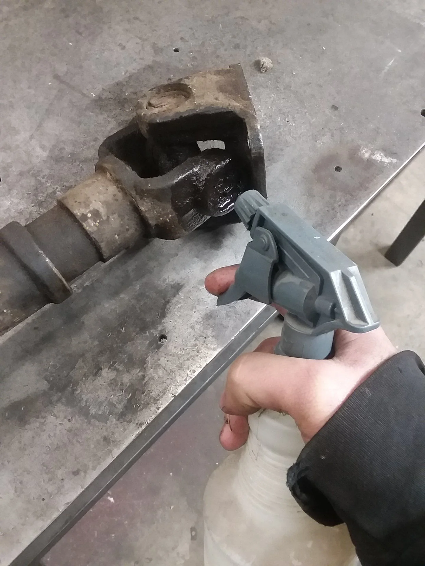

I like to spray the old joints down with a penetrating oil or in this case whatever I had on hand, WD-40

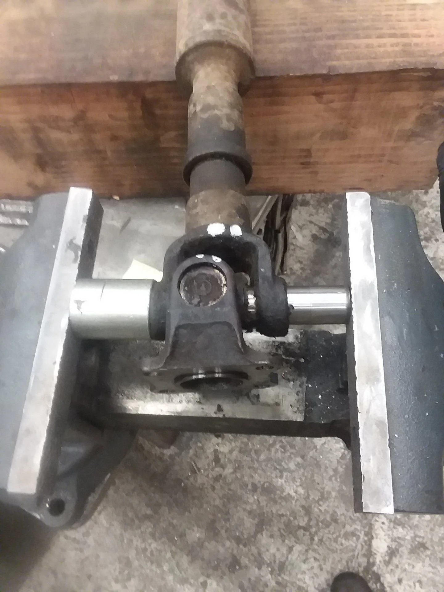

Next I used a dowel pin and a 1 inch pipe Coupler.
Slowly and evenly apply pressure using the vise.

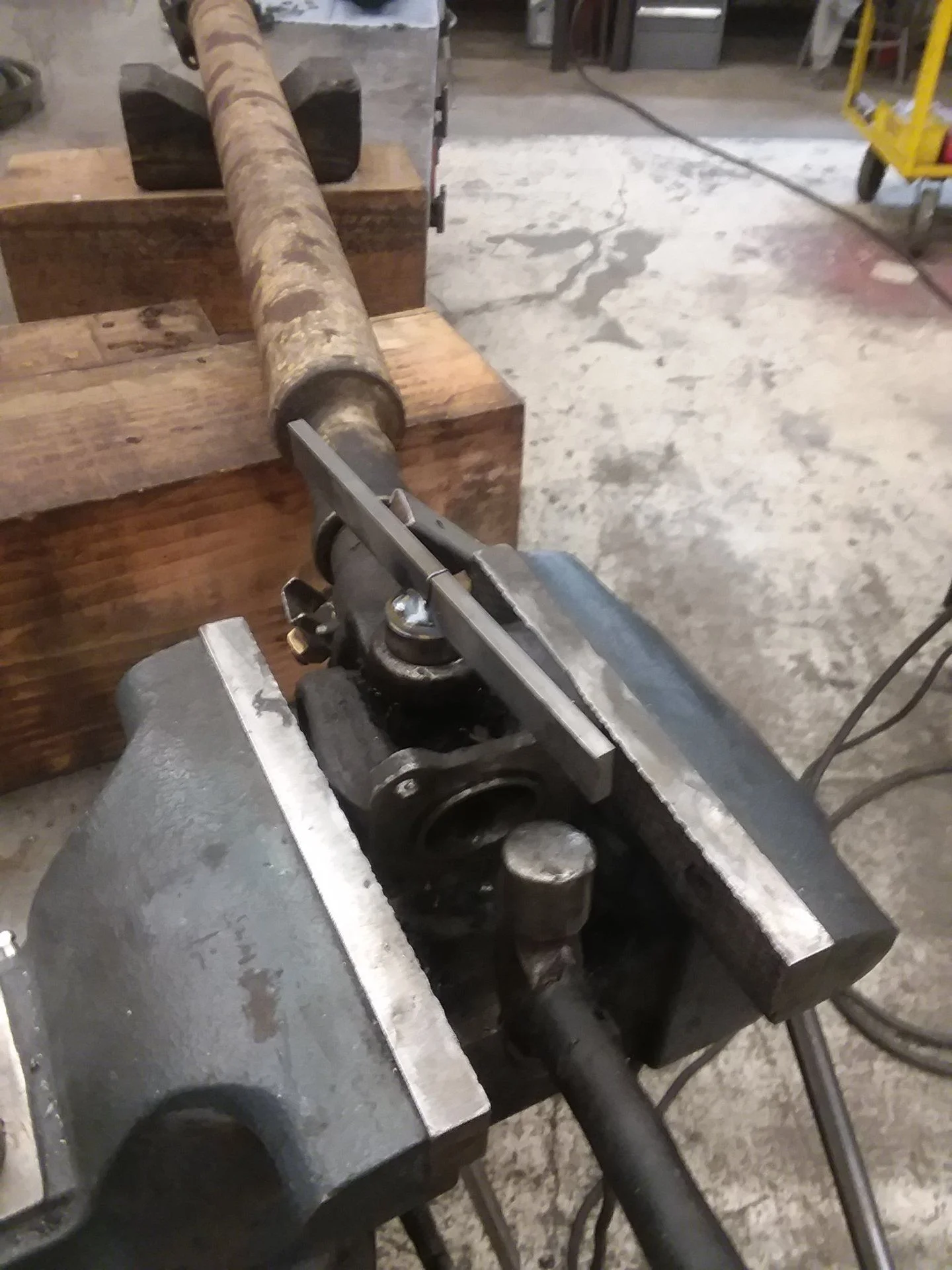

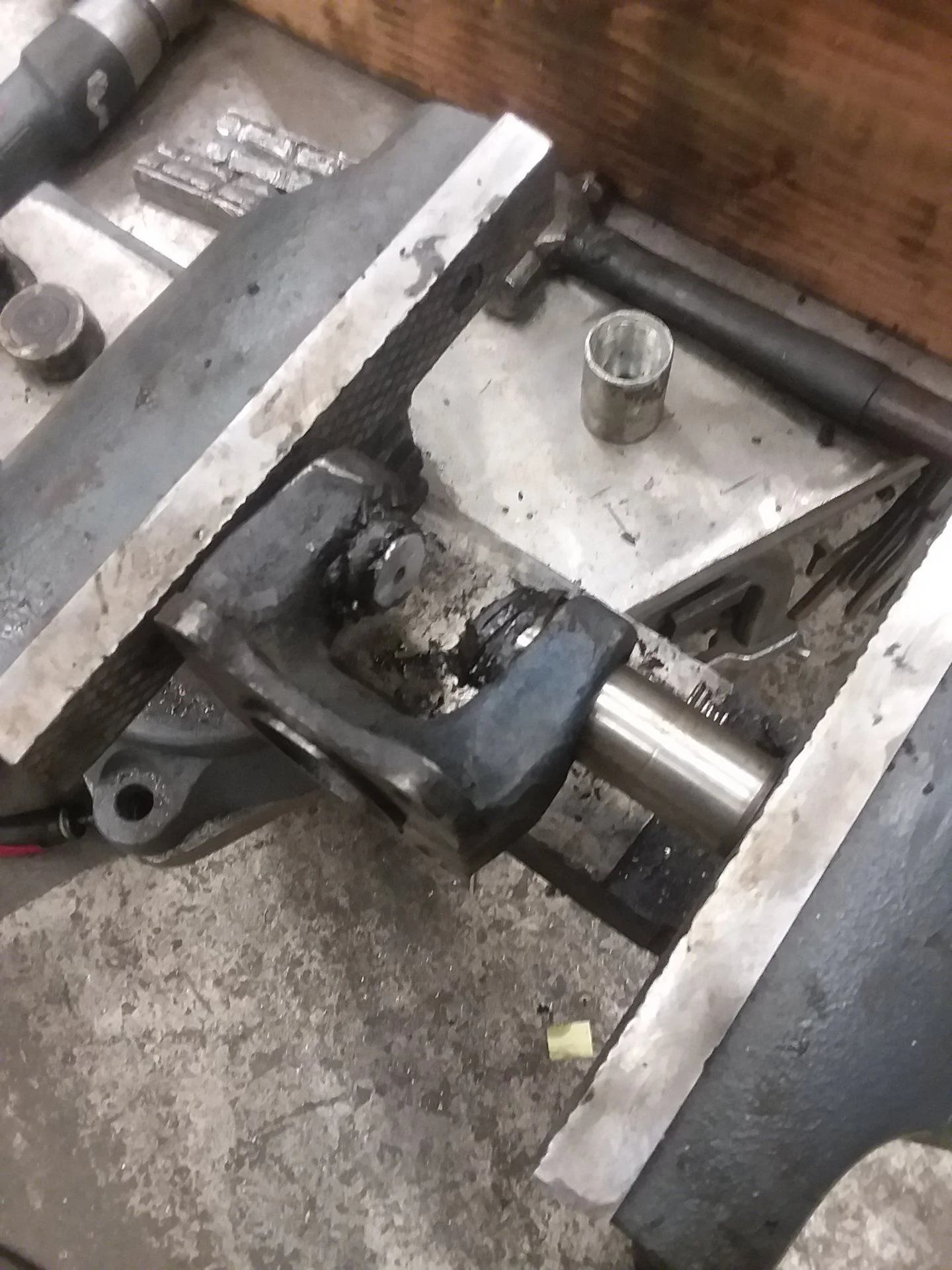

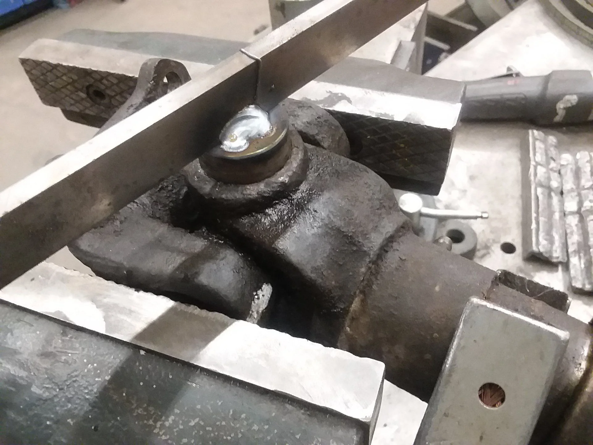

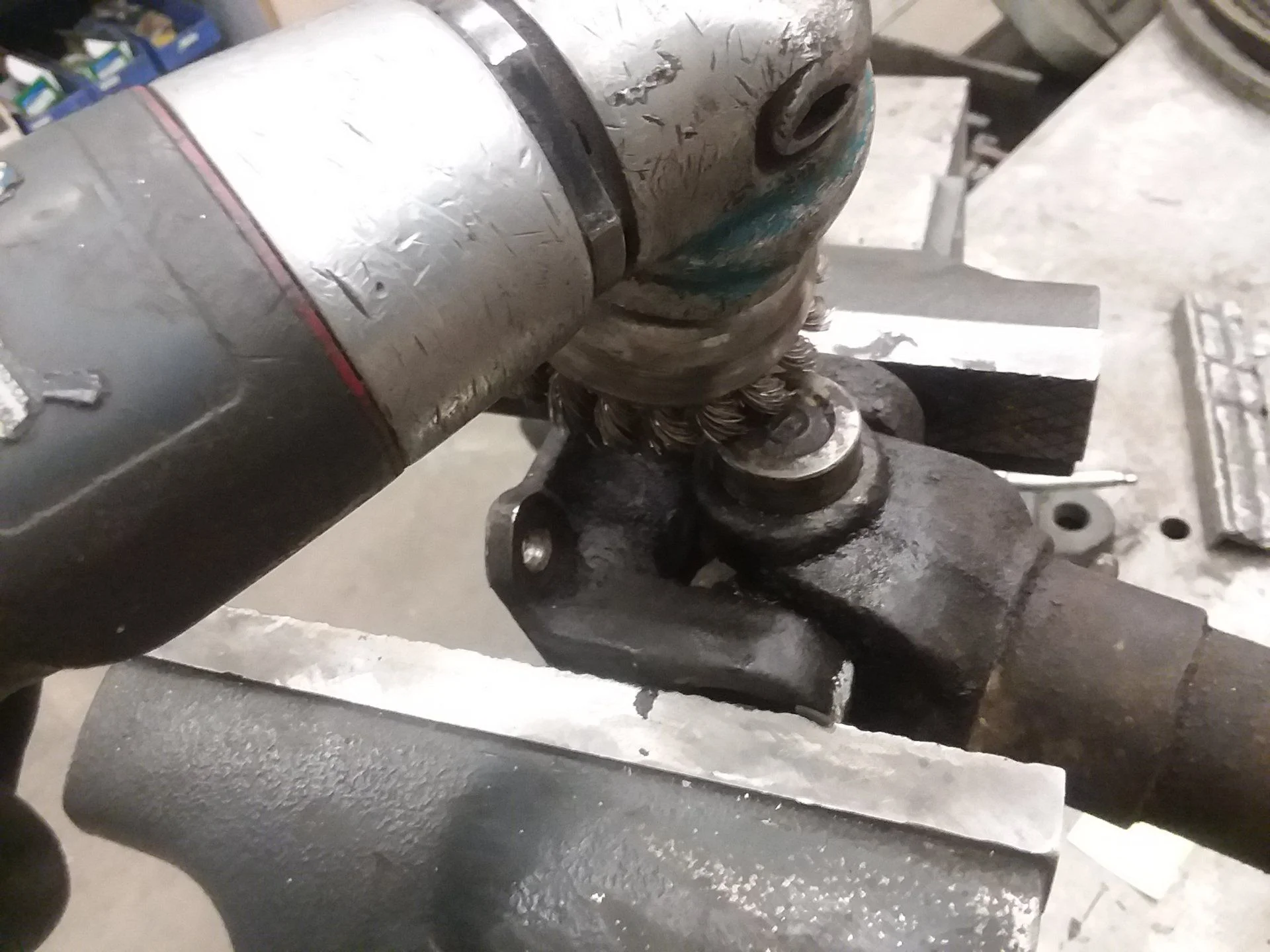

Once I pressed the joint to its furthest point and exposed the cap, I then attempted to remove the cap with a pair of channel lock pliers. I was not successful in the least. The cap was so stubborn I ended up pressing the joint back in to expose the opposite cap. It too was not coming out. I made the decision to weld on a piece of steel so that I could tap it out with a hammer. I prepared the surface with a wire wheel.
The cap came right out with only a few taps.

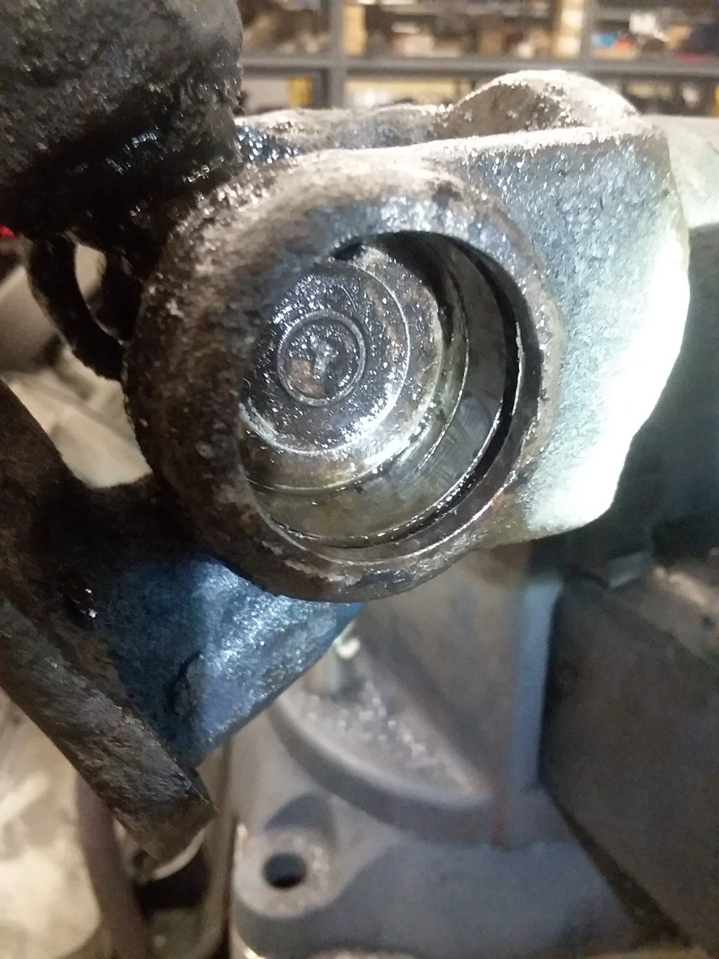

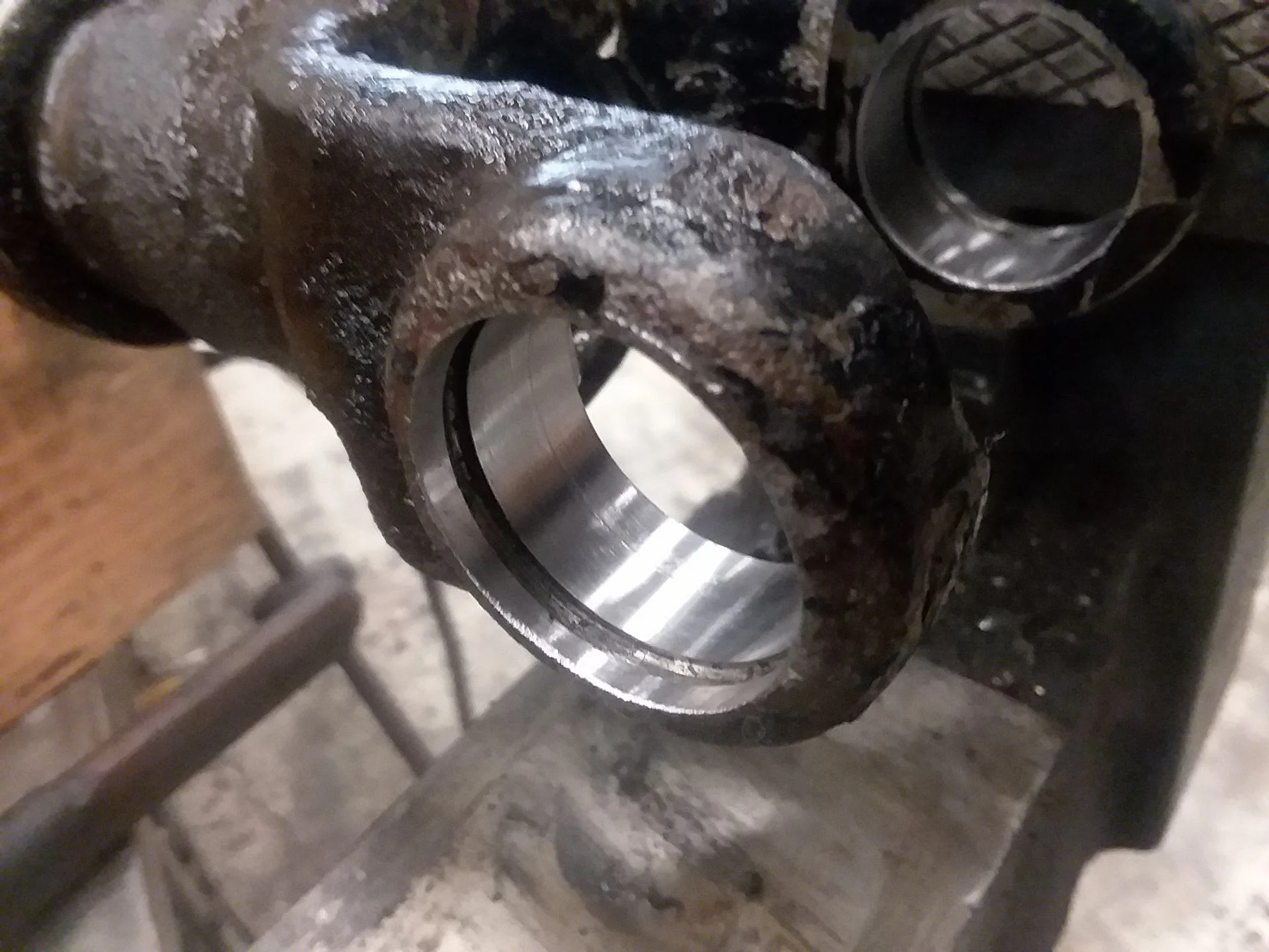

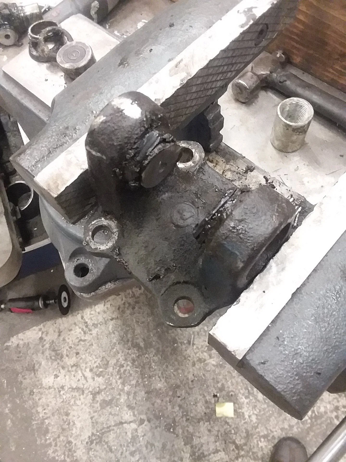

But unfortunately when I exposed the opposite side I saw where I had damaged the bore. This must have happened when I pressed the joint back through after my first failed attempt in removing the first cap. Not cool...
You can see in the center where there is now a groove/gouge.
I have a solution for fixing the gouge but fist I needed to remove the rest of the u-joint. I did not want to damage the yoke any further so I decided to cut the remaining joints out with a die grinder.

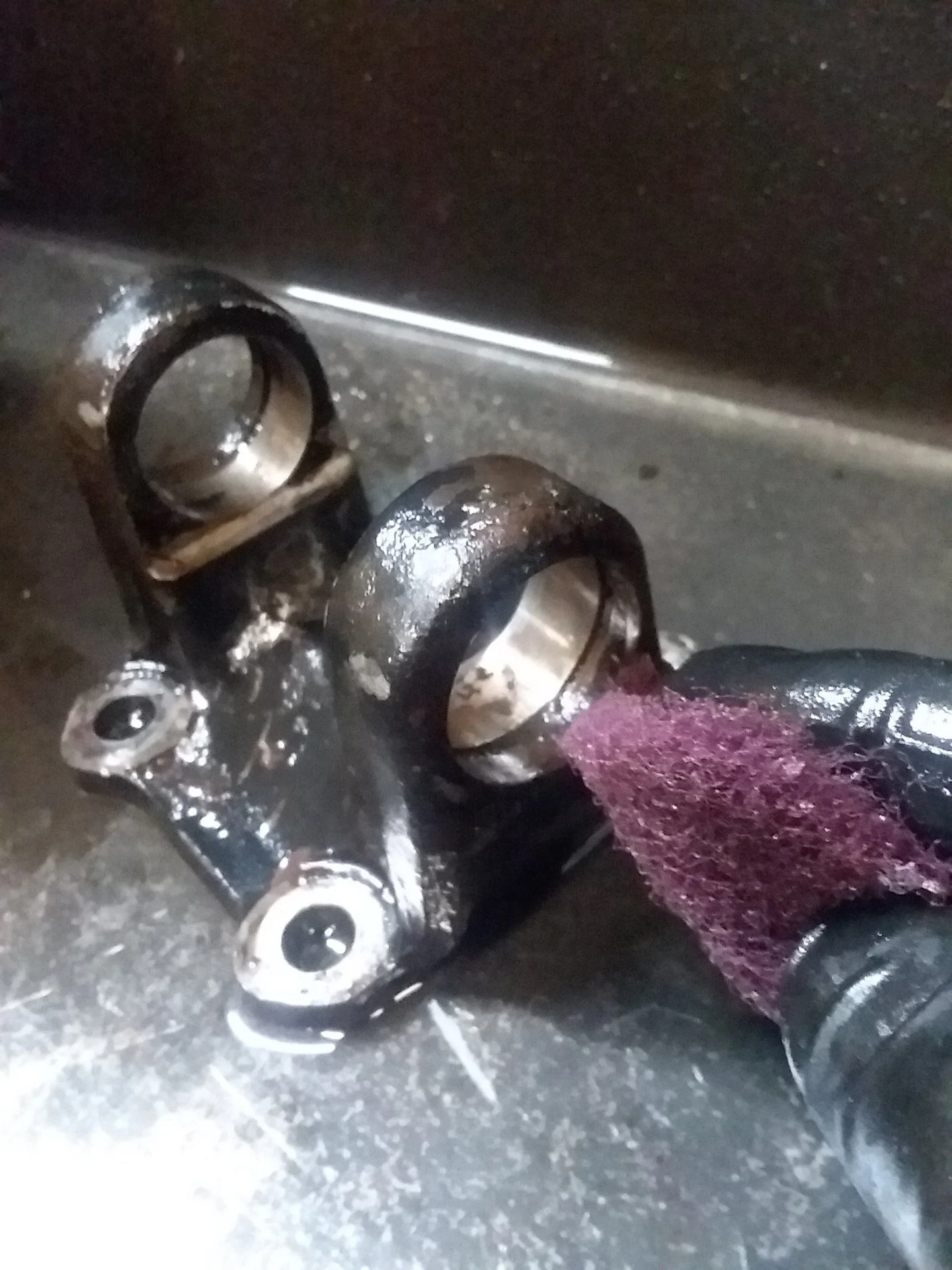

One everything else was I pressed out out gave the parts a bath in the parts washer and scrub them down with a scotch brite pad.

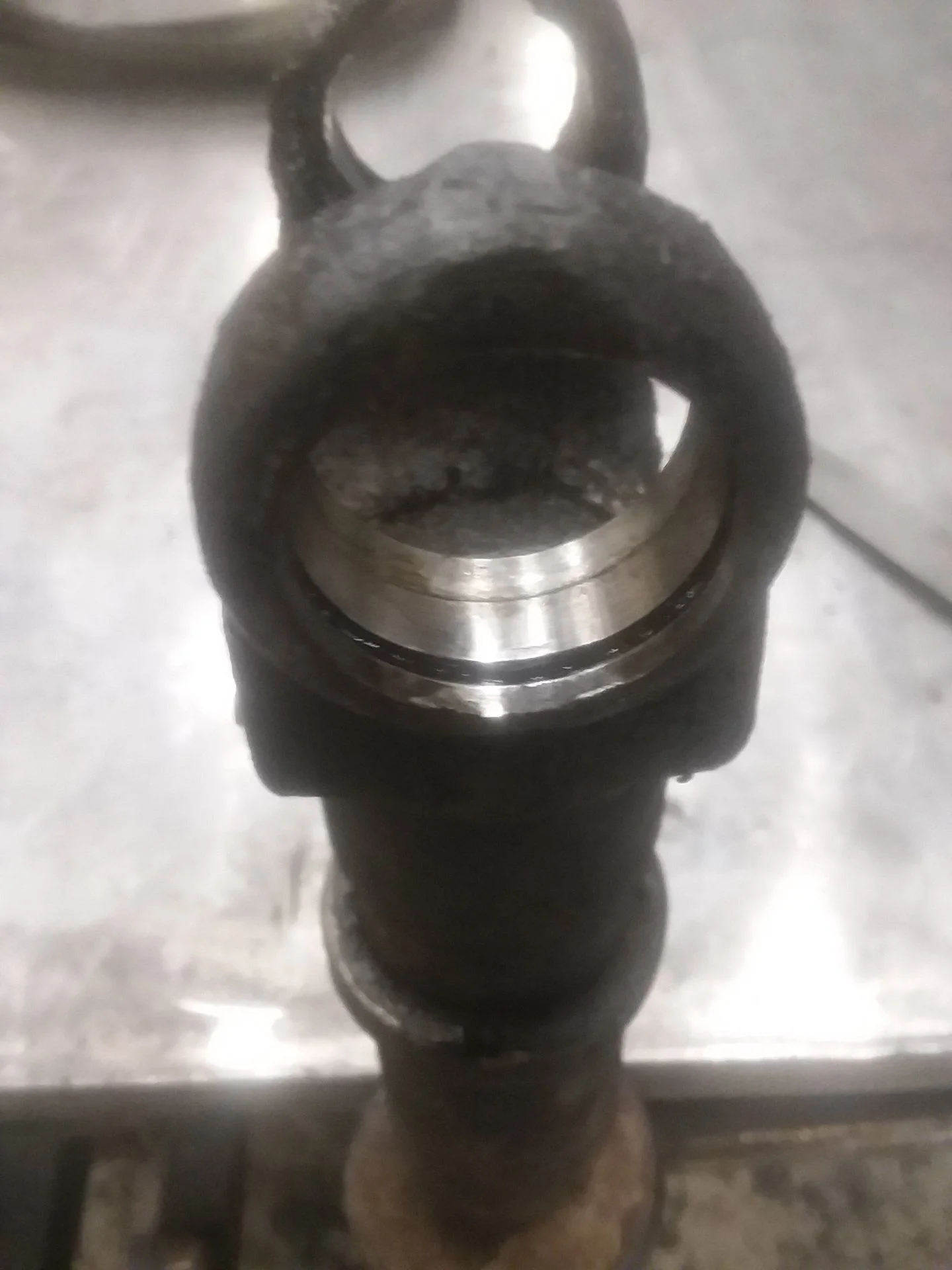

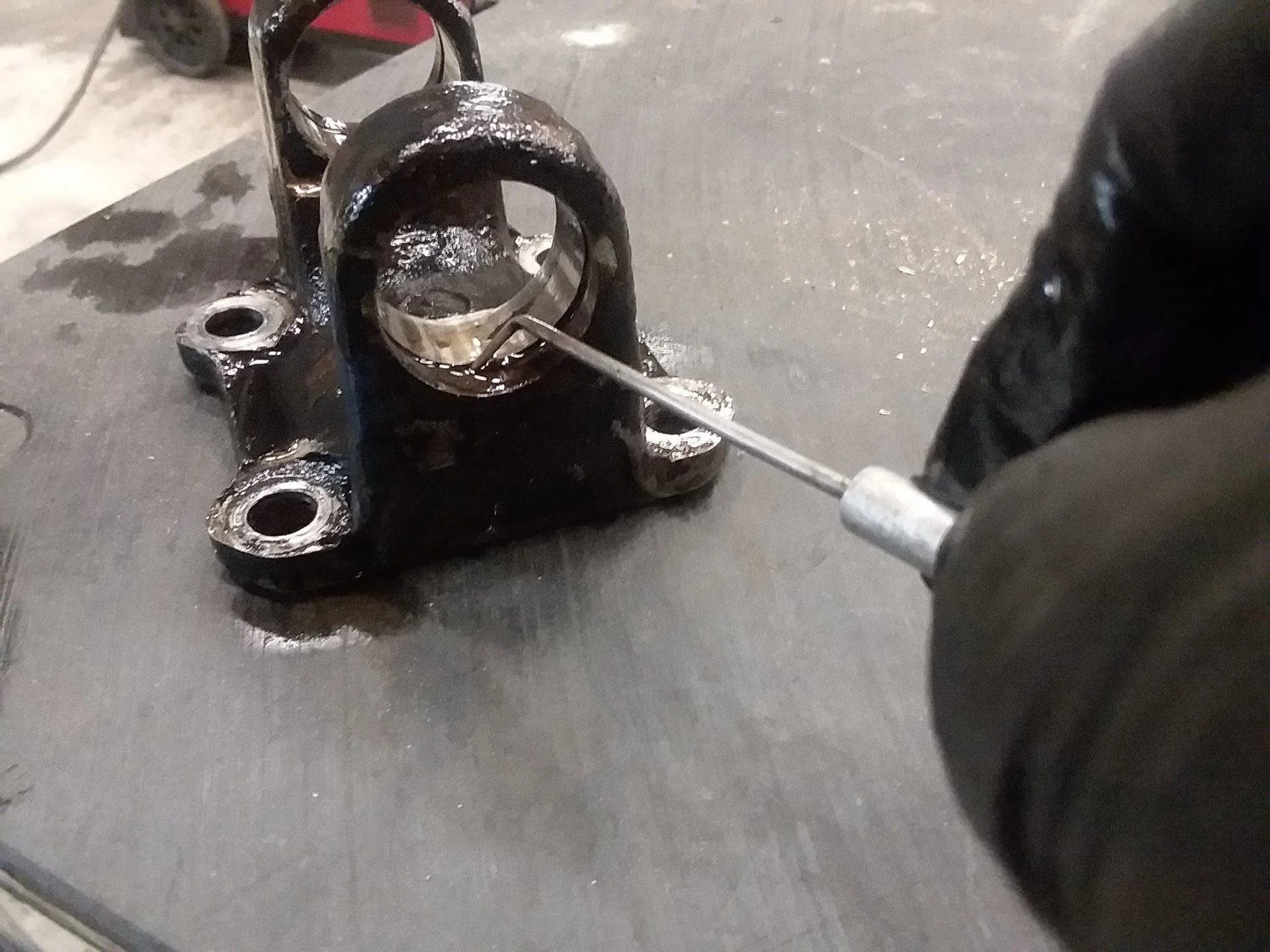

Now to address that gouge in the bore of the yoke.
I dont necessarily recommend doing this but it is what I did to remedy the situation and I am confident that It hold up over time.... i think.

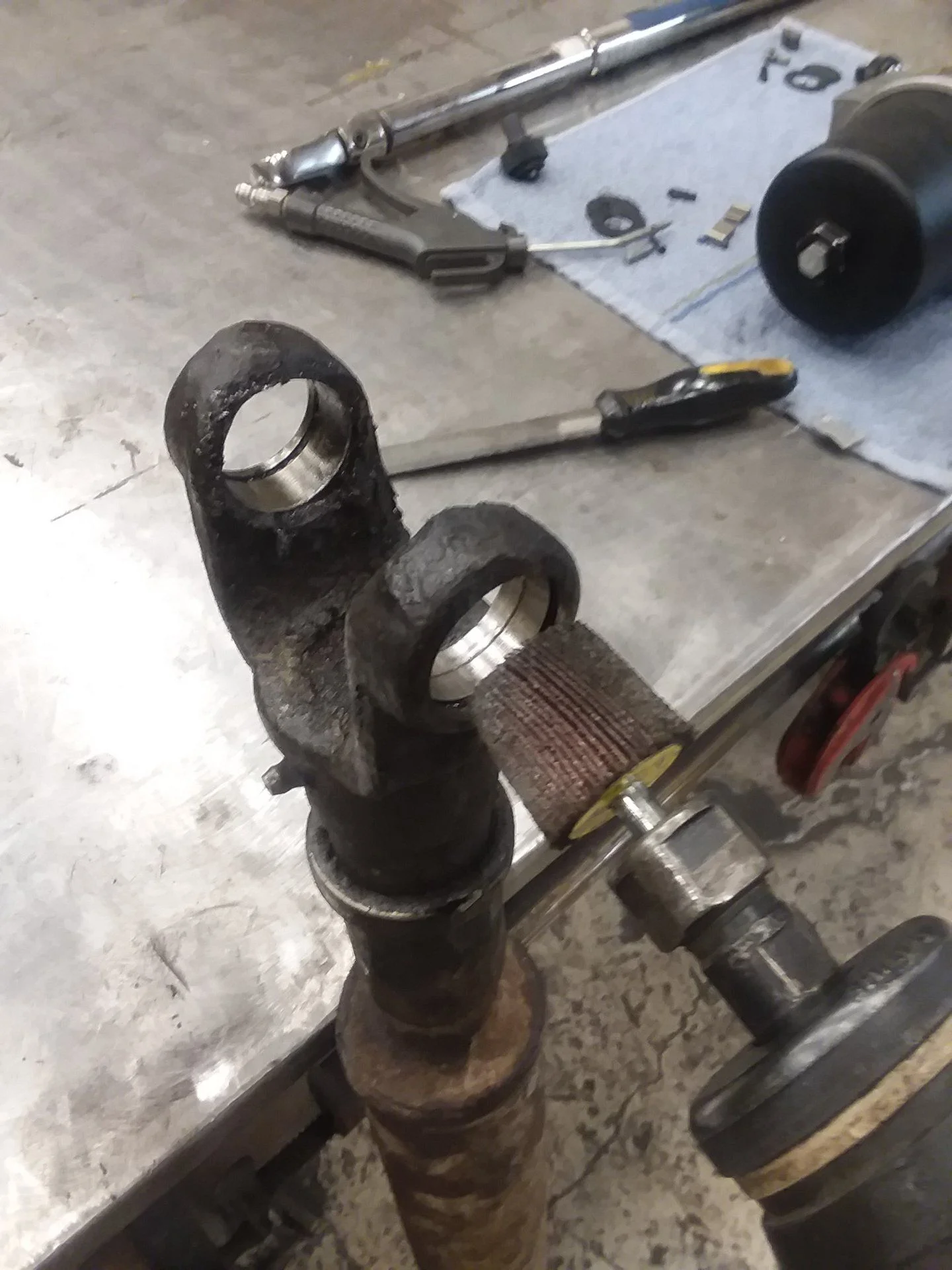

I removed as little material as possible with a "flapper wheel" insert on my die grinder. I smoothed it out by only taking a couple of quick passes through the bore.

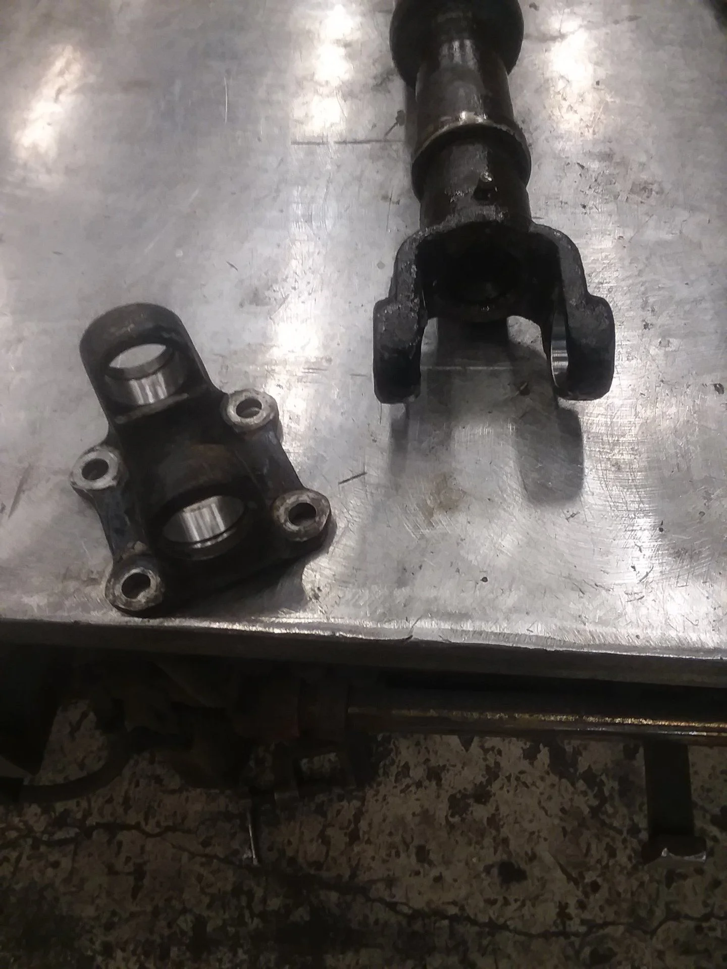

All cleaned up and ready to install the new u-joints.

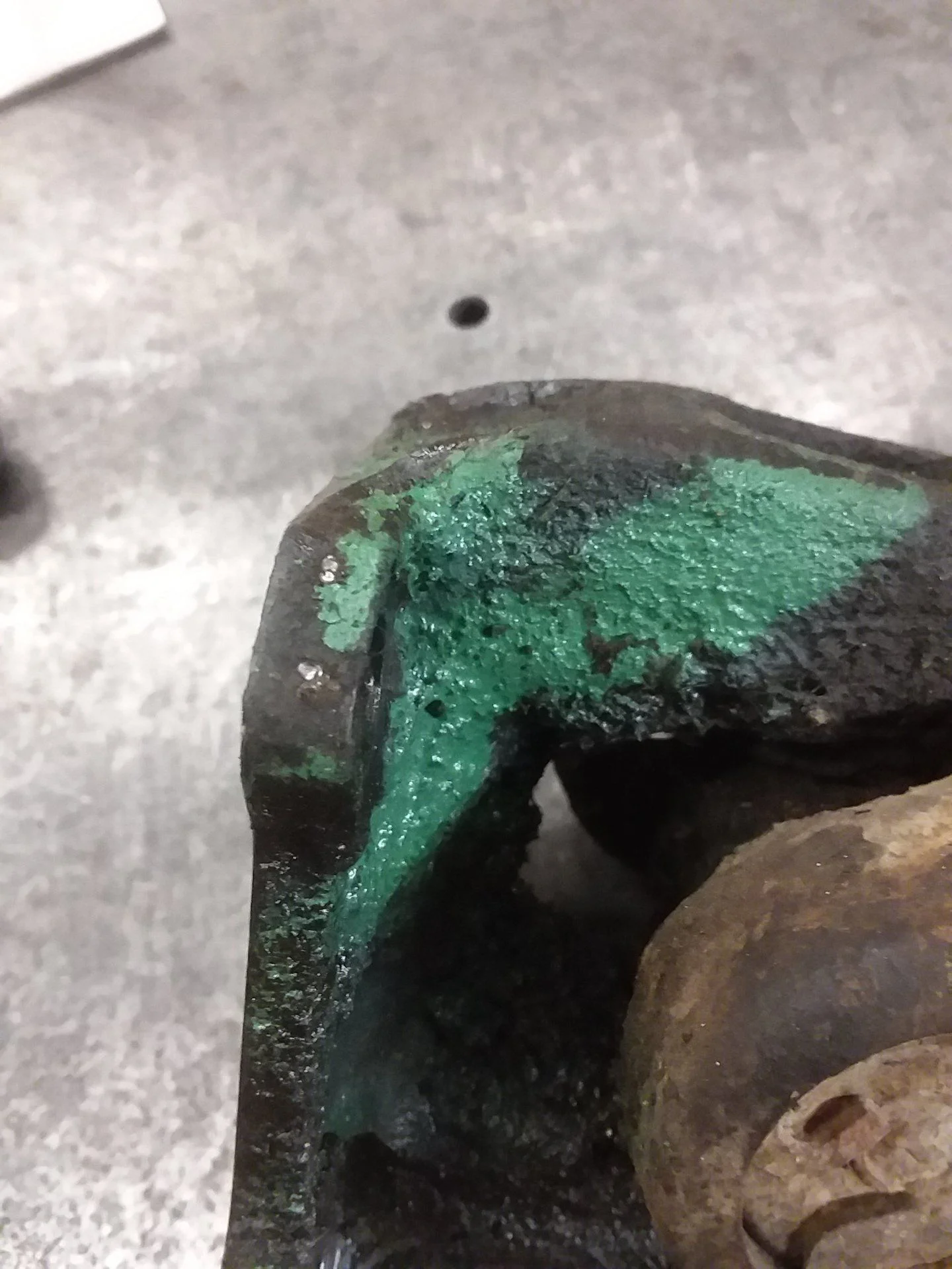

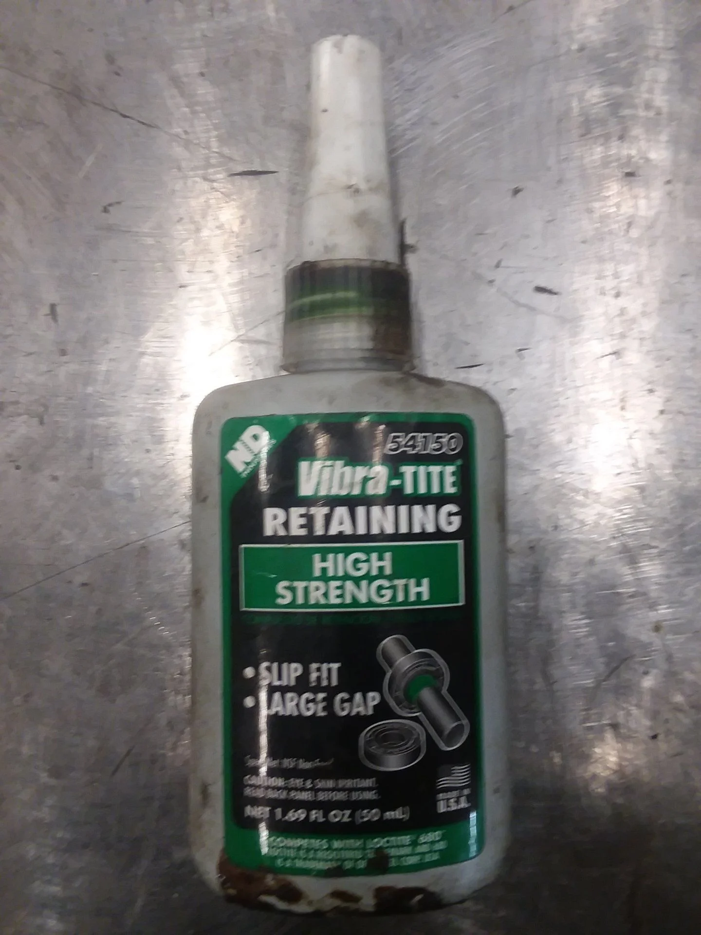

We use this stuff at work when installing bearings onto equipment that has been out in rock quarries. Seems to do the trick.
