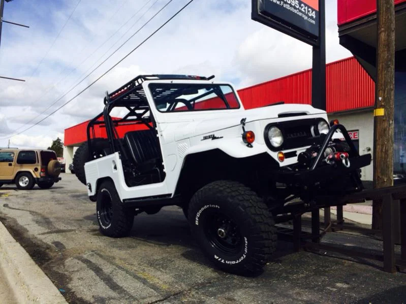

My 65 FJ40 get it running and see what happens. Work in progress thread
Nice work!! Glad all the fab work and hours worked out. Your 40 is awesome.
But white letter MTs... really!?!?!? ;-)
Just kidding... this is awesome and inspirational....
I think white lettered tires look great with the white & black paint. You did a great job restoring this 40! :cool:
To each is own I guess. It's a old school thing that I thought would compliment the 50 year old rig. And play into the black and white of the rest of the design.
Just giving you a rough time... your build is terrific!

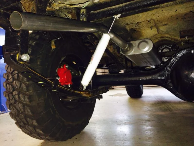

So when I get on the gas a little the exhaust/muffler sounds restricted. Kinda like trying to blow hard through a small coffee stir straw. So I talked with the local muffler shop about installing a new muffler.........ended up getting talked into a whole new exhaust system. With a flowmaster 50 series delta flow muffler. They are installing it tomorrow. The muffler is supposed to flow good / sound good but not be annoying and loud.

Got my new exhaust put on. Flow master 50 series delta flow muffler with 2 1/4" pipe from the header back. All above the frame and crossmember. Sounds gooder ;-)
May want to add a turnout at the back corner - keeps the fumes from coming back inside . Just point it diagonally out to the corner of the body . Build looks great , btw...
Sarge
I asked about just that Sarge. They said because I don't have a top it should not be a issue. But I will keep an eye on it.

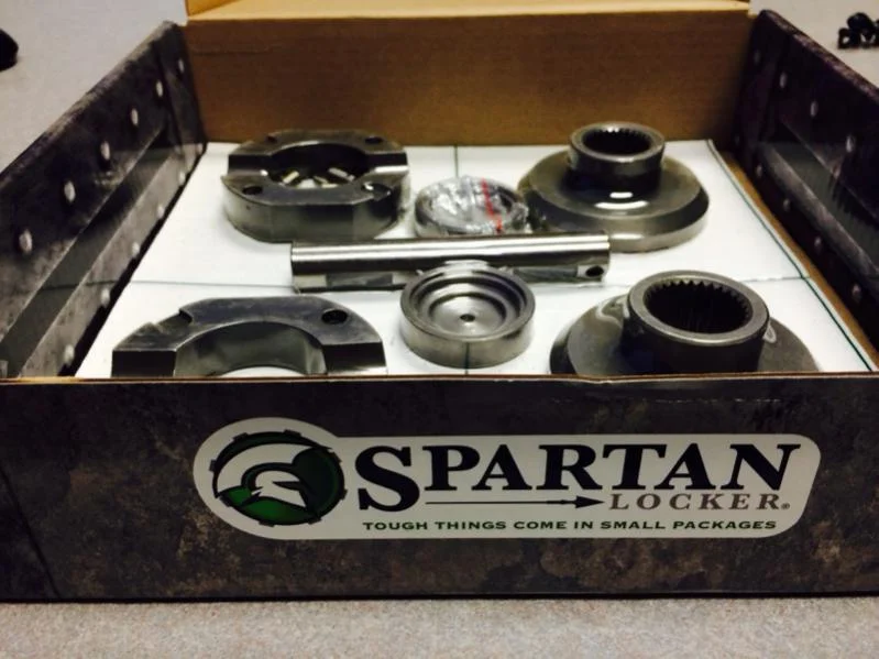

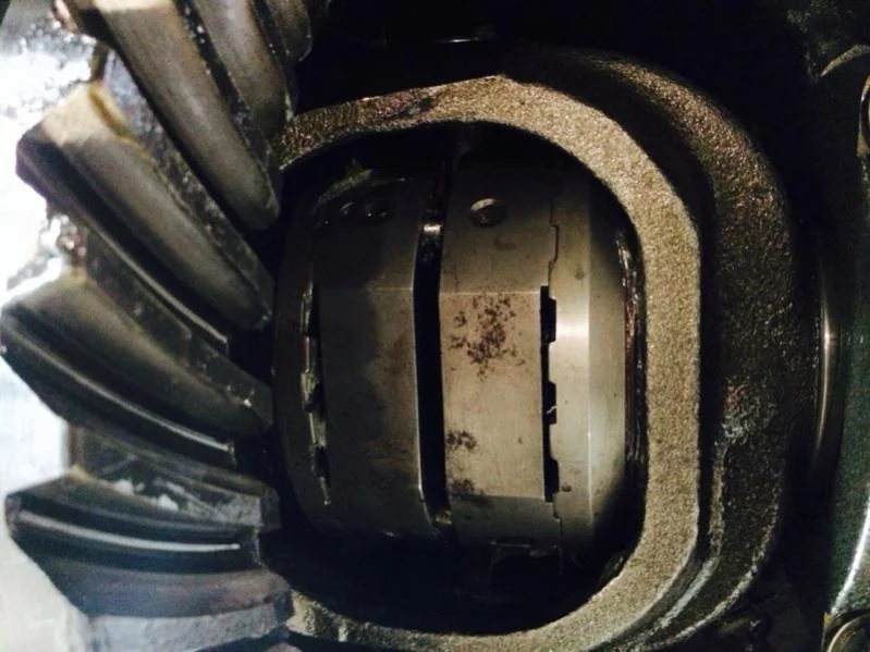

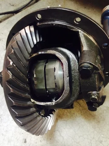

I installed my rear lock right but needed new thrust washers to have the correct clearance. Ordered them from Toyota. Did some looking and found a locker for the front. It's a Spartan locker. They look a little beefier than the lock right. The pins are twice the size. And have a cool way you install them that looks easy.and does not use thrust washers. And comes with a new hardened pin. I got a great deal on both my lockers. 150 delivered for the rear! From marlin crawler. It was the last one they had (the old 10 spline) and I got the front from Diffs only for 279 delivered! Can't wait to test them out!

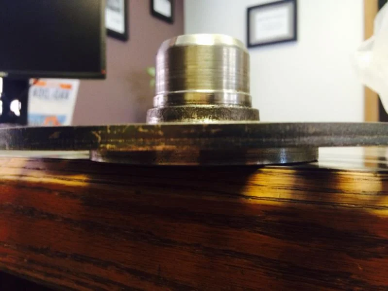

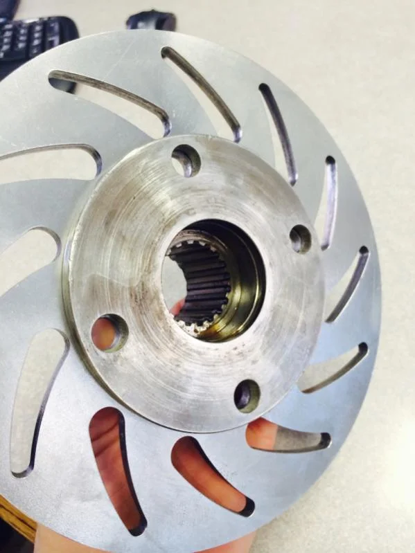

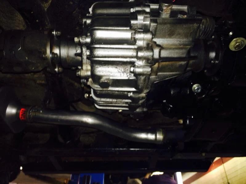

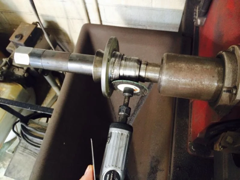

Started working in my disc brake parking brake today. I had the disc mounted on the rear of the transfer case between the flange and the driveshaft. I was hoping I could center the driveshaft still and not have any vibration. Because as you know the driveshaft centers itself on the flange with a little hub that sticks out and goes into the t/c flange........Well that did not work.

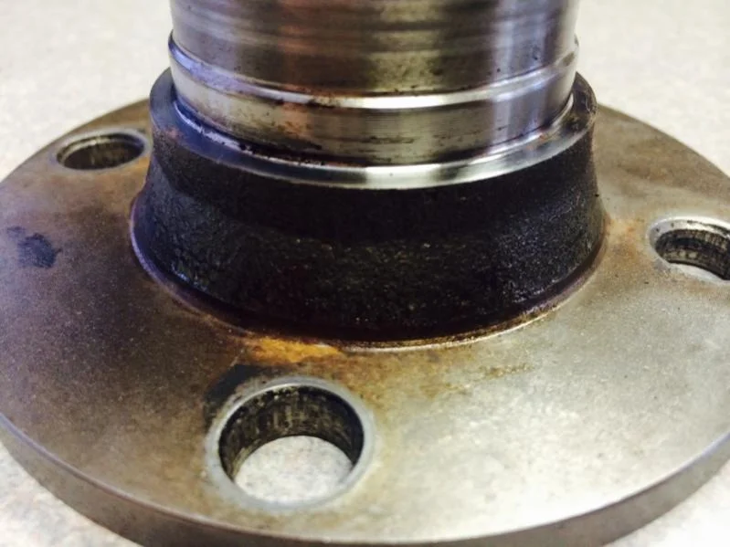

Bolted it up and went for a drive and it had a noticeable vibration. Without the disk on no vibration. So I think it best to mount the disk on the inside of the t/c flange. But it would not fit. The hole on the disk is just a bit to small to go over the hub on the flange and bolt flat.
So I was going to take the disk to the machine shop and have them open the hole up for me.....till I had a bright idea.
At work we have a rotor and drum turning machine. So I chucked the flange up in there and first tried to modify the cutter attachments to work but they just could not reach. Then I thought.... die grinder!
Spun the flange on the machine and used the grinder to cut down the flange enough to get the rotor on. Took a few try's and a few test fittings but I did it! It fits!
Little stuff like this make me happy. If I can figure something out and do it myself and not have to pay for someone else to do it, yeah I dig that!
I'm locked front and rear now!!

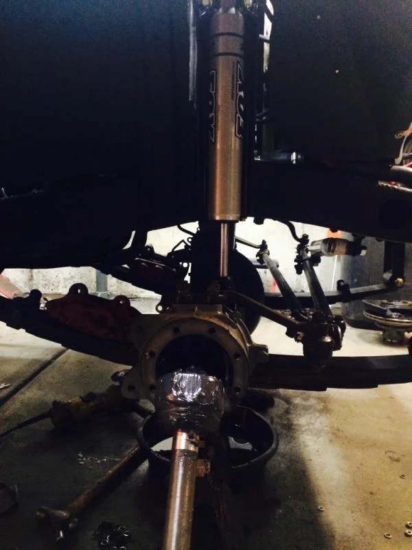

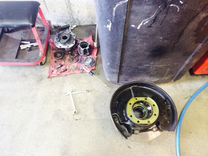

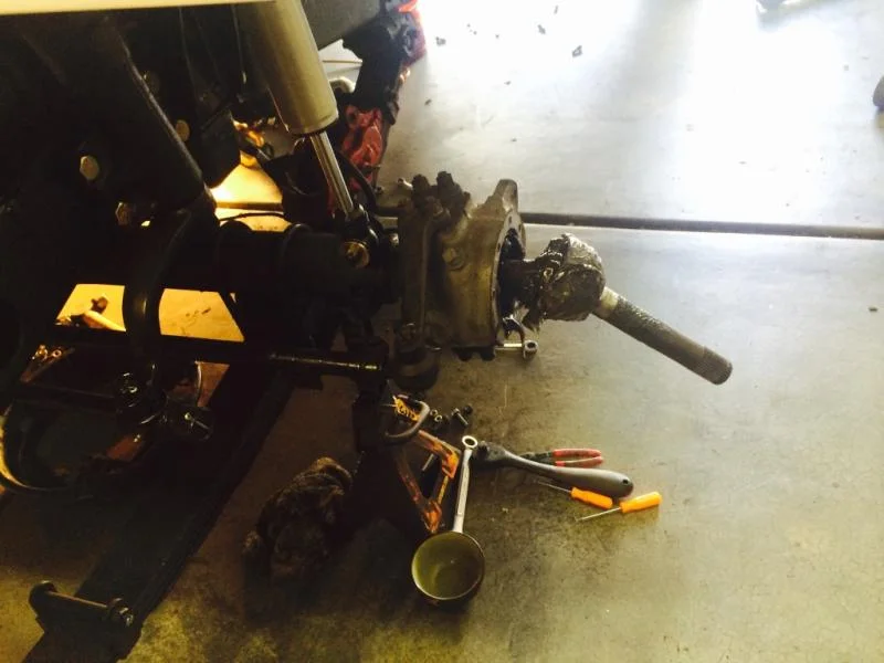

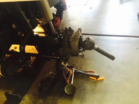

I installed my Spartan locker in the front end today. That was easy.

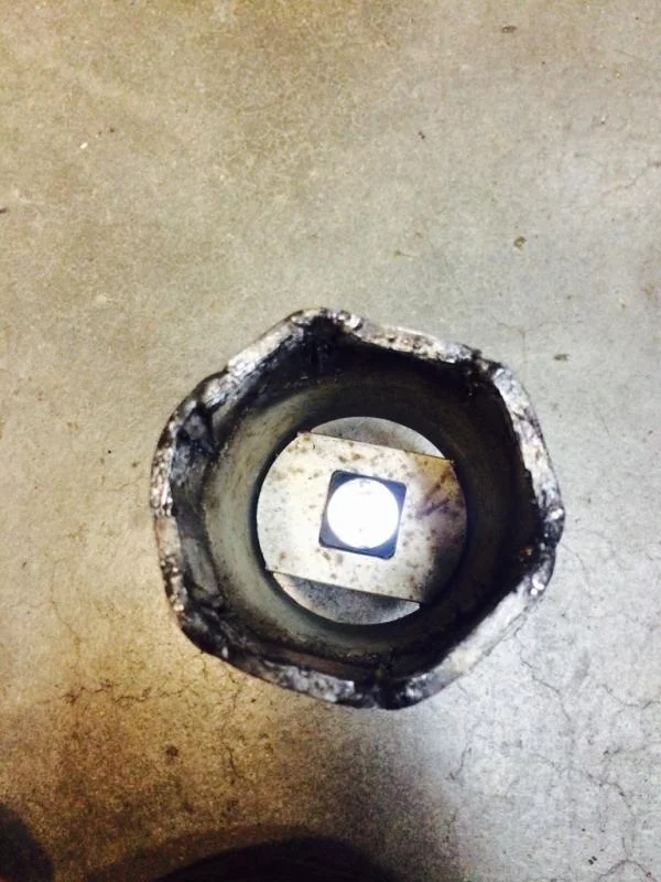

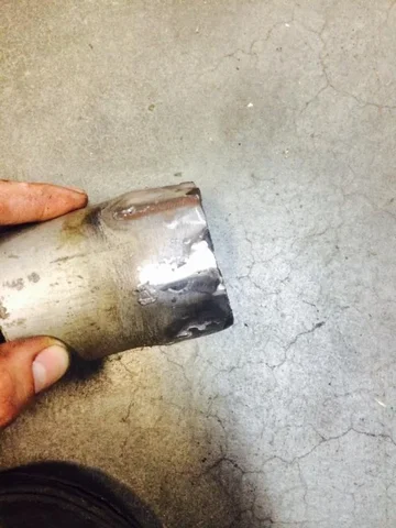

So I did not have a 54mm socket for the spindle nuts. But I did have a 2 3/8" socket I used exactly once about 15 years ago when I worked on my father-in-law's explorer. So I cut it up made it 54mm and welded it back together. Problem solved.
Worked out fine. If it was a high torque nut I would have bought the correct socket. But this will handle 45ft pounds of torque just fine.
