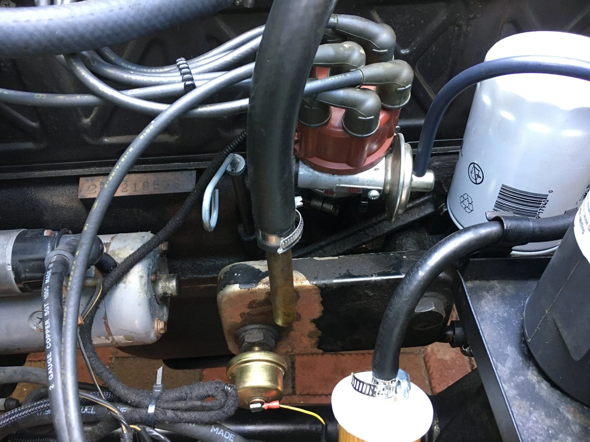

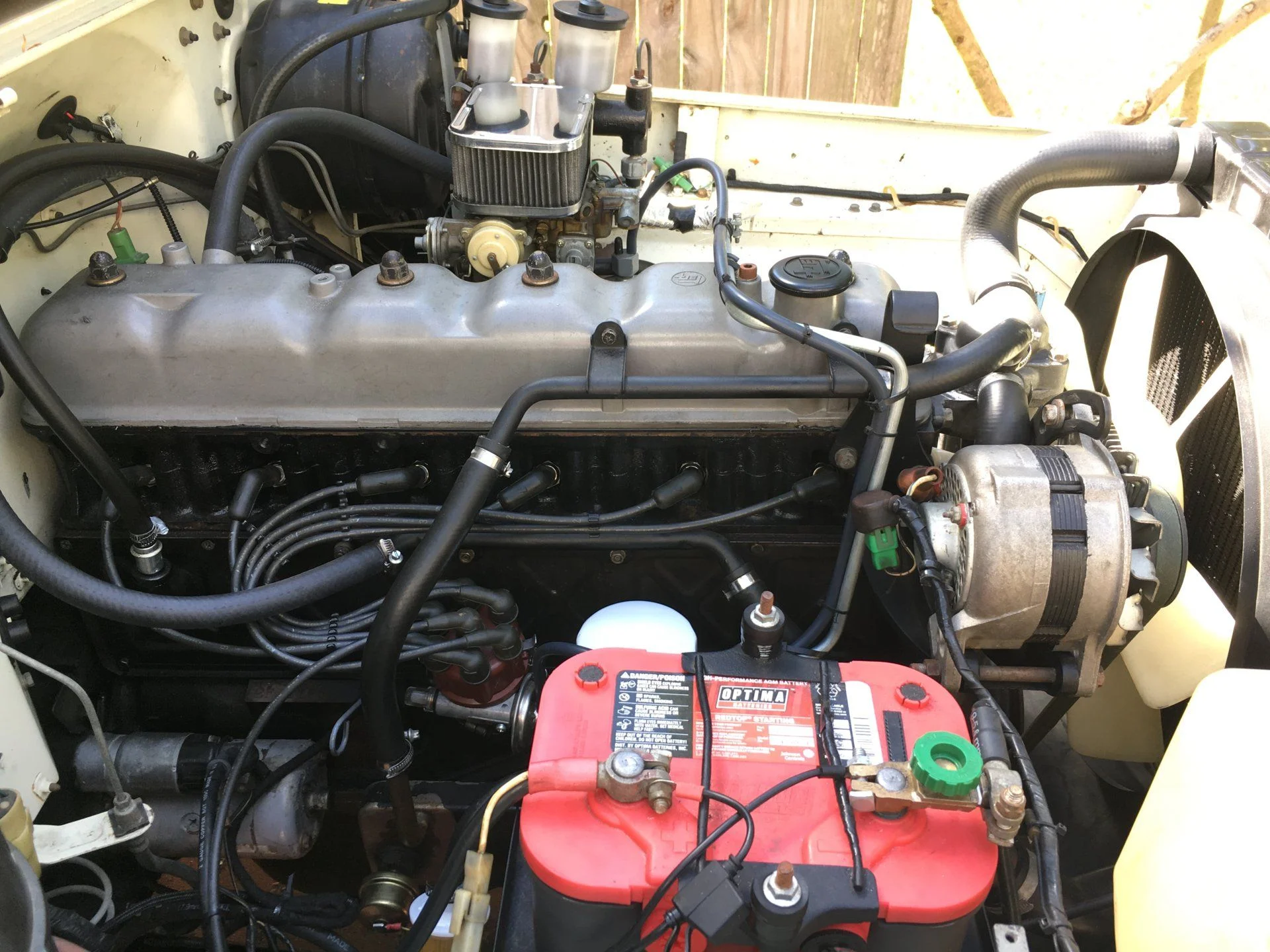

Thanks. I haven't heard this recommendation yet. Just to recap my issue so you have the full picture here it is. After a period of time from driving around and idling in traffic my engine gets up to normal running temperature. While driving the engine will start to sputter like it's not getting gas and then will completely die. I pull over and pop the hood to let heat dissipate and after anywhere from 10-15 minutes the engine turns over and starts just fine. I drive off and head home because if I continue to drive the problem comes back within 10 minutes. So something is happening where the engine heat is shutting something down. I've chased this problem for a year now. Replaced the old dizzy with the JT non-US dizzy with the electronic ignition upgrade (which is Pertronix), replaced the coil with a JT coil at the correct ohms, I've wrapped my fuel line with heat reflective tape just above the header to rule out vapor lock, I've run two fuel filters to ensure the fuel is clean, and I've upgraded my fuel pump to a higher powered one to ensure it can push the fuel all the way to the Weber 38 carb.
I do not know what else I can do as that is where my basic knowledge ends. So if this still sounds like an issue of what you are suggesting could you help me out with a play by play on what I need to do with running a new wire as a jumper from the ignition switch to the coil? Where on the ignition switch would I connect it and where on the coil would I connect it? I have attached a pic of my engine below so you can see the setup. Thanks in advance as this has become a very frustrating gremlin to track down.
Just a wild guess...but, take off your gas cap and drive around and see if the problem goes away. Perhaps it is not venting properly and when the vacuum builds up, the fuel supply gets choked off?
