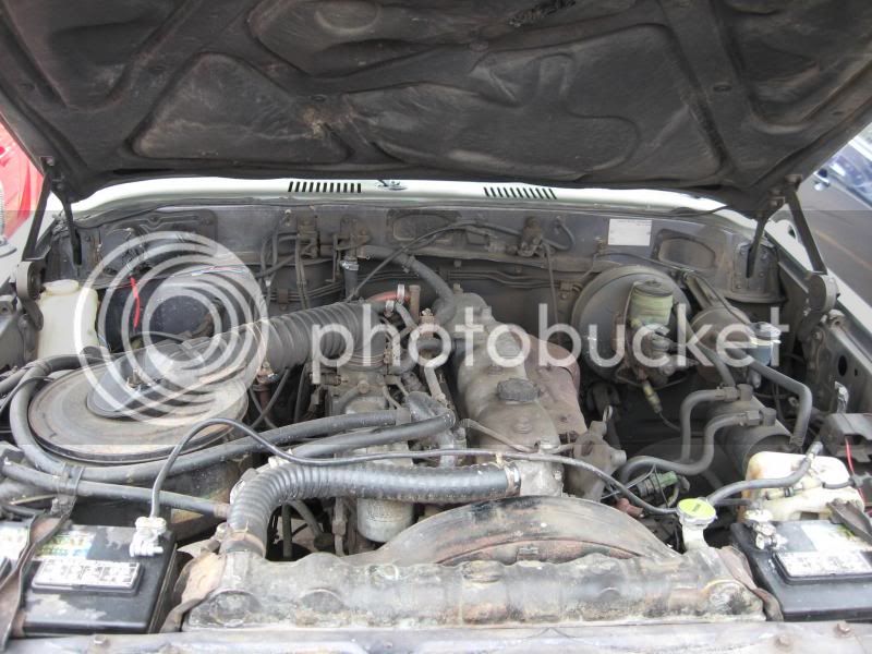

I think I got my HJ60 air cleaner bolted into the correct spot. The stock intake hose will not connect to the throttle body. Does it look like my engine was installed on an angle? Remember my front driveshaft hits the crossmember with the zerk fitting because I think the engine is tilted. I added a shim under the passenger engine mount and now the driveshaft clears but I would like this intake to fit.
Compare my pic to this stock 2H pic I stole from the FS thread. Look at where the last valve cover bolt is on the firewall compared to mine.

Just my opinion, and I am not knowledgeable with diesels, but your engine does look tilted. I haven't gone through your whole thread though. Instead of 4.11, why not get 3.73 FJ60 gears? Keep your rpms lower and the diesel happier?
I think it's tilted because of the bad motor mount, but there is a slight cant to many diesels especially from the factory.

The engine is tilted from poor install. The mounts are welded to the frame in the wrong position.

there is an angle to the 2H in the 60 but I think you went about 1 1/2" - 2" more angle than factory. Me, mine is 1" less angle than factory which resulted in a VERY tight rear propeller shaft. I had to cut my rear shaft down by 1/2" to get that back to factory slip. I'm considering lengthening my front shaft by half as well to compensate for my misallignment.
