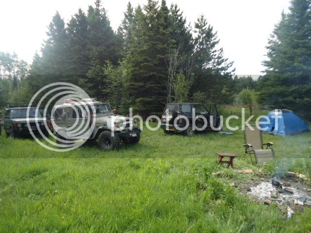

I had a canada trip planned in june so I got a little ambitious and did the spring flip to stretch the wheel base out and lengthened the driveshaft and put in a new brake line, only to find out I had a slipping clutch and ended up leaving the cruiser in two harbors mn and rode with a buddy in his range rover classic, overall a very fun trip.
So now I still have to replace my clutch, and I am planning a custom cage build for next week, also I am getting a hardtop on sunday, so I will be installing that and possibly doing something again with the sleep platform idea.
Here are some pics.
no trip is complete without the need for some bush wacking.
River crossing.

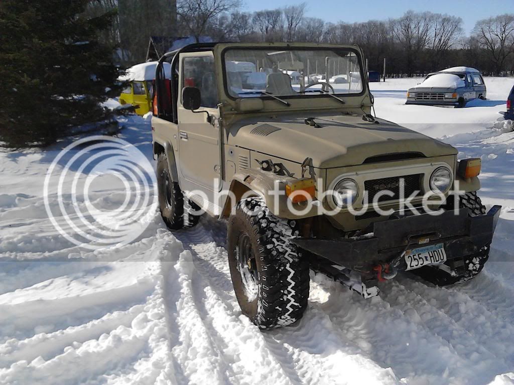

Updates, I am in the middle of replacing my clutch (finally), I also did a shackle reversal, and have decided to go spring over. I also sourced a hardtop and ambulance doors, which should make driving it in the cold weather worlds better than it was.
Here are some poor cell pics, will take some better pics tomorrow with my better camera.
