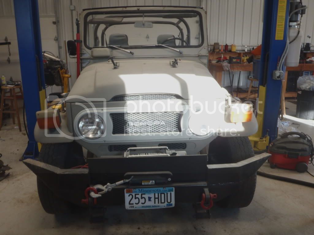

My 1975 FJ40 to be expedition rig, lots of potential

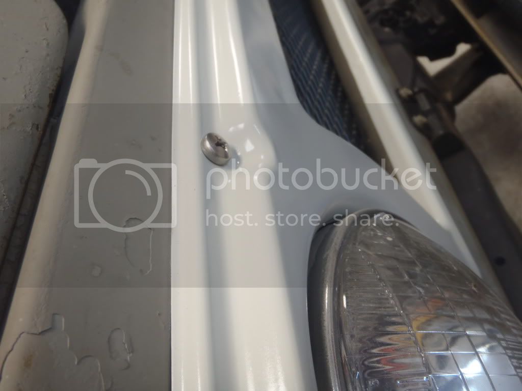

Did I do it right?

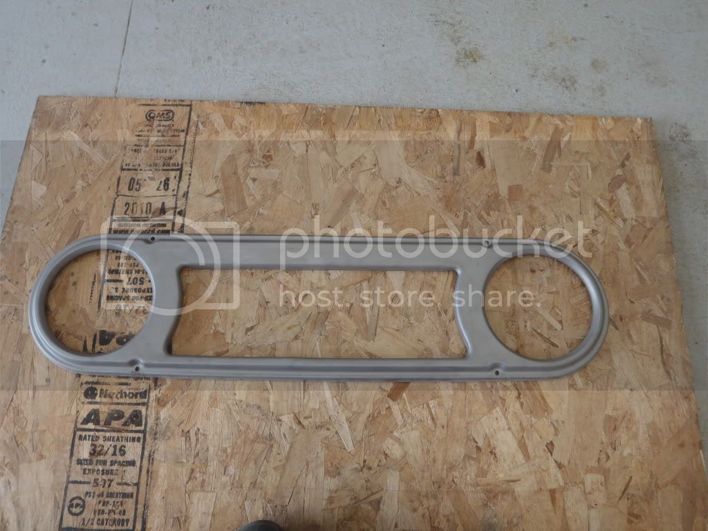

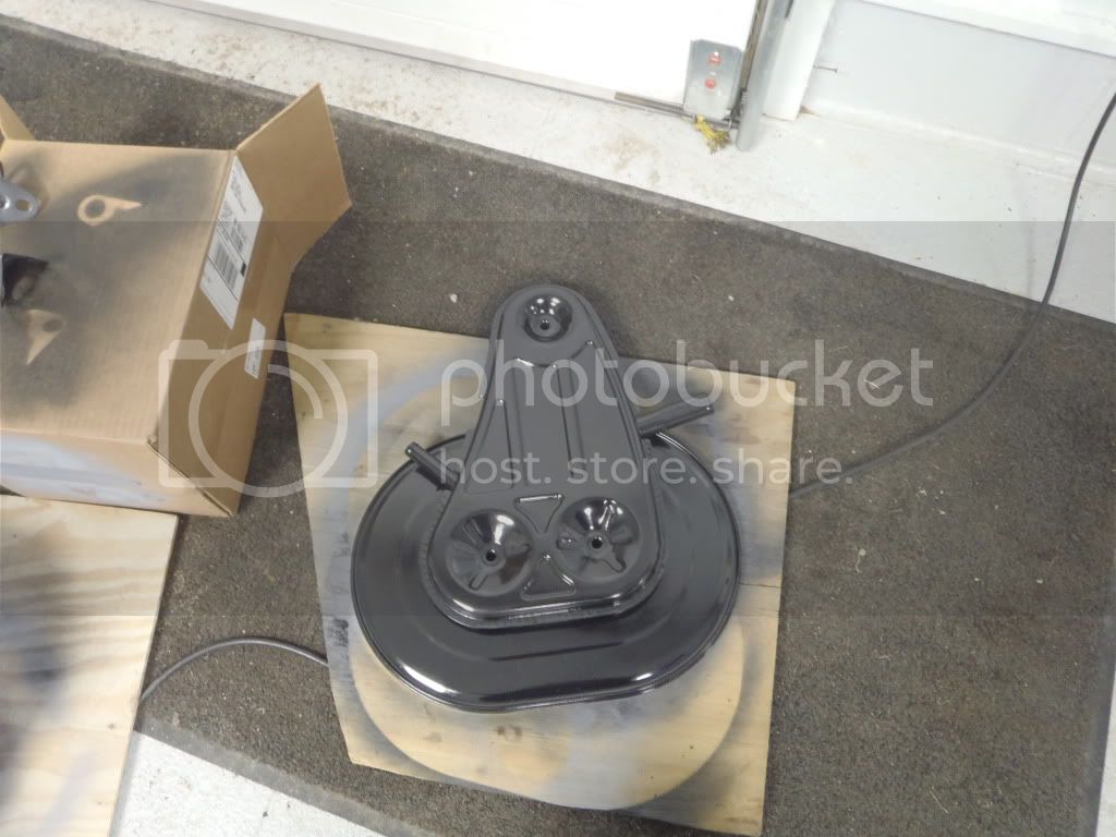

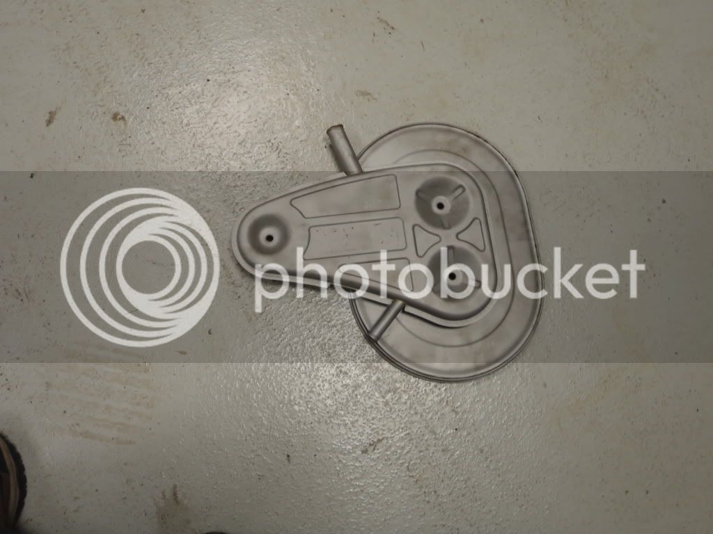

First I removed the bezel, and sand blasted it.
Then I got a can of this stuff.
I really need to just remove all the easily removed body panels and sand blast em and repaint stuff....

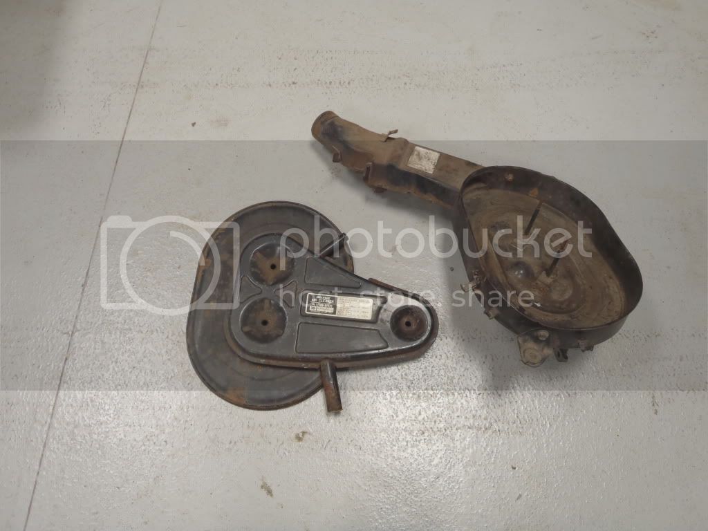

Picked up this bad boy today, along with an air cleaner assembly,and a spare tire time for my 70, from some guys up in Duluth.

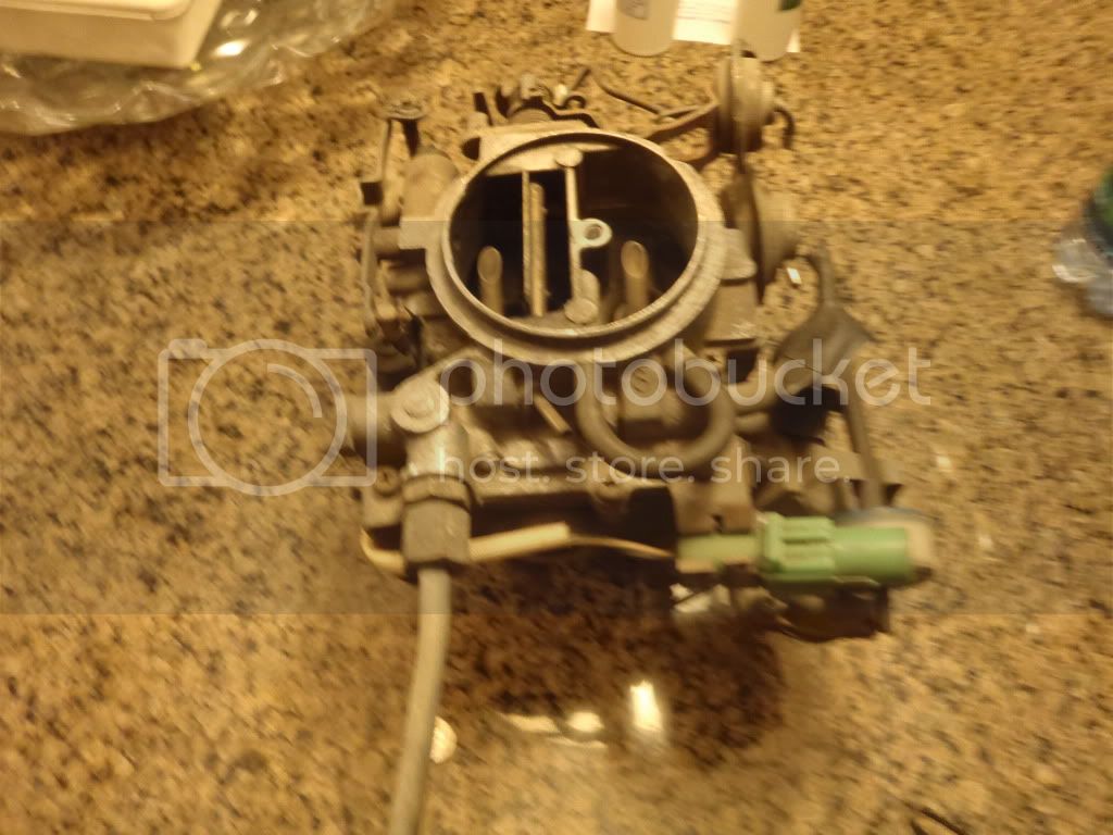

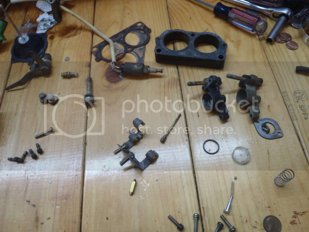

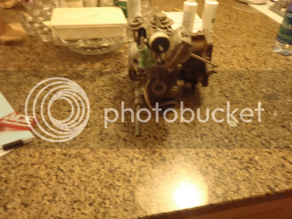

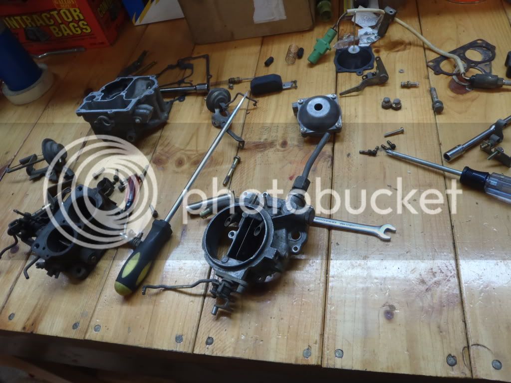

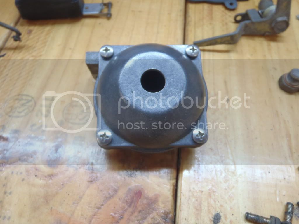

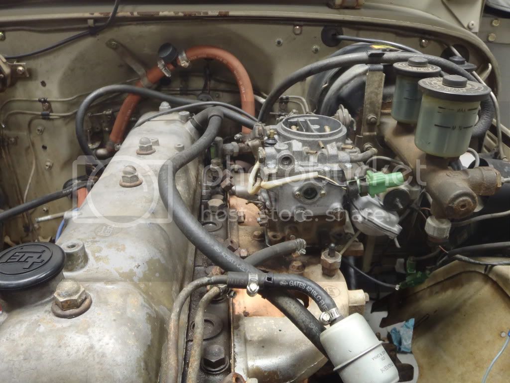

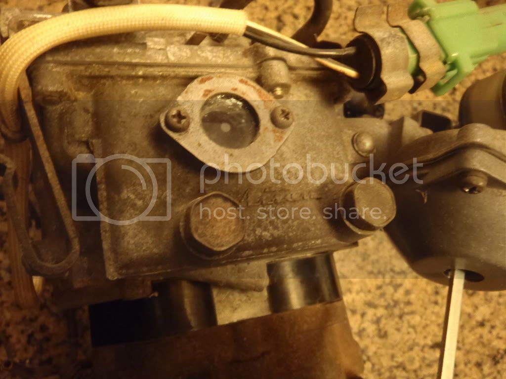

Pulled the carb apart for rebuild, kinda irritated with the main jets not wanting to come out, hoping that soaking the carb in some carb dip tomorrow will help to loosed em up, totally not wanting to have to drill em out.

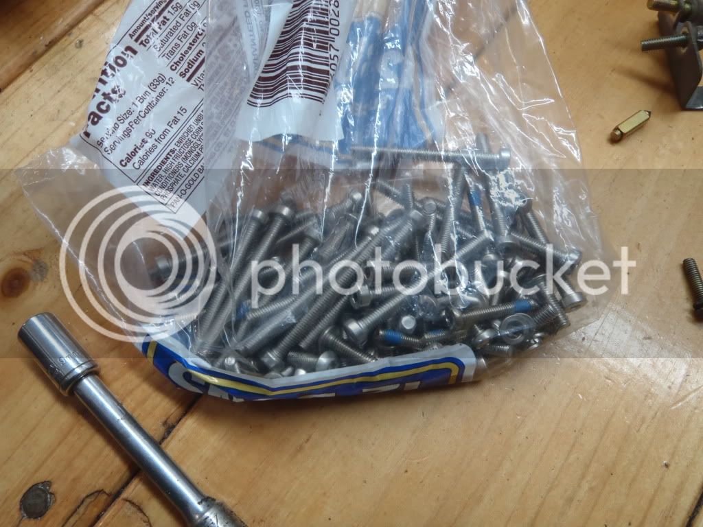

Also replacing all the little hardware with stainless while it is apart.
The current bane of my existence(over exaggeration).

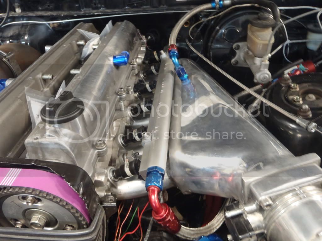

The other project is coming along nicely also, lots of plumbing done now. :P Building a wiring harness from scratch for it tomorrow, and going to get a bunch more done on the cruiser also, *cough* carb....

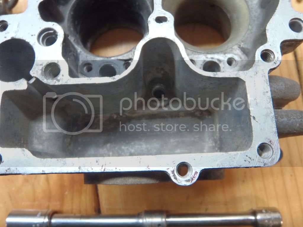

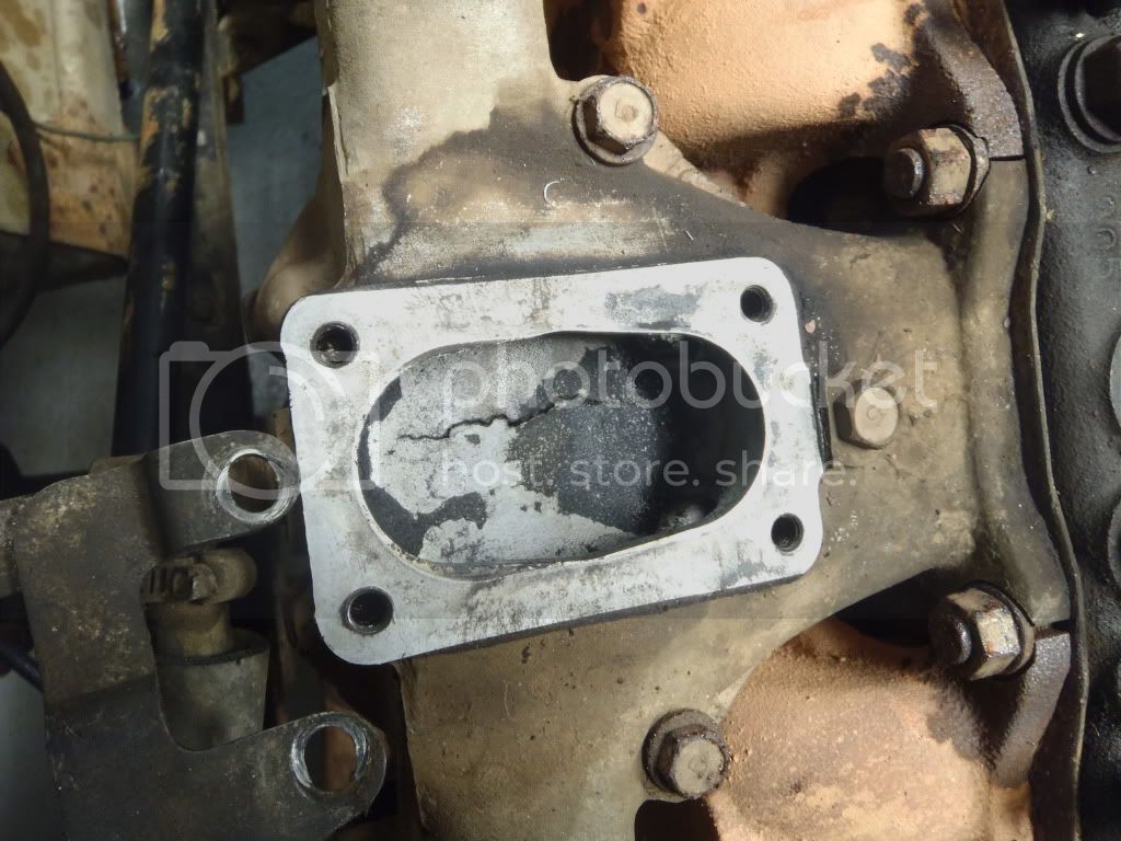

:( Intake manifold has a big crack in it, who would have guessed? I will be pulling it off the truck next week media blasting it and having it tig welded up, really hoping it doesn't warp too much.
Also finished the carb rebuild, just have to make a spacer to make it work tomorrow...
Well, I have been really bad about any sort of updates on this project, and honestly I haven't really done much to it other than enjoy it. I did take off the thermostat housing and media blasted it and reassembled it with new toyota gaskets, and I did end up media blasting and welding up the intake manifold which then had to be surfaced along with the exhaust manifold to seal back up (no biggie). Still running the weber carburetor(switched it over to a manual choke and that helped), but have plans to switch to the aisin sometime this fall/winter (truck is parked until spring).

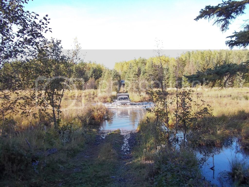

Here is a poor quality short video just driving through a little water.

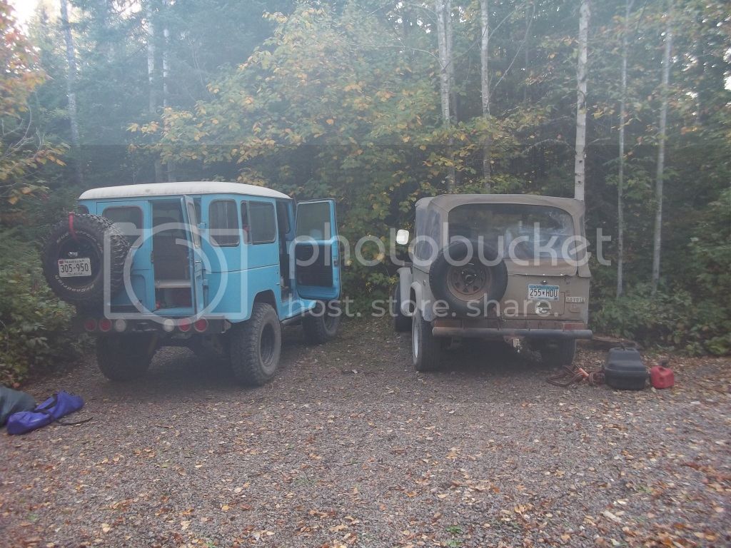

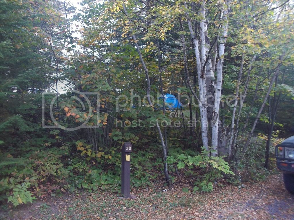

The previous trip was through central minnesota, this next trip was through the arrowhead part of Mn north of duluth and went up to the grand portage area....Canadian trip is in the plans....
First obstacle, sadly we didn't break the edge with our shovels and carry on as I wanted to and instead turned around and went around it (I know the FJ40 would have easily done it).

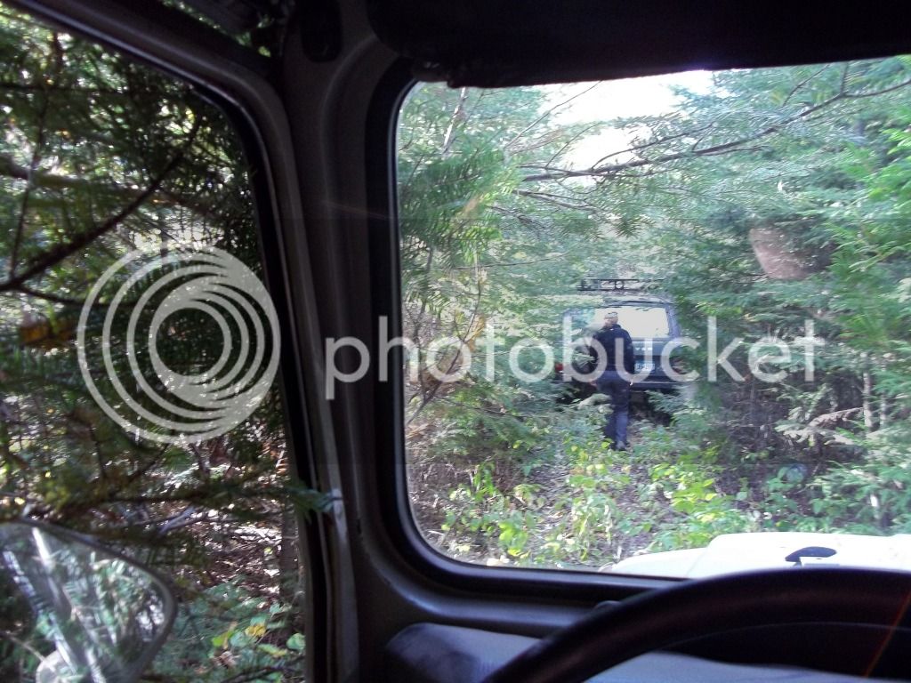

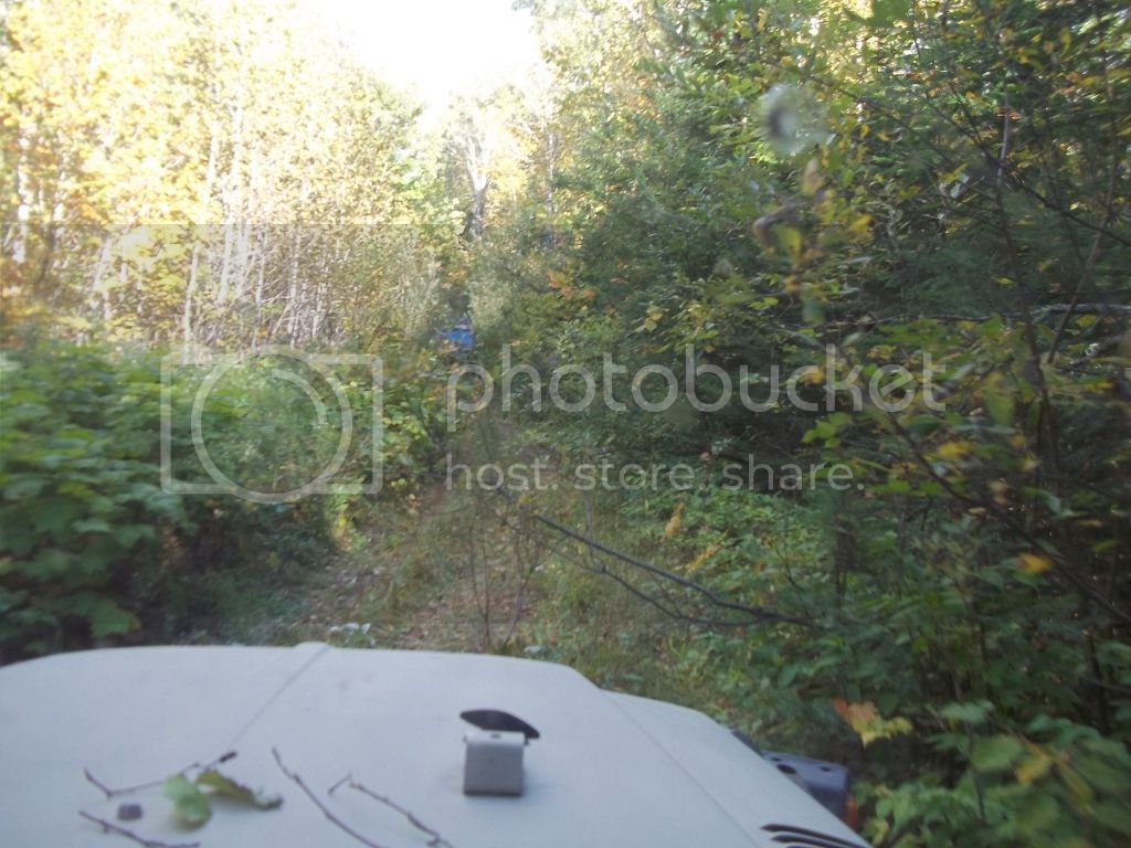

Soon the road disappeared...

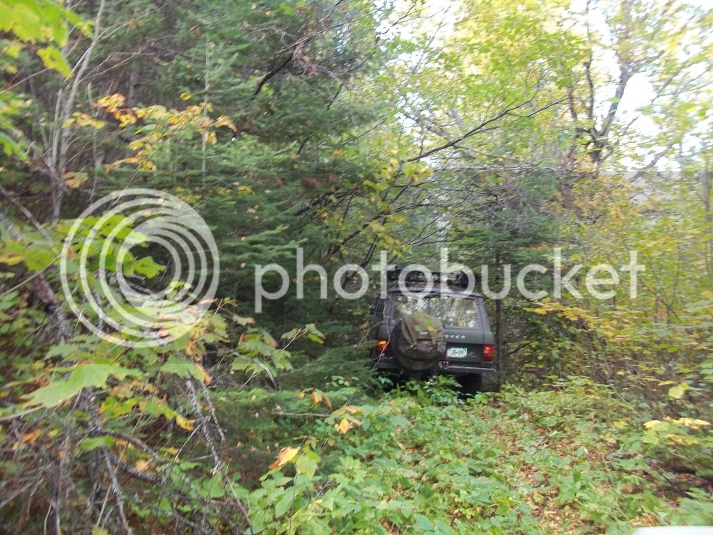

We ended up going down this narrow little trail for some ways and had to bust out the chainsaw and clear it a bit to get everyone through, but then it was getting late and we still had a long ways to go to break through the trail and turned the convoy around after having cleared about 600 yards of trail (personally I wanted to setup camp there on the trail and continue on bushwhacking the next day, but alas guys were damaging their trucks trying to follow...)

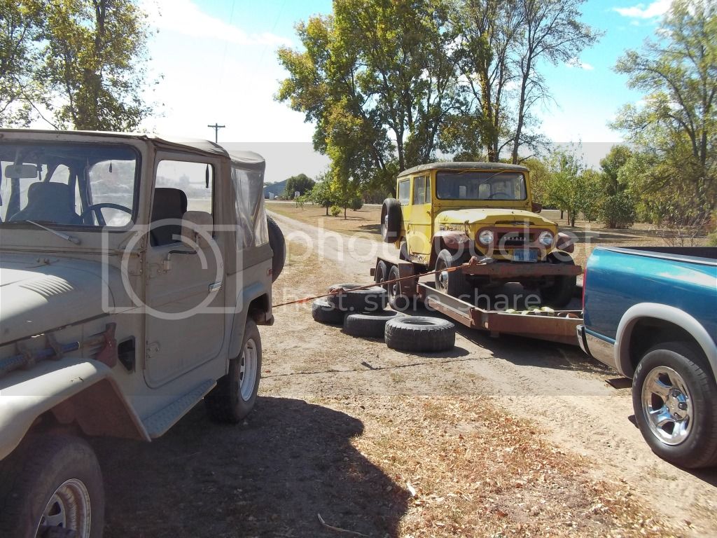

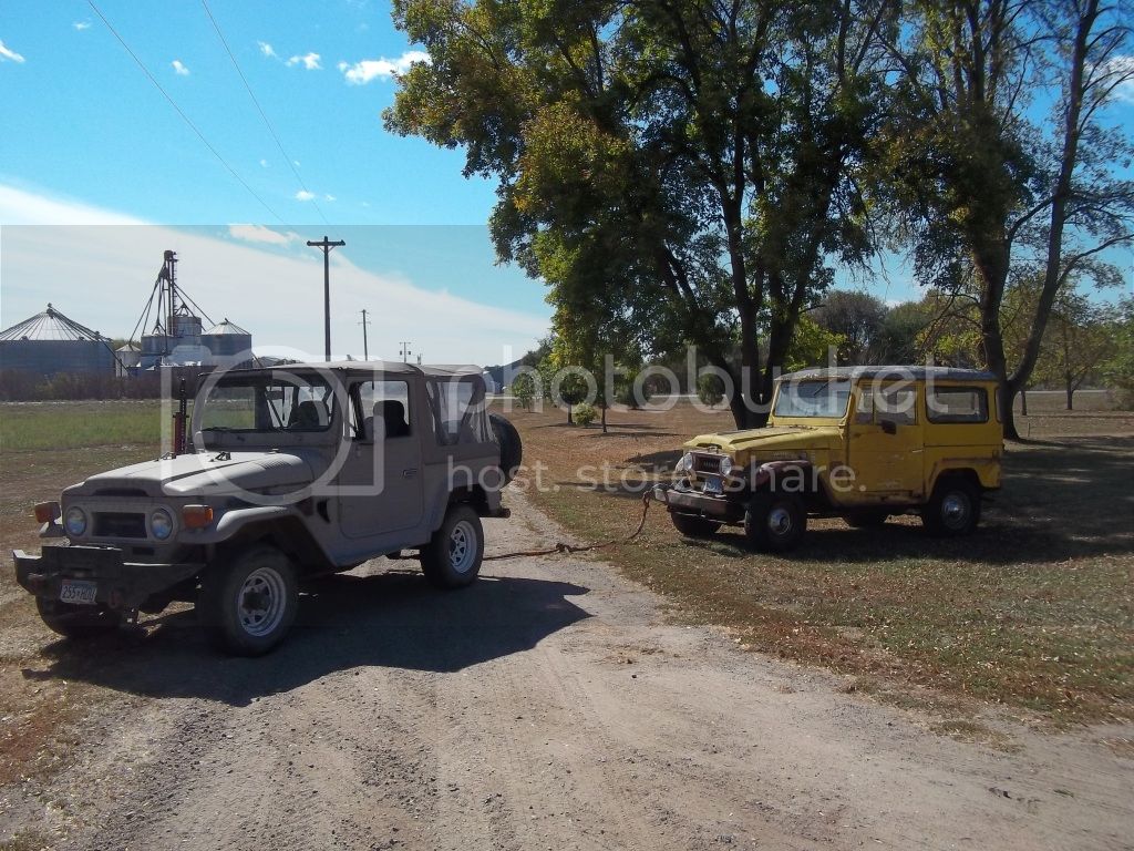

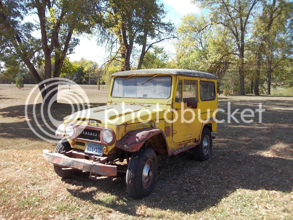

On my way home from this last trip, I finally caught my neighbor outside and stopped to ask about this little yellow 40 he had sitting out back that I have been eyeing up for sometime....Well $200 later I now have a 1968 to add to the list of projects...
Loading it onto the trailer was easy with help from the 75.

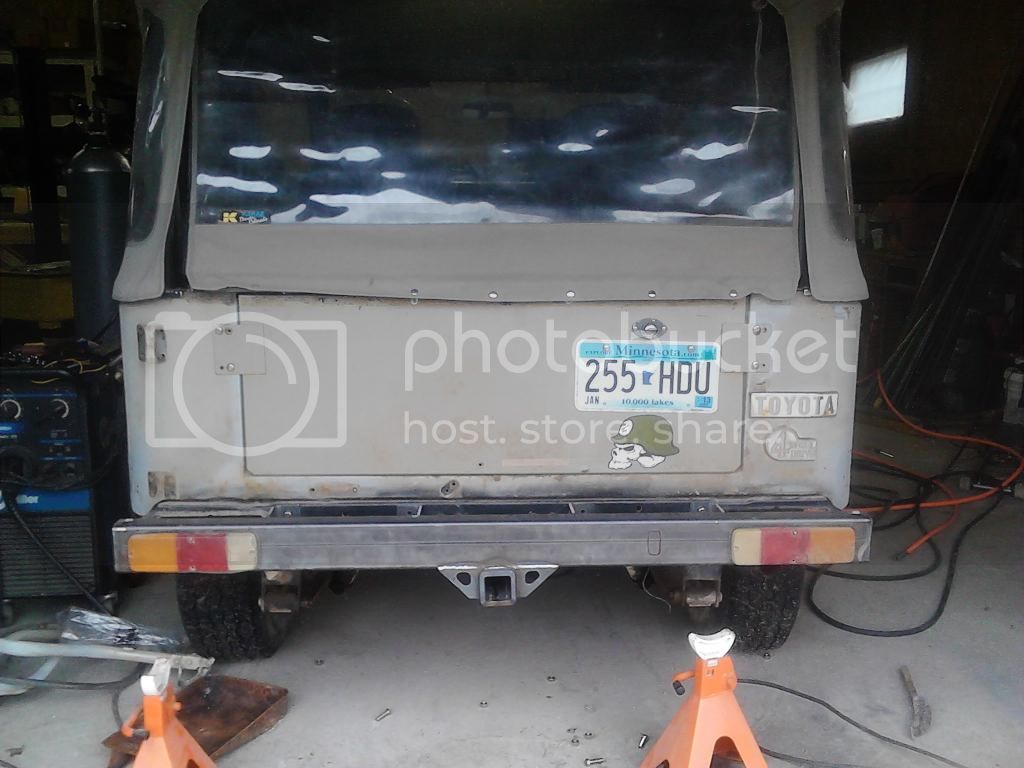

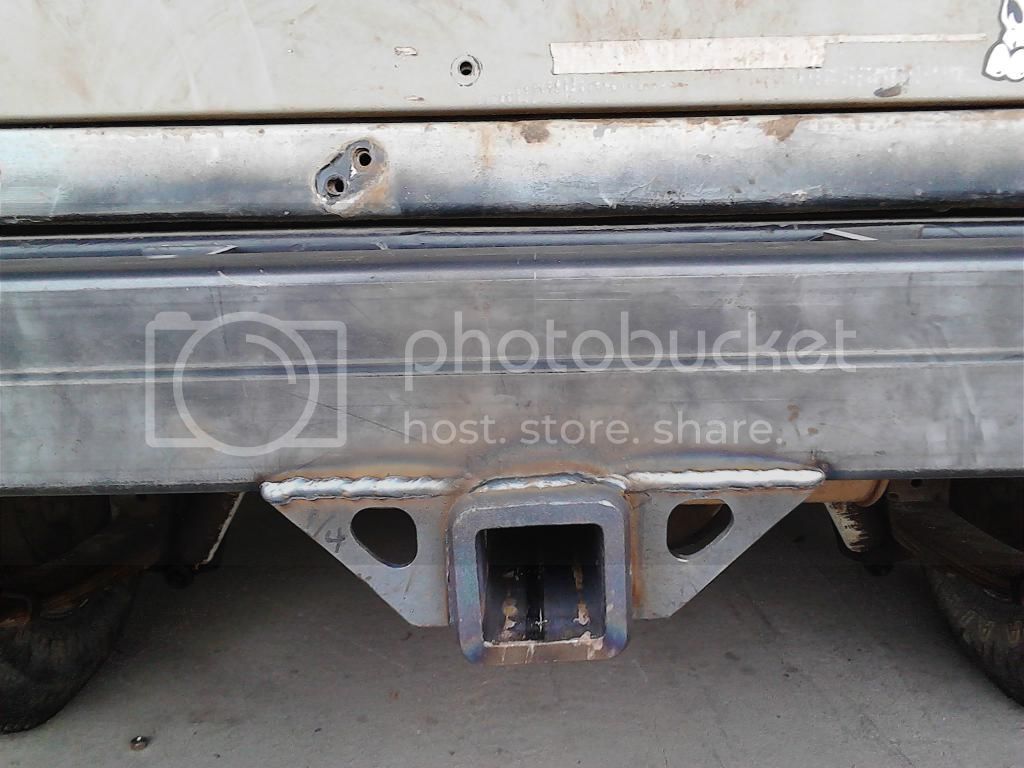

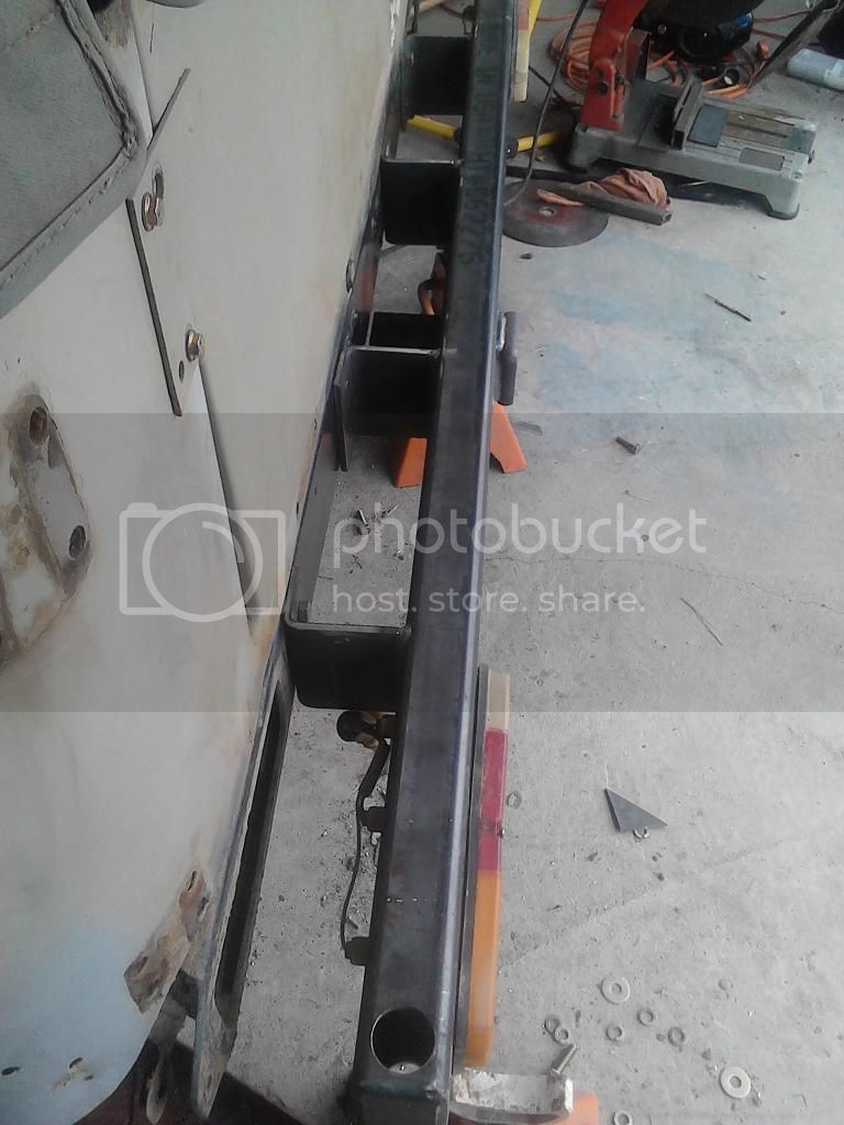

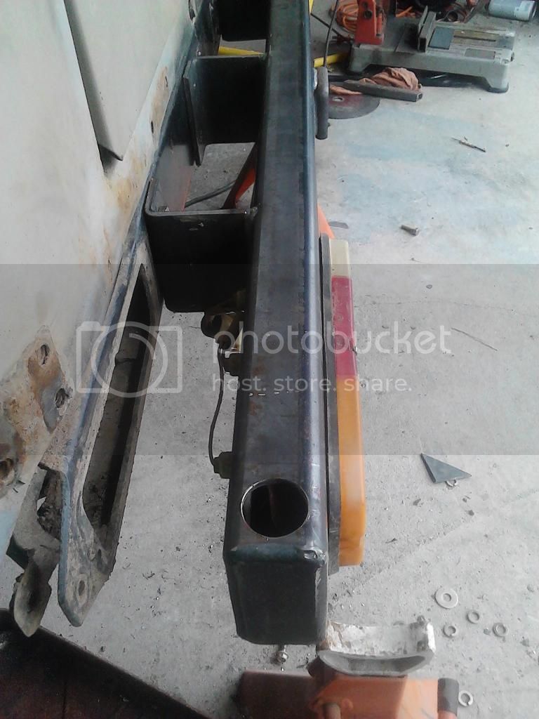

I just started making a new rear bumper for dual swing outs, I had made a bracket to carry two Jerry cans on the factory spare tire carrier which resulted in a bent tire carrier after a few hundred miles, therefore the only reasonable thing to do was either build or buy a new rear tire/Jerry can carrier system. With the current cost of available replacement rear bumpers with dual swing outs building was the best option.
Here are the pictures of what I have so far.
And here is what doesn't work.
