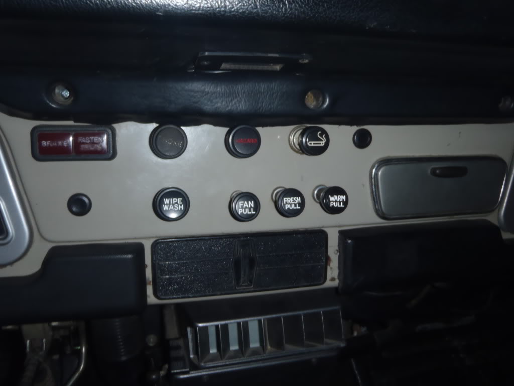

Today I didn't have to work due to materials not arriving as they should have, so I redid two of my knobs (the easy ones to do), and I worked on my catamarans trampoline also restoring an old Taft cat to use this summer, the cruiser will be pulling it around.

Knobs are looking pretty good I think (choke cable is goofed up and have a weber carb currently, will replace when I get a new aisin carb)
