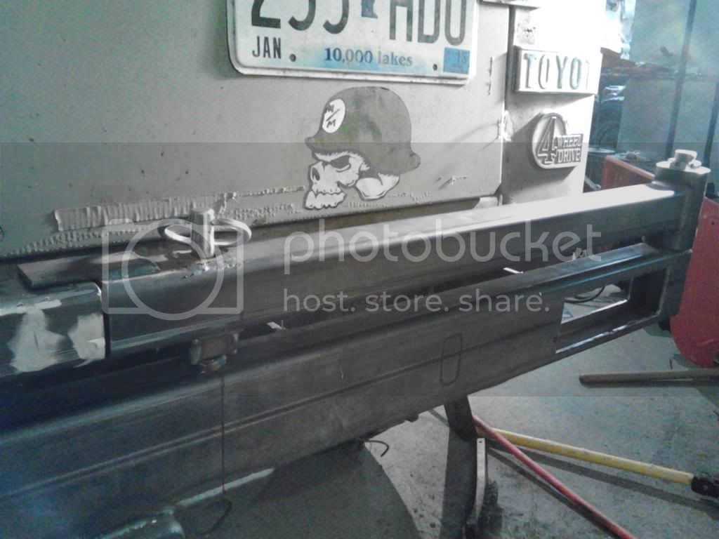

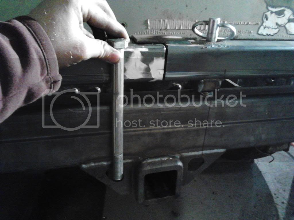

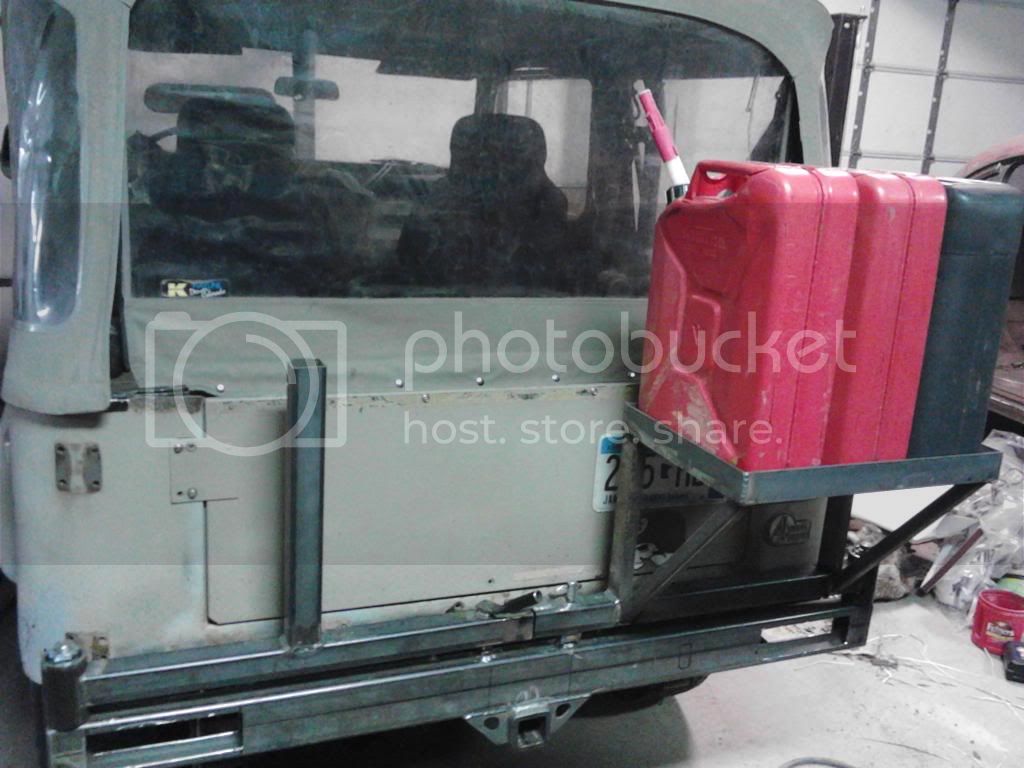

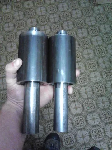

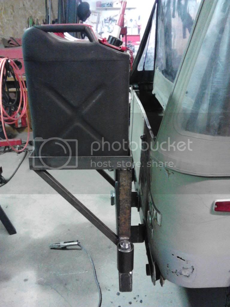

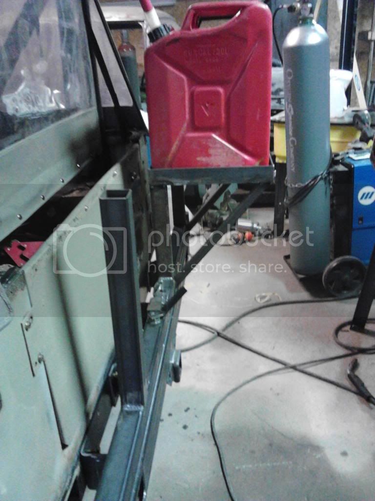

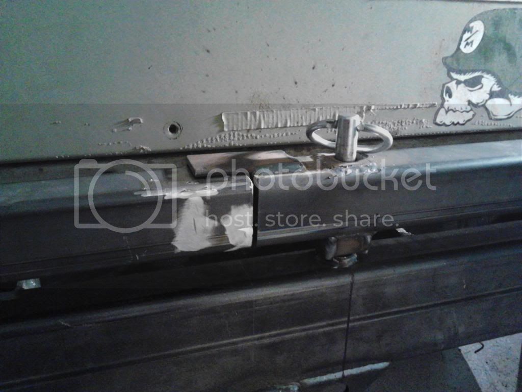

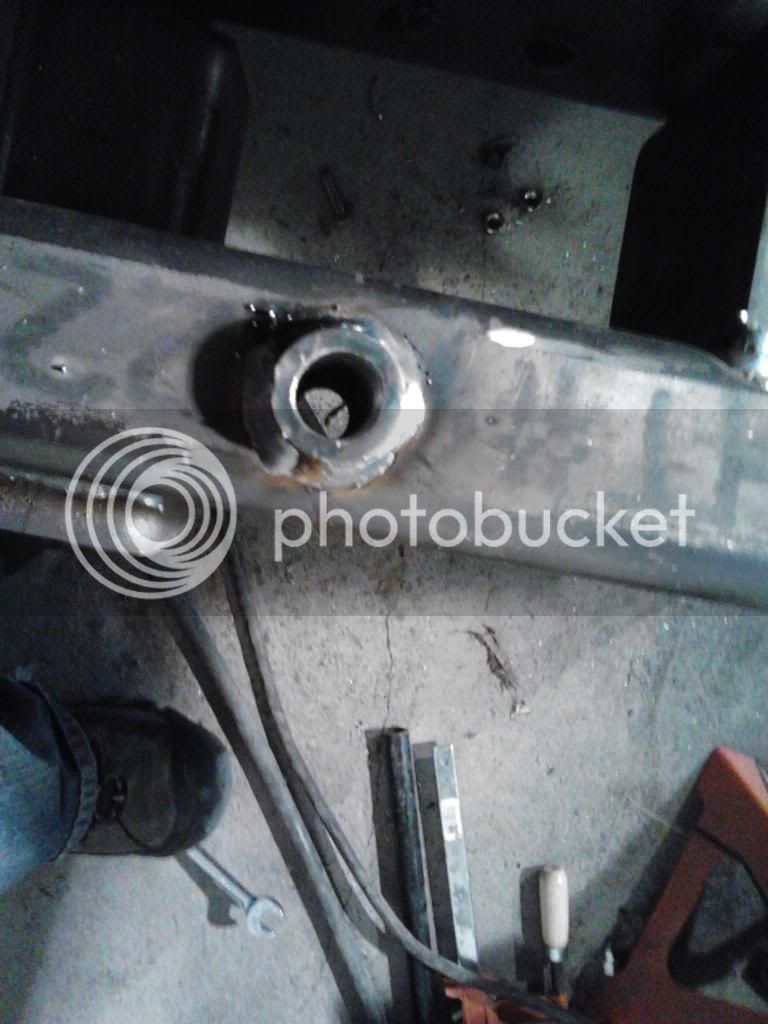

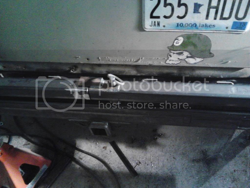

Well I ordered two sets of those spacers for the Bezel. Also I stopped by my parents place and my dad machined me up a couple of hinge carriers.

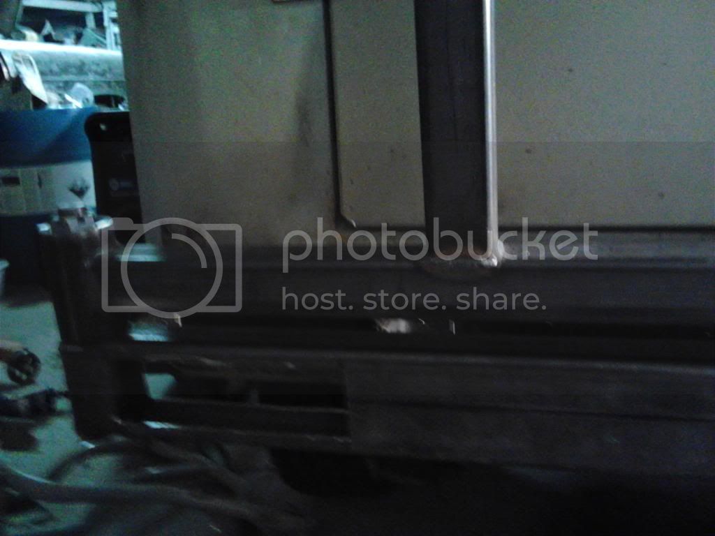

These things are beef cake! I used heavy gauge dom tubing. I might get the welding them in tomorrow and making the swing outs.
Got a little bit done tonight, not the prettiest thing I have ever made but it seems to me that the concept I have going is pretty solid. I am thinking tomorrow I can have it mostly done.
The one side has a spring action pin, and the other is getting a bolt with a handle on it, should hold everything nice and solid and still be somewhat manageable to use.
-Sean

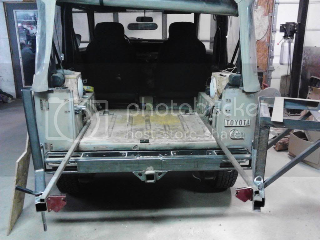

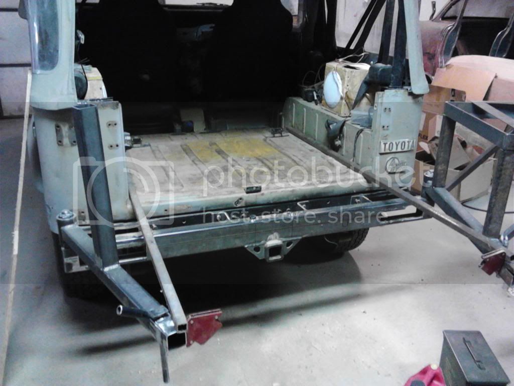

Got some more Bumper work done.

So I have this idea for a sleep platform and am curious as to what you guys think of the idea.
I plan to make the platform either slide out in several sections to fit in the bed or use a couple piano hinges to connect the boards, the idea is to make a lockout in the position I need on both swing outs and another piece to be a receptacle for the platform, then from there make a tent that attaches to the cruiser and to the platform to keep bugs and rain out. For the tailgate I will hinge what I currently have and use some toggle clamps to hold it up. What do you guys think good idea? Or not so good?

Well got a little bit ambitious and started on the sleep platform.

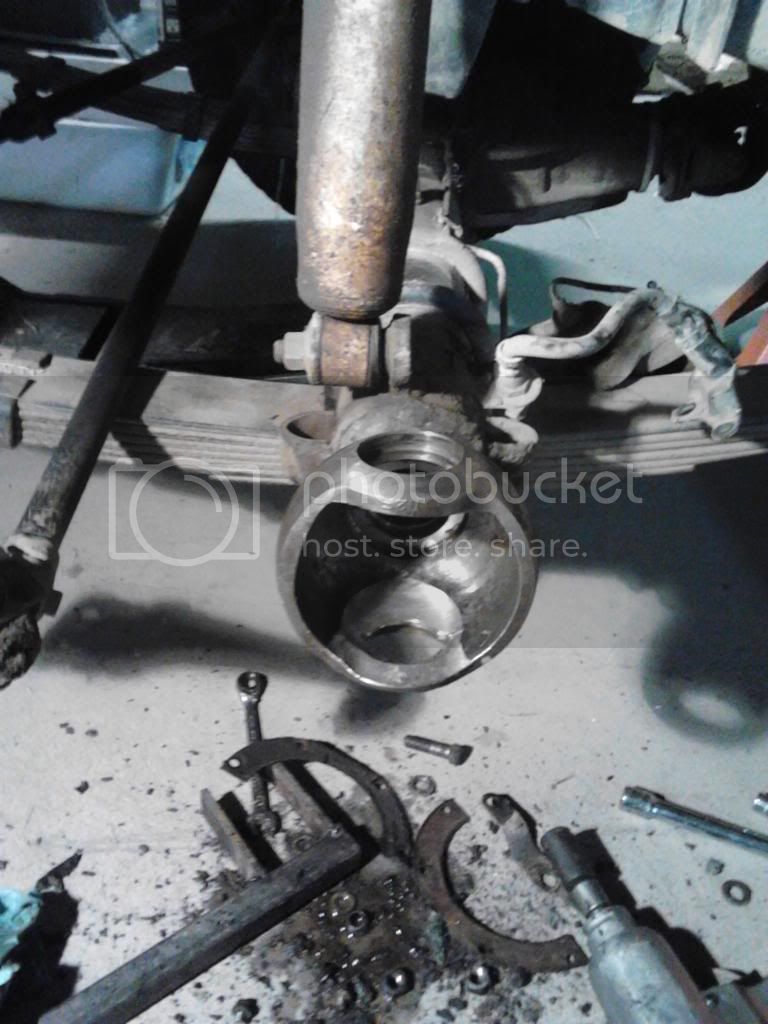

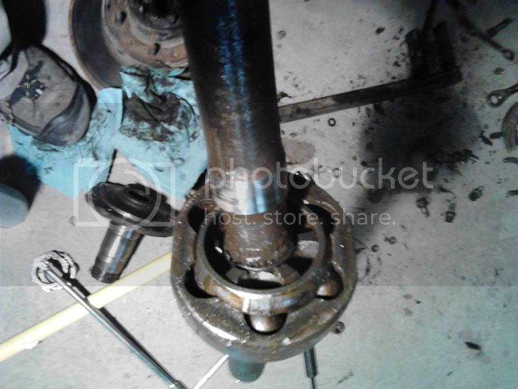

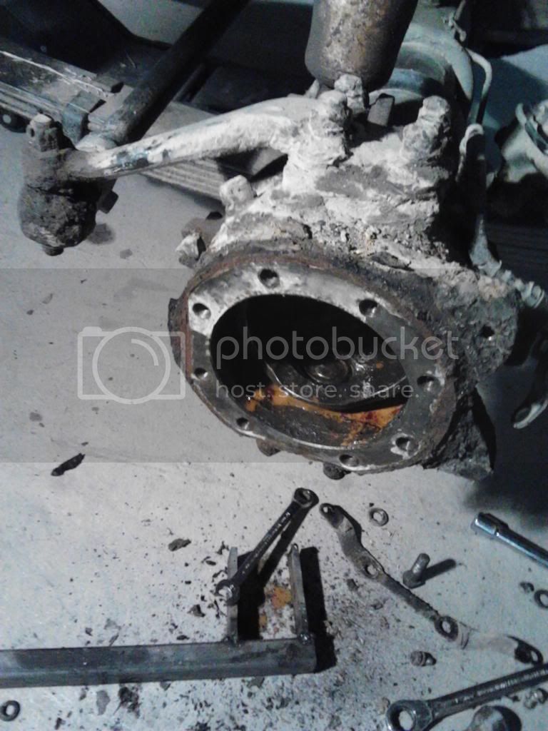

Does anyone have a good recommendation for birfs? One of mine is clicking when engaged in 4wd and since the truck is parked until spring I want to replace/upgrade them. I also have a line on a hardtop for this beast :D
-Sean

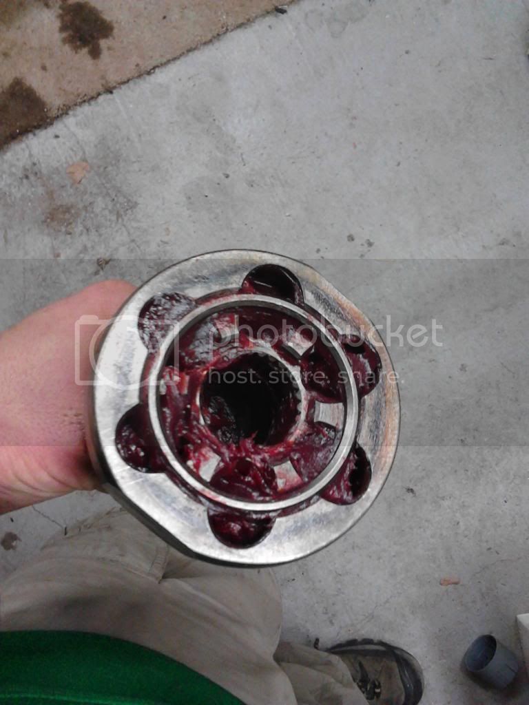

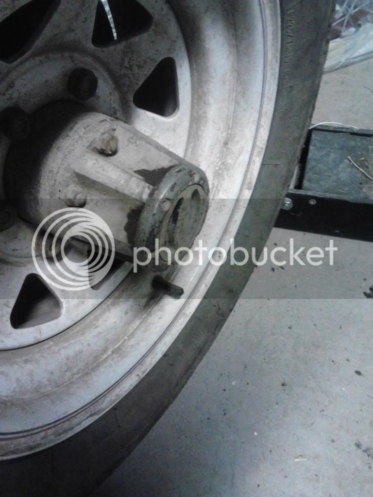

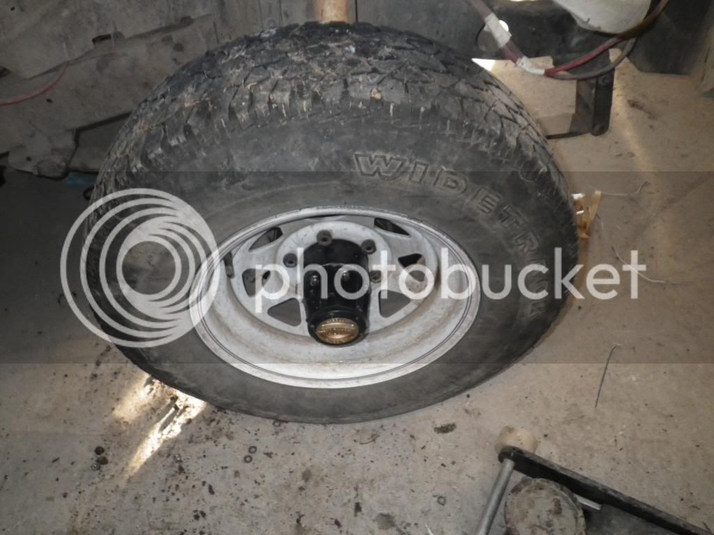

Got started on one knuckle tonight, I found water in it and the grease was looking pretty rough. So I disassembled the birf cleaned it and repacked it with new grease. The knuckle bearings were also pretty rough so I am glad that I am redoing them.
-Sean

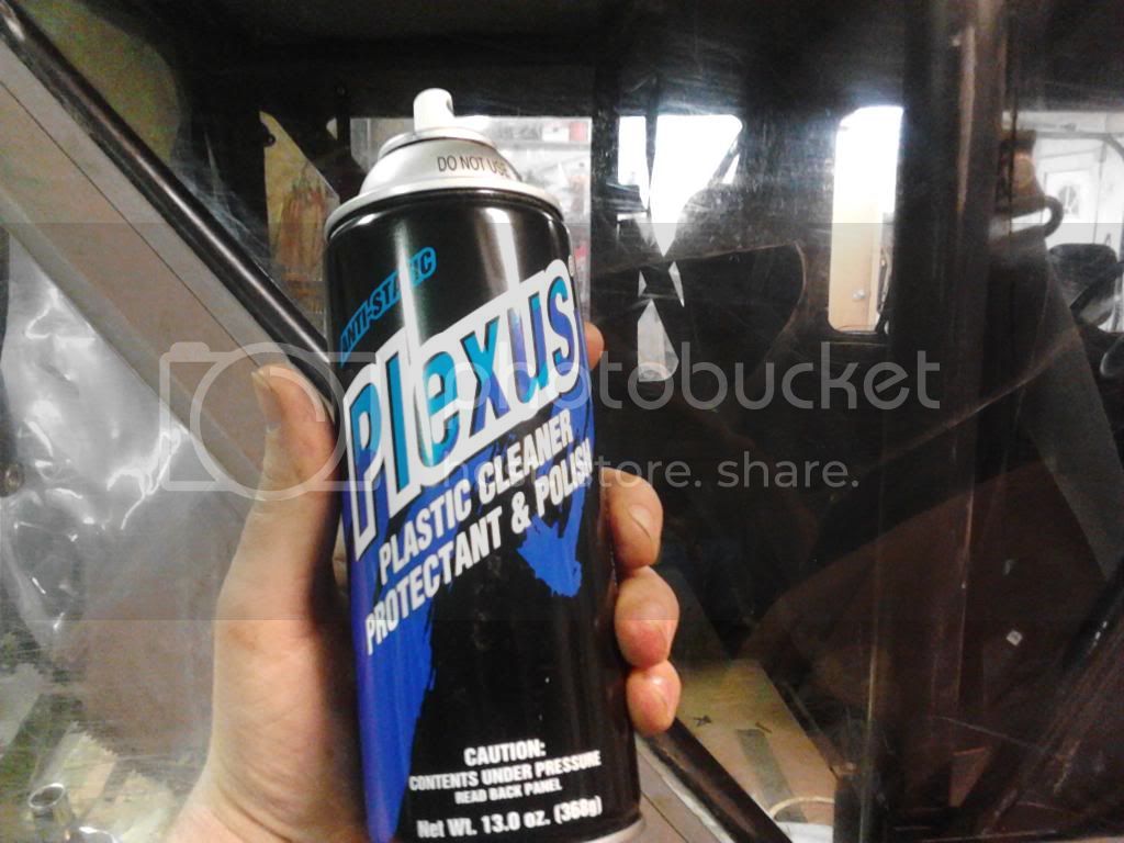

Anyway this plexus stuff is really awesome.
Before
after

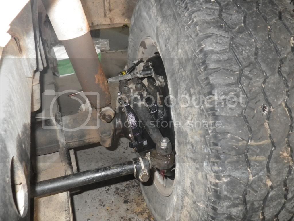

No idea on the birfs, my suspension leaves pop a little when turning, but I think my birfs are fine. It's good that you're rebuilding them and replacing the trunnion bearings. That alone might help a lot.

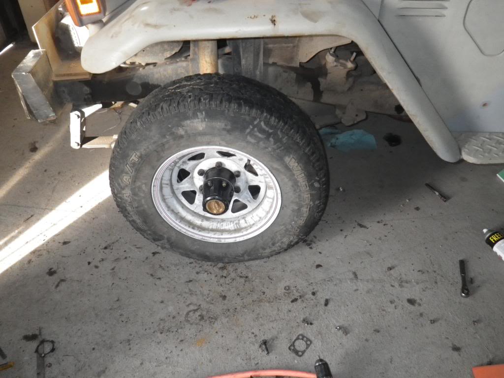

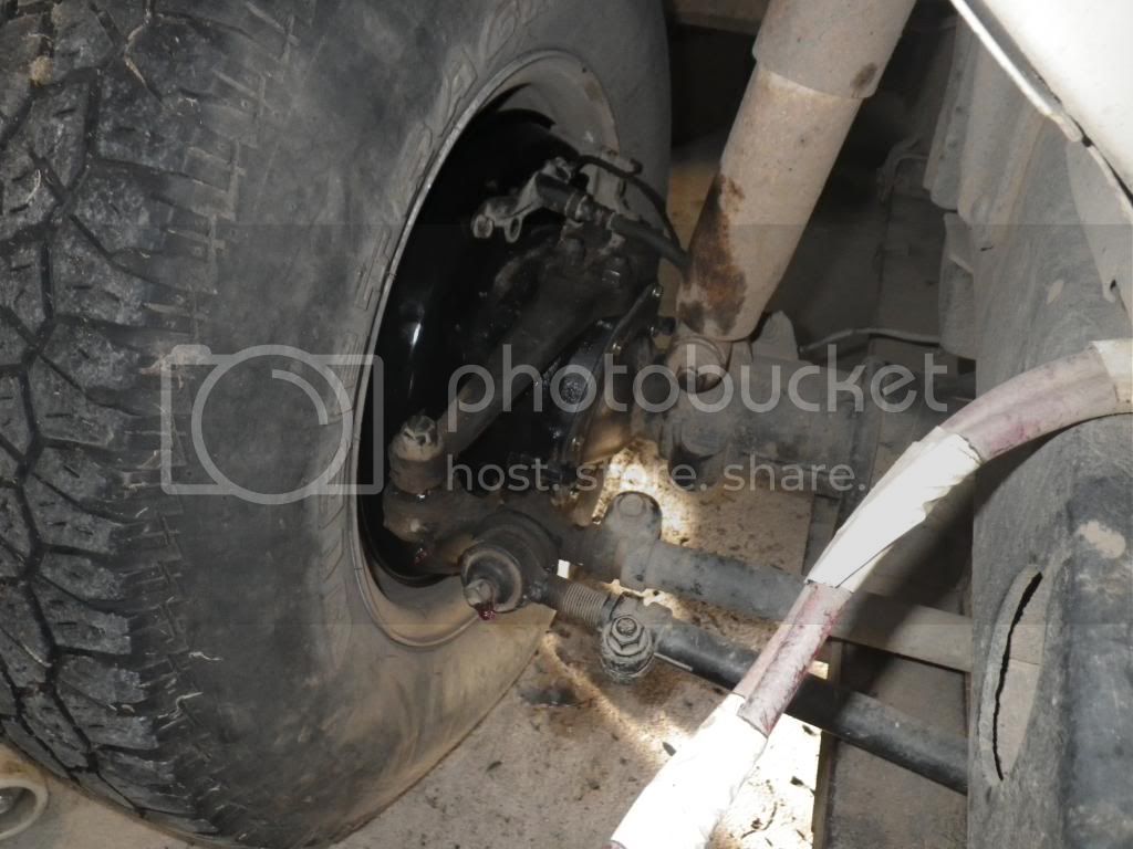

Finally got the knuckles all back together, what a chore... with all the shimming, and cleaning and painting...Only to get covered in dirt again in the spring lol.

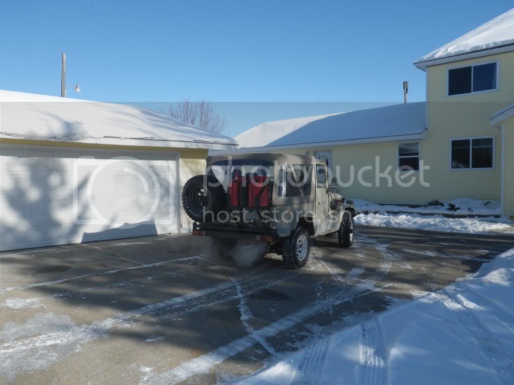

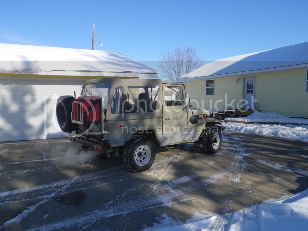

Finished my rear bumper, so I then pulled her out of the garage and filled up the tank, and drove her 50 miles just to keep things working right. A few pics.
