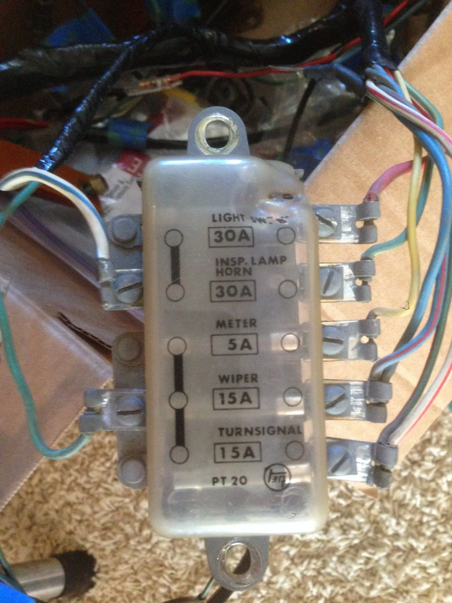

Started on the wiring. Stripped off the outer tape. Found most all of the wires are in good shape. Just a few loose connectors that need to be replaced and two wires that I don't know what they power.

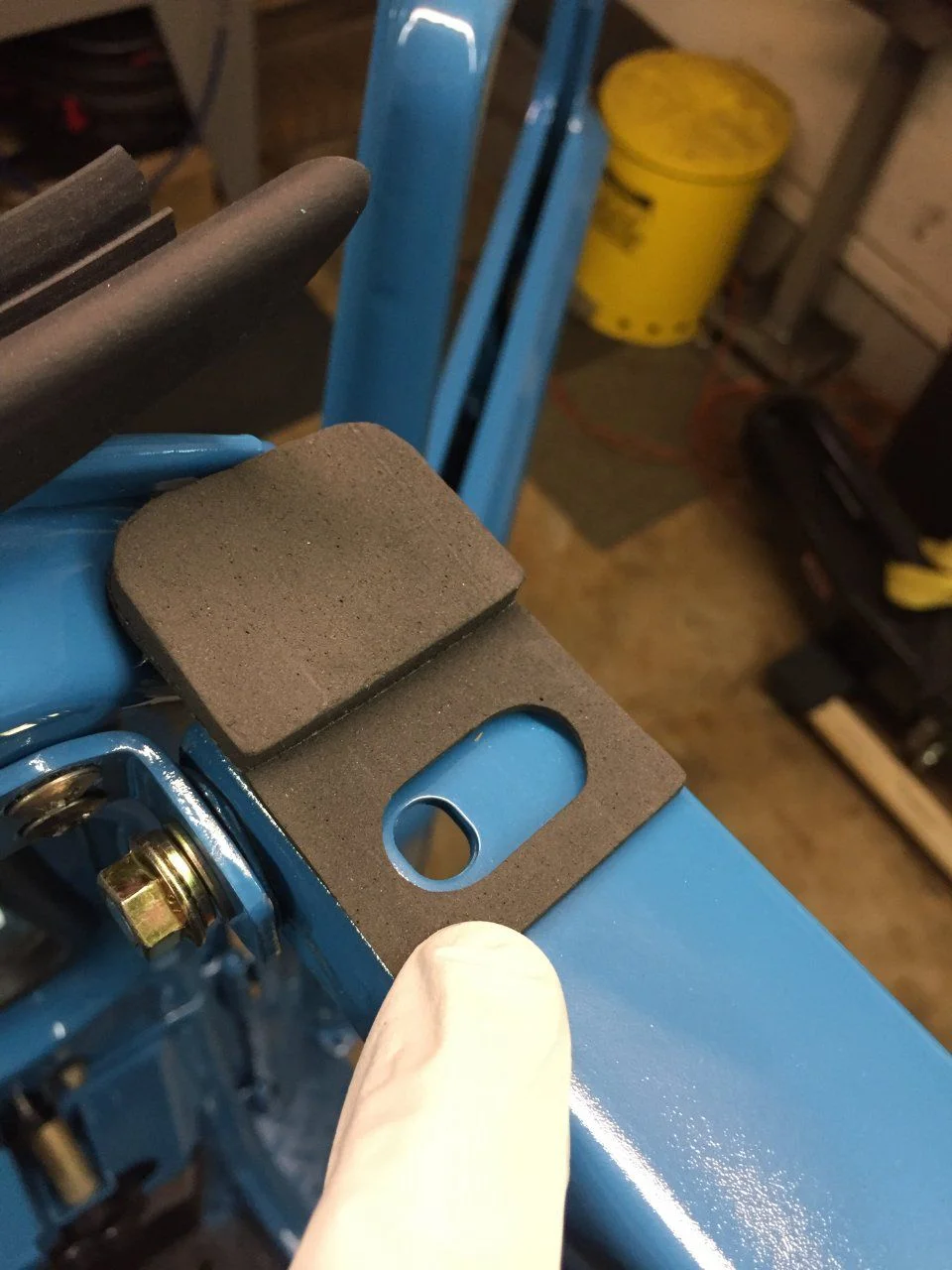

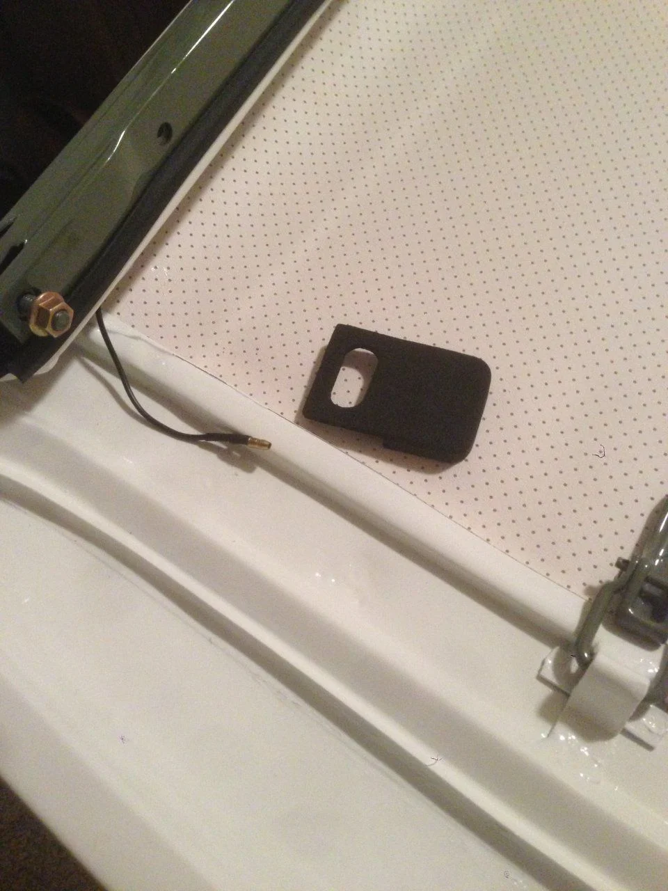

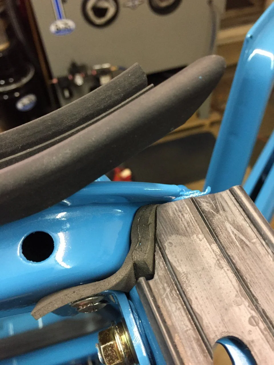

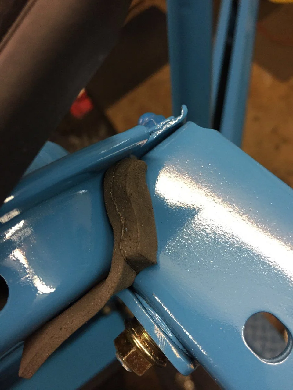

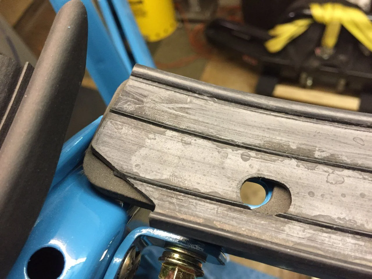

On 40's it installs like this with the top gasket laid over it. The gasket comes up short on 40's.
But installed mine like this because that is where the air leak would be on my 45.

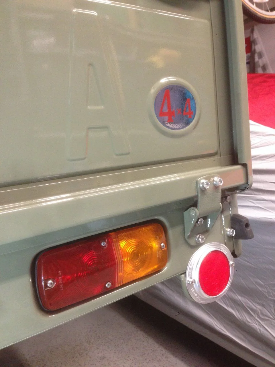

My bad kreutz. I thought you were talking about my tail lights not kunzma's.

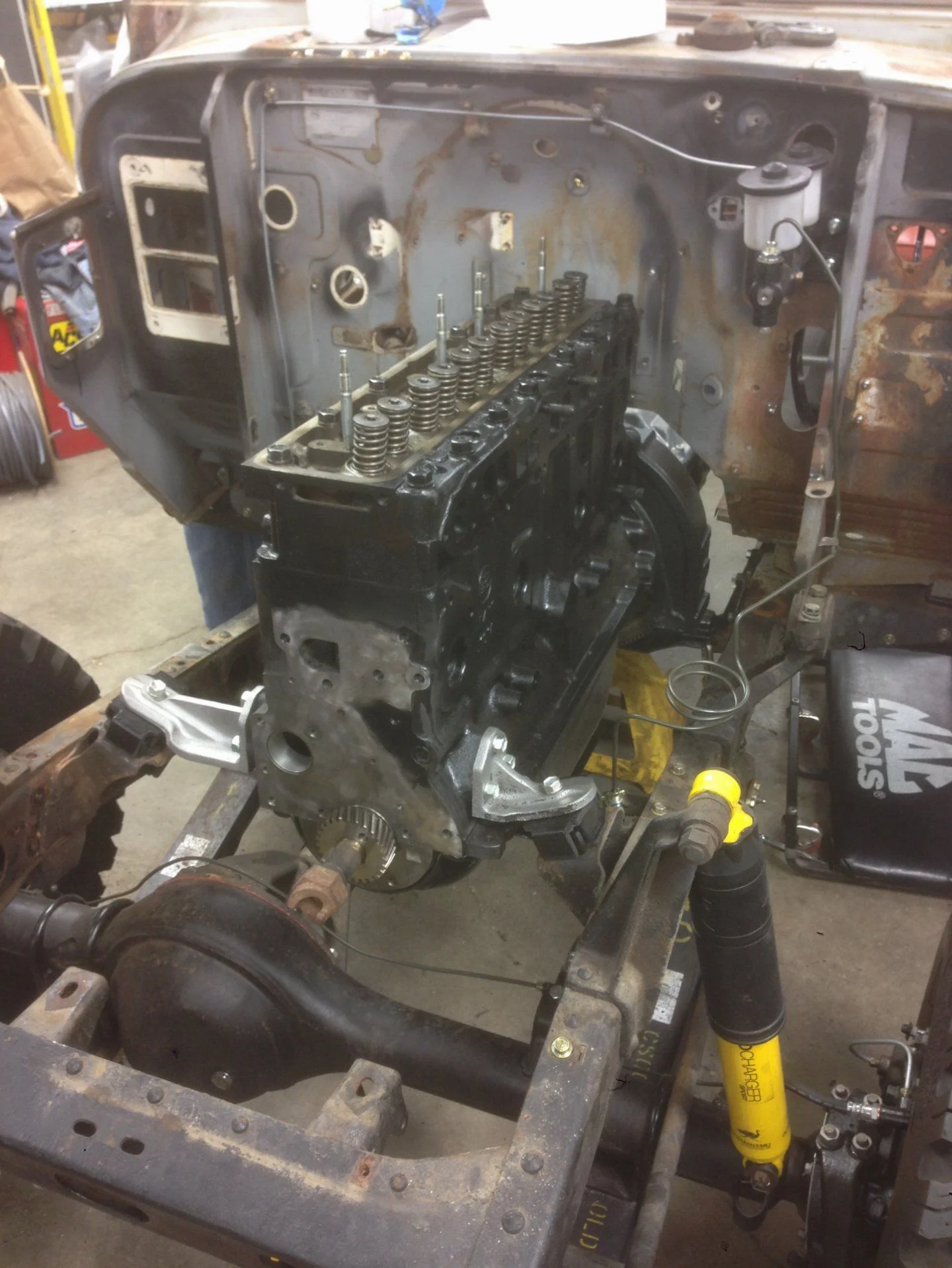

I got the camshaft back and it only cost $100 to have three lobes redone and to go thru their whole process. The engine work should start to move forward again.
The rear reflectors (Grote 4023) were purchased on Ebay for a little over $8 for the pair with free shipping. They are an american brand that hasn't changed design in 50 years. I've seen them in pics on 45's and they fit perfectly. I think that some of the dealers were installing them once the trucks arrived from Japan, but I don't know that for sure.
Sorted out the wiring and rewrapped it. Disconnected the fuse block and soaked it in vinegar for an hour. Then hit it with a toothbrush, the dremel tool, and sandpaper to remove the paint and corrosion.

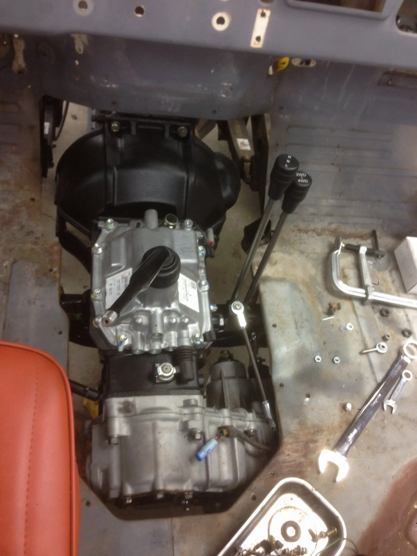

Poser fitted the 2F engine and H55 transmission. The shifter needs to be straightened and the twin sticks need to be bent to the left. Looks like a tight fit but will work without a body lift.
