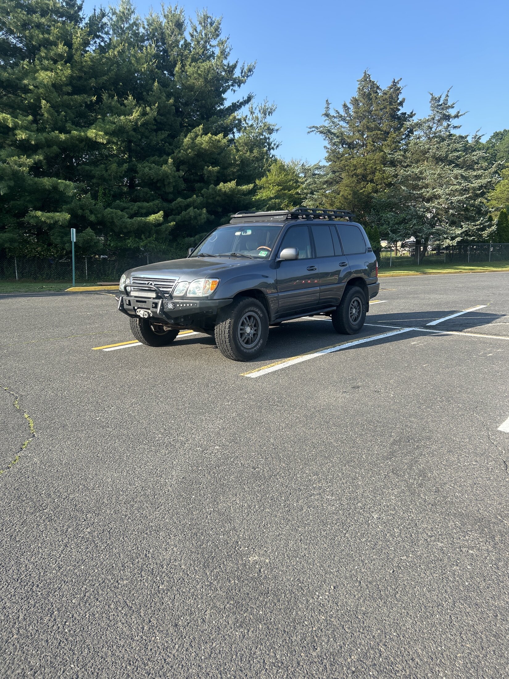

I got 14.6mpg on a 100-mile drive today. Back from 10.4 logged when I first got it. I must be doing something right. 34's, roof rack, drawer system, 1.5" lift and all.

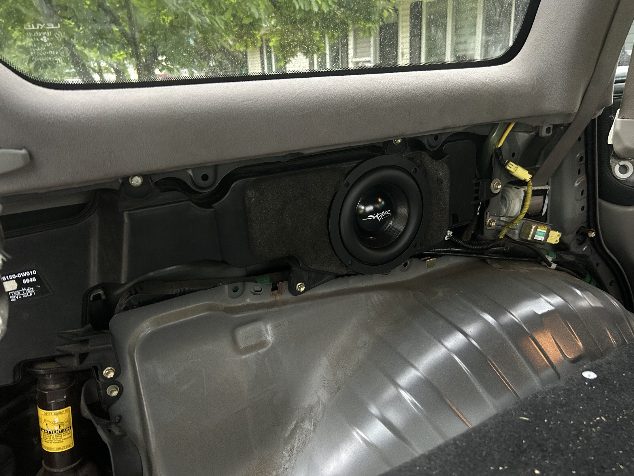

Did your amplifier have 4 wires or 2 wires to the subwoofer? If you had 4 wires, how did you wire it?
It had a place for four. I jumped one junction to the other and then wired the oem positive and negative one to each junction. Worked like a charm
