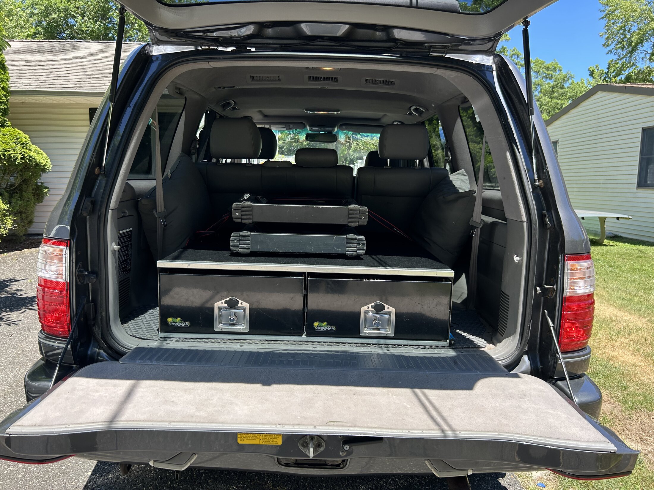

Put an Ironman 4x4 double drawer system in the back. Really digging it. Also got a few outdoor cushions. Kids love tailgating with a pillow against the drawers. It’s not too bad when changing from a wetsuit either.
And a bonus, the weight of the drawers evened out the suspension. My rake is much better now

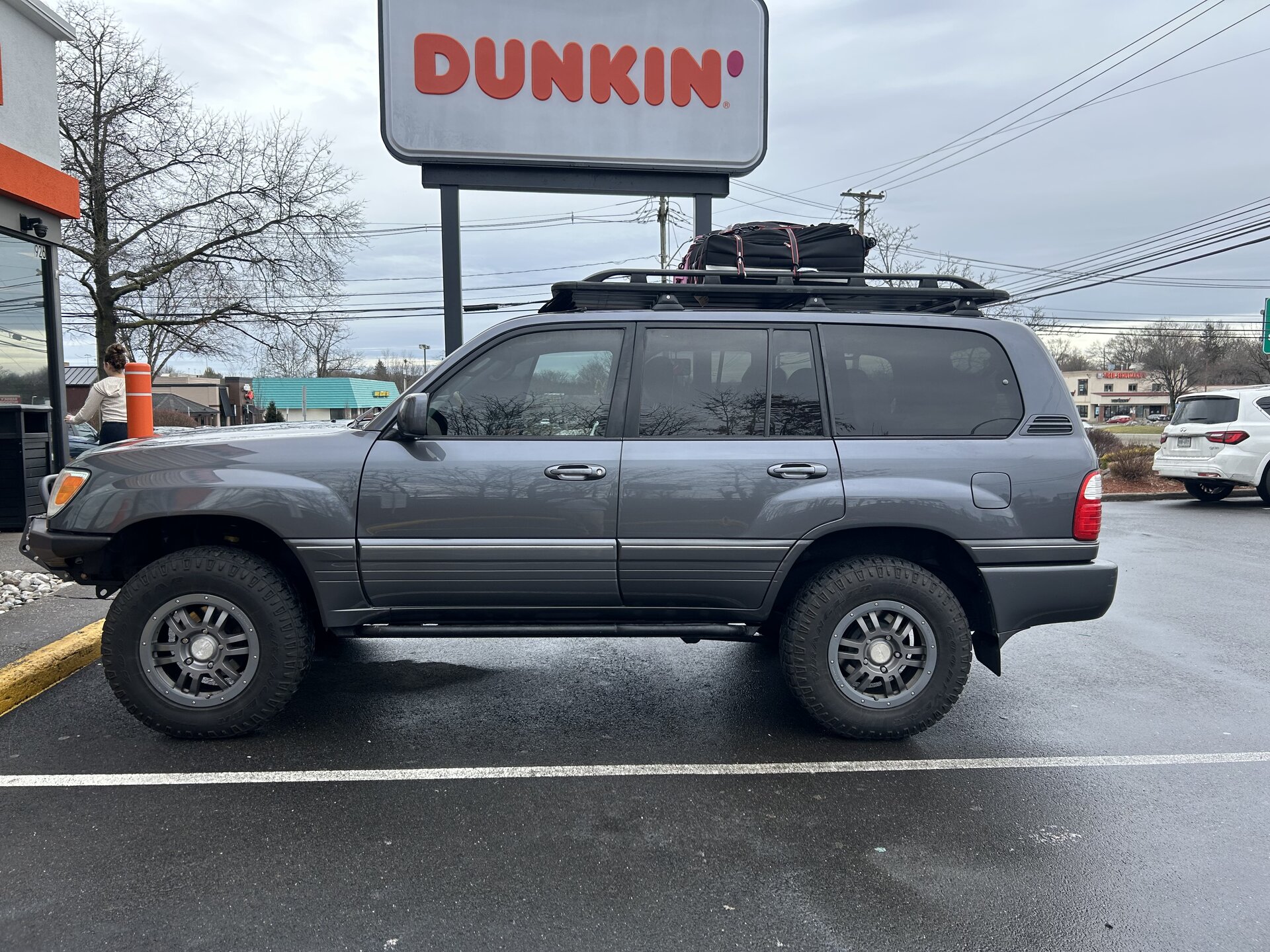

285/75R17's coming soon.

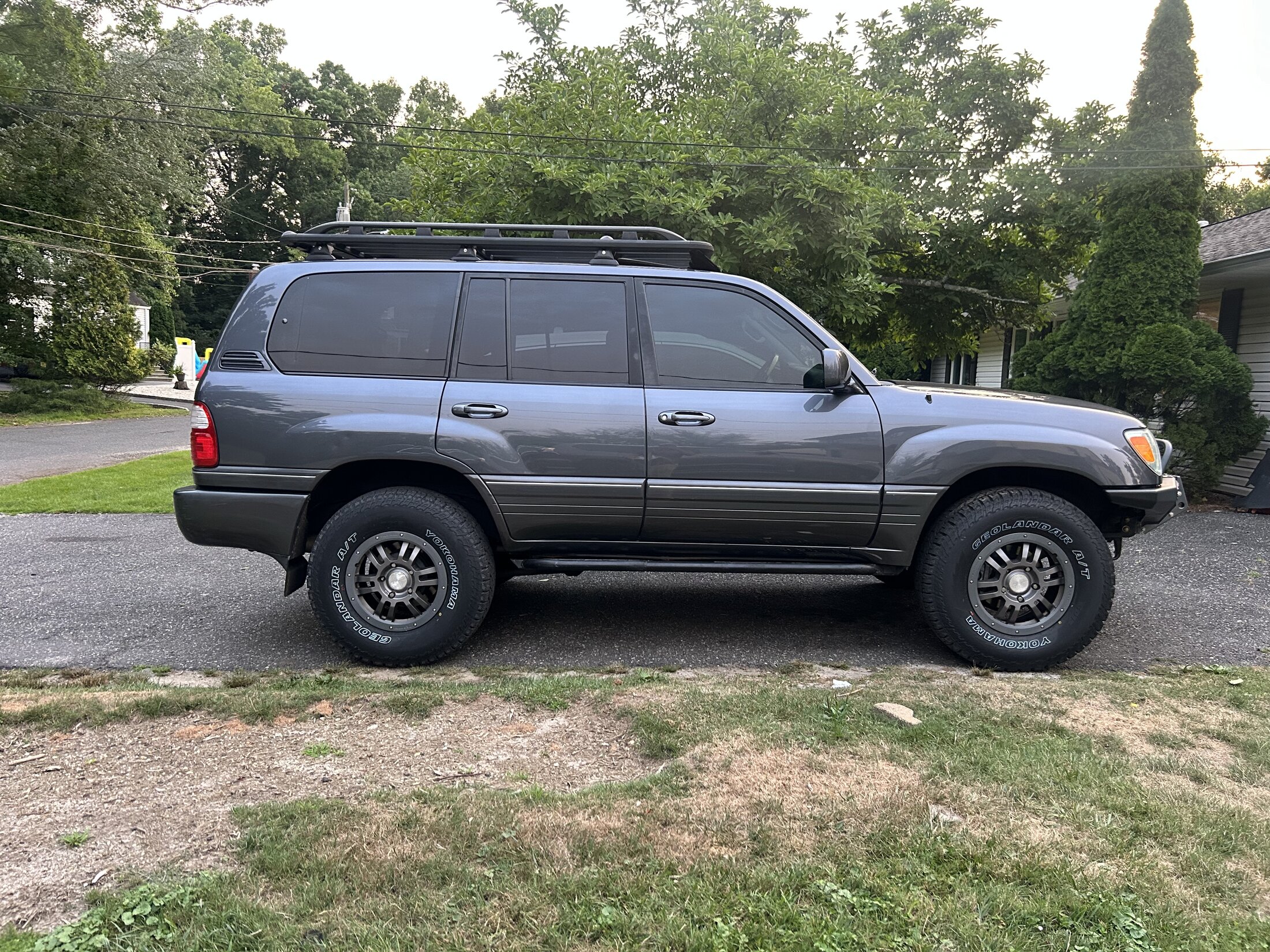

Got my new tires put on.
It really completes the look from the lift kit, but not only that, as suggested by someone on here, I think @Kamran Khan - the new tires without slime, properly balanced, etc feel SO much better on the road. Despite being an inch taller.

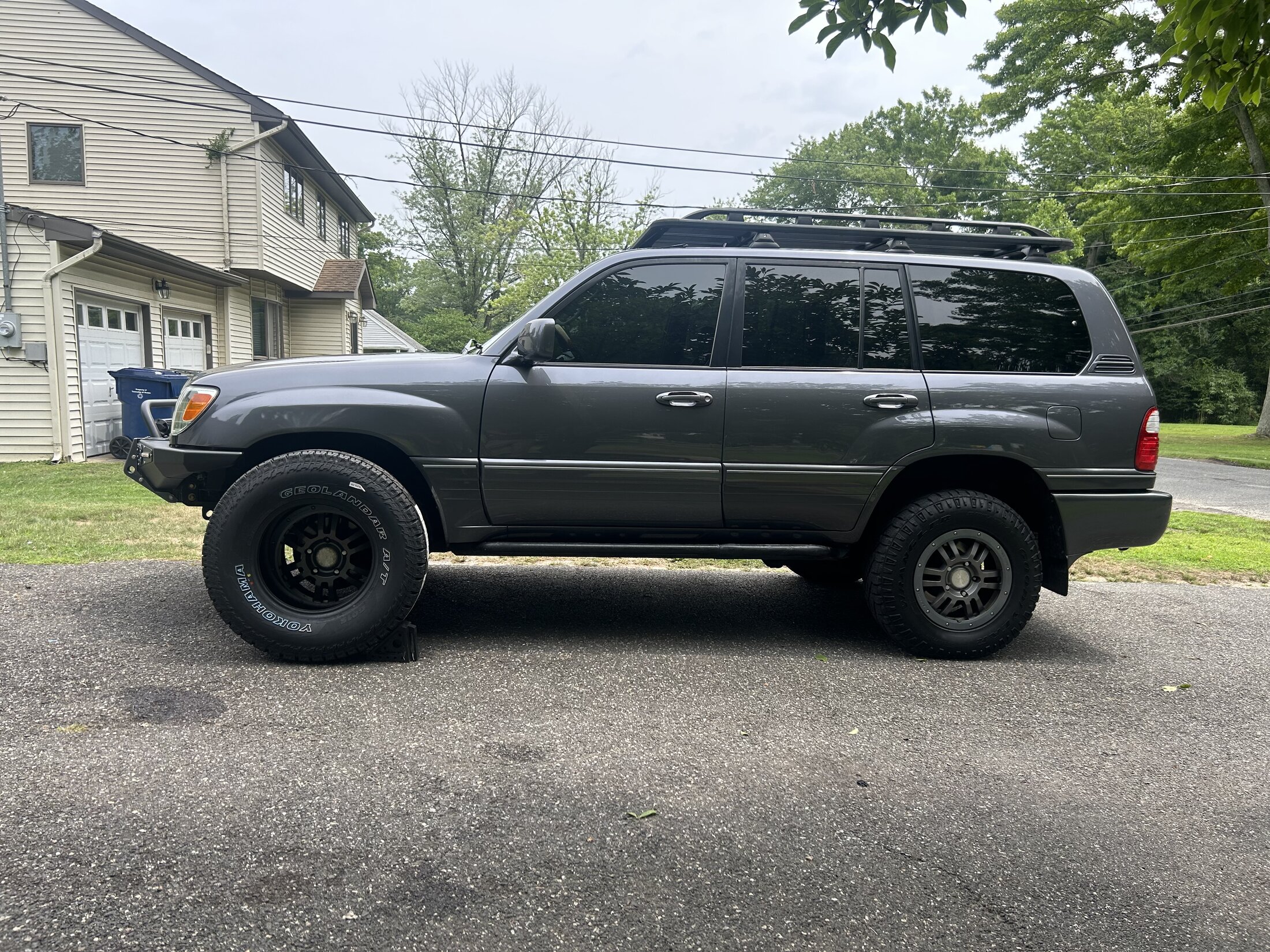

Now for the rub. They rub. The rear clears by a bunch. The front hits the interior plastic liners on extension. Any tips? Also I think it shifted a metal cover for the pass side AC line. It’s now sort of floating back there.
YOKOHAMA G015 286/75R17
Chopped the pinch welds this morning, primed and painted the area, reinstalled the liner & heat molded it it out of the way.
Looks like my metal rock slides are contacting. They need a little haircut too.
Changed the front pads too. Trimmed back the sliders a quarter to a half inch. Went for a drive. Eliminated all of my annoying sounds by doing the tires brakes and dust shield. Now all I hear is the gentle creaking of my Ironman drawers, and the vibrant heartbeat of my manifold exhaust leak.

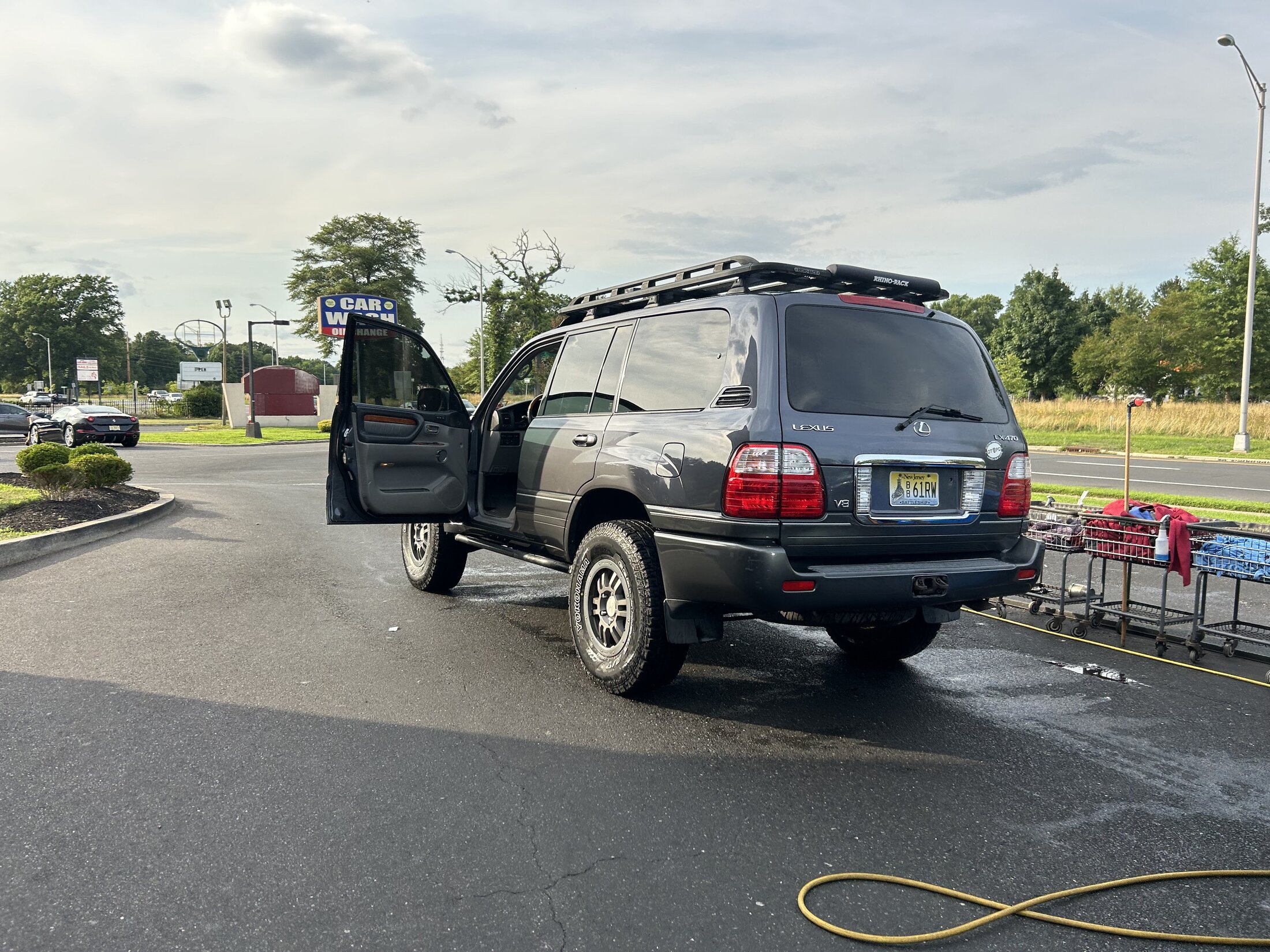

Also I got a car wash

Looks awesome! I believe either the driver door or the rear left door is repainted. Ask your local body shop if they can fix this tiny imperfection. Maybe a compound polish can fix it.

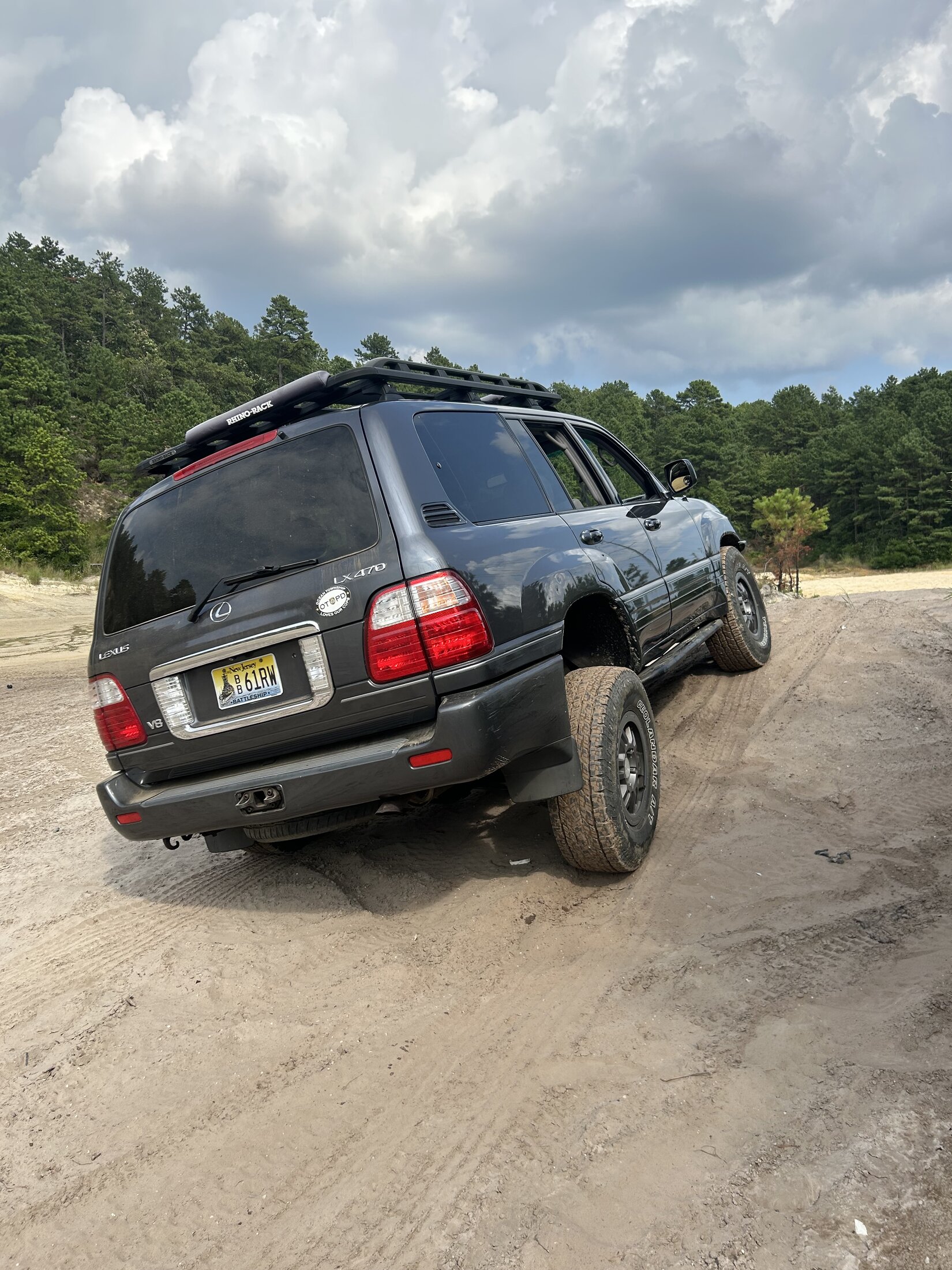

17mm ratcheting wrench made short work of my rock sliders. Slid them back as far as they would go & further trimmed the wheel well liner.
Then took it out to some local trails. It handled like a champ.
