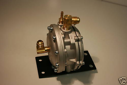

The one's I'm familiar with are for the automotive LPG application , the filter is incorporated into the lockoff valve . Small round felt about 3" dia and 1/8 thick that filters the inside of the tanks & line.
Looks like this :
But required vacuum to open the flow of liquid LPG , Your system your describing is filtering LPG in a gas form .
