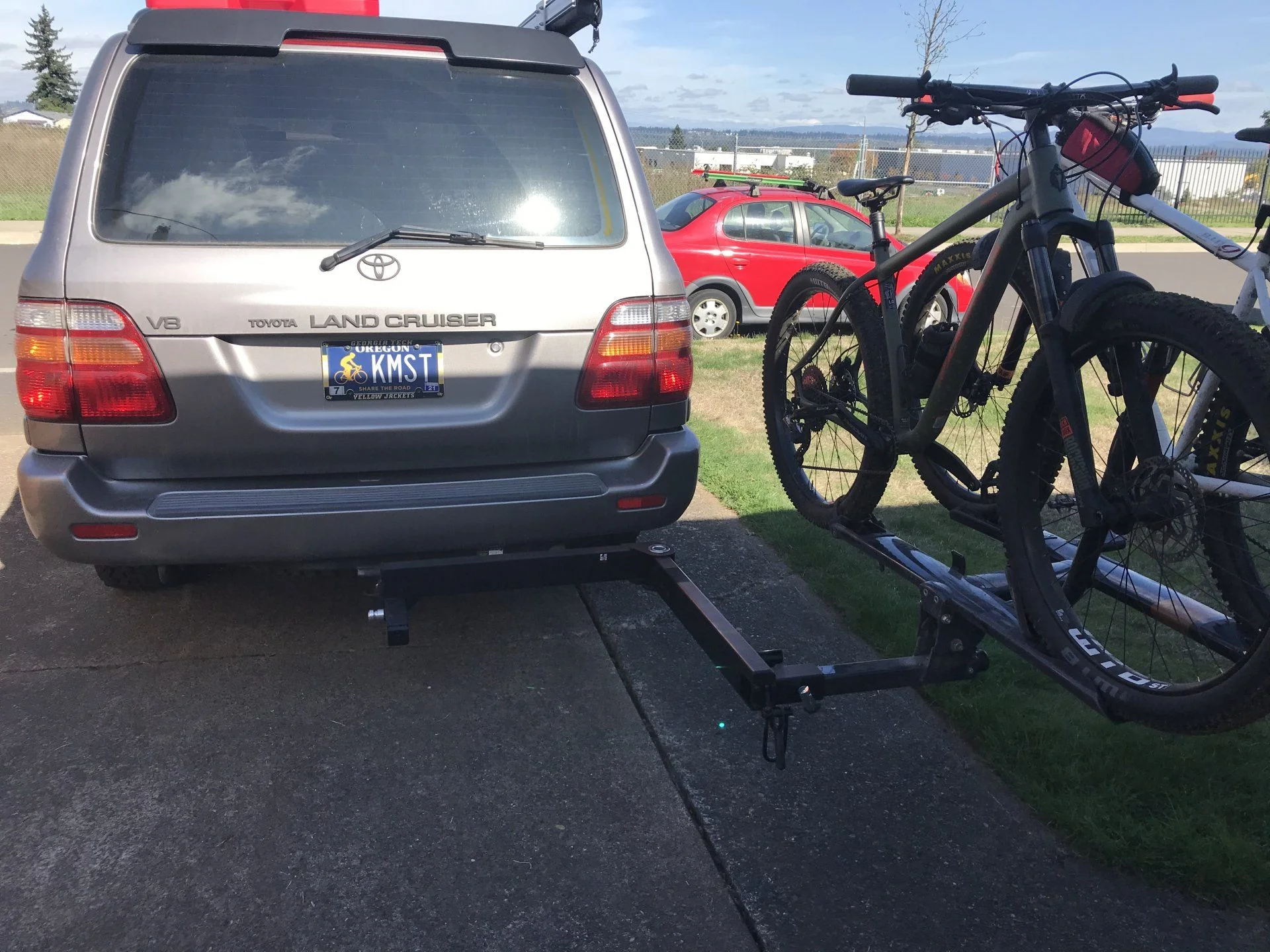

We have the Kuat NV2 that’s on the truck 90% of the time. When we go on longer trips we also have their swing away adapter which is a great add on since we sleep in the back of the Hundo. It’s a much smoother than our old Thule rack.

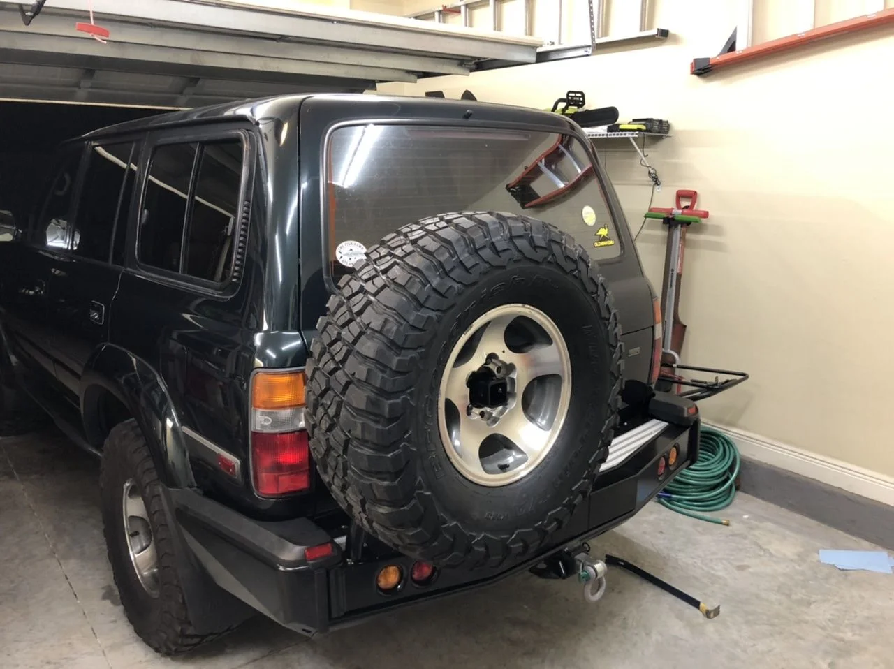

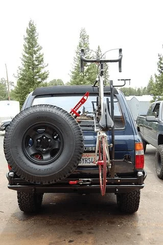

I've got an ARB rear bumper that I'd like to have the bike go out with a swing-out. The spare tire swing out for the bumper has a hitch receiver. Is anyone aware of a vertical mount that utilizes a hitch receiver? I'm thinking something similar to the Surco, but vertical. Northshore is cool, but would put the bikes up way too high.
Love this idea. Wish it could retain the front wheel!

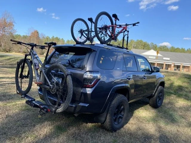

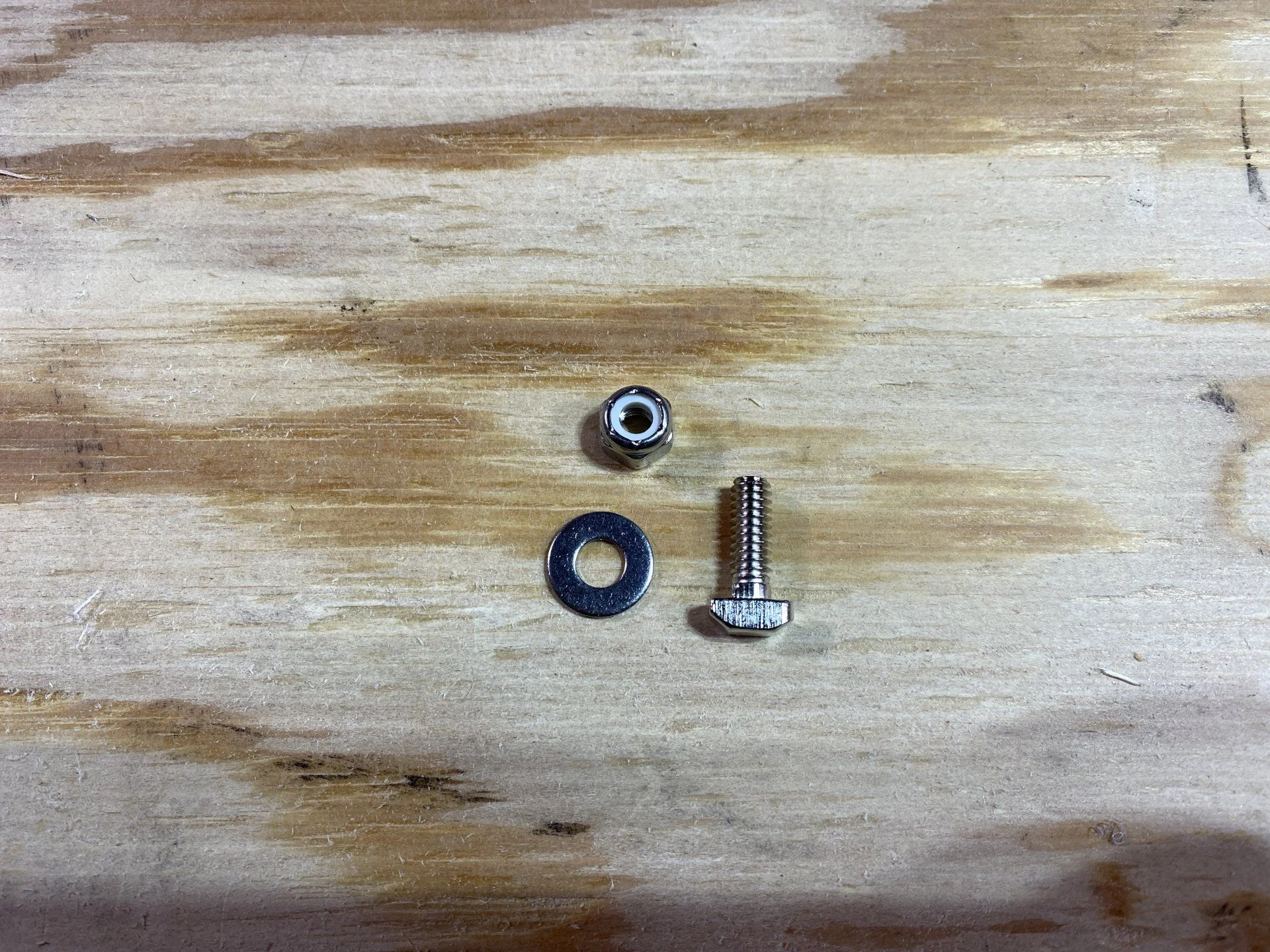

When I carry my own bike around I use my single mount 1UPUSA. However, there are times when I need to haul additional bikes for the kids and their friends. I had some old Yakima roof mount trays laying around. Now, since I don't have bars any longer on the roof I had to get creative. I currently have the t-nuts track on the roof so just drilled a few holes in the tray and added the required hardware and bam there you have it. fairly easy to install and remove since I don't need them all the time.

look up veloci rack. See if they’ll sell their front wheel holder by itself. Then you could make something pretty easily with that

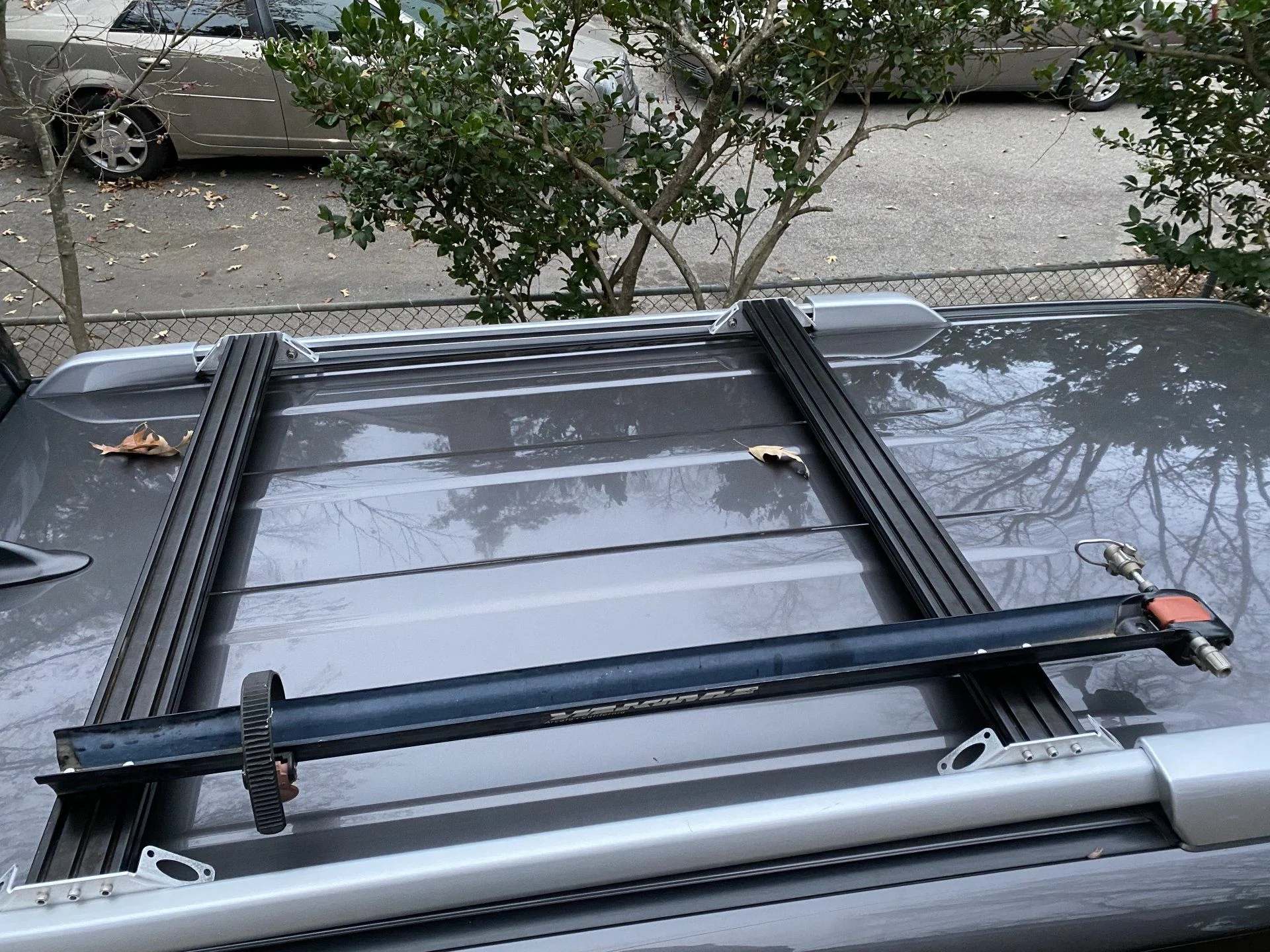

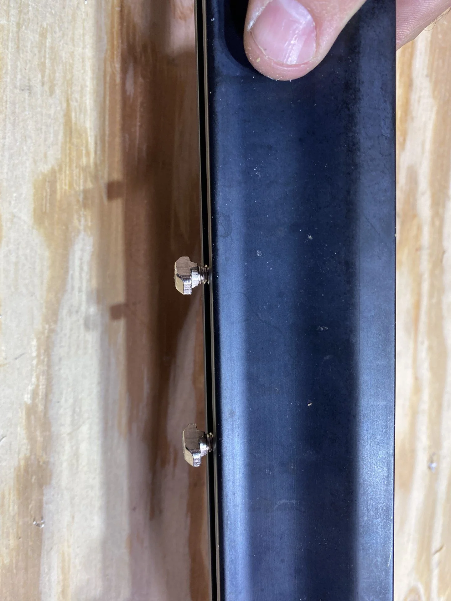

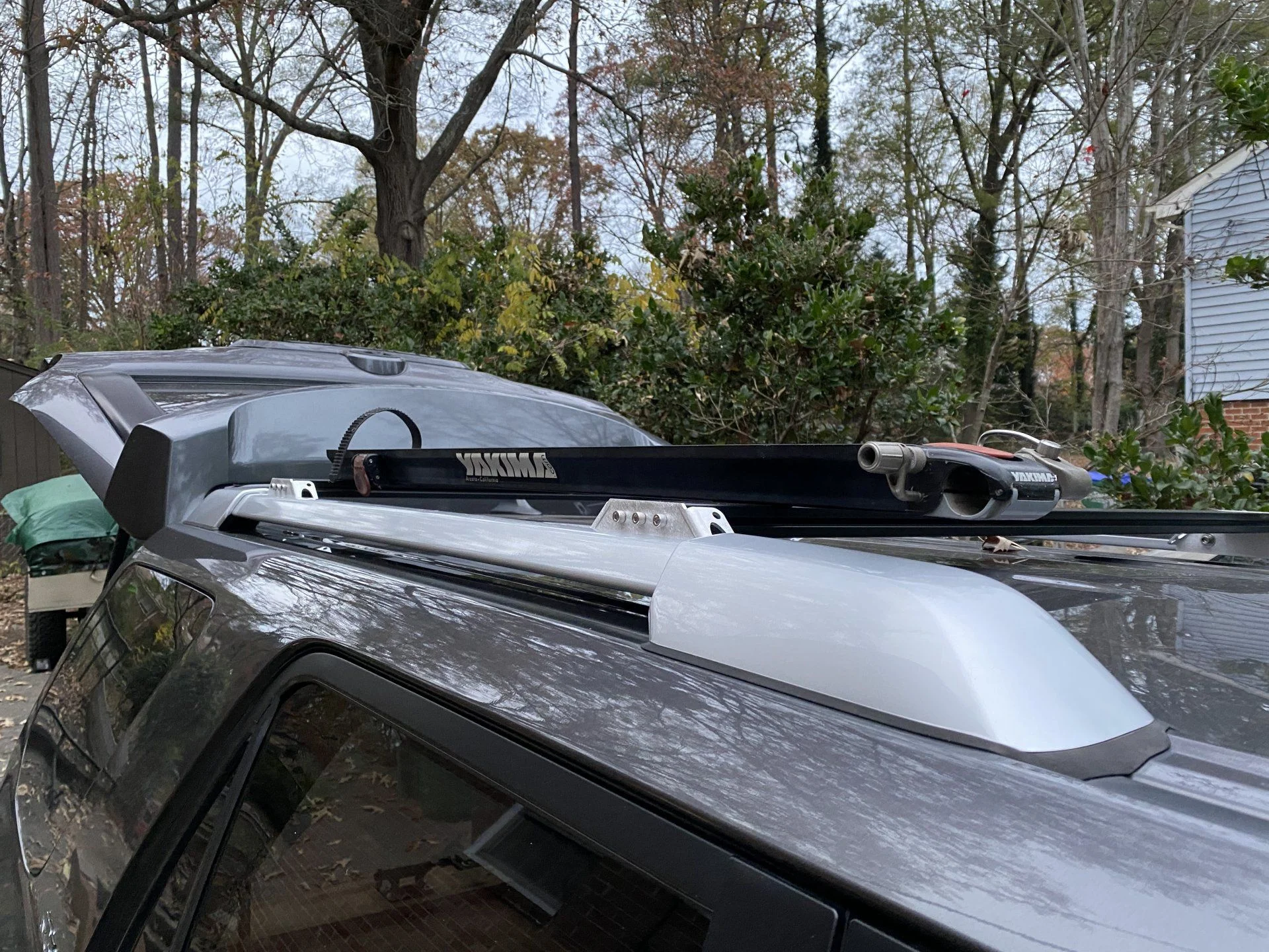

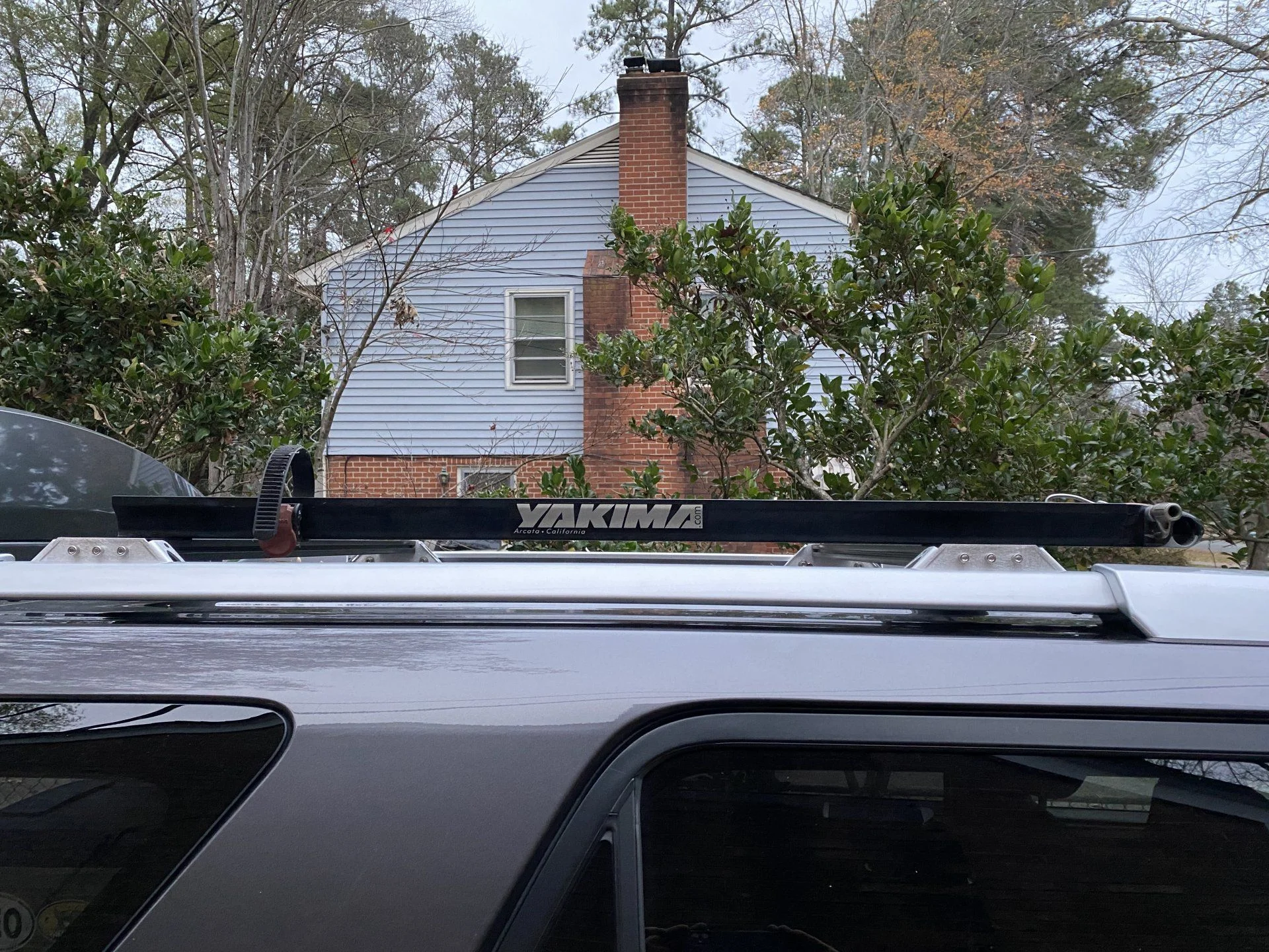

View attachment 2503952View attachment 2503952View attachment 2503953

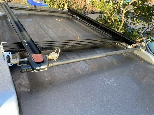

UPDATE
added the second tray and a bar across the two to keep them from twisting. Bar is wrapped with electrical tape until I get proper caps and proper rubber to “lock” in the tray to the bar

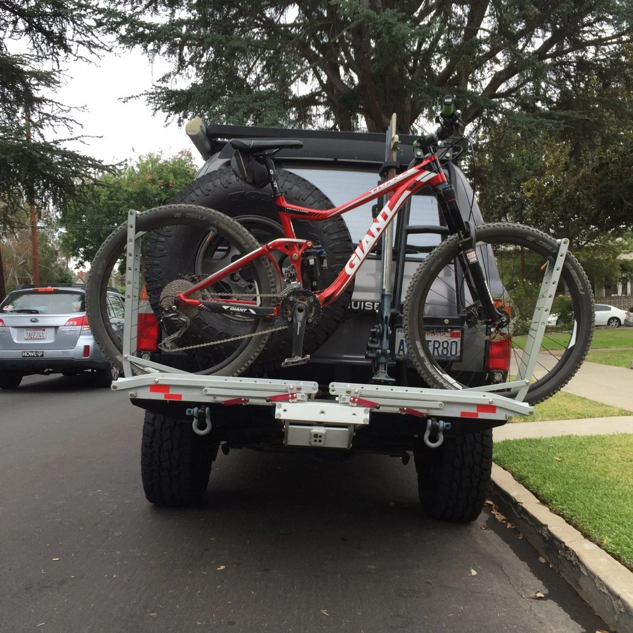

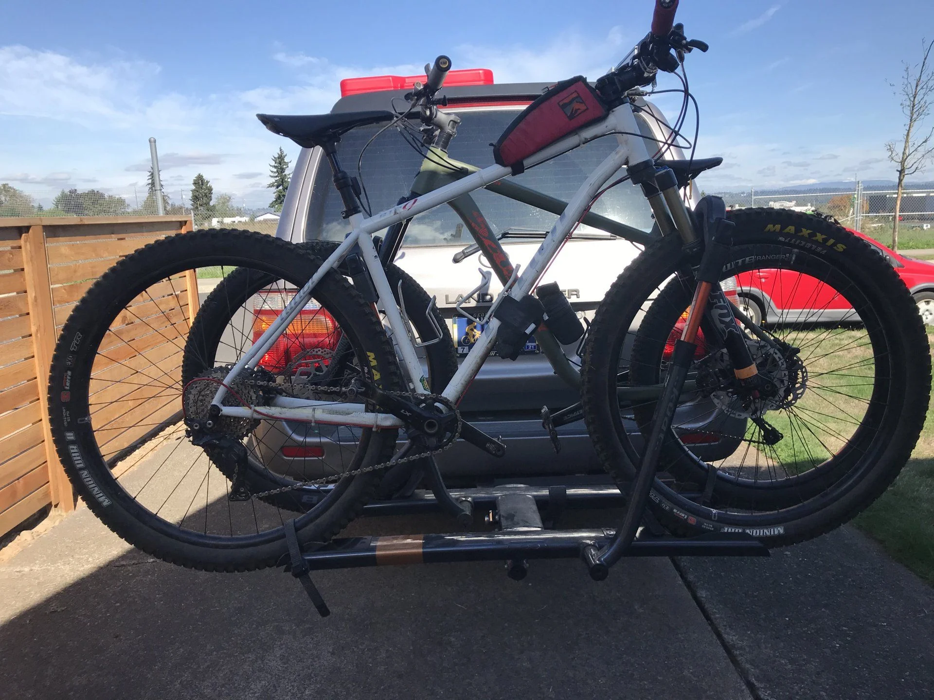

Another vote for 1upusa...
I had a Thule vertex 5 bike rack and it was a PITA. Bikes bounced around, fork stanctions were scratched and that was enough for me to put it on Craigslist.
The 1up will carry between 1 and 4 bikes. I don't recall how small of a bike it will hold but for sure it will hold 20, 24, 26, 27.5, 29" in bikes. Will work with road bikes and fat bikes. As stable as can be. No bike damage during transit - on or off road. Ridiculously easy to mount/dismount rack, and bikes. I love it. It folds up and down.
With my labs rear bumper I use a hitch extension from Amazon and it fits perfectly with my 35" spare

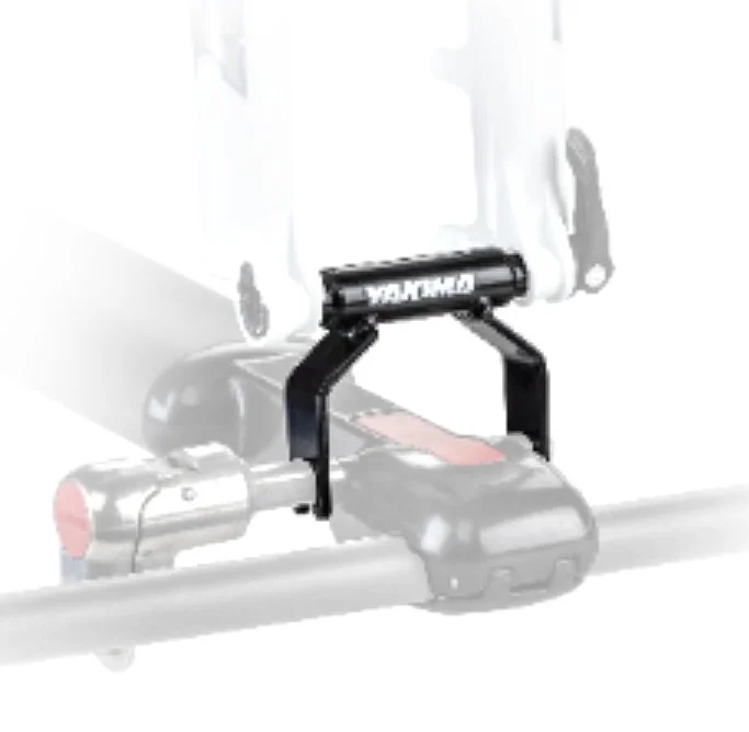

Related question: from what I've seen of the back tray mounts, bicycle wheel bases are such that wheels protrude on both sides of the 100s, just ready to get bashed in the field.
What is the scoop on removing front tire and recentering the bike within the vehicle envelope?
My "old school" bikes had the quick release skewer such that front tire was removed and bike was fastened via fork. I have heard that it is not quite so easy w the newer wheel axles.

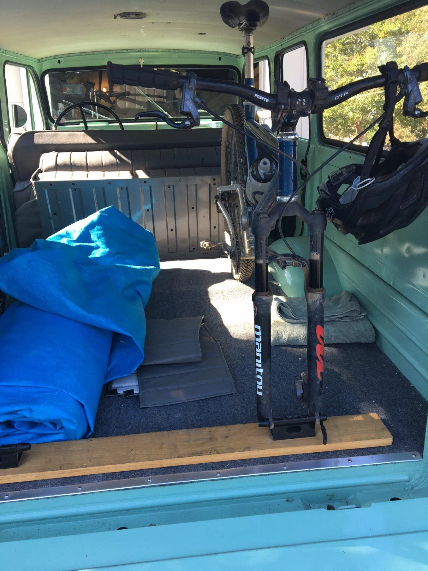

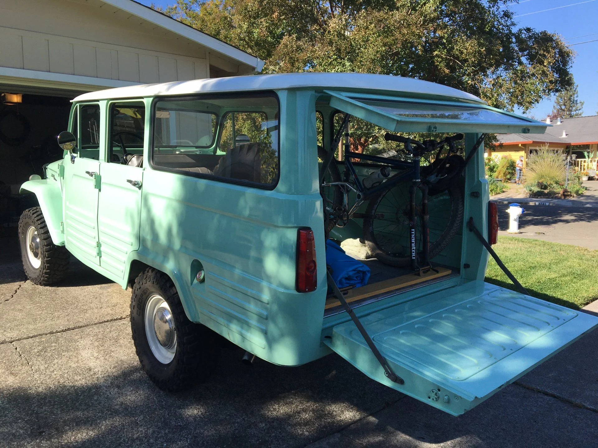

I can agree. Though on my old tech bikes (2006 stumpjumper), the front wheel remove/install only take a minute. I have to do this as to carry inside the back of the 100 requires front tire removal (which is currently my system).
Actually, the gear up/gear down takes most of the prep time.
That is exactly how I mount mine. Difference is that my plate is a three track extruded aluminum. Allows slight forward/aft adjust w infinite side to side. I'll post a pic w manufacturer.

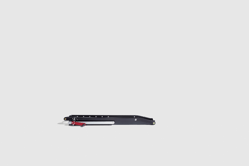

1up owners... How good is the ratcheting mechanism?

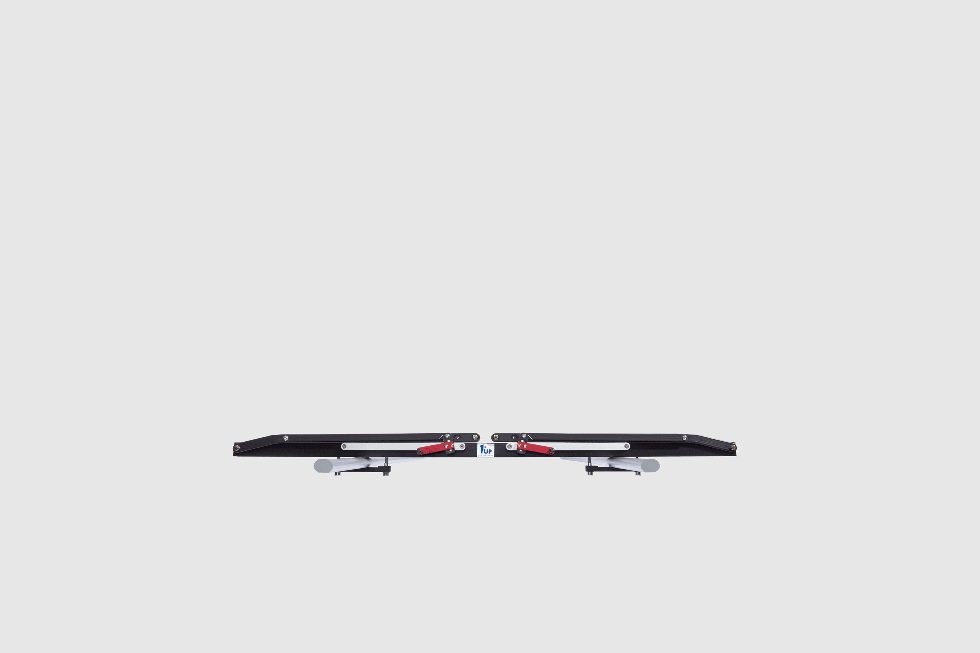

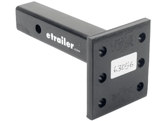

I think I've figured out how I will vertically mount my bike. I can't use the typical 1up hitch-mount system as I don't think it will drop enough to clear my tire swing out. However, I have a 2" receiver that is centered on my spare wheel that I am planning on putting a pintle mount on. From there I can flush mount 1up's roof rack system with their supplied T-slot hardware (same mount as the hitch mount but without the hitch base). It will swing out with my spare and I'll still have access to the rear. Simple and efficient.
For mounting the bike I would be ratcheting the bottom (rear) wheel mount into place, more or less, and then setting the bike in. From there I would ratchet in the front wheel for final positioning.
My concern is how robust the ratcheting system is. Are there locking pins or is it strictly tension that keeps the ratcheting tire holders in place? The bike will be in place with me on the trail on my 80 heading out to camp. Last thing I want is a few good bumps knocking the holders off the ratchet.
+ (imagine it is 90° from pictured and vertical)
= SUCCESS (?)
