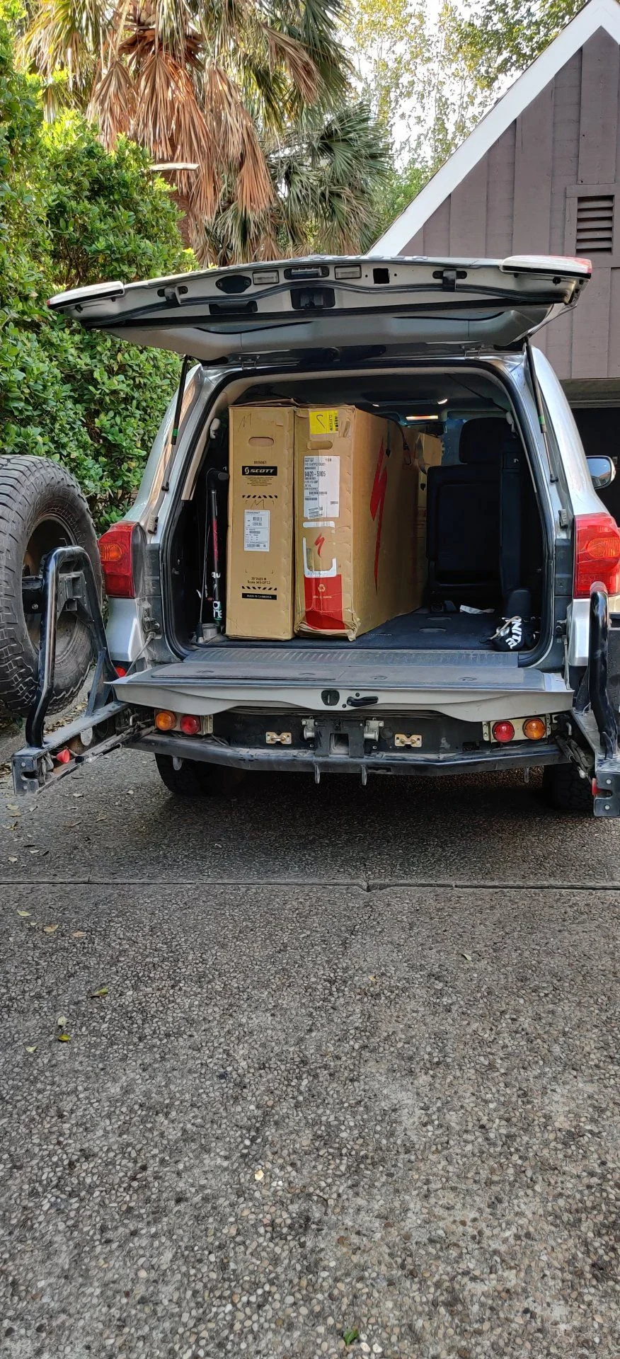

I have not yet worked out how I'm going to fit my existing 1-Up rack on my 2014 LC with ARB split rear bumper while still maintaining the ability to open the bumpers and the tailgate, but I was able to fit two bikes --along with two weeks worth of stuff --in the back of the truck with ease. Our trip was mostly centered around non-biking activities so I needed to be able to secure the bikes inside the truck. It only took about 30 minutes at the beginning and end of each ride to setup/breakdown the bikes because I was not shipping these things and thus didn't need to be too fussy about the packing. Also, carried both front wheels in seperate boxes.

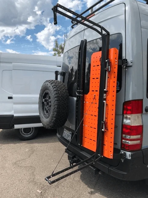

I went ahead and bought their kit. Will probably be this time next year before anything bike related shows up at the rate of things this year, but we'll give it a go. They use steel cable which I generally see flexible ones having a ≥ 250lb working load (and their description calls the same number). Talked with the owner for a bit - claims thousands of miles without issue, so we'll see!
As best I can tell it's a roof rack variant from 1UP with their "vertical bike kit" seen HERE

So, the cable is there to keep load off the ratchet and the clamping in the rack is done with the upper bar?
I really couldn't find much in the way of people using these vertically other than 1UP telling me I should use the roof rack version if I wanted to mount vertical. Why? No clue. Seems like the normal rack but with a T-slot mount. I just happened to stumble on these guys (Owl Vans) that already came up with something. "Proven" and winds up being cheaper than if I came up with my own. Only bummer is that Owl won't change out their hardware, so I'll have to source that on my own as I'm not fastening to one of their systems. Not a big deal.
While I can't speak for their methodology, I was working on something similar for my application. My thought is if the cable is fastened in a way that leaves the bottom bracket slightly acute from 90° with the mounting point, this now becomes a "fixed" position when the bike is installed. This is beneficial in that it cannot extend further for security and also for helping to get the bike put up. Drop the rear wheel in the bottom with the cable holding it in position and crank down on the front wheel with the top, ratcheting bracket. Tension on the front pushes into the fixed rear. Should stay secure.

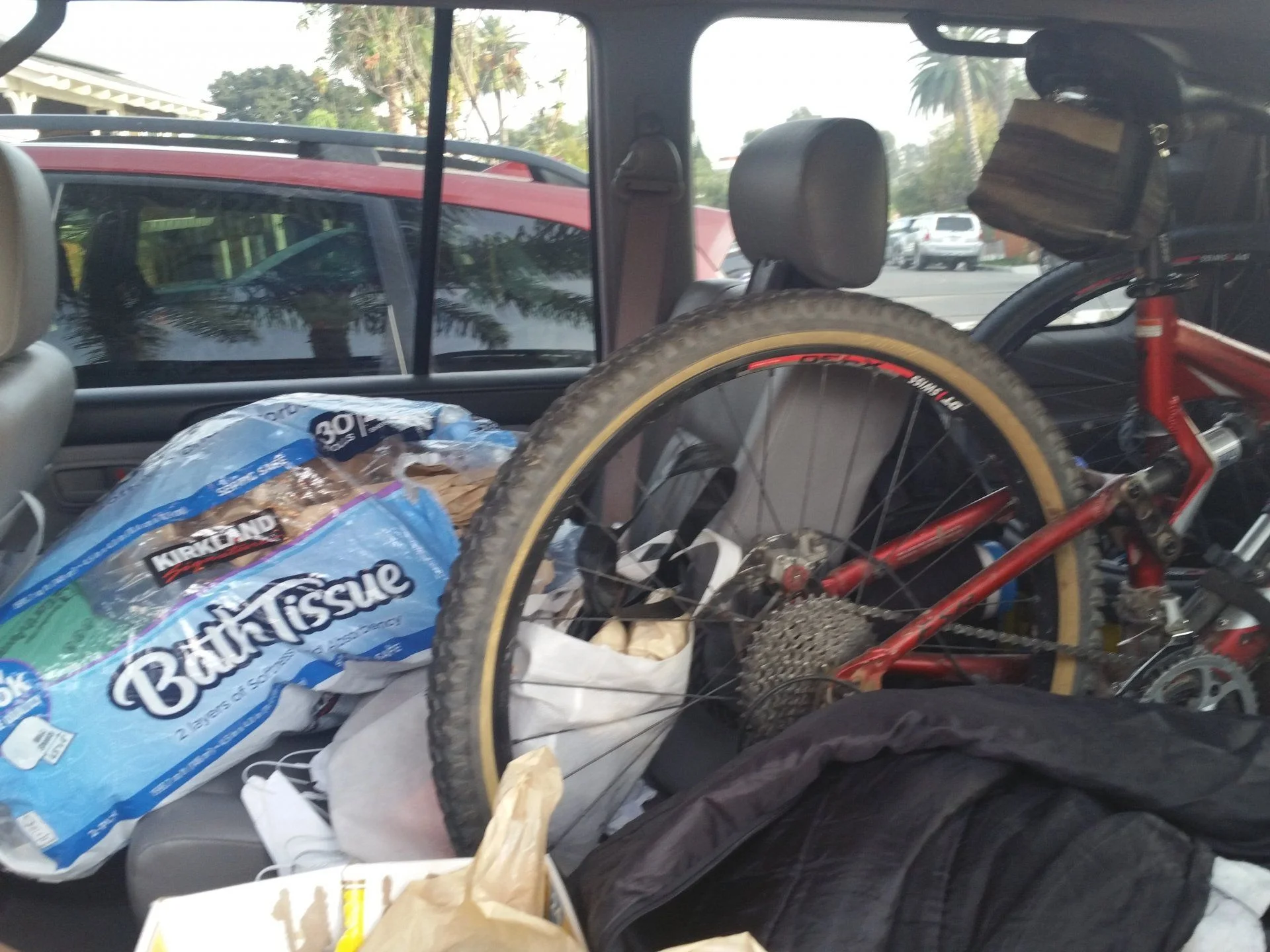

Has anyone rigged their rig where you can put a MTB in the back with the seat down? Sort of like how it would sit on a roof rack with the front tire removed and mounted to a Kuat Dirtbag or something of the like?
I have a Kuat NV, but I ride solo 99% of the time and it would be nice to just load my bike in the back instead of having the rack on all the time.

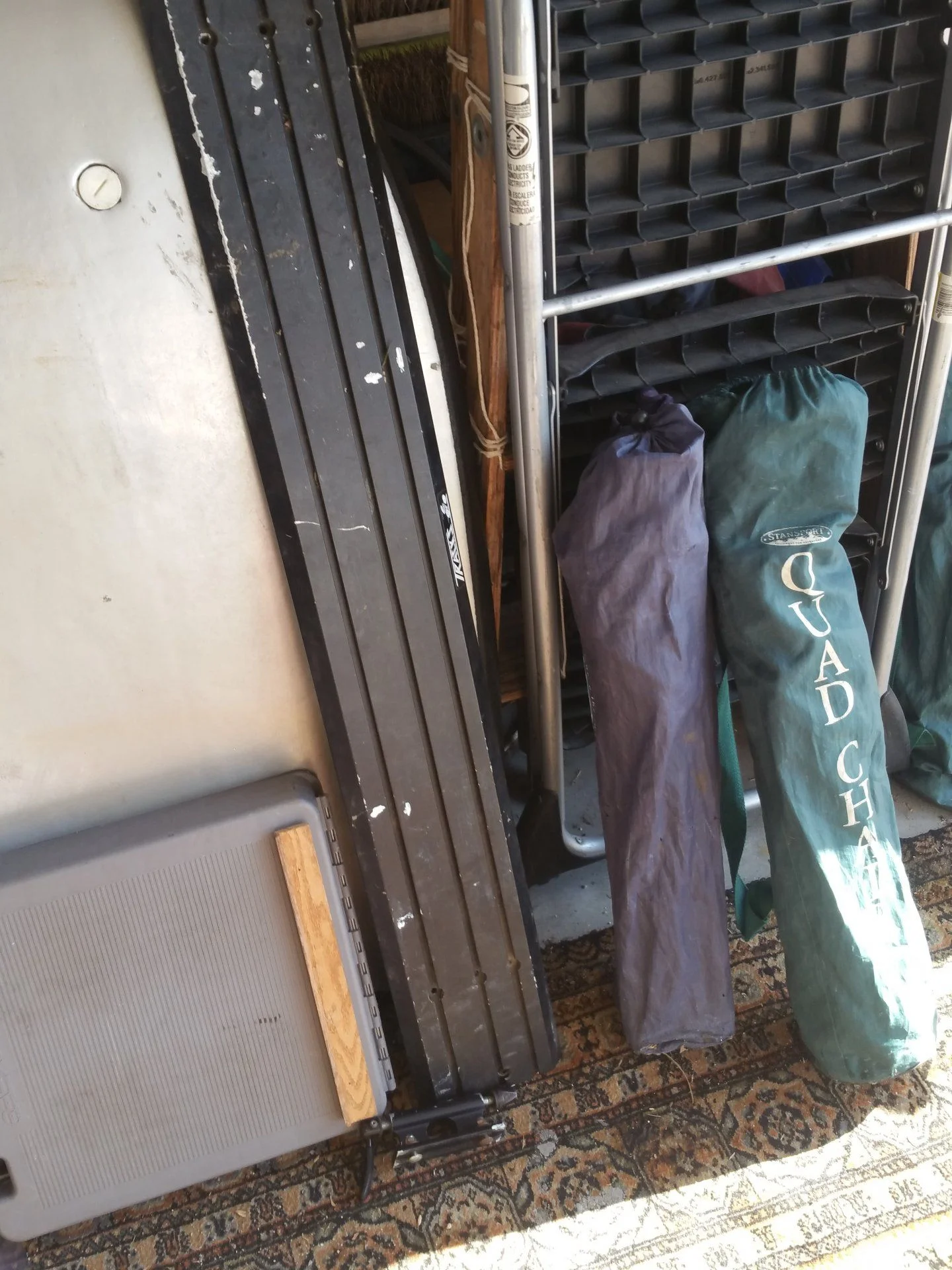

What I did there was run a line from one cargo tie down, through one of the extruded plate channels to the cargo tie down on the other side. Then ran the line back to the first tie down. I have a ratching line pully/hook (thank you Thule). Then pull like hell to tension the line. Anchors it right down. See the blue line in second pic.

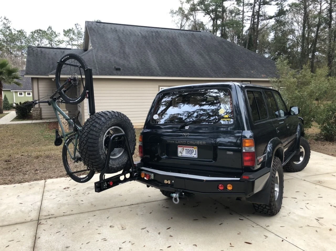

Finally got around to getting it put together. They forgot to send me the cable set, so still waiting on that, but the concept stays the same. Bike certainly sticks way out there since I have it on my spare, but the push was to have it on the swing out for quick and easy access into the cargo area. Took a bit of modification and some creativity, but it turned out pretty nice I think. I'll have to get a flag for the bars... Overall, goal achieved.
Turned out great @spazzyfry123
