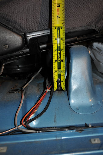

Here's what they sent to get measurements on:
Rob,
I need to know the height of the rear of the front seat mount rails, so where the seats are bolted to the floor, on the rear mount the height of that, as there is two different heights.
Regards
David
All Car Carpets
B 0 359643223
So of course i took pics... Let me see if i can find and attach/link.
Here's the response to All Car Carpets:
David,
I think i understand this correctly - attached (if they come through) are pics. Looks like the back of the front mount is just a bit over 4 inches (4.25-4.5) or 108'ish mm. Sorry for the delay getting this to you. Does this show the correct spot i am to measure?
Rob
and the pic i sent to show (just in case i didn't understand correctly).
Hope that helps anyone else who orders these from them. Also i got an ETA of 10-14 days after it ships (scheduled for Mon 3/30). So i might have these mid April! I'm in no hurry - damplifier needs to be complete before i can install them anyway.
