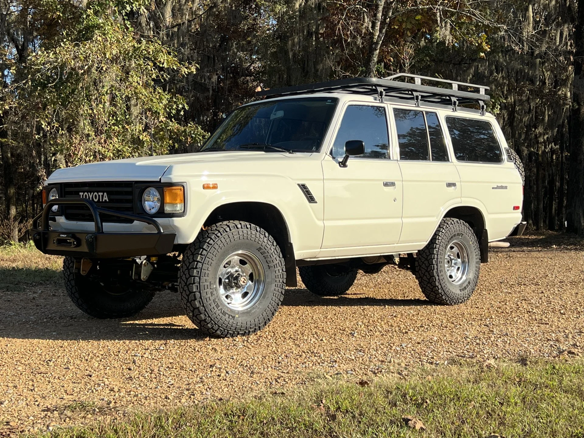

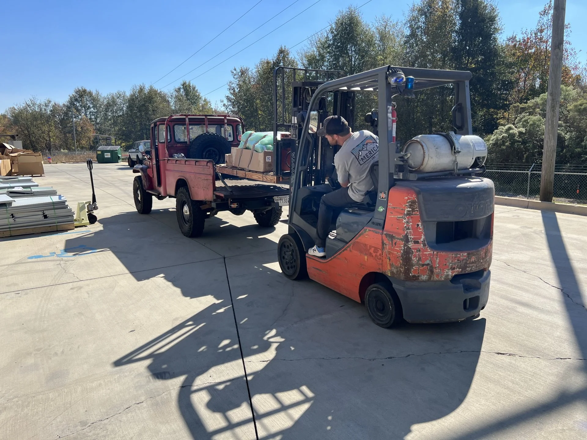

The owner has been driving his FJ60 every day for the last 2 weeks. All is well.
FedEx is dropping the 4Plus goodies today so I had him drop the truck off.

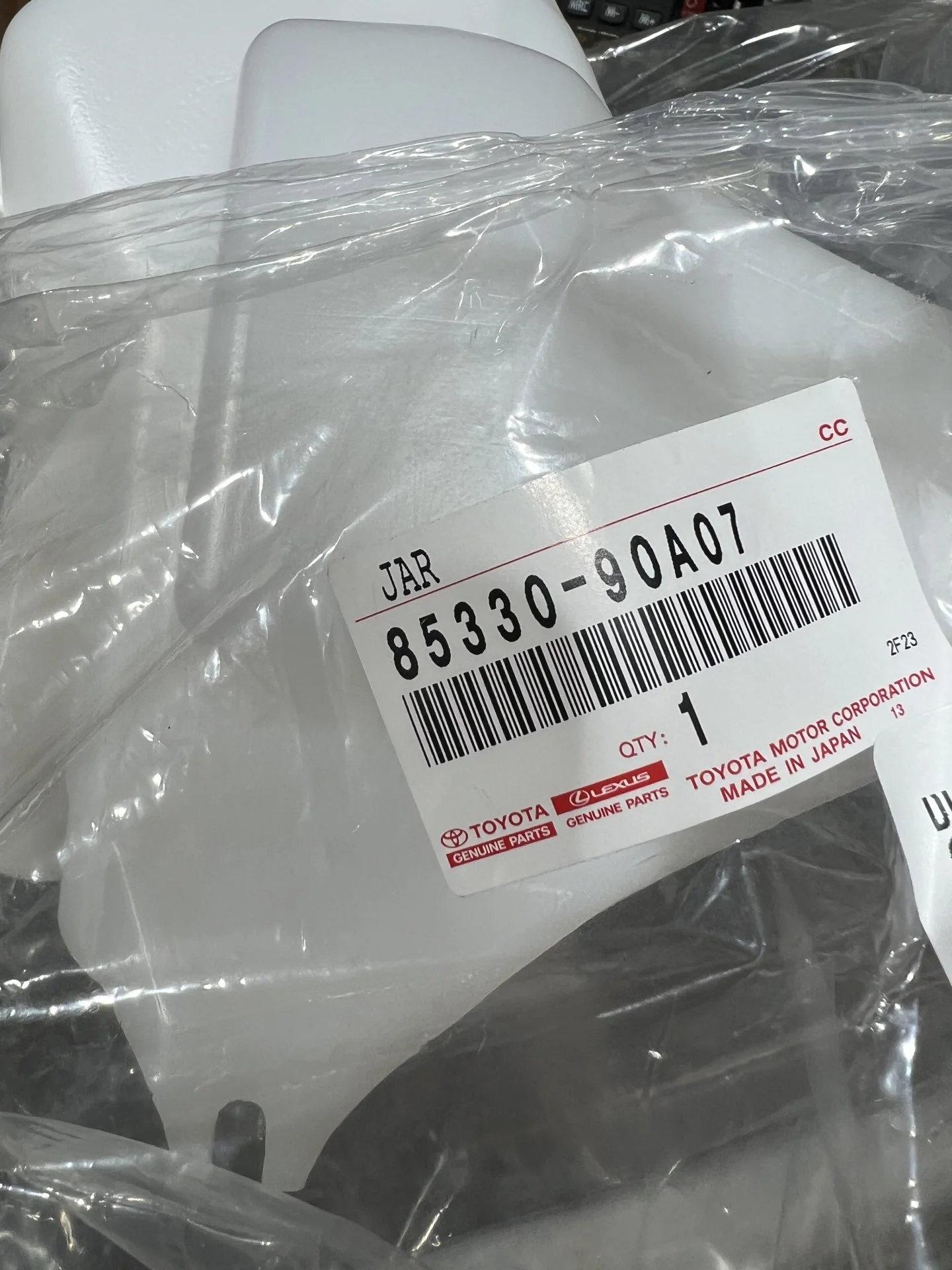

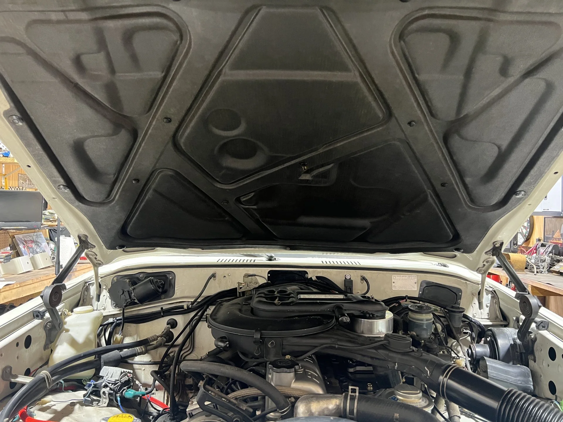

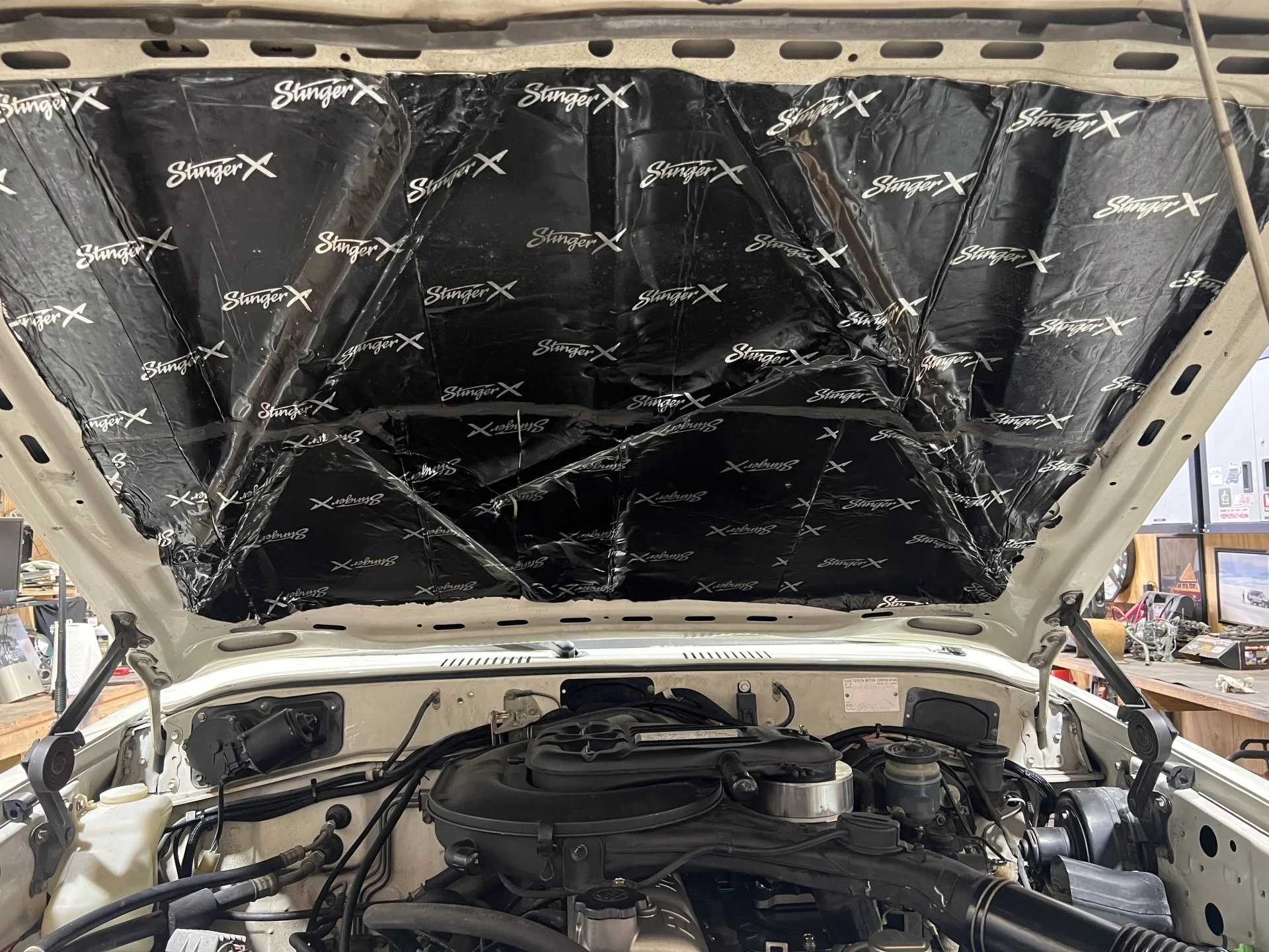

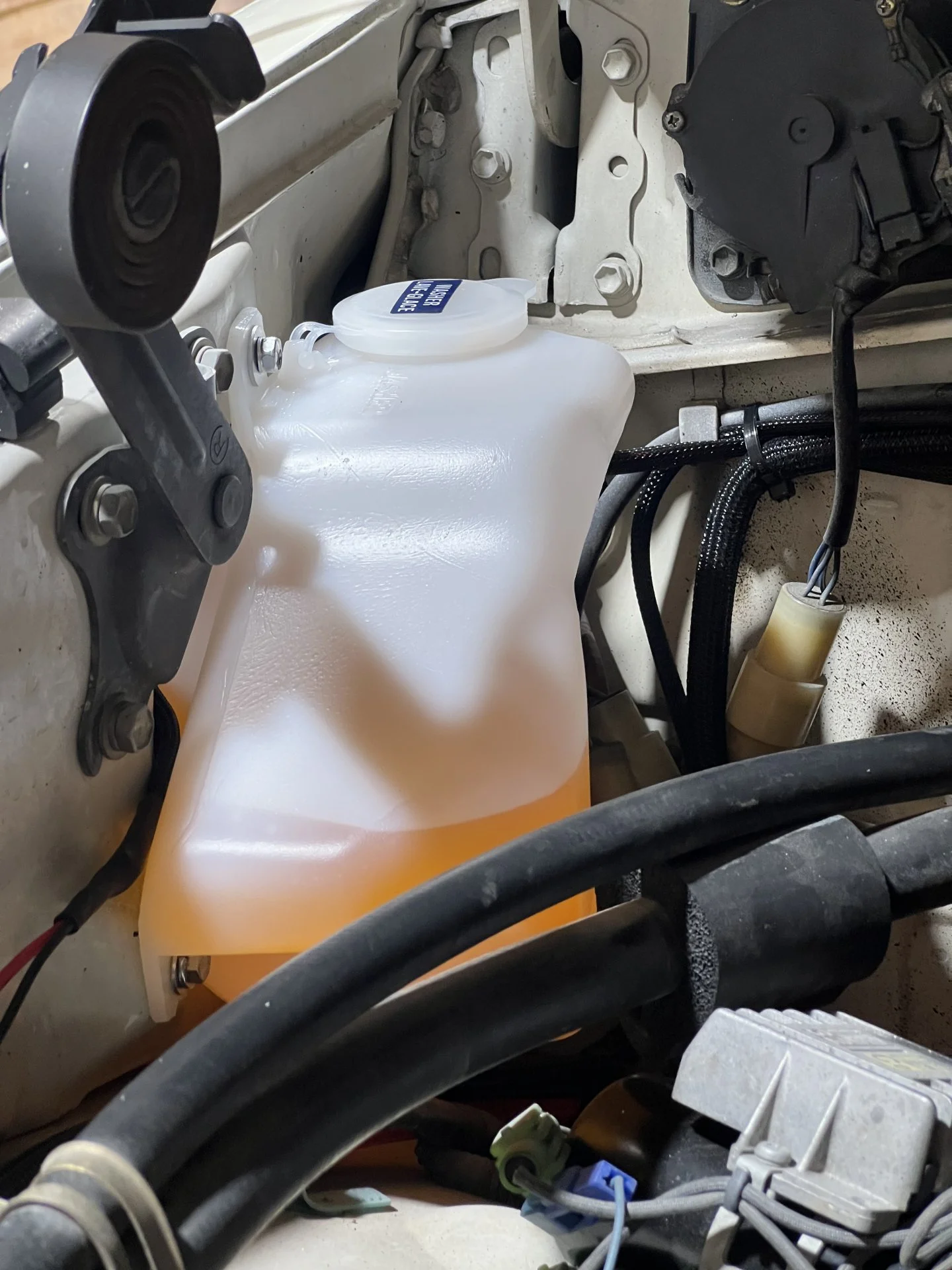

First things first….hood liner and a new “jar”

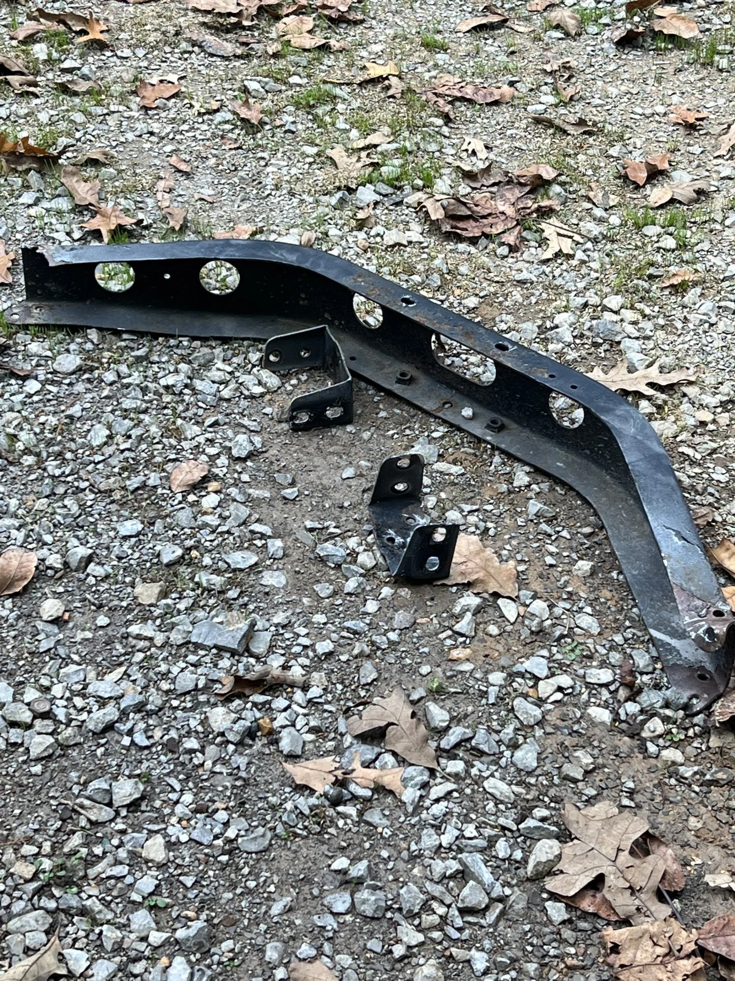

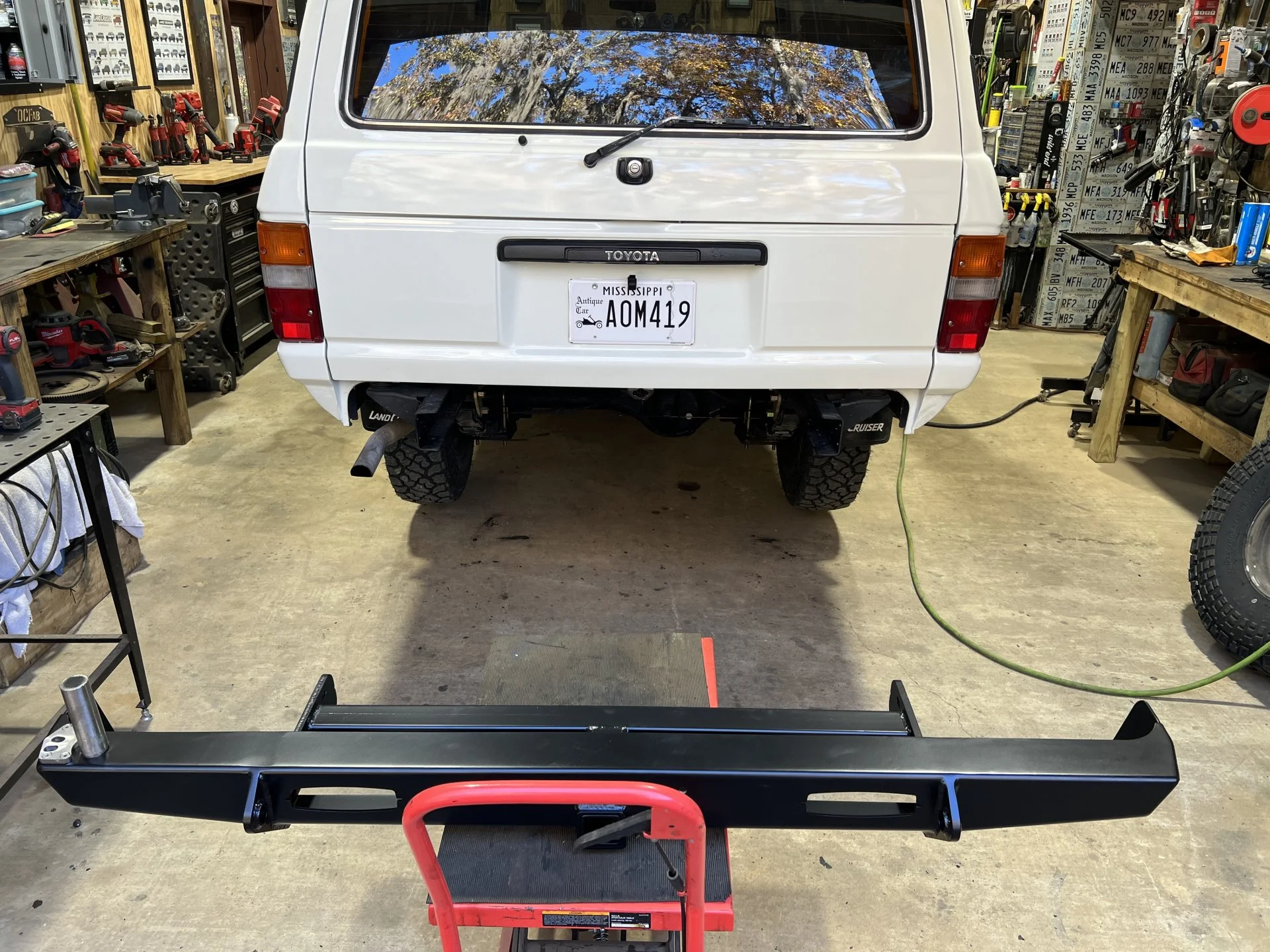

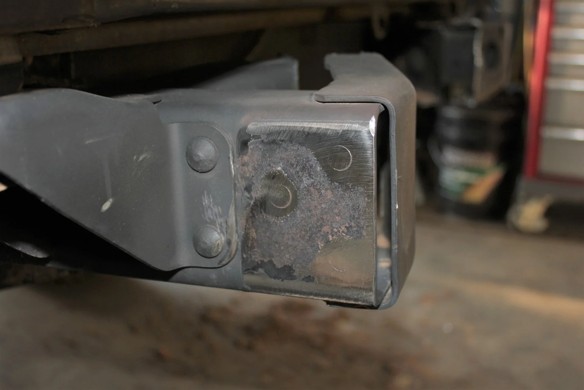

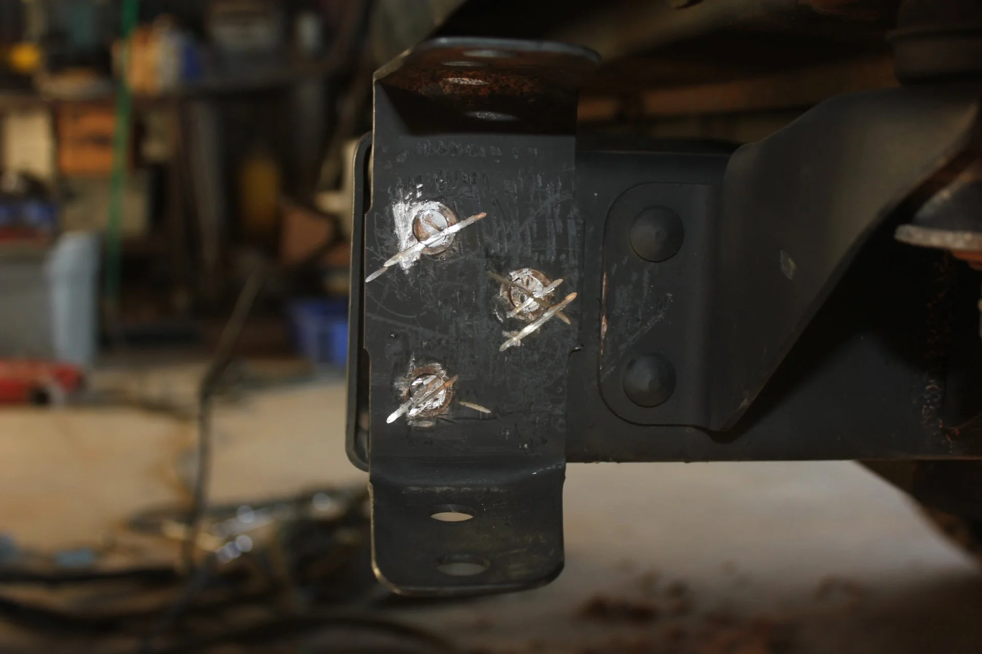

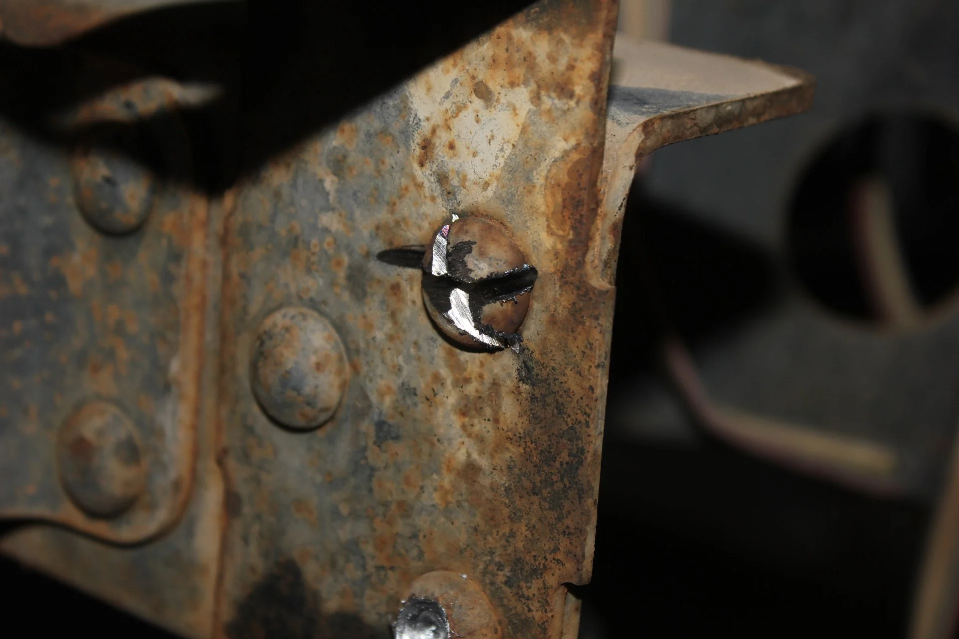

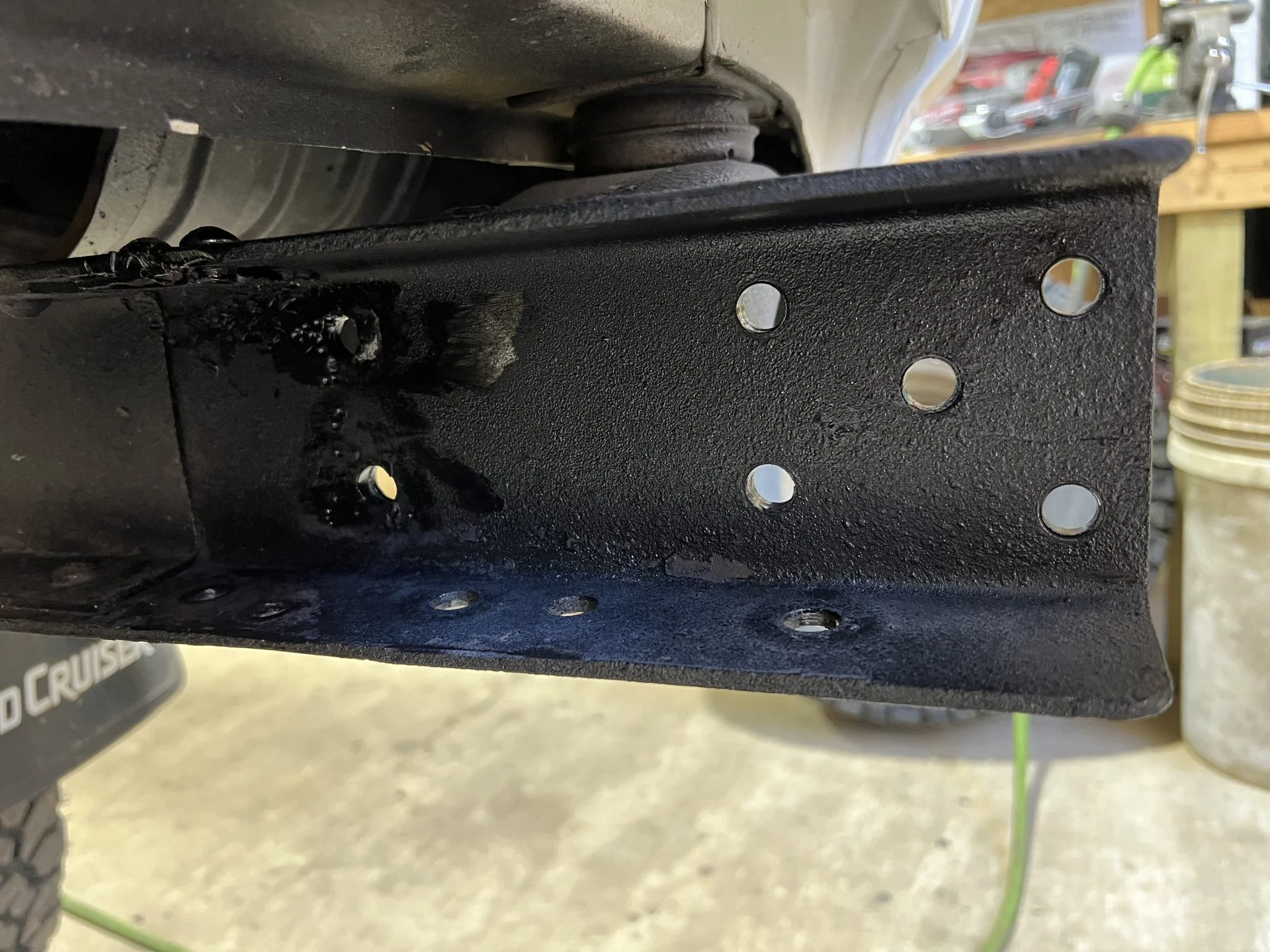

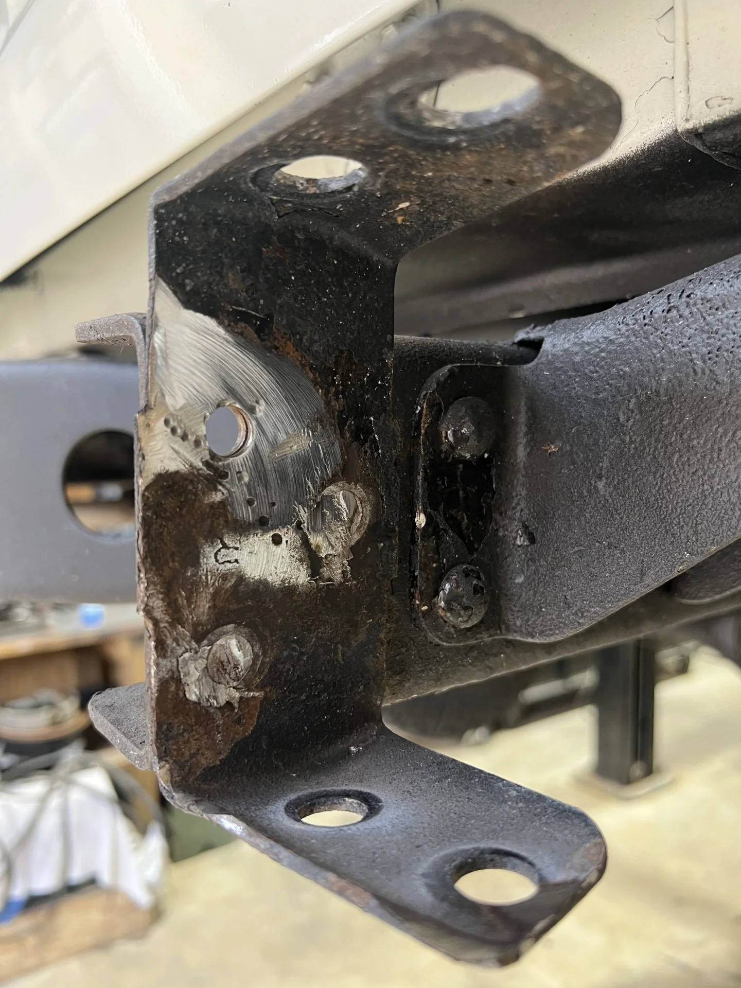

Next, I yanked the bumpers off and spent the last couple of hours doing the devils work….cutting out the rivets that hood the bumper brackets and crossmember.
Awful job.

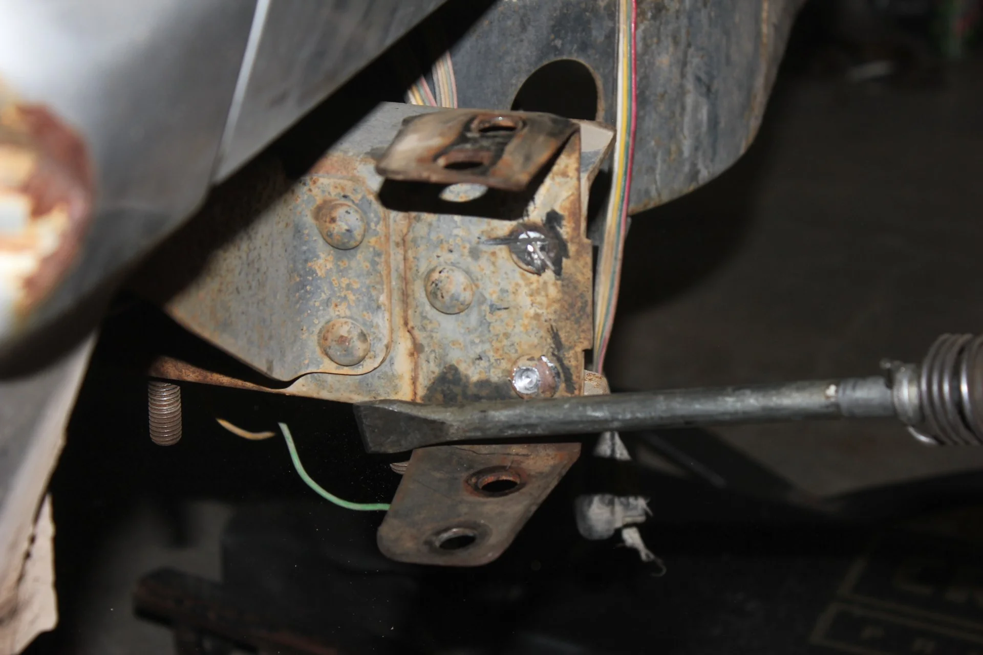

Man. Forgot that 8 more rivets had to come off the frame.
Man. These things are murder. Simply murder.
4Plus though. What a beautiful product. Thanks @lcwizard for the beautiful products
Ghastly hell hounds
What is your rivet process? I have zero issue with a good air hammer with a chisel bit then a punch bit.
About 30 seconds a rivet
I have a monster air chisel and sharpen my chisel each pass.
Then I use the same long stroke chisel with a punch to drive them out.
Then the punch deforms them and won’t ouch them out then I grind and beat and then I get the plasma out which produces slag that is a bigger mess.
Total bitch. I’ve never ever gotten one off in less than 5 minutes.
Well damn. I will say the older rivets are definitely more of a pain in the ass than the newer rigs.

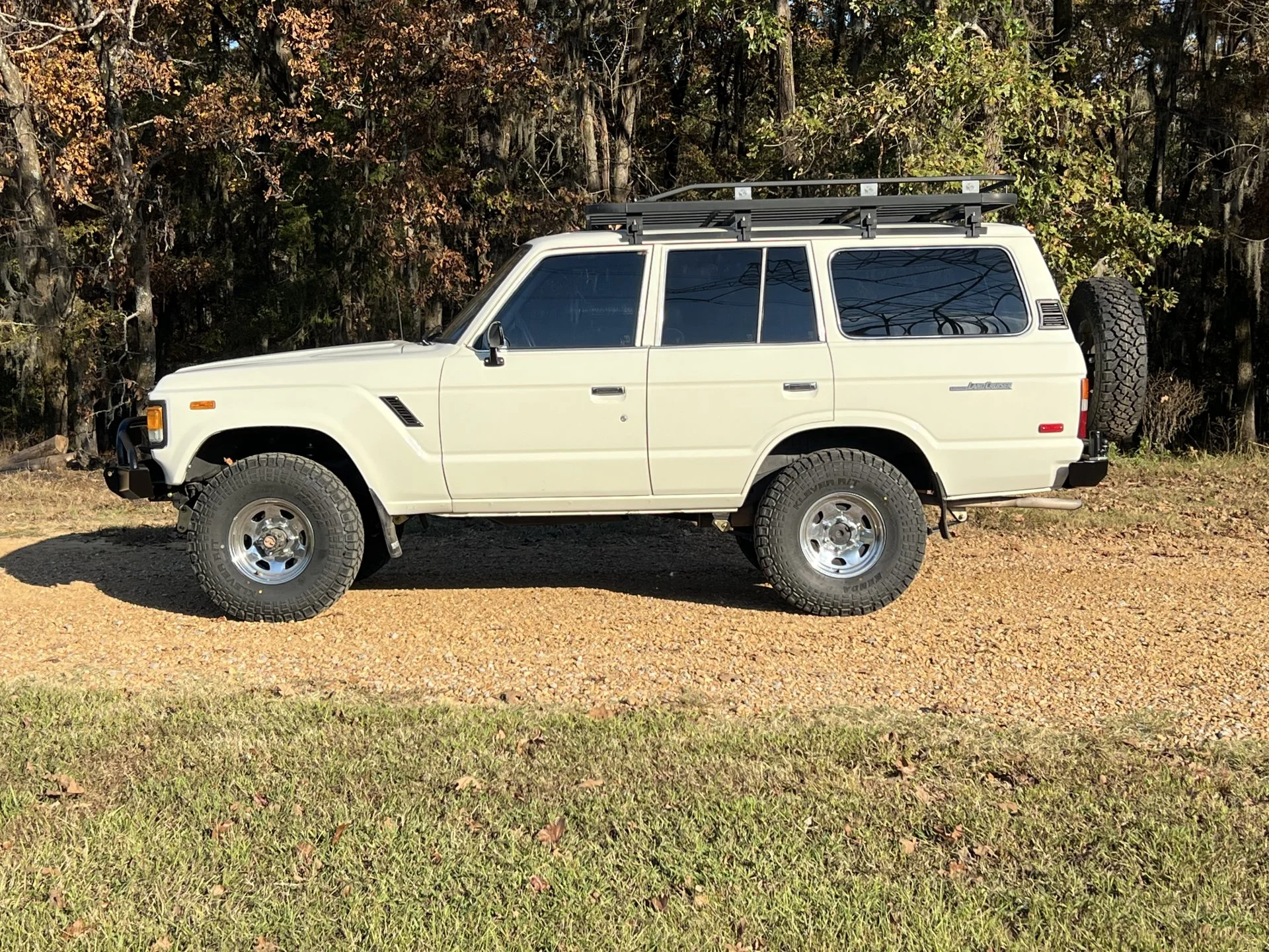

The ole girl fired up nicely and the first test drive was a grand success before I jumped in the OddBall 80 and hit the road for some R@R at the Cruiser Crawl
What did you do for a throttle linkage set up?
Lokar 36” cable hooked to the hand throttle tab on the 60 pedal

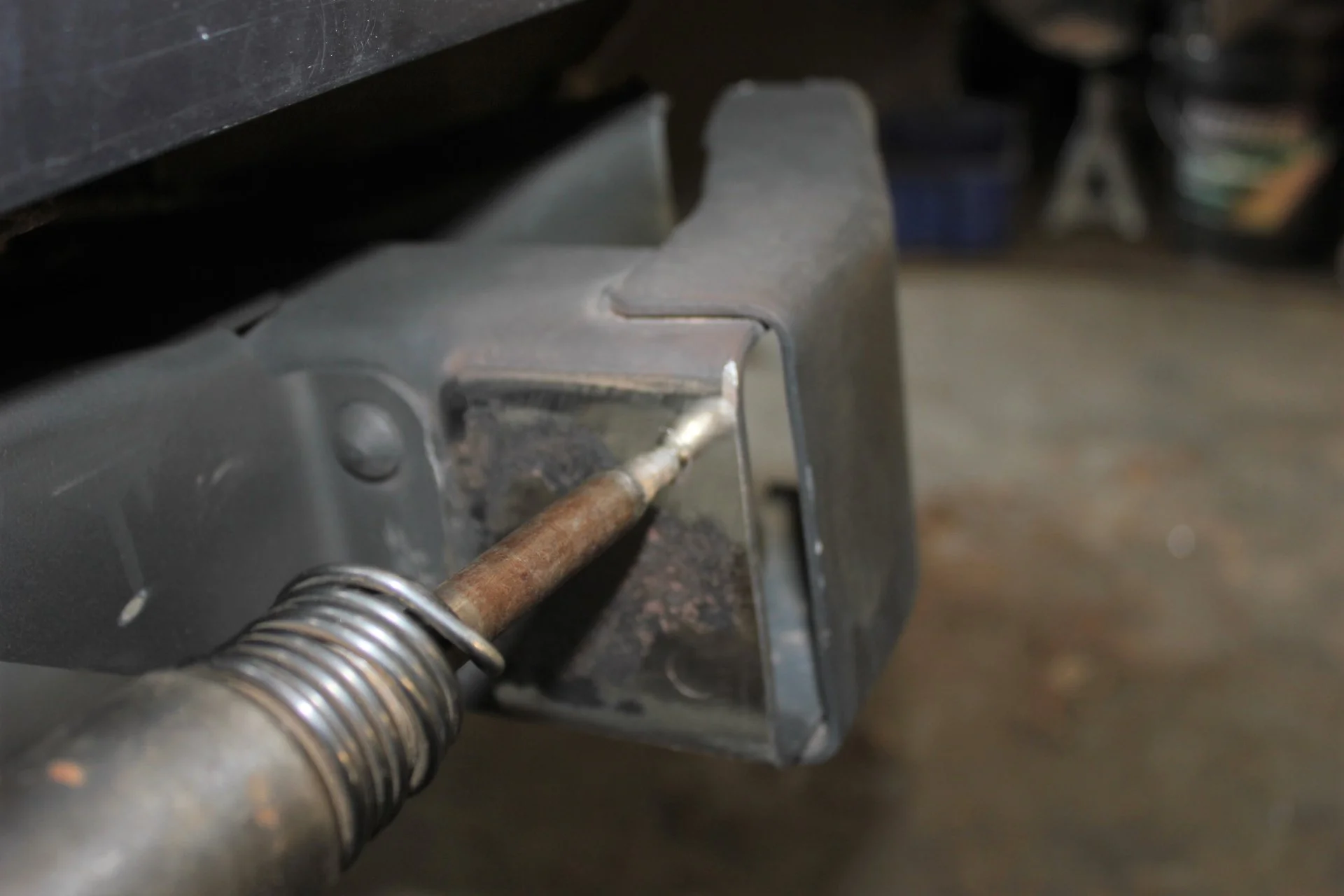

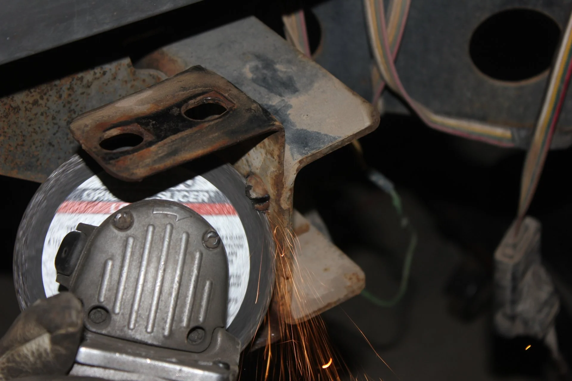

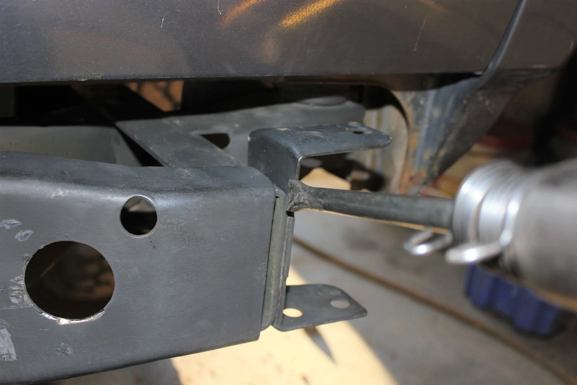

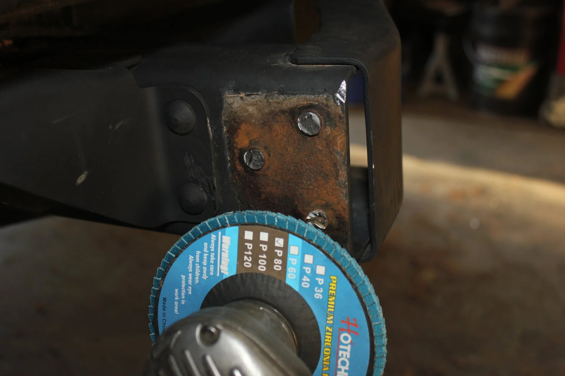

I use LCWizard's cross cut trick, but use a die grinder with a diamond wheel - it tends to be easier to get into places than a full size grinder.
(random internet photo)
